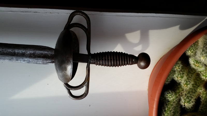

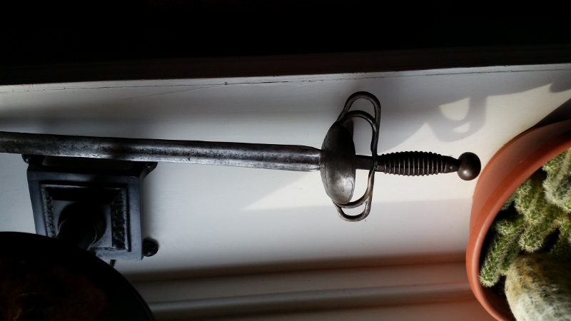

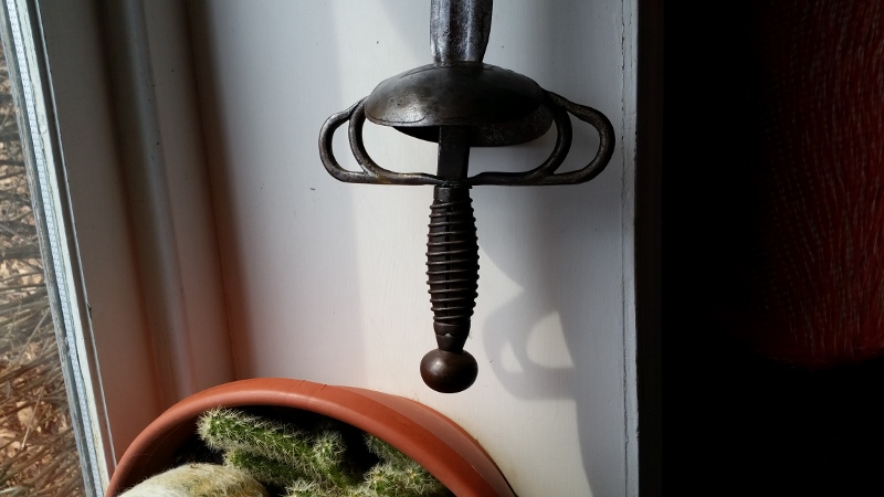

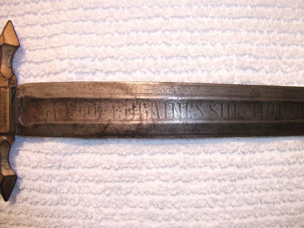

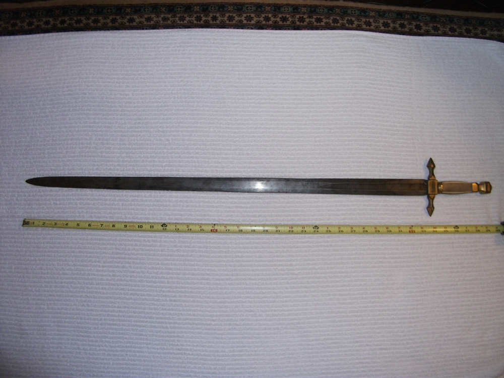

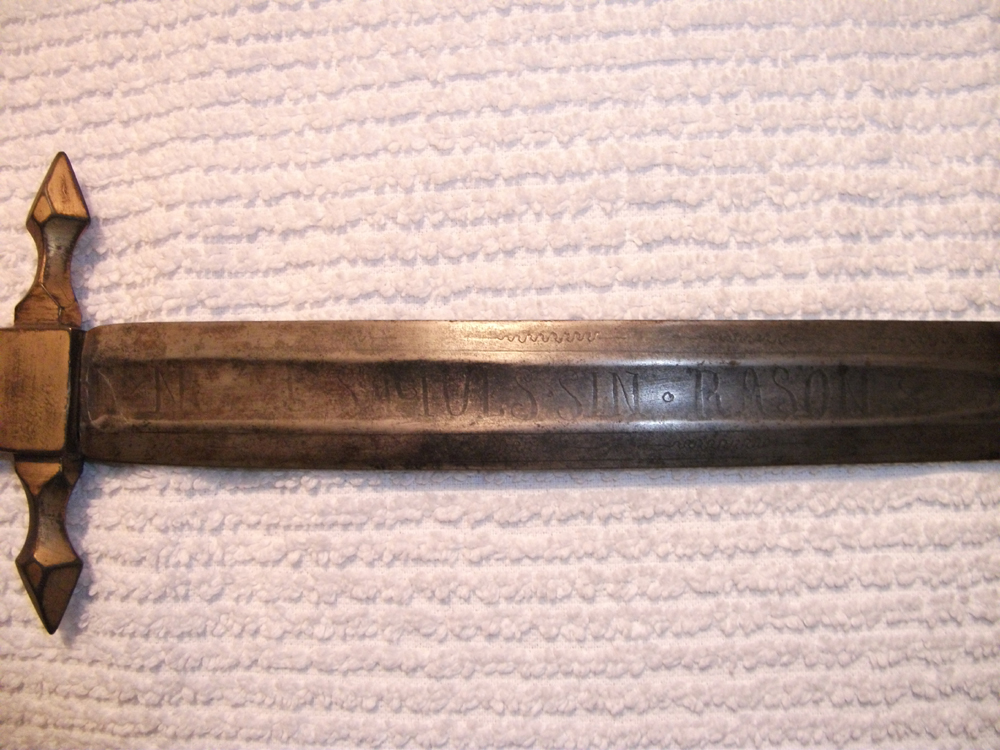

Can anyone help identify the maker and approximate date of this sword?
The sword was given to US Army Brig. Gen. Robert Swartwout, probably during the War of 1812, by US Navy Commodore Stephen Decatur. The sword had been taken by Decatur as a token of surrender from a Barbary pirate captain whose ship was captured by Decatur during the war with Tripoli in 1804.
Gen. Swartwout unfortunately changed the hilt so that he could use the sword as his personal dress sword. The sword passed down through the Swartwout family and I inherited it.

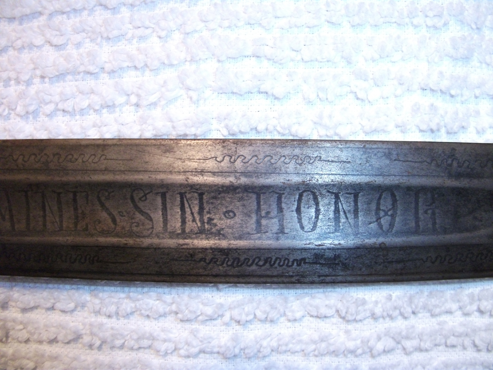

The sword is engraved with the "Spanish motto" "No Me Satues Sin Rason" and "No Me Enbaines Sin Honor." The engraving is nearly identical in appearance to that on the sword of Jeff D, whose sword is shown in the following thread:
http://www.vikingsword.com/vb/showth...=spanish+motto

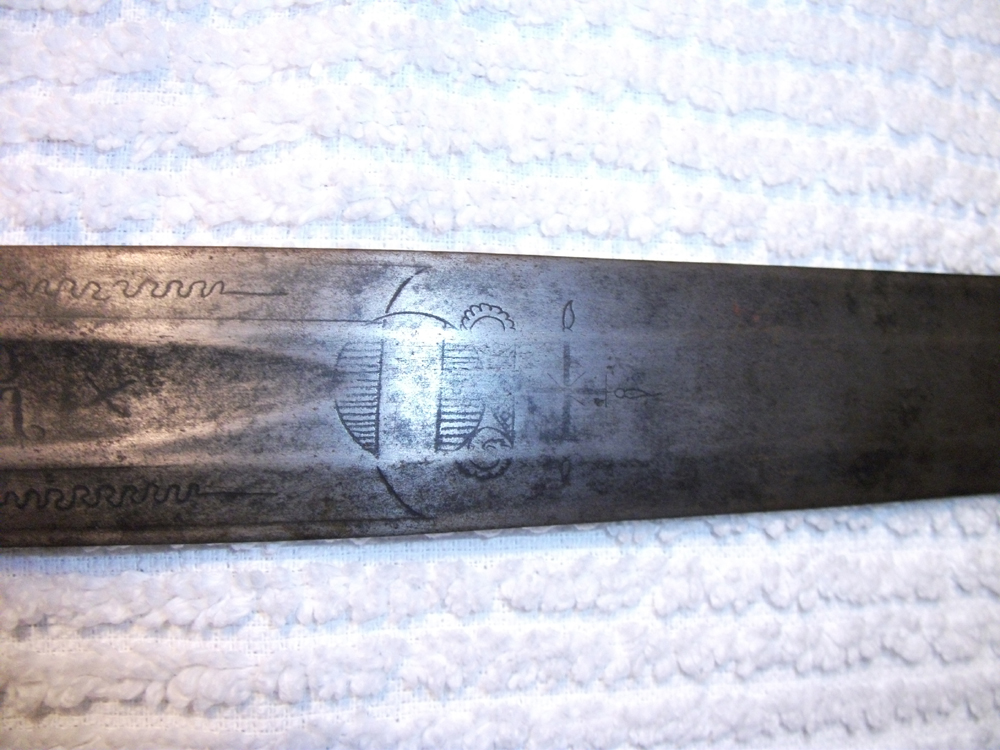

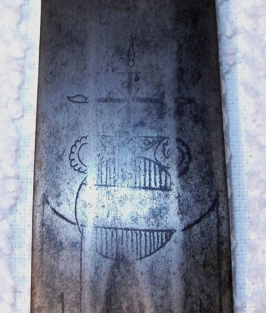

The difference in the engraving is that, while Jeff's sword has a "sun and moon" motif attributed to Solingen, mine has a different motif that I can't describe in words, so I'll let the photos do the talking.
If anyone can identify the maker from the engraved motif, I would be most grateful. It's shown in the last photo below, and is the same on both sides of the sword.

Thi is most certainly an European blade, Jesse.
Let's move this thread to the European Forum, to see if members there come around with their comments.
Old 10th February 2015, 12:33 PM   #5
Until better opinion, i would bet on the Solingen origin, such as used for export.
The symbols (Solingen Orb type) are unusual, although recognisable by some.
It looks like they are connected to something more defined than the usual generic stuff.
May i put it upright ?
... and maybe with time you can get a better picture ?

Thanks, Fernando. Do you think my "orb and cross" is a Solingen mark, then? It seems similar to this group of Solingen marks:
PS...sorry for photo quality. That's the best I can do. The markings are worn and quite faint.

The history of the piece makes sense. The Barbary Corsairs were 'just across the way' from the Iberian Peninsula, with trade routes and potential captures from Spanish ships. The blade is from a broadsword (?), so we can assume the original hilt was probably that of a bilbo (more likely) or perhaps cuphilt, as in the types seen in Peterson's and Brinkerhoff's books.

The thread you had a link to was a Scottish baskethilt with a Spanish-type blade. The problem with trying to identify a sword sans hilt can be very confusing. Spanish and Portuguese swords of the 17th-18th c. had the classic saying, but that motto was often inscribed on imported German-made blades for the Spanish market. Spanish swords were often diamond-shaped/six-sided, but again, Solingen often reproduced this pattern for export. Your blade seems to my inept eyes to be a true Spanish type, based on decoration/inscription, but still might be Germanic in origin. In any case, it is extremely rare to see that motto on anything other than Spanish types (bilbos, cuphilts), such as the Scottish sword in that thread. Being that yours comes from Morocco or similar port and bares the Spanish blade, I surmise that the hilt was a bilbo or cuphilt. I have in my collection a very similar bladed bilbo (the inscription barely legible and from an earlier sword), the hilt of classic 'colonial Spanish' form, with primitive braised pas d'ane, kidney-shaped guard from another sword, wood hilt with crude wire wrap, all 18th c.
As a pirate enthusiast, I can't tell you how much this sword means to fellow collectors, but provenance is everything! Keep your receipts and correspondence! The hilt found on the piece does appear to be the typical early to mid-19th c. dress style hilt.

Posts: 10,852
Mark is of course spot on in his assessment and observations here, and we have always had a passion for these 'Spanish motto' blades. As he notes, this blade was probably in a Spanish 'bilbo' which was a rapier like heavy arming sword used in the Spanish colonies in the 18th into the 19th centuries.
These Bilbo type swords were quite common in Spain's colonies on Mexico's east coast, Cuba, Florida and other ports of call in the "Spanish Main' . Naturally the Moroccan littoral was included in these locations, so not at all surprising to see this very nice blade in this context.
These 'Spanish Motto' blades were indeed made in Solingen for Spain to export to her colonies, and entire shipments of these blades have been found en masse. The 'flourish' incorporating the cross and orb would be part of the application added in Solingen, but these blades be ascribed to any particular maker. I believe they were contractual and likely completed by several makes and inscribers.
