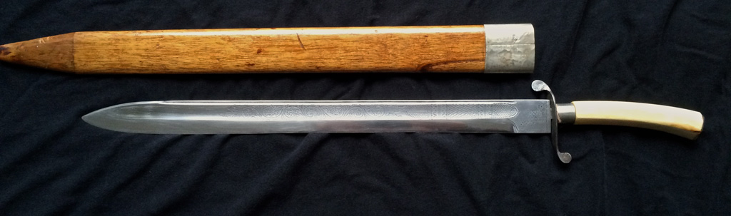

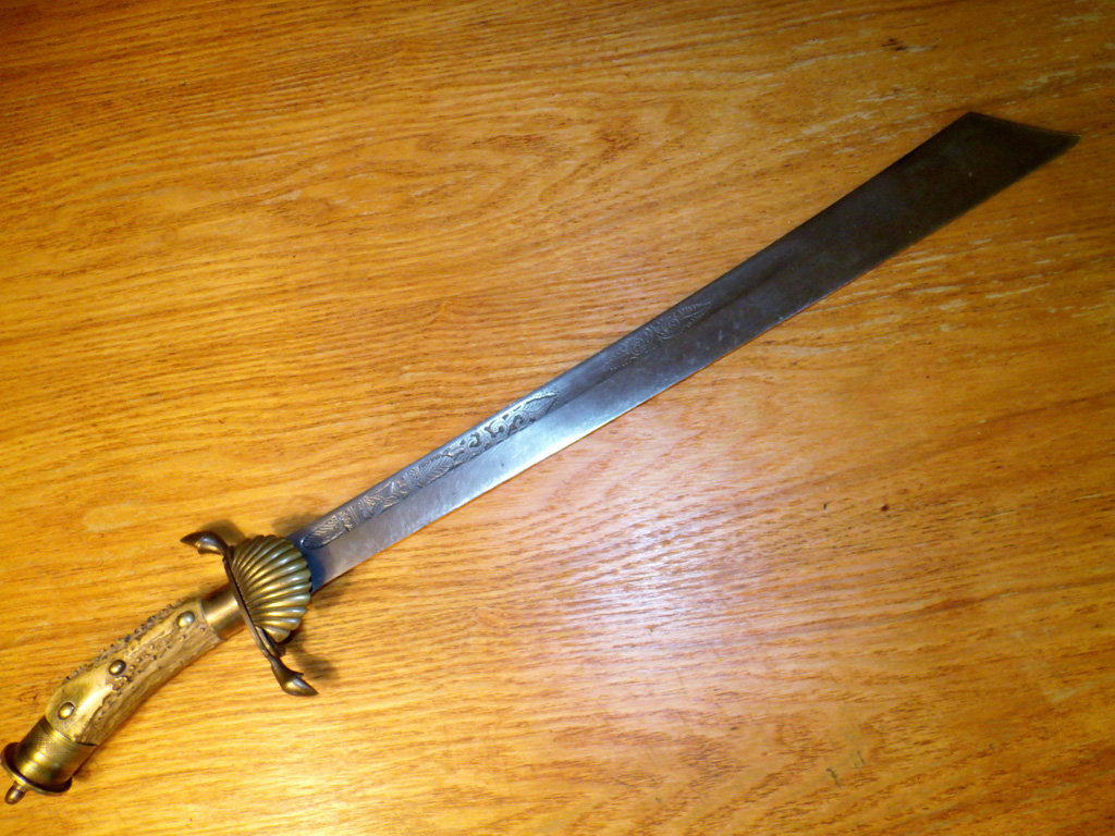

To get us started, here are two of my swords. One is a heavy Tjicatjing Klewang married to a European-style stag horn grip with a clamshell langet on the front of the cross guard. it is beautiful and a delight. The second is a Tjipatjing Golok with a beautiful bone hilt and a European style S-shaped guard. Both blades are very well forged, light in the hand and sharp enough to shave your beard.
