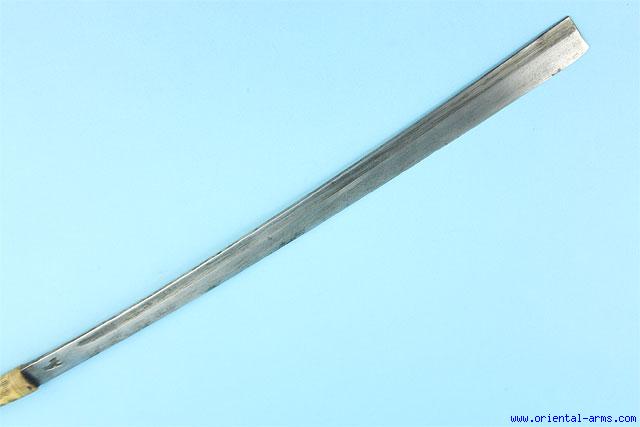

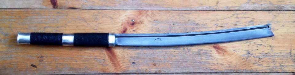

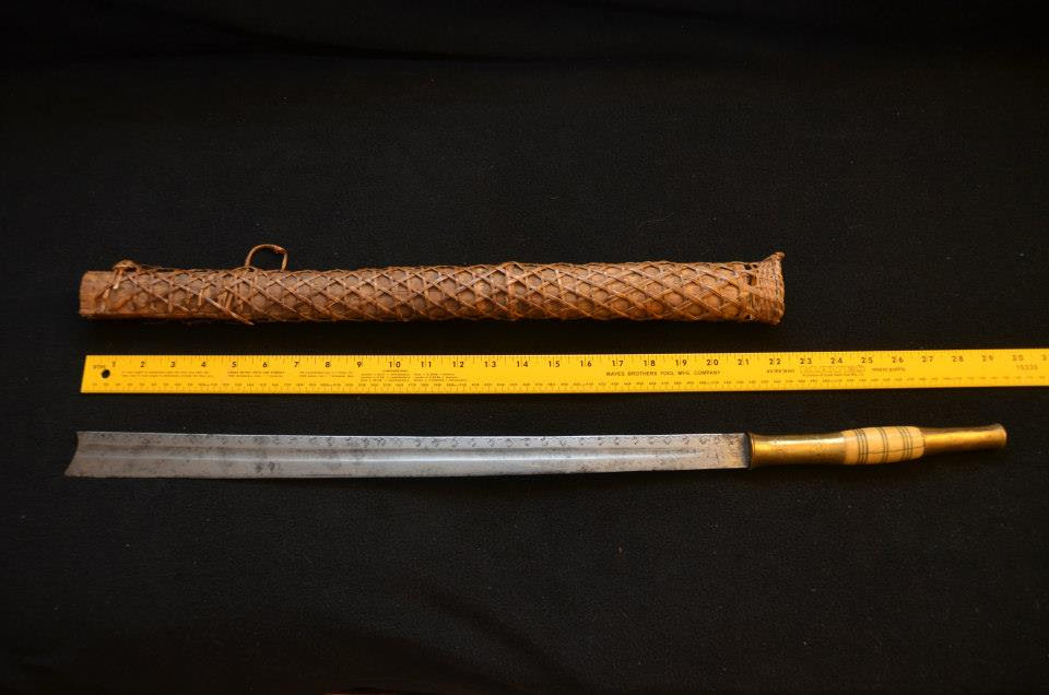

1. dha , kachin? guessing metropolitan , any thoughts on age and origin ? scabbard pictured certainly not the original

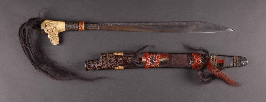

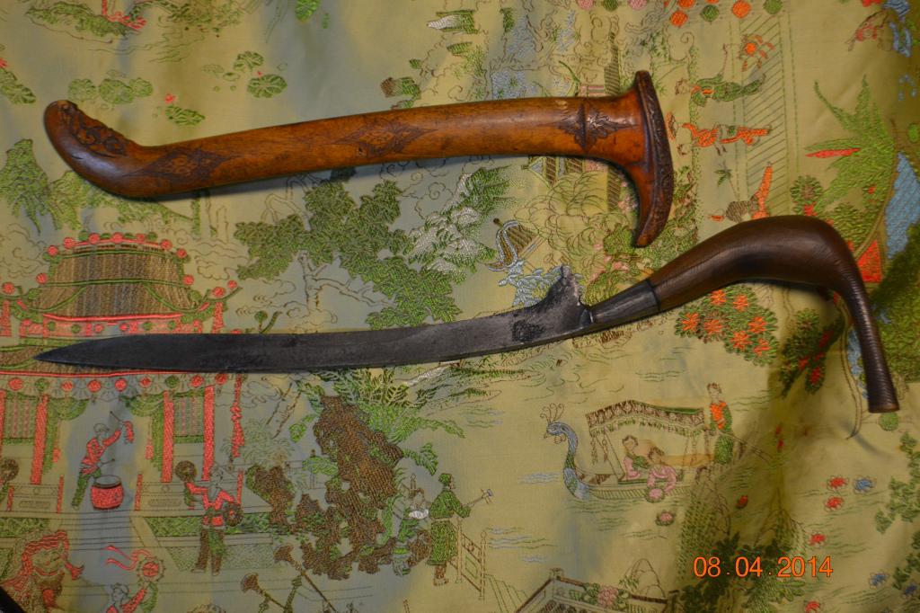

2. how old is this? I think old, I can make out very very faint old aso patterns, almost impossible to see in a photo- this is the one I am most curious about
3. My very first real mandau, purchased from antiques dealer online, age was claimed to be first quarter of 19th century, it has a very fine balance, and I think he was not lying, but again, expert eyes appreciated!

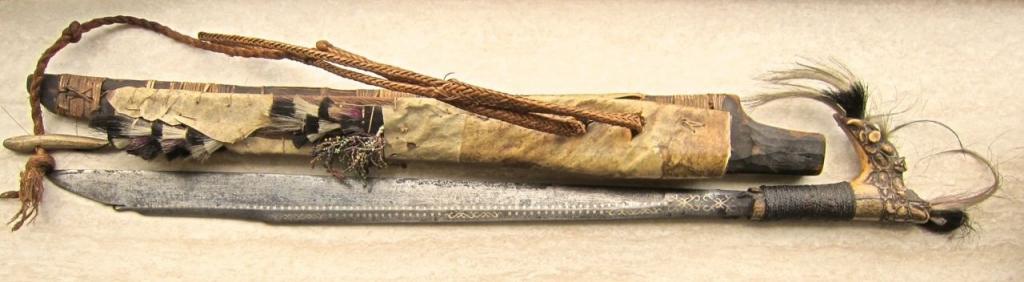

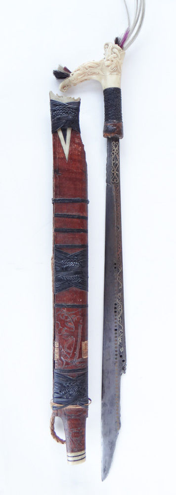

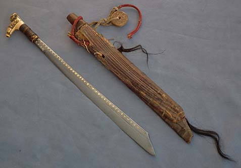

4. perhaps my favorite mandau , purchased from another dealer, any ideas on the tribe and age appreciated-- dealer dated it 3rd quarter 19th

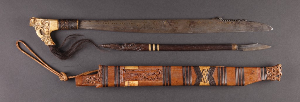

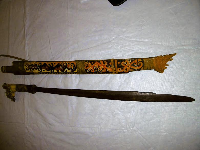

5. same deal included this one, simply love its design ; scabbard is replacement, would like thoughts on age of the blade.

Hello Gehazi:
Welcome to the forum. That is an impressive collection of mandau you show, but the one that interests me is the dha/dao which does resemble the Kachin style dha used mainly in northern Burma. This particular one, with its brass fittings on the hilt, was probably made in Burma or southern Yunnan but I suspect it was used in Assam. The accompanying sheath with its lattice work of rattan resembles rattan work from a number of tribes to the north of Burma, including the Abors, Akas, Garos, and Singphos, and probably a few others. It is not common to find this form of scabbard. Both the sword and sheath seem to have some age (perhaps late 19th C).
Ian.

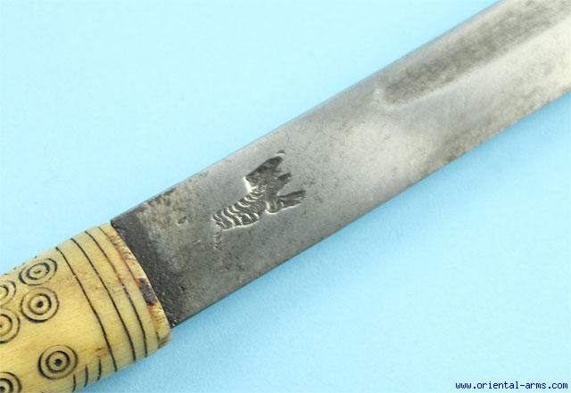

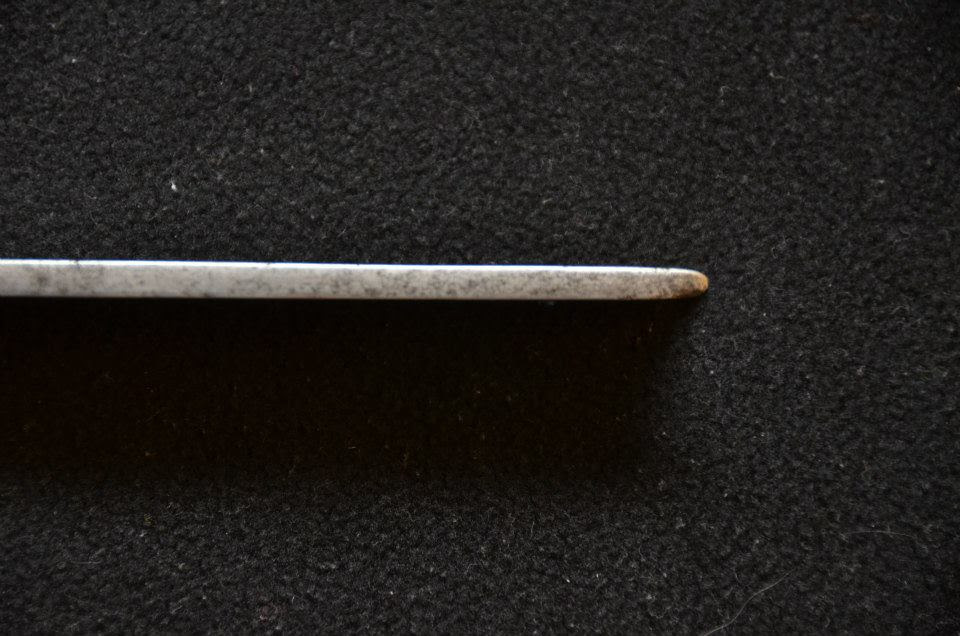

on the dha the scabbard actually fit so poorly I assumed it could not be original to the blade; though if it does match region, it would make sense it just got worn out. the blade remains very thick from hilt to tip, with almost no distal taper-- of all my dha it is definitely my favorite, I will post the rest that I have archived as I can-- I will include a few more pictures of the dha since you are interested in placing it better-- also a key feature I think ; it looks almost like it has a hornet or hummingbird forgemark that has mostly worn away.
a few more pictures of the first dha, along with another dha you guys may recognize, as I snapped this up within a few minutes of it being posted on artzi's site. it is my only obviously forge marked dha

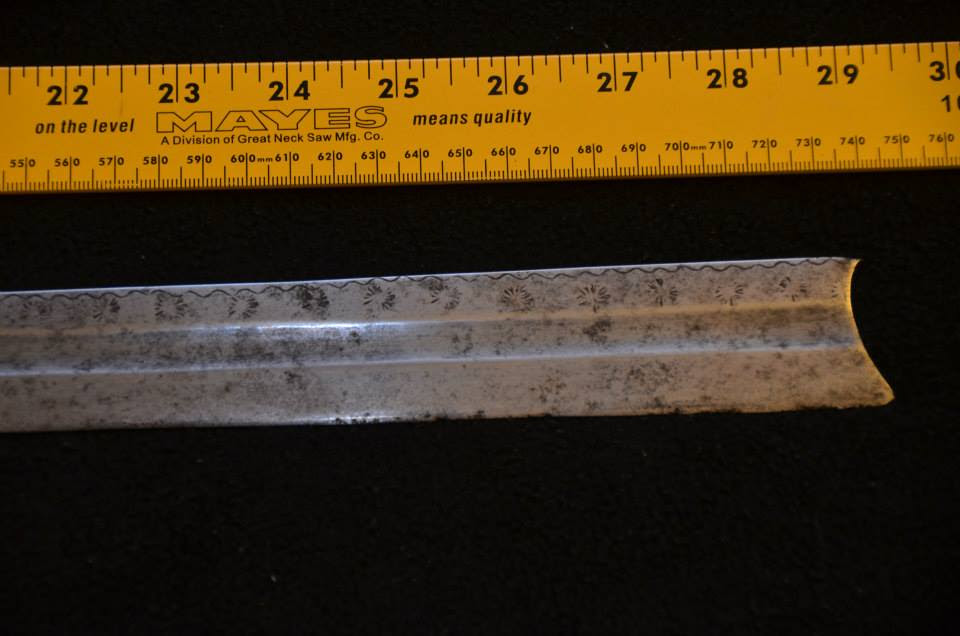

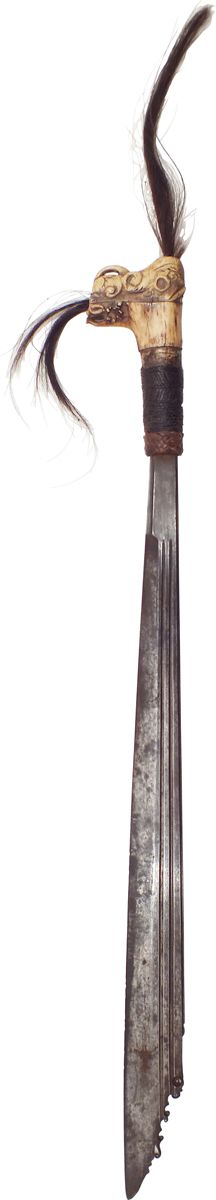

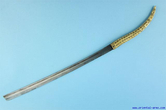

1. a really well balanced mandau missing most of its decorations, but the steel is still very fine, the double fullers and the work on the end make it one I really enjoy, though It lacks the art of many of the more complete sets-- would love opinions on actual time and place for this one-- I picked it up from fagan ( I hope it is ok to tell whom I purchased these from as I consider most if not all of them worthy of advertisement, my collection is largely possible because dealers let me pay over time )

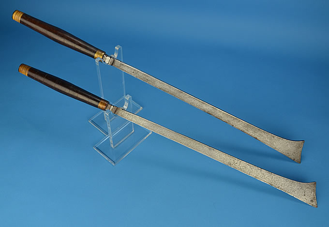

3. I saw these up at akaal arms and simply fell in love immediately, they are so strange, and almost a union of all my favorite collecting areas! dha+parang= very cool swords; 1906 coins in the grips, seller guesses the blades are kora influenced, I think there is naga influence, please any ideas are welcome on origin ; small note is that one is built thicker, and a bit longer, slightly heavier; my guess is blades meant for right and left hand.
4. I won this off of ebay, I bid against a fellow forum member I am sure, but I just had to have this one, and my luck was that it was missing a pisau, but I did have a very high quality one that looked as if it was made for it, and now they are a full set-- no full set pictures yet but I am organizing collection for insurance and will take new pictures soon.-- this is just a very fine blade all round, I love it , one of my highest quality mandau

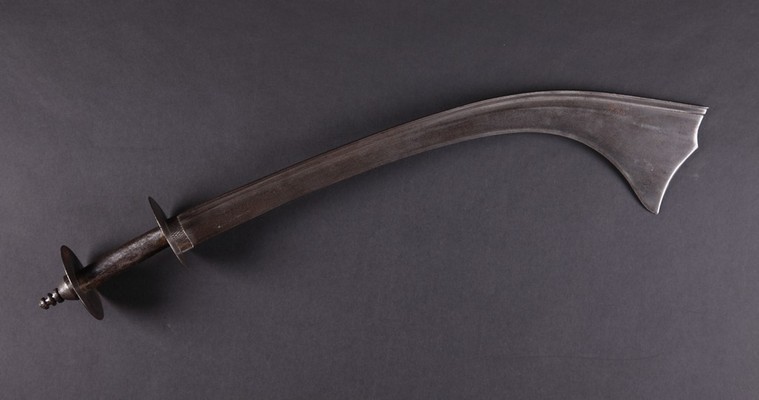

5. My one and only kora fighting sword, purchased from erik's edge, steel looks almost crystalline though I know it is not wootz, it has a feel unlike my other blades in the character of its steel, not sure if it is the design of the blade or an actual high quality steel-- not as interested in this one's past, as I know it is a kora, and a bit off of my collecting target of head hunter blades.

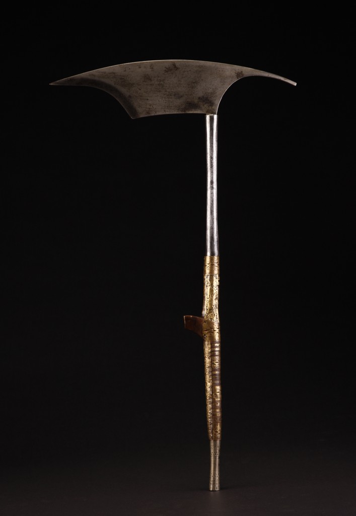

1. A chieftan's ax, luzon, kalinga, all original, farrow fine arts

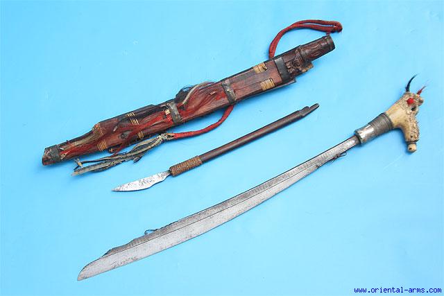

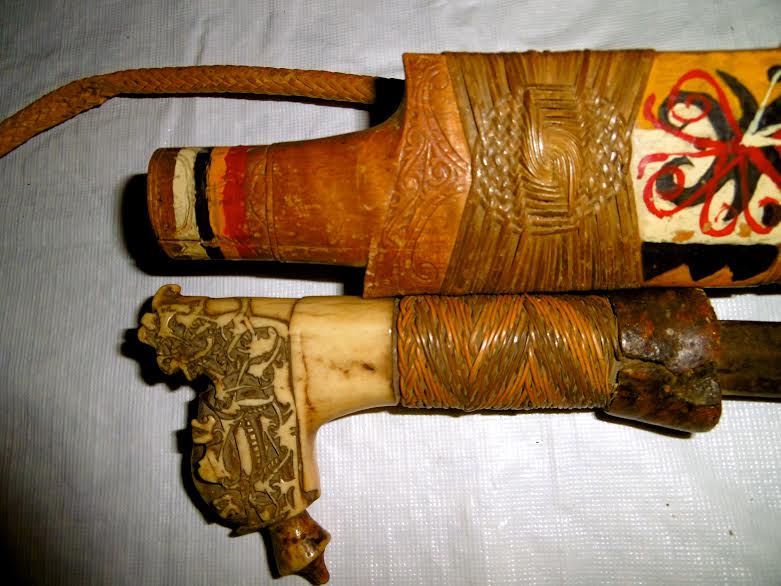

2. A complete sea dayak sword, not a mandau, but does have a side knife, and even has a floral decorated dart holder in perhaps ebony ( or some dark heavy wood) is set between the pisau and the main blade-- the blade is centered and very well made, a saber-- one of my favorites ; oriental arms

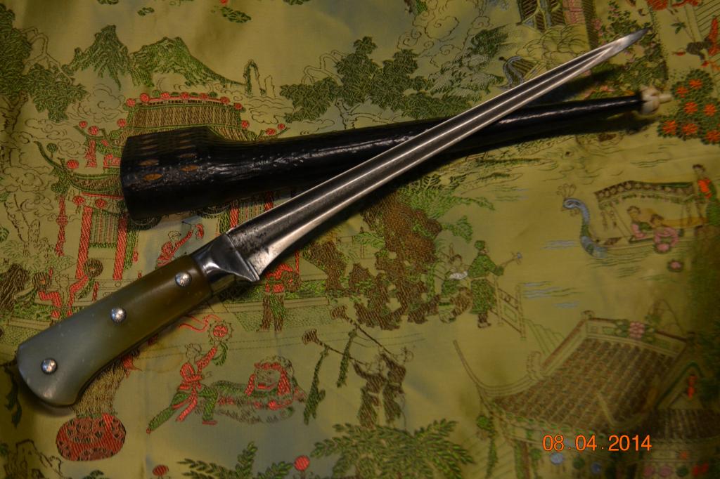

4. pesh kabz with wootz blade and jadeite grip, arms and antiques
