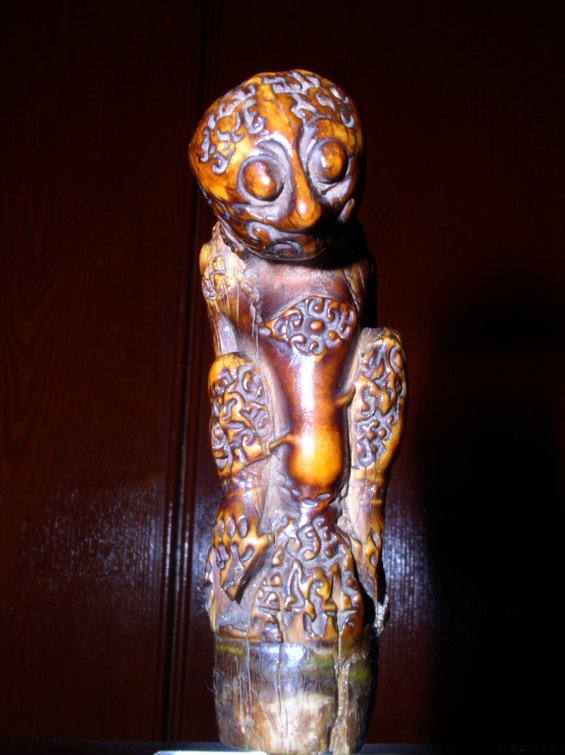

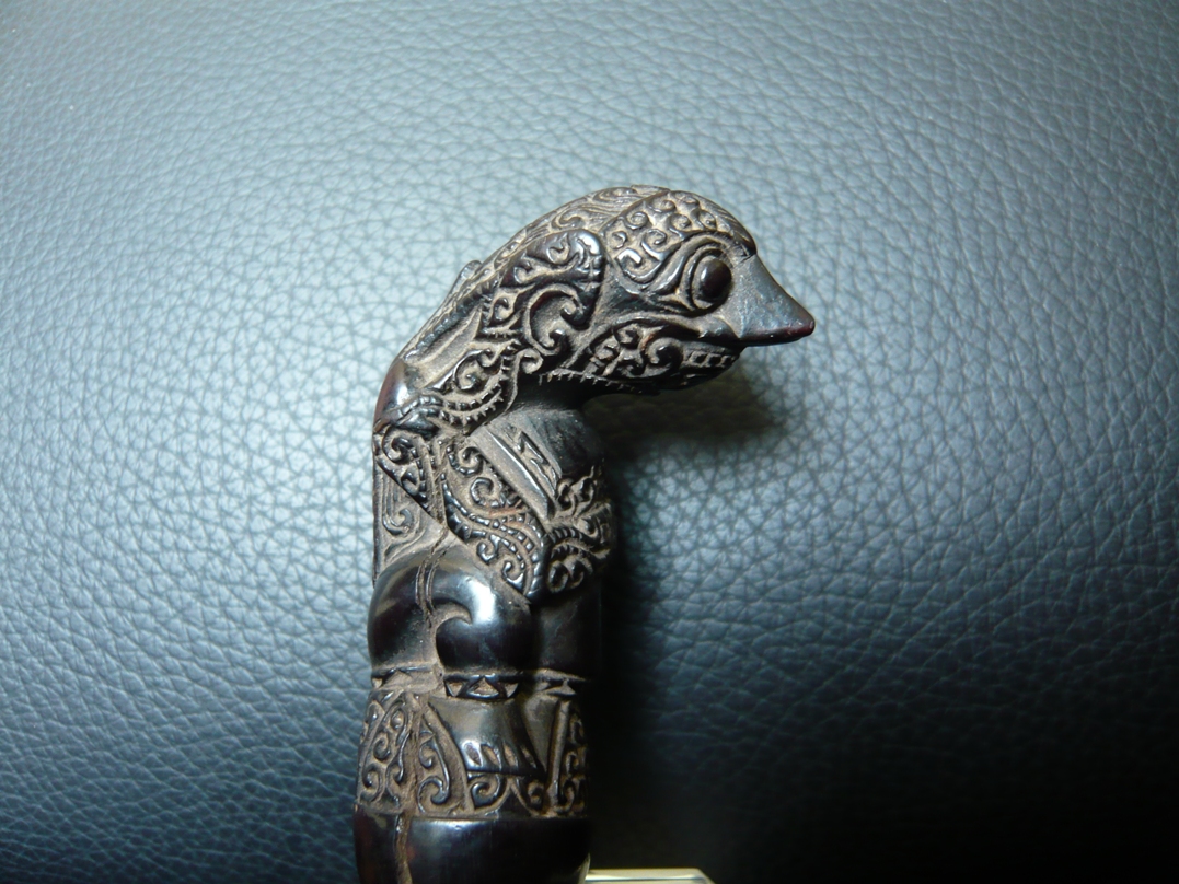

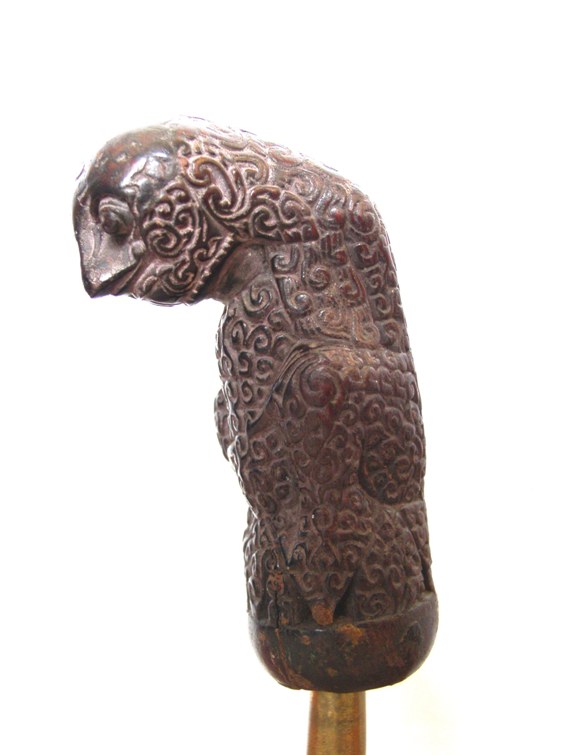

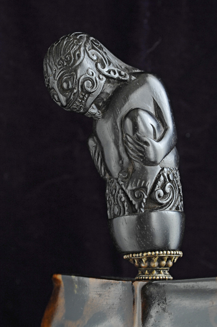

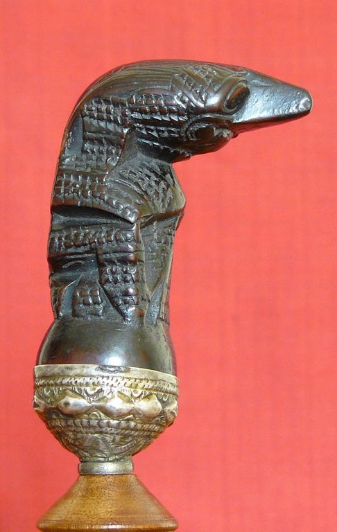

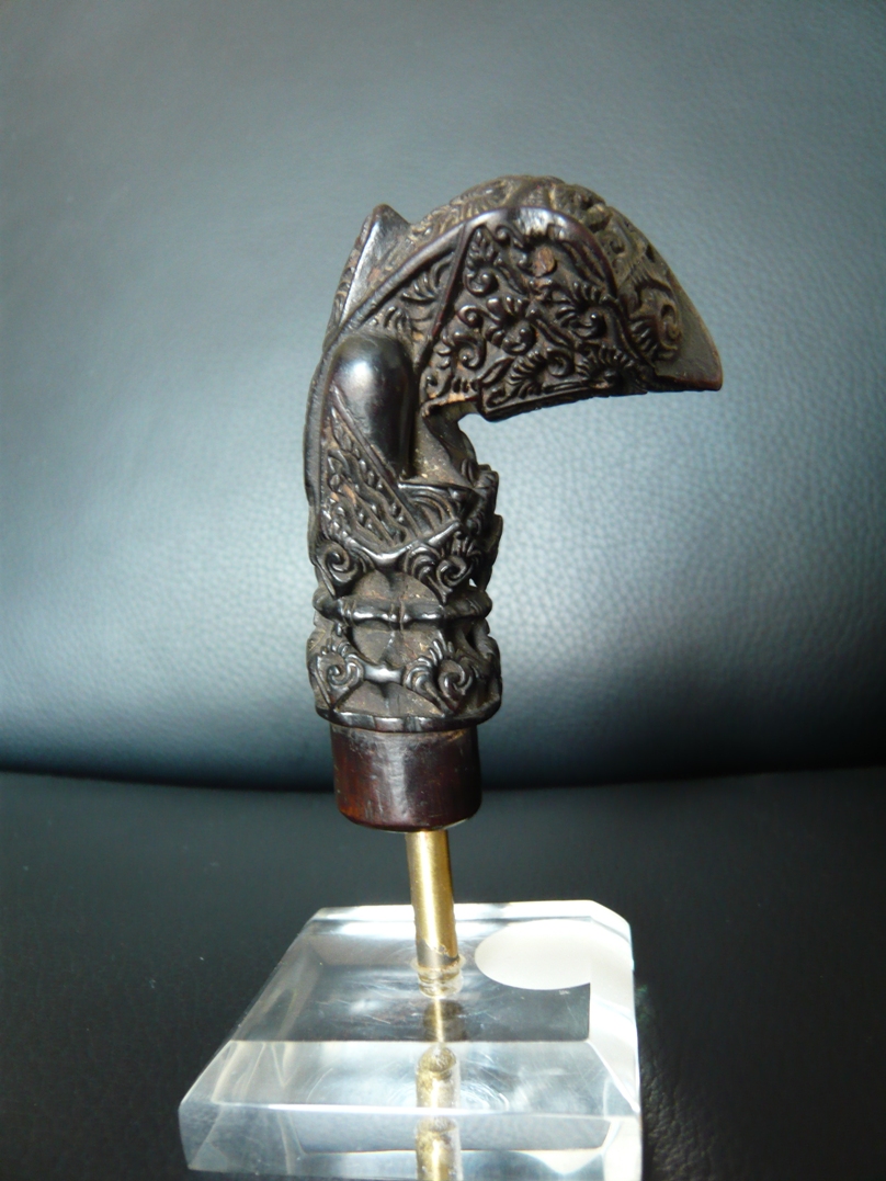

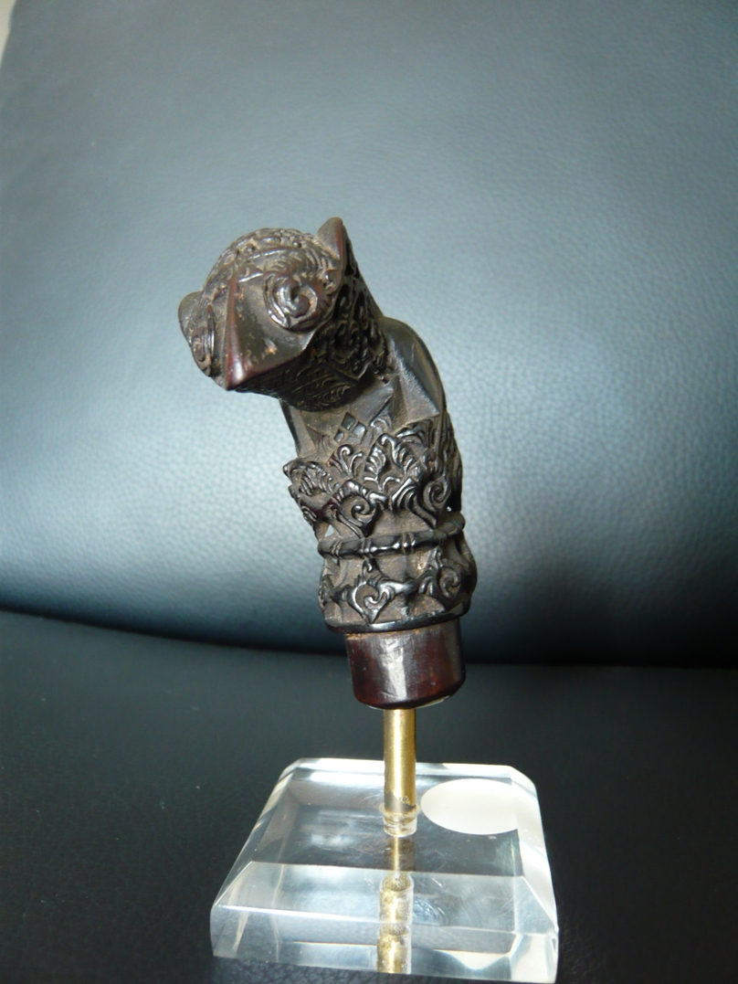

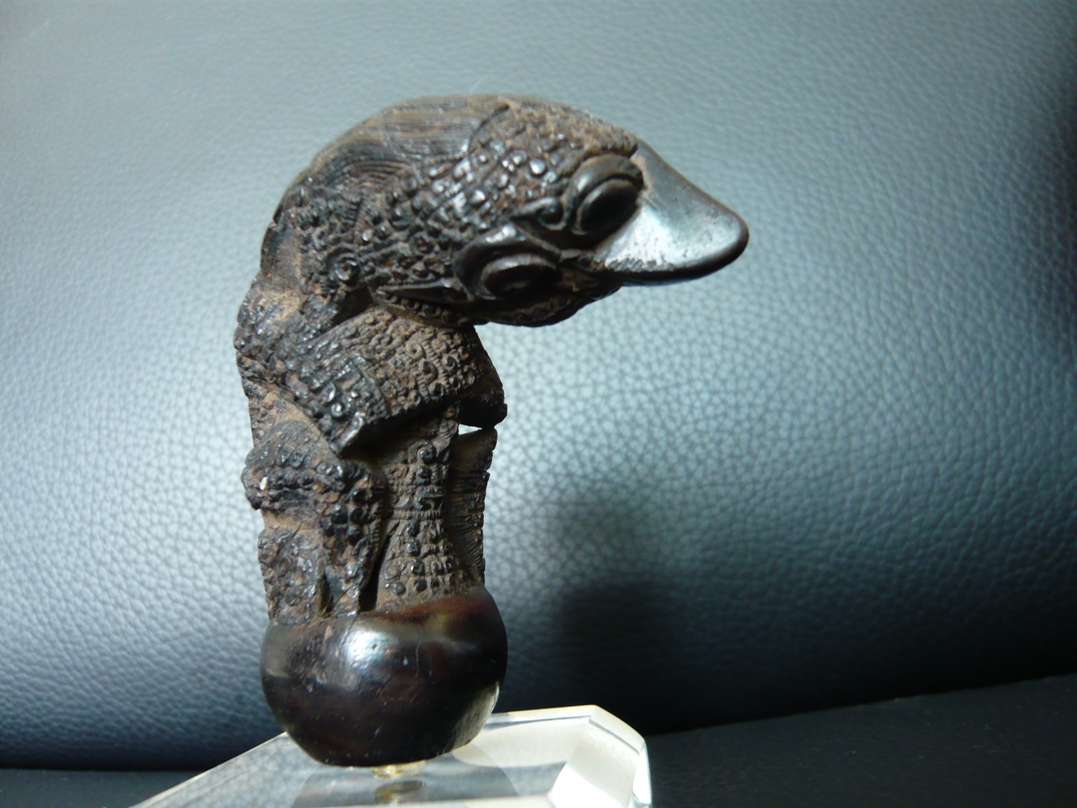

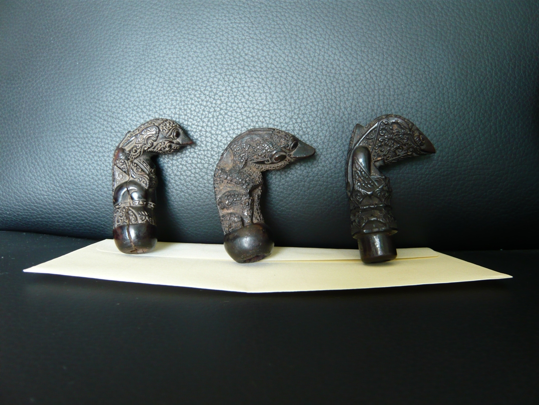

These 3 hilts were brought here by a runner. Interestingly, all 3 are different forms from the North Coast of Java. 2 of them have forms linked to the Jawa Demam form seen in Sumatra and the Peninsula. The interesting one is the rashaksa-type hilt with the Jawa Demam posture of one arm wrapped across the other, holding onto a piece of fabric/cover(?)
Old 27th November 2010, 03:02 AM   #2
BluErf
BluErf's Avatar
Location: Singapore
Posts: 1,180

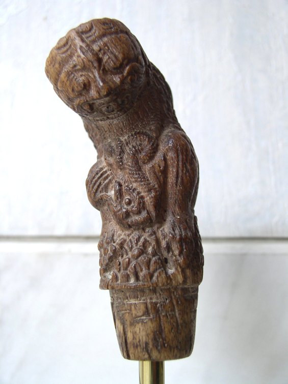

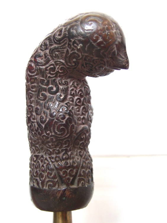

The rashaksa-type with Jawa Demam posture
Old 27th November 2010, 03:05 AM   #3
BluErf
BluErf's Avatar
Location: Singapore
Posts: 1,180

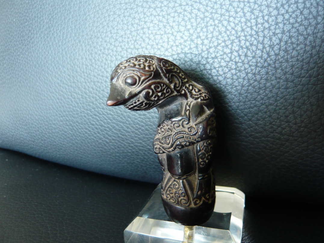

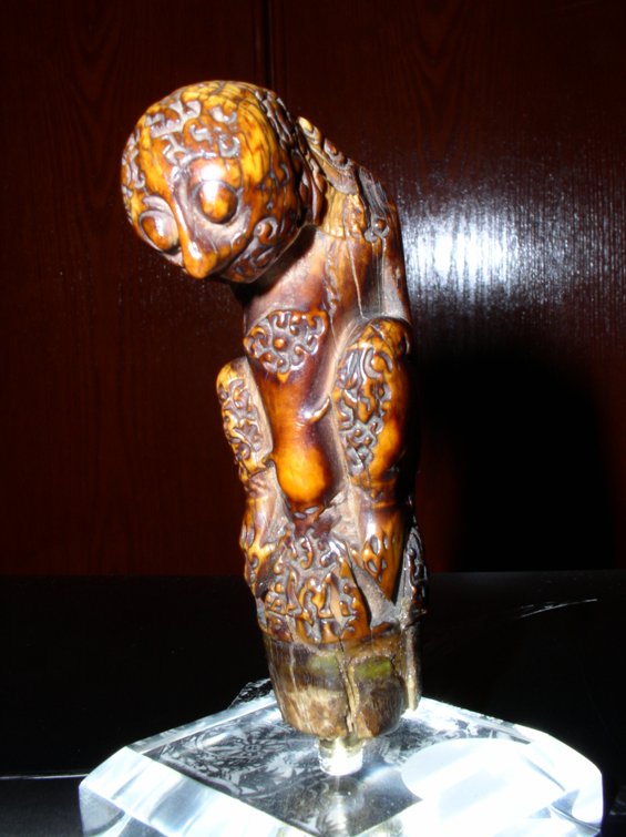

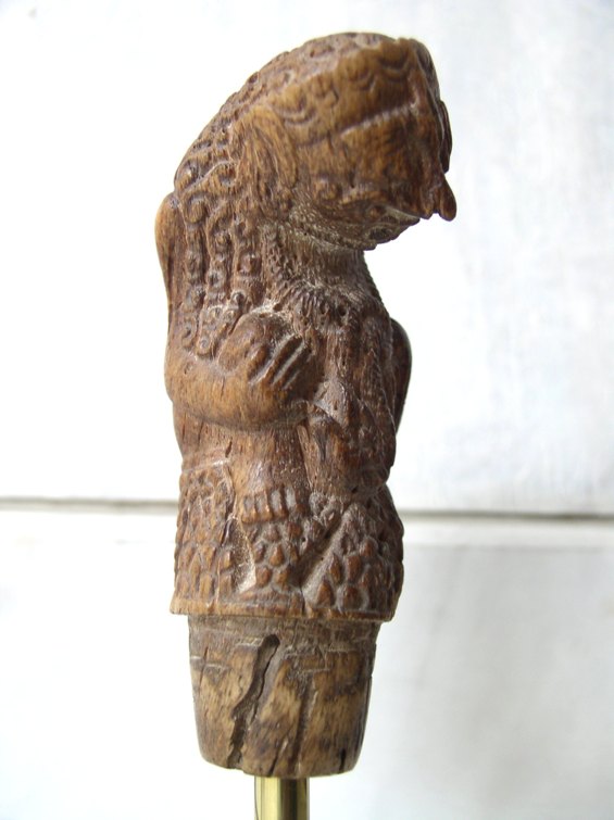

Rashaksa-type with arms crossed over the chest and covered in 'c' motifs. I thought there is a variant of this from Palembang too, but I cannot recall where I saw it, and what the differences are.

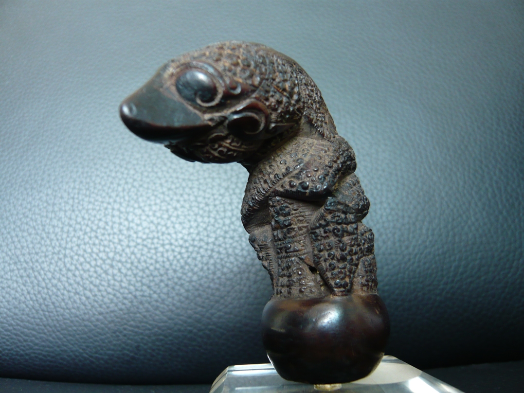

Old 27th November 2010, 03:07 AM   #4
BluErf
BluErf's Avatar
Location: Singapore
Posts: 1,180

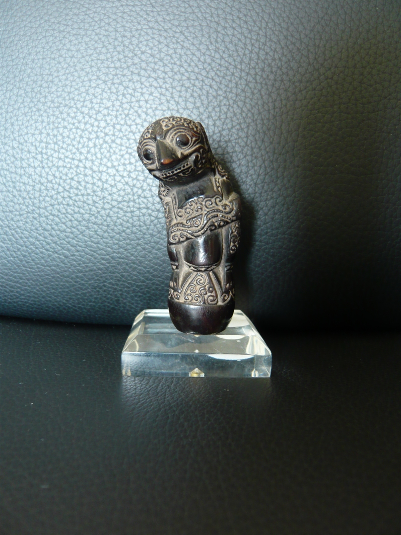

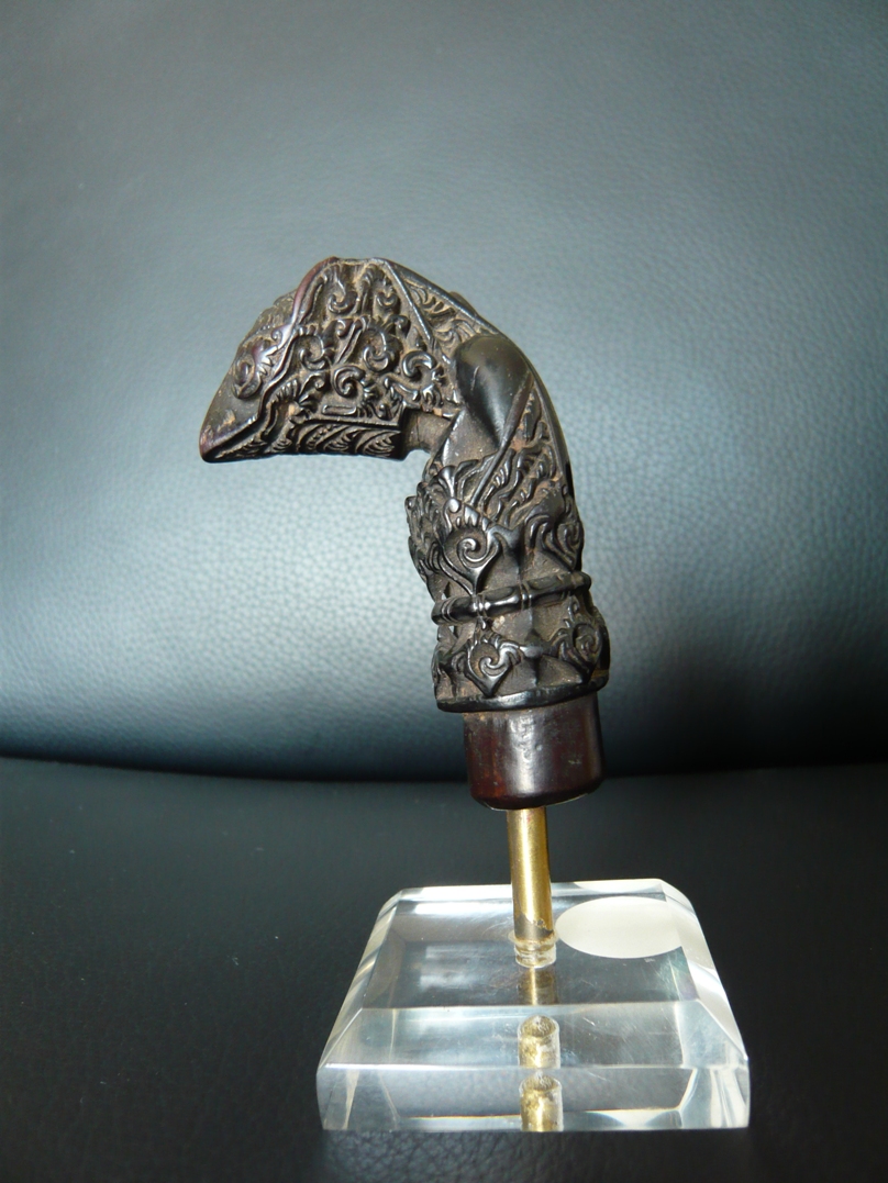

The Jawa Demam type, most abstract amongst the 3, and the closest to the Malay/Sumatran Jawa Demam.

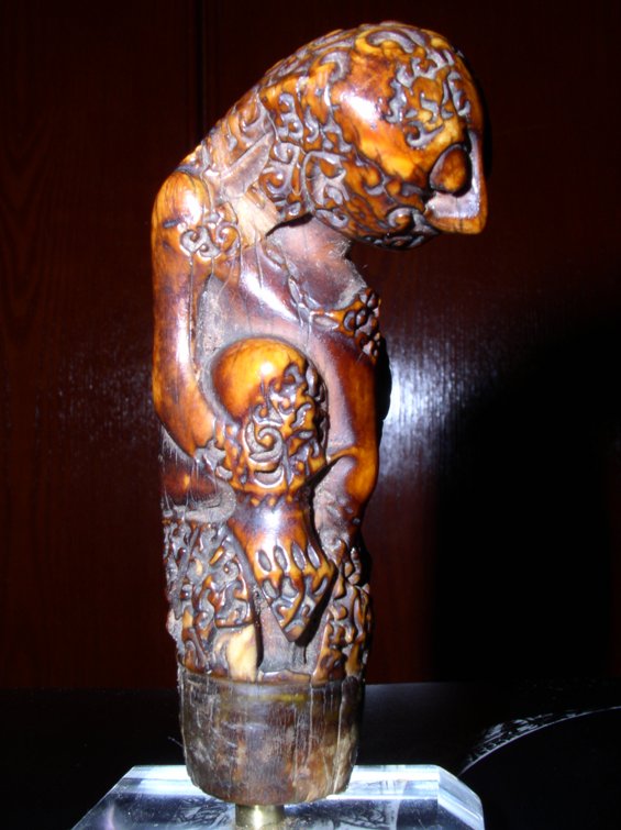

Old 27th November 2010, 03:11 AM   #5
BluErf
BluErf's Avatar
Location: Singapore
Posts: 1,180
Also, some people think the rashaksa type hilt, esp like hilts 1 and 2, could be depicting Garuda, because of the prominent nose/beak. And Garuda was described in some old texts as a man with bird-like features. I thought there could be such a possibility. If carvers want to depict a divine figure, why not a major deity, instead of a generic rashaksa/giant?
Old 27th November 2010, 03:19 AM   #6
BluErf
BluErf's Avatar
Location: Singapore
Posts: 1,180

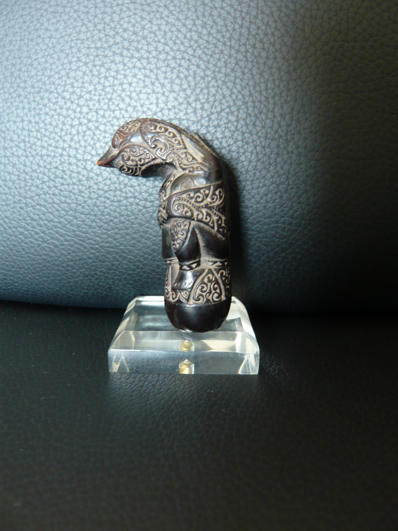

More suspected Garuda hilts

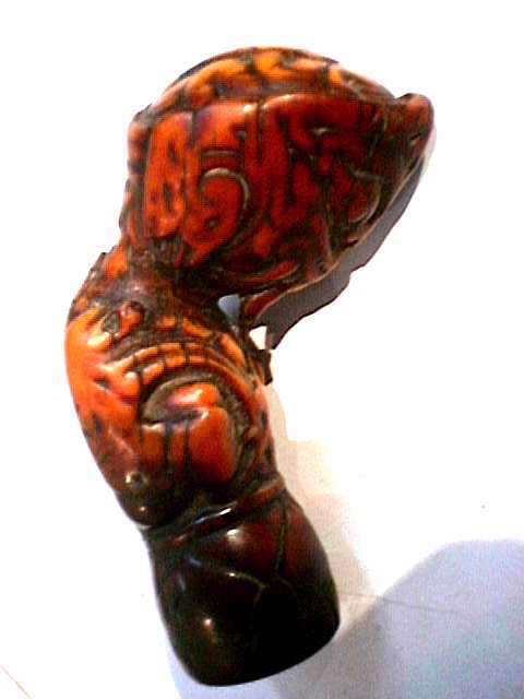

Old 27th November 2010, 03:20 AM   #7
BluErf
BluErf's Avatar
Location: Singapore
Posts: 1,180

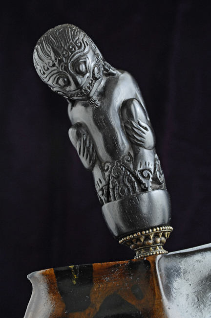

Deer horn Garuda(?)

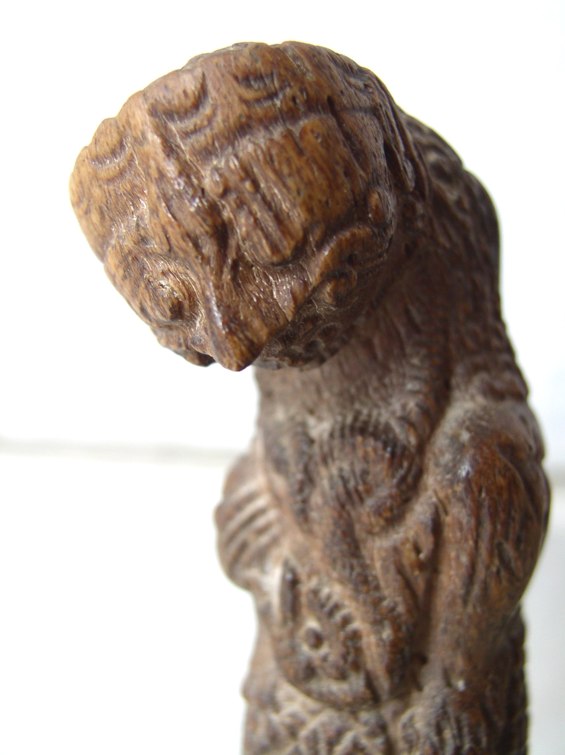

Old ivory one.
Old 27th November 2010, 08:28 PM   #9
Posts: 7,302

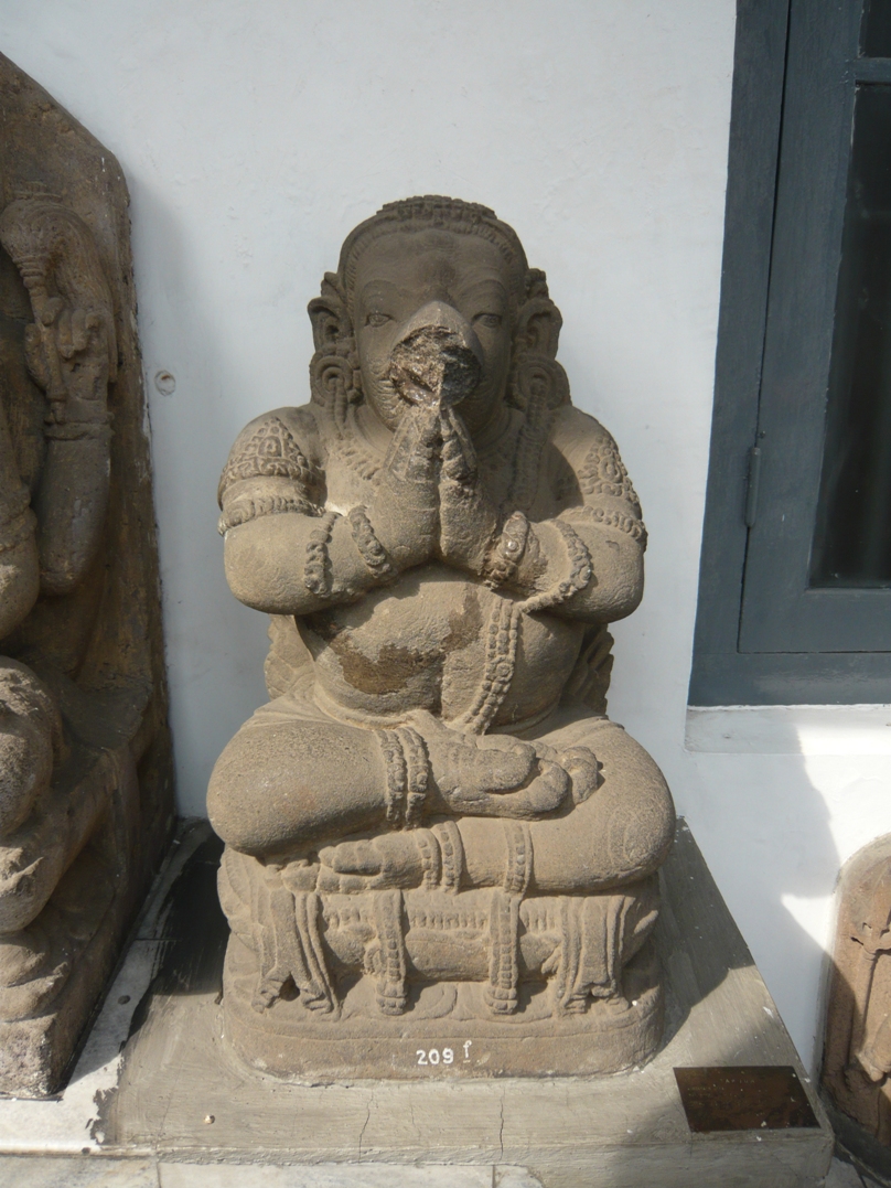

Nice hilts Kai Wee. I am not prepared to argue either way if this figure is meant to be garuda or not, but i do feel fairly certain that this example of mine is meant to be the very same character as the last few you have shown yet the nose is not nearly as prominent as to be described as a beak.
They also lack what seems to be included in most depictions of garuda that i have seen, some kind of wings, either obvious or stylized.

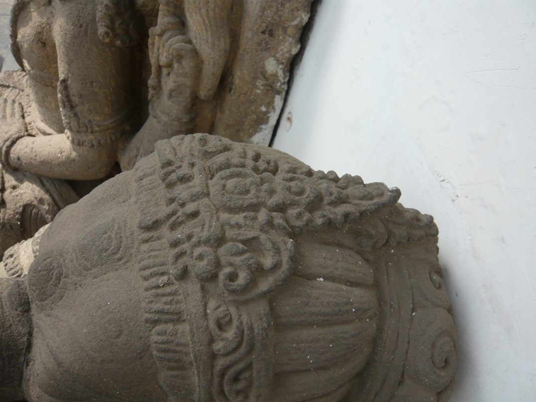

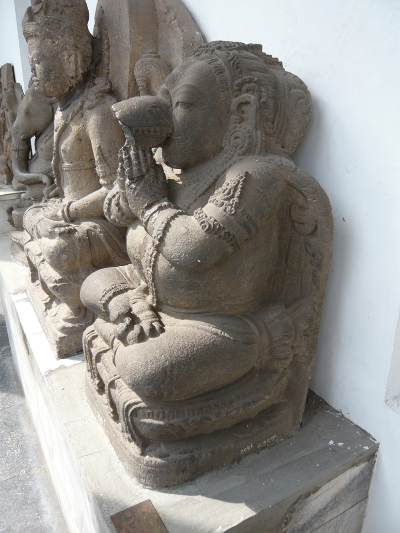

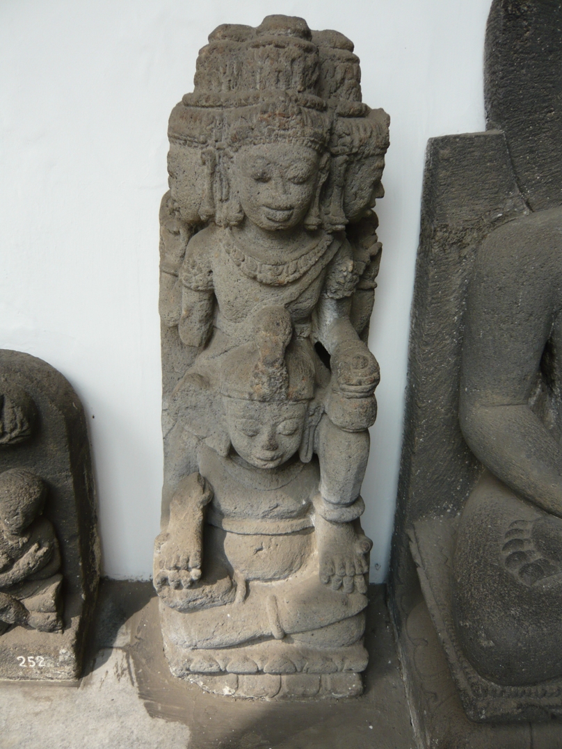

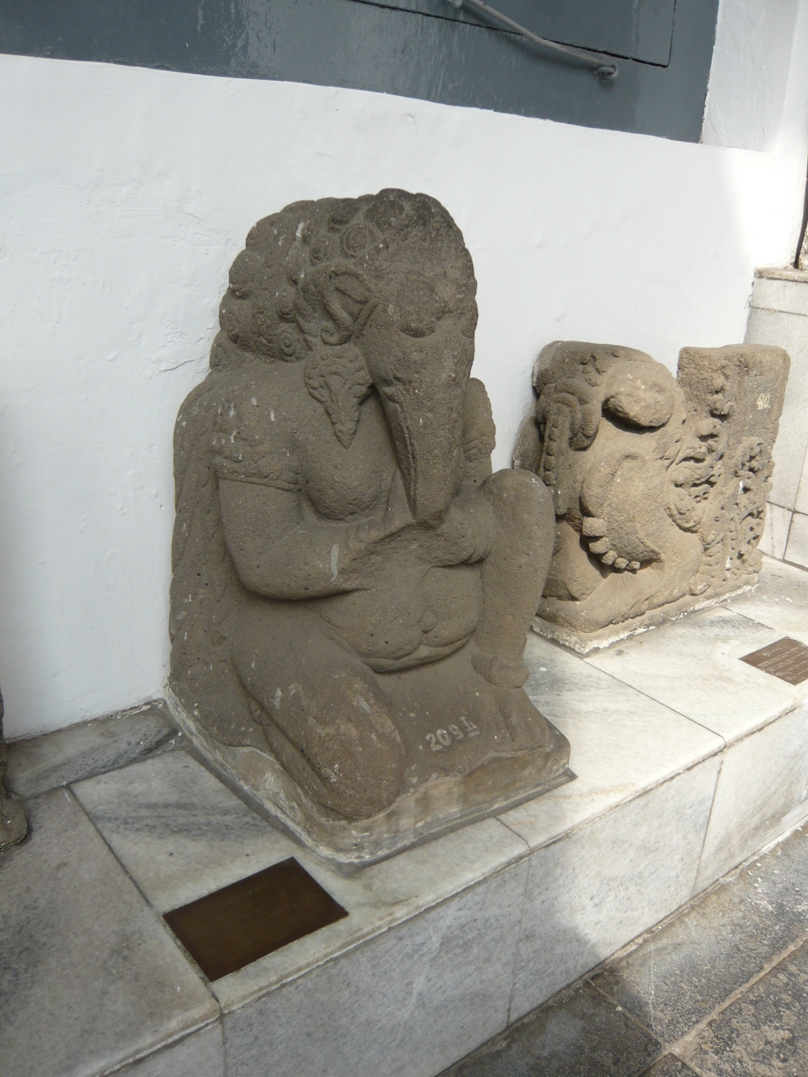

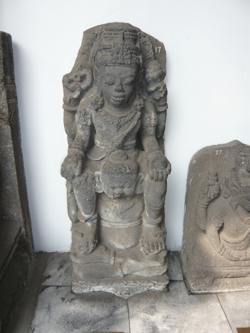

Which is where these pictures of statues in Jkt's National Museum comes in handy...

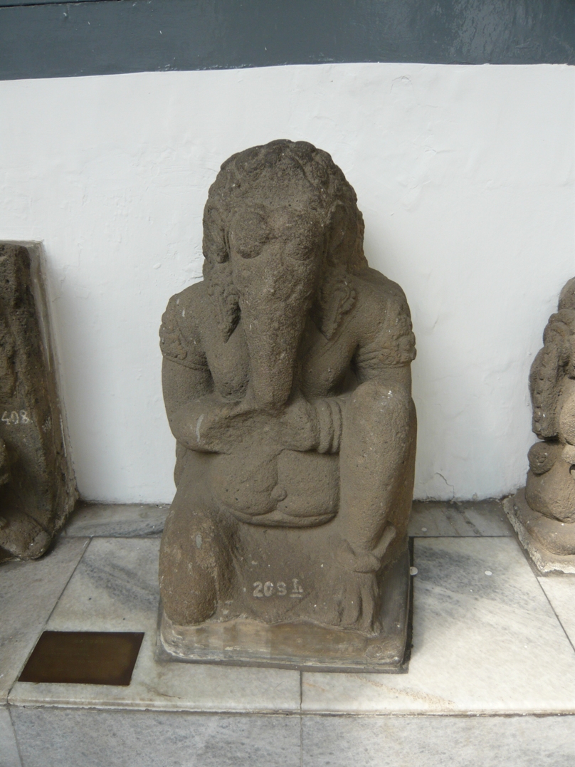

Old 28th November 2010, 12:38 AM   #11
BluErf
BluErf's Avatar
Location: Singapore
Posts: 1,180
2 more.

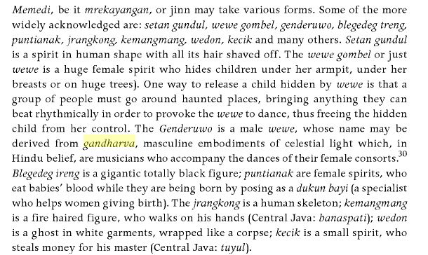

tunggulametung
Join Date: Jan 2007
Posts: 238
This always an interesting subject, but I think not as simple.
Other than Garuda, Bhima or Yaksha, Gandharva and Vanaspati seems to be other figure worth to mention (the last two are quite popular in Javanese tale). When relate further north (Sumatra/Peninsula Malaysia), as well as Bugis hilt, I sometime thought they depict Islam influence (salah/sholat position like ruku etc) as Islam seems to spread quite early in these areas. Probably also Western/handgun influence although I'm not sure how early it was seen by people in Nusantara.
tunggulametung is offline   Reply With Quote
Hello BluErf,
According to my references, this type of hilt is said to originate from South Sumatra and not North Java (of course I can't guarantee that this is correct), you can find a similar specimen on page 112 of my hilt book.
Best regards

Old 28th November 2010, 03:58 PM   #14
Hello Kai Wee,
all hilts are very nice and good photographed. The last one from post #1 is clearly from Cirebon/north coast Java (look attached picture).
By the second one I am with you, I've heard that this type of hilt is found in Cirebon and Palembang too but I am not able to differentiate them. I have four hilts of this type in my own collection. And I am with you also that the "c" carving is normally a sign for Cirebon. If you want I can take pictures of my hilts for comparison.
The first hilt is the most interesting one. It have features of the Cirebon rashaksa hilts and also of the jawa demon hilts so it may a connector between both types.
I am also like David not prepared to argue either way if this figure is meant to be garuda or not.

Well Kai Wee, i see what very well may be a representation of wings in a few of the statues you posted. Others are not positioned to be able to tell. If these hilts in question showed some kind of stylized wings it would definitely reinforce the notion that they might represent Garuda, but they do not so it is still an open question in my book.

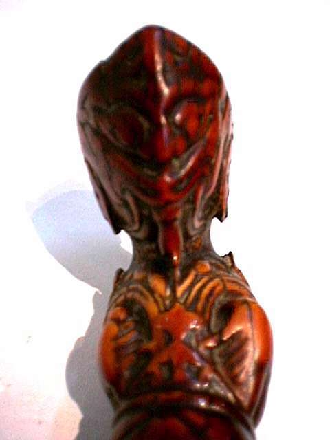

tunggulametung
Join Date: Jan 2007
Posts: 238
I found this beautiful hulu picture while browsing for "pipit teleng" and thought that it will be good to add to this thread. Thank you to kerisarchipelago.150m.com for the informative website.

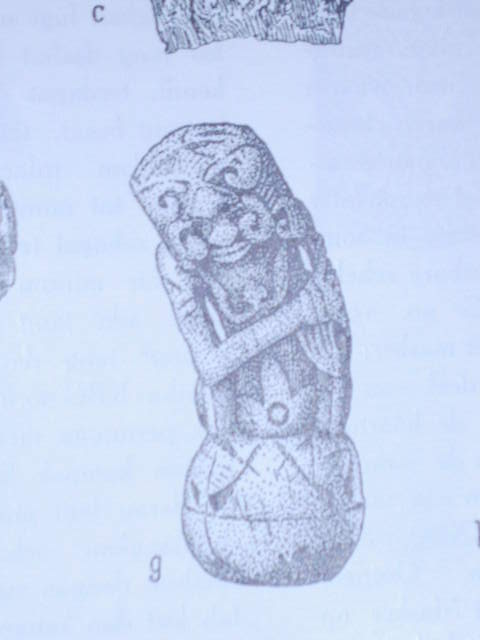

Ah, Dave's 'missing link' hilt. But one thing that's not consistent with the modern Jawa Demam is that it's posture is not one arm hugging the other, and though the face is looking downwards, it doesn't have a pointy garuda mungkur at the back of the head...

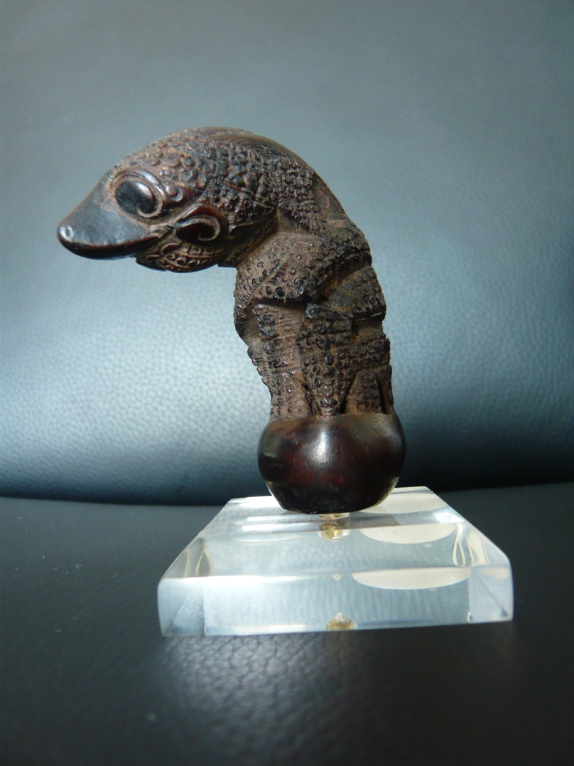

Old 12th December 2010, 11:36 PM   #24
Gustav
Join Date: Jun 2009
Posts: 1,346
Another possibility of a "missing link".

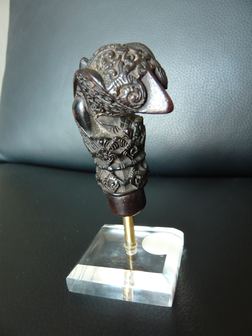

Old 12th December 2010, 11:42 PM   #25
Gustav
Join Date: Jun 2009
Posts: 1,346
Here we have another possibility of a "missing link". In van der Hoop's trilingual book "Indonesian ornamental design" from 1949 (which still now is a reference book) on page 99 there is a depiction of a hilt, he writes: Ditto (which means ivory in this case), Middle Java: KBG no. 22900 ( museum of Koninklijk Bataviaasch Genootschap). To my oppinion, this book is for its age very precize with descriptions.
Of course, it's just a 2-dimensional front picture of a Keris hilt. Interesting for me is the symbol on the belly of this figure - Lotus or Amerta (associated with Garuda), on similar place found also on some Bugis hilts?

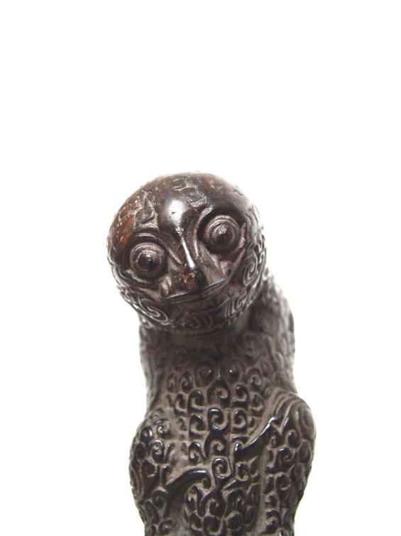

Old 21st December 2010, 10:28 AM   #26
Jean

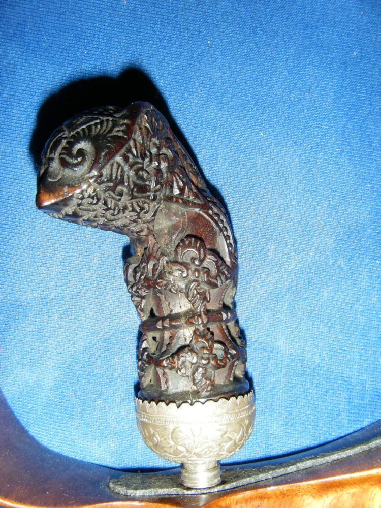

Join Date: Jun 2009
Posts: 1,740
Originally Posted by Jean
Hello BluErf,
Best regards
Jean

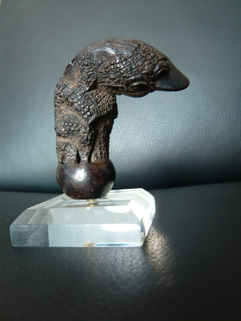

I found a reference of a very similar hilt described in Jensen's Krisdisk (Chapter 9.2, , page 2, figure 148 and Chapter 9.1, page 3, figure 123b). The hilt is and part of a kris dating from the 17th century and in the Dresden Museum collection, and Jensen depicts it as Garuda and attributes it to Palembang/ Lampung area. Sorry I can' post a picture due to copyright.
I attach a picture of my hilt for comparison.
Best regards
Jean

Originally Posted by David
Yes, but what does Jensen base his assumption of this being Garuda on exactly?
Hello David,
My point was mainly to confirm that these hilts are probably from South Sumatran origin.
Unfortunately our friend Karsten Sejr Jensen is no longer with us for supporting his opinion that these hilts (which he calls the naturalistic Garuda hilts) represent Garuda but I will summarize what he says about it in chapter 9.1 of his Krisdisk:
Quote: The main part of the hilts from Sumatra represents Garuda.
The early Palembang/ Lampung hilts have some relationship to the Raksasa hilts from Banten or Cirebon. Now the hilts do not represent a Raksasa but a Garuda bird, the mount of the God Vishnu. But its squatting position indicates that he is an ancestor, too. Unquote
He gives 3 interpretations for supporting that these hilts represent Garuda:
1. The Kings of Srivijaya (now Palembang) used to worship the snakes as their ancestors and were known as the Lord of the Nagas/ snakes. The introduction of Garuda (the enemy of the Nagas) may be related to the conquest of Srivijaya by the Javanese during the 13th century as a symbol of the defeat of Srivijaya.
2. The cult of Vishnu may have taken over the area.
3. It may be connected to the introduction of Islam in the region, as Garuda seems to be a locally accepted figure by Islam.
I will not comment these interpretations but may be Alan or Chandra could voice their opinion.
Best regards
Jean
