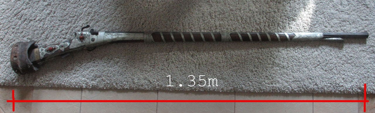

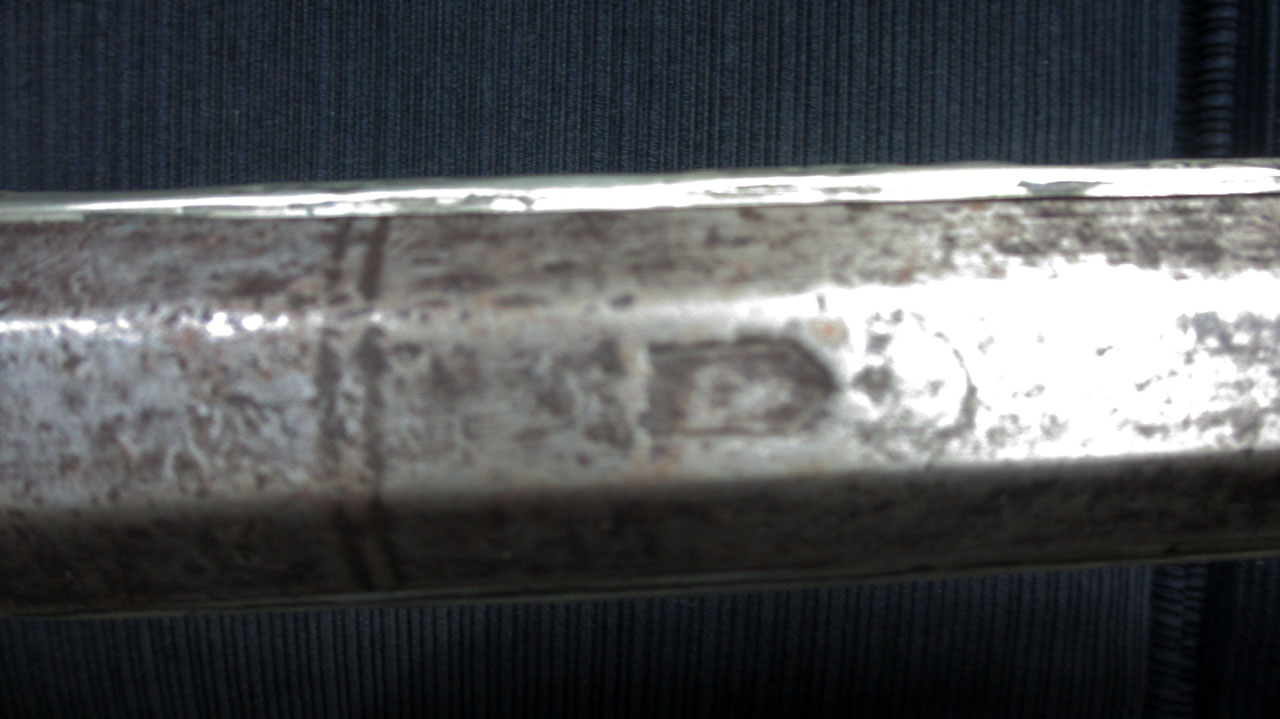

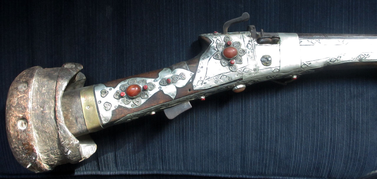

I have recently been given this matchlock. Told it was bought from a store in yemen. I would like to know more about its providence - age of the weapon, type of rifle, place of manufacture, is it an intact piece? Some images are posted including a barrel stamp

19th c. South Yemen
Hadramawt
May be the barrel from Persia, 18th c.
Beautiful piece!

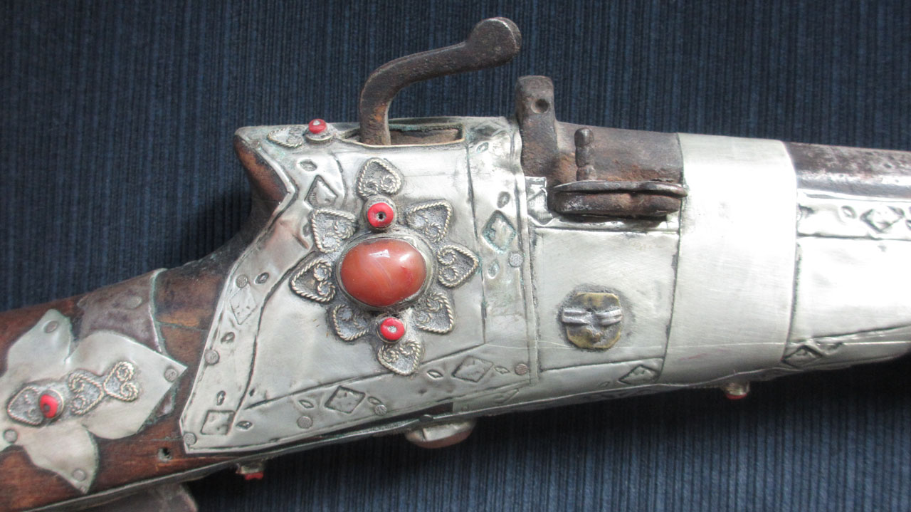

Yes, nice gun. Is the metal work silver, or aluminum? Looks like the latter to me. If so, more like mid 20th century. Or at least, decorated then.

Nice and interesting piece. I would say either silver or white metal. Testing by a jeweler would determine which. Aluminum wouldn't have any green patina.

Nice piece but IMHO the decoration is mid to late 20th century, and typical of Yemeni work. Likely white metal rather than silver. The matchlock gun could be older. I would call the style Indo/Arab, and agree that it probably originated from the Hadhramaut region.
It looks to be complete, though an old break in the stock is evident. The older piece of iron/steel band over the top of the comb of the stock is to strengthen the repair. The white metal decorated plate shows no damage and this is why I say that this decoration is a later (and more modern) addition. Also the wound banding down the barrel is not usual, and is likely to enhance "eye appeal" at point of sale.

I am interested in the actual gun type/make - if there is one associated with this piece, especially the makers mark on the top of the barrel - if anyone can shed some light on this?
If this piece is from a yemen/arab origin - did they also make the base weapon? or could it have been made in europe and transported out to the far east for local sale?
Many Thanks
