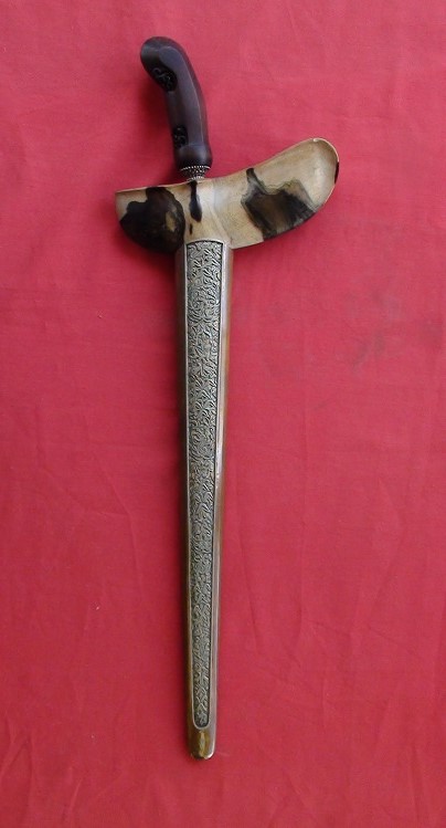

Originally Posted by semar
keris java
thank you David
ho can tel me more about this dapur and i think the tangu of this keris wil be pinggi ???????
reagars semar

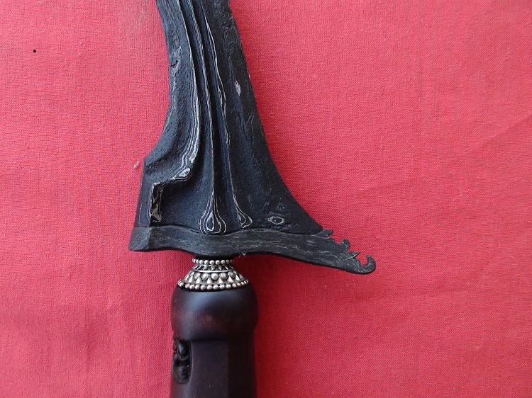

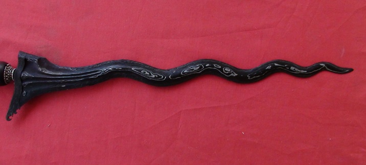

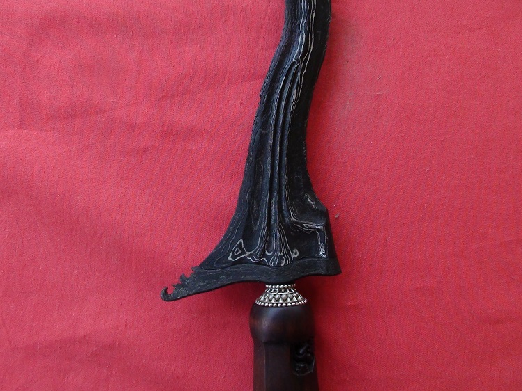

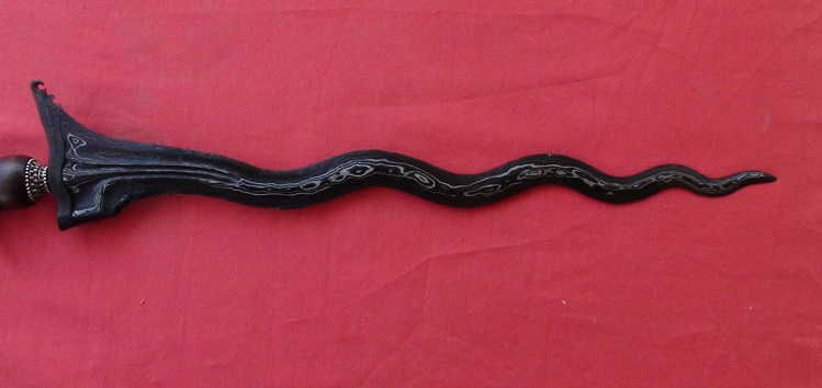

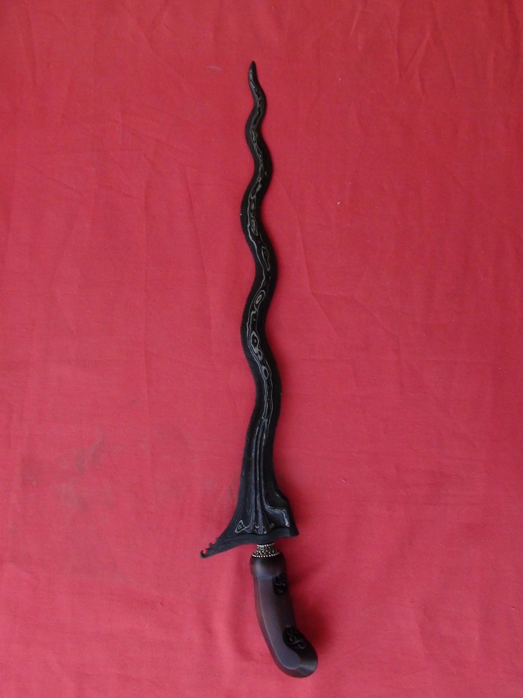

thank you David
reagars semar
Hello Semar,
Your blade with 9 deep luk has the following ricikan: pejetan, tikel alis, sogokan, sraweyan, greneng, ganja dhungkul, and ada-ada? It does not match with any standard dapur from Central Java. The pamor pattern is Beras Wutah?
The style of the blade may be seen as Pengging because of the deep luks but this is not sufficient to attribute it to tangguh Pengging.
A nice blade anyway.

Posts: 7,255
Pengging is a very, very scarce tangguh, not many people would ever have seen a keris of Pengging tangguh.
Yes, the luk in a Pengging keris are very steep, deep luk, but they are also very different to the luk in all other keris.
Personally, I cannot agree that the luk form of this keris is anything like the luk form of a Pengging keris.
I think perhaps that ganja kelap lintah might be a little closer to the mark?
One of the major distinguishing features of the Pengging style of keris is that it has a very long wadidang with a very deep curve, this results in a very long gulu meled. The blade cross section is rounded like rotan, the blumbangan is boto rubu.
I'm sorry, but to me, this keris does not even remotely resemble a Pengging keris.

Posts: 7,255
Yeah, as usual Jean, there is a whole heap of stuff attached to this tangguh business that doesn't come through into broad understanding; I only gave a couple of the Pengging indicators, in fact, there are 13 that I have a note of.
I can see why you'd think that maybe this blade could bear some similarity to Pengging, and maybe that's what the maker was shooting for, because all he had to go on was the common description, but he'd never seen one either.
I've got one Pengging keris, and its just plain weird. I've only seen maybe one other --- I say "maybe" because I cannot remember if I've seen two that were attributed to Pengging, and if there was some sort of agreement that either were Pengging. In fact, the Pengging keris that I have is a very poor quality keris, but it does bear the salient features that permit it to be classified as Pengging.
No, I'm not aligning the ganja form with any classification. They do seem to crop up more on East Jawa keris, but you can find them on just about any later keris I believe.
All I'm saying is that the form is kelap lintah. Have a look at Ensiklopedi P. 167.
Pengging is an interesting classification, because it was never a kingdom, it was only maybe a kabupaten, it was set up by a noble from Majapahit, Adipati Handayaningrat, who was the grandfather of Sultan Hadiwijoyo of Pajang. This of course makes all the later rulers of Central Jawa, right through to today, descendants of Pengging (through the female line). The area even today has a strong spiritual element, it is located in Banyudono about 8 or 10 kilometers west of Adi Sumarmo airport. Interestingly Yosodipuro is buried there.

Posts: 7,255
Based upon what I believe I can see in the photograph I am of the opinion that this keris is tangguh Kemardikan.

Old 15th December 2014, 12:49 PM   #13
Posts: 7,255
Jean, look at the bottom of the ganja, the bottom being the part of the ganja that touches the base of the blade.
Now count from below the sirah cecak with the point of the keris in the down position.
The waves in Semar's ganja go down > up >down > up > down --this last "down" trailing into the greneng.
Now count Haryoguritno's waves in the same way, then count Harsrinuksmo's waves in the same way.
You will find that although each of these illustrations of ganjas look different, they are in fact the same.
Do the same exercise with the two totally different illustrations of ganja dhungkul. Once again you will find that they are the same.

Old 16th December 2014, 05:47 AM   #15
Posts: 7,302
OK gentlemen, that's enough...
Let's keep this discussion on the keris and keep it civil.
Frankly Semar, i also think your keris is Kemardikan.True, that is an opinion based on photographs while you have the keris in hand. But i believe i see some definite clues in the erosion of this blade that this keris has been artificially aged.
I must admit that, like Alan, i also question the practice of throwing a keris up on the boards that you believe you already know about without any indication of what you think you know just it to draw out the opinions of others....only to disagree with those opinions because they don't jive with what you think you already know. You would be better off saying all you think you know about the keris up front. It would appear more honest, more transparent. But i have noticed this is a general posting pattern for you. "Keris for Comment" or "Keris for Sharing" is a common thread title for you and rarely do you say any more about your posted item. I believe that Alan was perhaps rash to refer to you as a "troll". I certainly do not believe this is so. But frankly, your posts often appear to me more as advertisements than trolling. I do hope this isn't the case. I can tolerate a troll more than i can a merchant in the our little temple...
BTW, Alan's practice of not showing his personal keris on the forum is not that unusual, especially amongst the indigenous culture. I mostly adhere to the same principle (though i recently did post one of my new keris simply for complete lack of knowledge of the form). I will show a sheathed keris (always meant for public presentation as an object of dress), but usually choose not to show my blades. They are my children after all. Alan has been quite capable of imparting countless bits of valuable information about the keris and keris culture without having to violate his principle of not posting his keris in public places.
