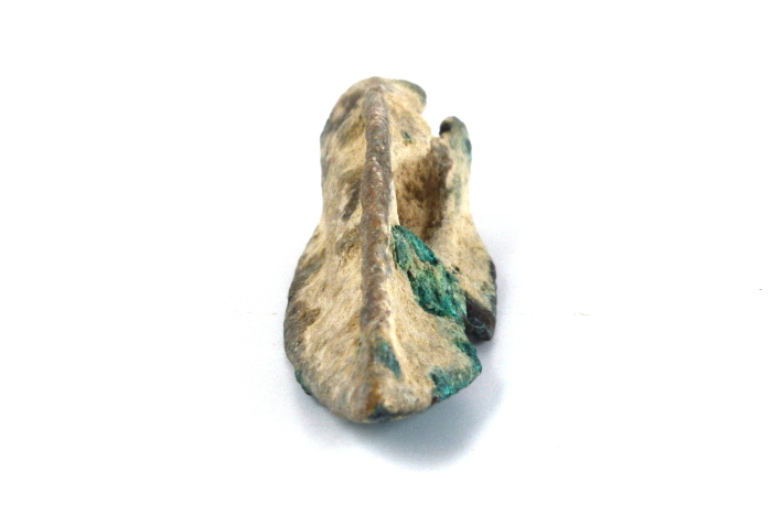

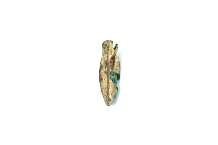

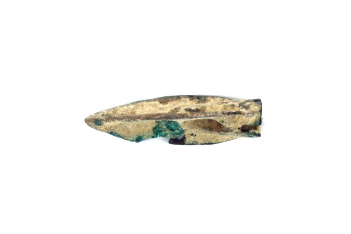

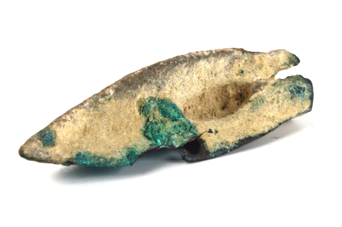

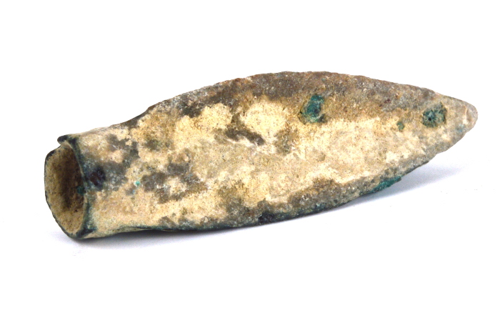

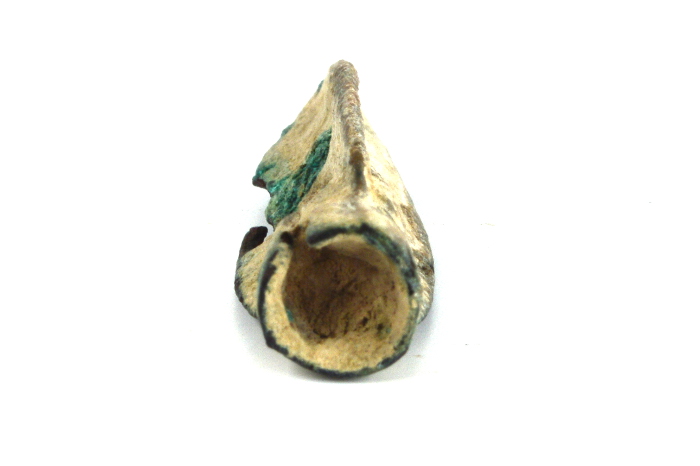

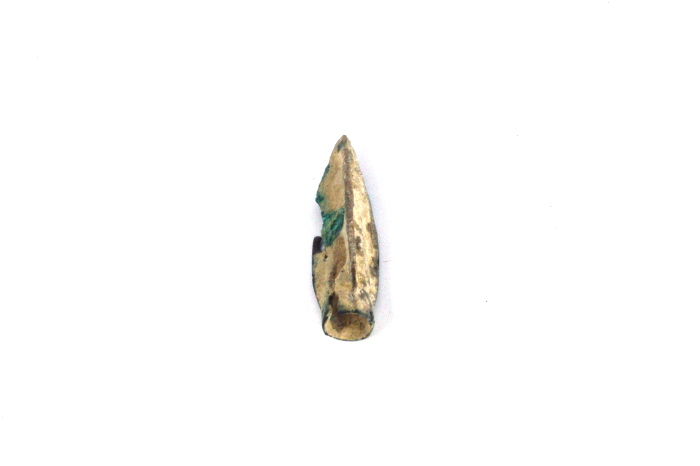

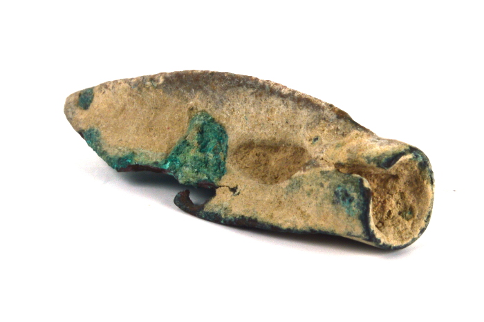

This small point appears to be made of copper. It was excavated in St. Augustine Florida. I have never seen anything like it, but it doesn't look Indian (Native American) to me. Could it be Spanish? Maybe a bolt for something like a small fowl hunting crossbow?
1.23", 31.242mm
.345", 8.763mm
.27" dia, 6.858mm dia
1/8oz, 3.5g
The photos are copyright (c) 2014 by Dana K. Williams

Hi Dana
I take it that you are sure that this bronze piece was excavated in Florida.

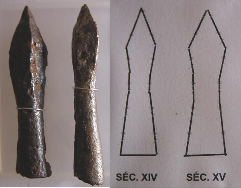

Judging by its forms and patina, i woud presume it is way (extremely?) older than the Spanish arrival in America. Bolts from the 14-16th century didn't have such smooth (harmoneous) lines and were usualy made of iron ... and would hardly have such fantastic patina.
If it weren't for the Florida provenance, i would within my ignorance guess that this would be an object of the bronze age ... you know, the (so often faked) Luristan type of stuff.

Originally Posted by fernando
Hi Dana
If it weren't for the Florida provenance, i would within my ignorance guess that this would be an object of the bronze age ... you know, the Luristan type of stuff.
But i am just playing the smart
You are so right Fernando, it is a puzzle. You never know were something really came from even if you find it yourself. A friend tells me he dug this up during the late 60s in St Augustine Florida. My father purchased it from him and it ended up in my collection.
There are Indian copper artifacts from North America, but it doesn't resemble any of those that I have found so far.

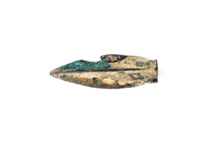

What this piece seems to resemble most are the 1st-3rd century bronze arrowheads made by the Romans and Greeks.

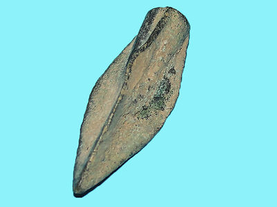

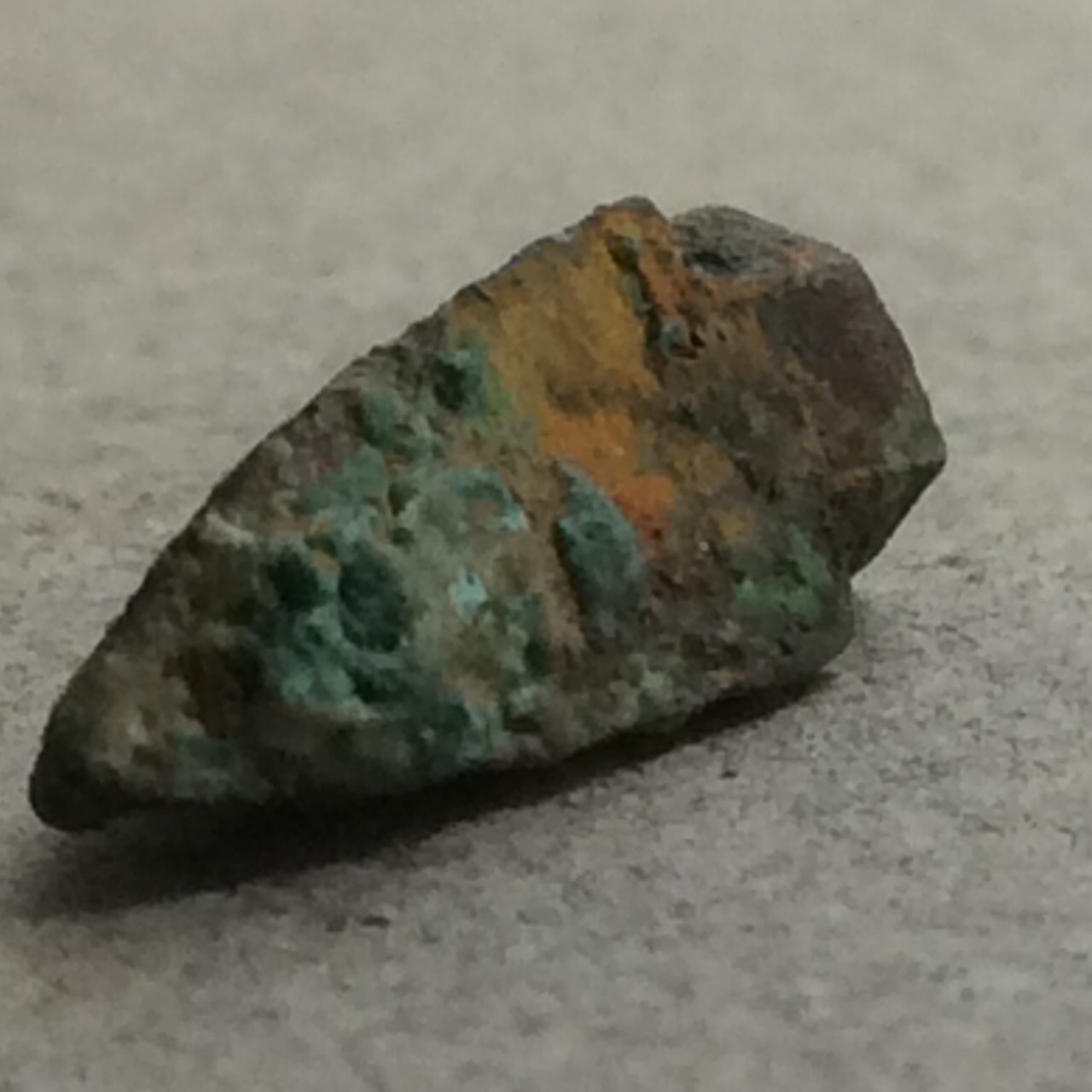

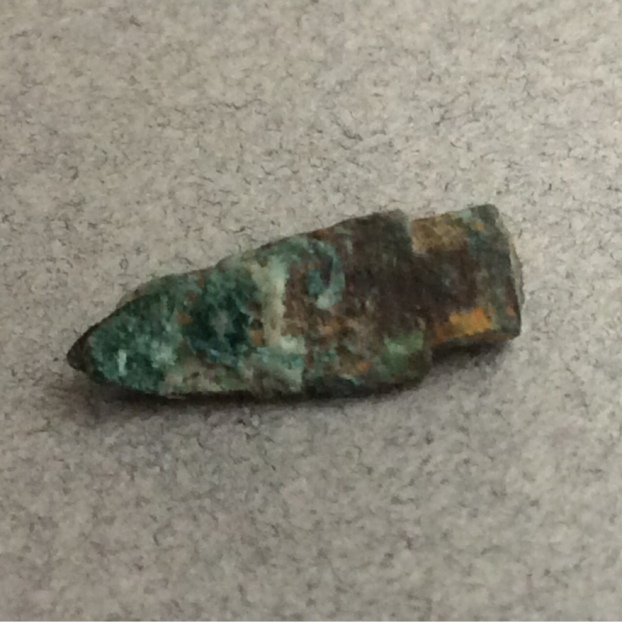

Here's a Bronze Age point from Chinese tomb sentinel I picked up in china.
Note the rough similarity to the St. Augustine bronze point.
I think a lot of Bronze Age and later bronze points have closely related forms due to parallel development. Similar weapons and utilitarian objects often develop independently but unrelated geographically or culturally.
The fact that form follows function will dictate this evolution, not to mention manufacture technique. The more complex an object becomes, the more room for deviation from simple function. An arrow point needs to be simple to mass produce. Mass production dictates uniformity. Once this is determined, a production method of one kind or another is chosen: cast, wrought, knapped, or other.

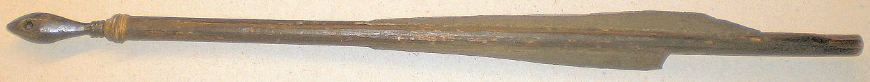

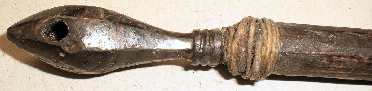

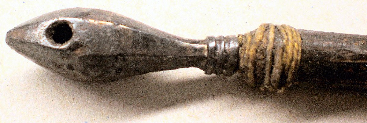

To me, though, it seems to be the head of a whistling crossbow bolt (German: Heulbolzen), or of an arrow for a bow:
http://www.google.de/imgres?imgurl=h...d=0CPwBEK0DMEY
The photos attached depict the only European whistling crossbow bolt known to be preserved completely, retaining its original haft; German, 14th-16th c.; it is in the private collection linked below.

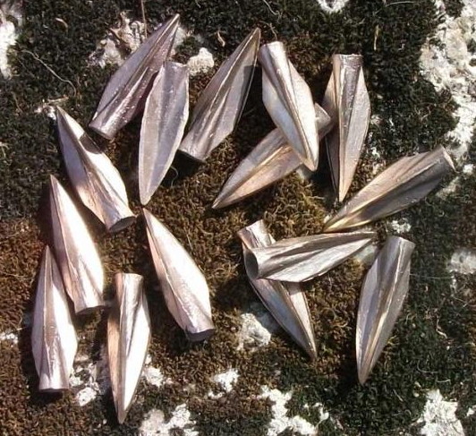

Old 1st October 2014, 11:21 AM   #9
here's what they look like new. i know a guy who casts these in the UK for re-enacters.
