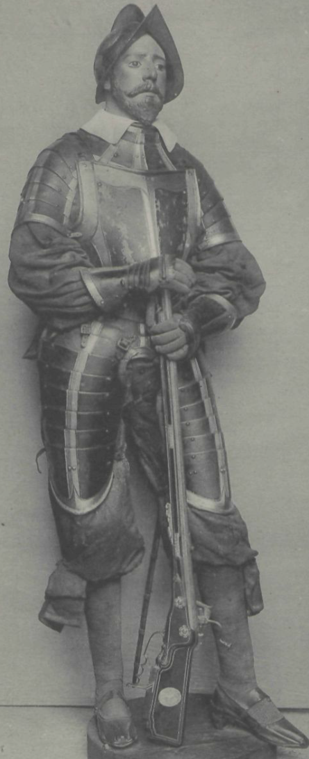

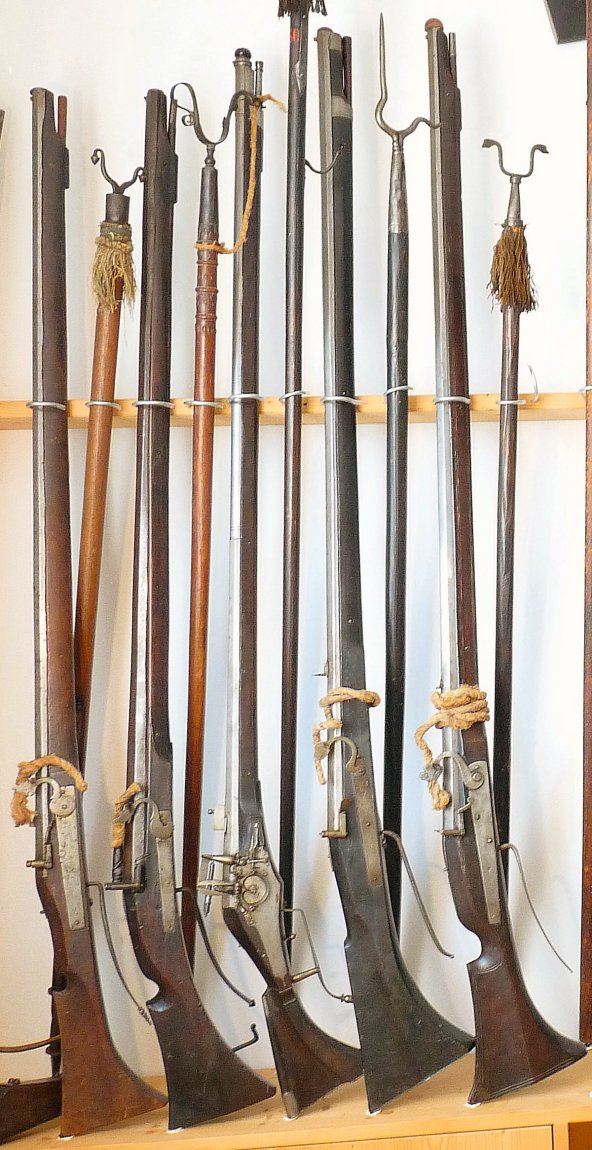

I have just posted a picture of an arcabucero of the period of King Felipe II of Spain and apparently this style was already light enough to support without a fork.
I hope Michael (Matchlock) comes around to give you a full and competent information on this subject.

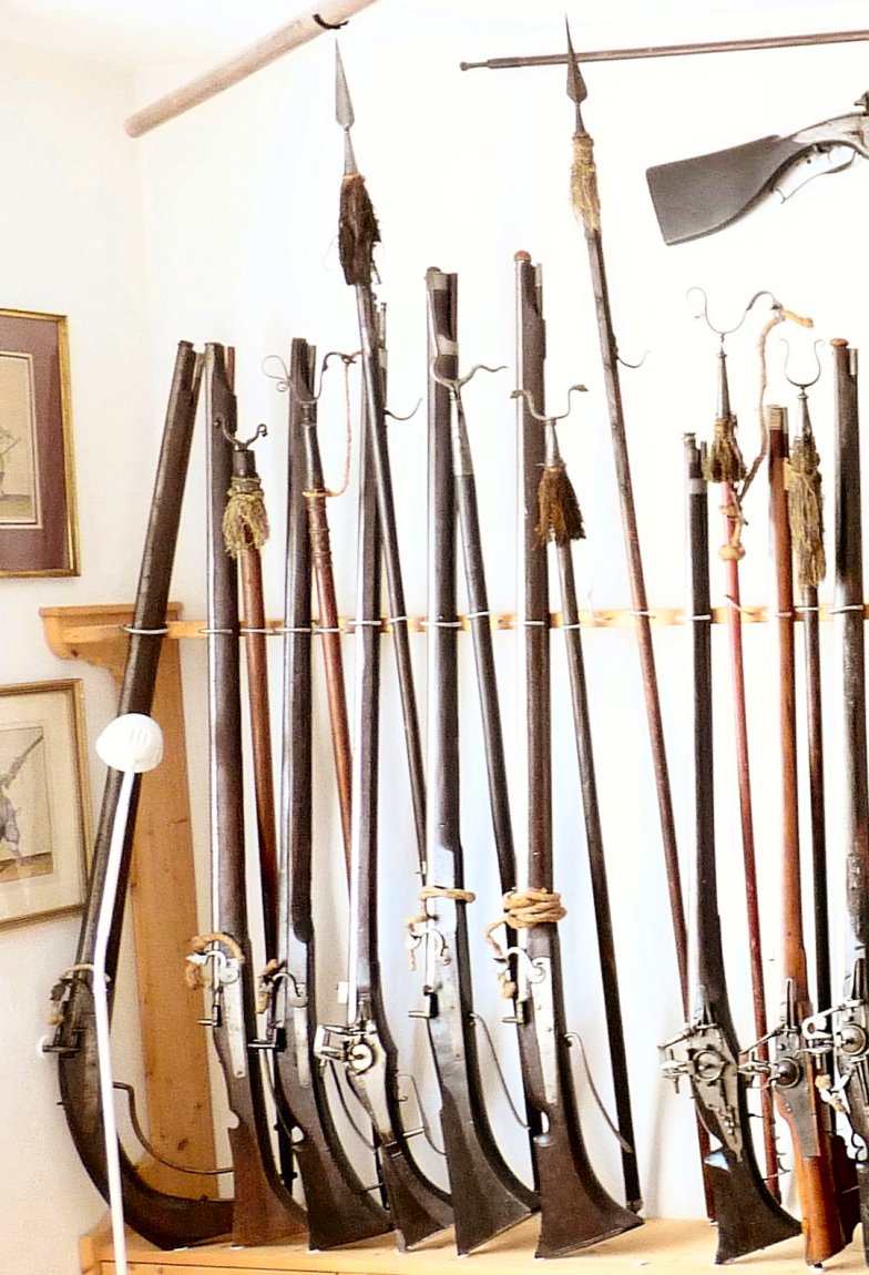

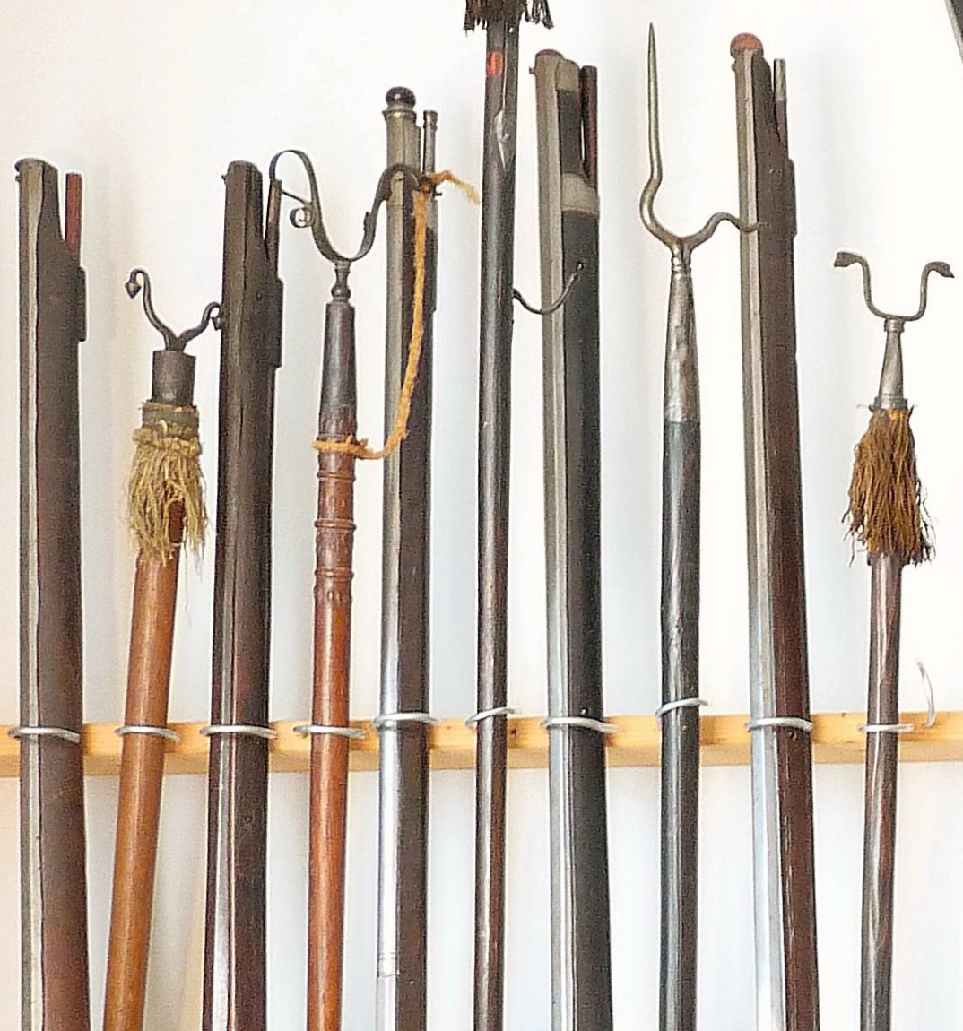

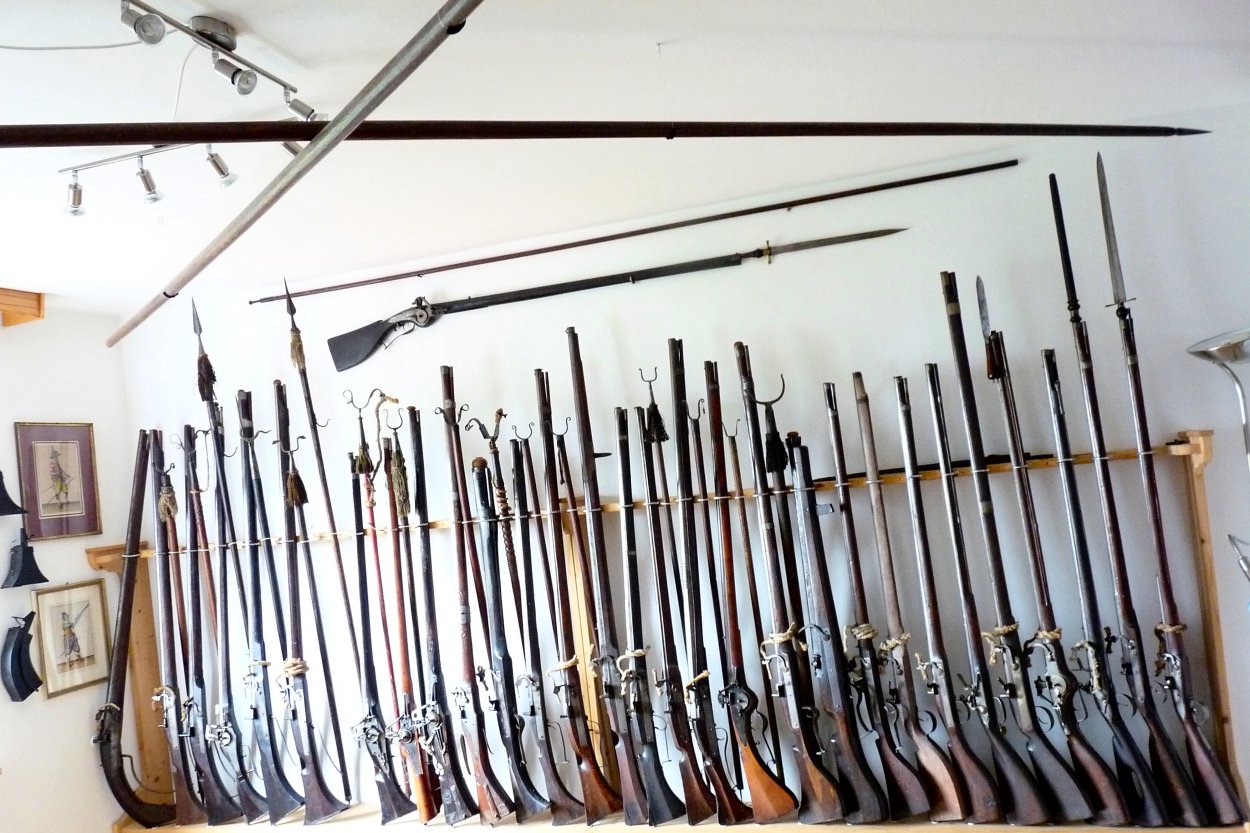

Without any doubt, they are an important contemporary proof of the upcoming of gun rests in the early 16th century, and their wider use by ca. 1530.
For more information on gun rests/forks, please see my new thread

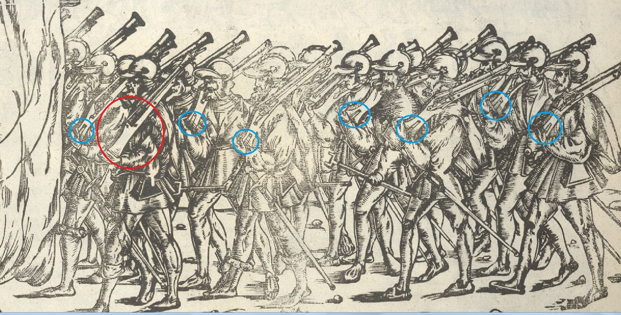

In Barcelona in 1529 over eight thousand [8270] troops embarked to accompany the emperor on his trip to Italy. We know from René Quatrefages - "La revolución militar moderna. El crisol español" / Modern Military Revolution, the Spanish melting pot - that among the shooters had "escopeteros" and "arcabuceros" or arquebusiers. For example, the company of Diego de Andrade, 279 soldiers, had 81 arquebusiers and escopeteros 27. The arcabucero charged more than the "escopetero".
I've been intrigued for years - no kidding - about the difference between escopetas and arquebuses, and assumed that the difference was calibers, but I also thought that there might be differences in the mechanisms triggering or in the material they were made: brass or iron.
The word "escopeta" is used in Spain regularly since 1508 - was previously used "espingarda" - and it seems the term was adopted in Italy from the word "schiopetta" but involving the same weapon. But clearly were different weapons, for two categories of soldiers resulted.
I add an image to display further details and questions. The arquebus red circle, has no key. Is it fired with fuse?
In the tails of the arquebuses with red circle you can see a piece. In the arquebuses of the German soldiers not appear

Sure, as it did not have a lock mechanism it had to be fired using either a fuse/match or an igniting iron.
As I said, and will show soon, those butts have a trap, a recess with a sliding wooden cover; it was NOT a "patchbox" but was used to keep small cleaning utensils, like a worm and scourer, and wadding for the load.
Please see an Italian arquebus of ca. 1525-30, with a butt trap on the underside of the buttstock in which the original cleaning tools are still preserved; in
