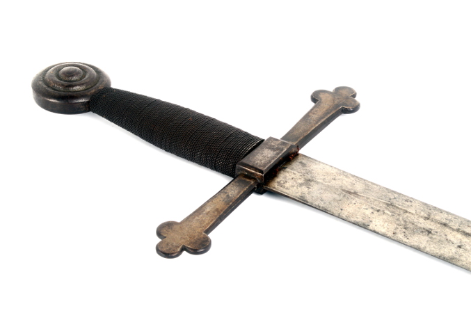

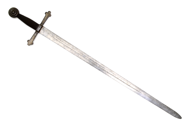

This medieval style sword is part of a weapons collection that my sister and I inherited from our father a few years ago. I have been trying to understand the distinctions of Oakeshott’s types and sub-types. Would anyone care to hazard a guess?
The sword weighs 2 lb, 6 ⅛ oz. The blade is 33 12/16 inches long and 1 10/16 inches wide where it meets the guard. The guard is 8 3/16 inches wide. The wire-rapped grip is 8 3/16 inches long. The pommel is 2 2/16 inches in diameter and 1 ⅛ inches thick and its thickest point.

I don't think this falls neatly into an Oakeshott type (his classification isn't a general one for all swords, only for the common types of European Medieval swords). One difference between lots of modern replicas and genuine Medieval swords is that modern ones are much more likely to have diamond-section blades, even on the cutting-oriented types that were typically lenticular. Also modern fullers are often much narrower, and terminate before the guard. Since blade section and fuller are major features used to classify into Oakeshott types, it's not so easy to classify replicas.
You could call it Type XVIIIa. Diamond section, shortish fuller, fairly narrow blade without much taper. Perhaps it is meant to be XII, but is diamond-section instead of lenticular.
I like binary keys (AKA dichotomous keys) for classification. However, they're not very common for classifications of arms. They don't really work well for incomplete classification schemes.

At first glance, it looks like mid/late 20th century. Maybe not strictly a replica; it might be a masonic sword or similar rather than a replica Medieval sword.
Apart from looking far too new, it isn't in the style of Medieval swords, but has lots of features found on older modern replicas.

As to the sword, my guess would be a Victorian era reproduction. But that is only a guess.

I agree, this appears to quite possibly a theatrical item, and from late 19th into the early 20th c.

By now, I was sure that I could find a similar sword for comparison. The trefoil finials look so familial and typical, but I guess they really are not.

...this appears to quite possibly [be] a theatrical item, and from late 19th into the early 20th c.
Jim, I believe you are right on target with this assessment.
