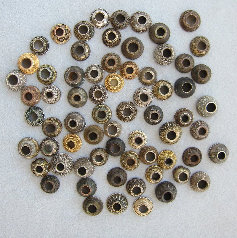

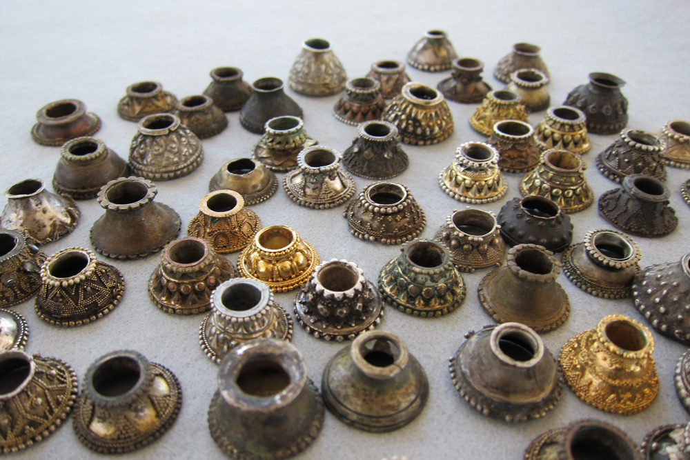

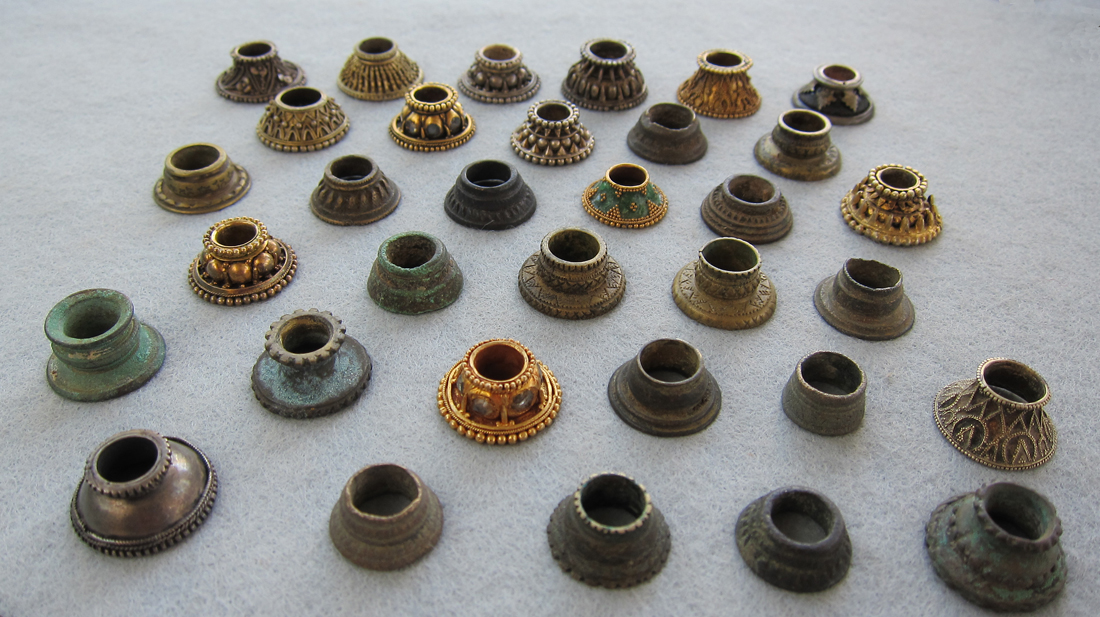

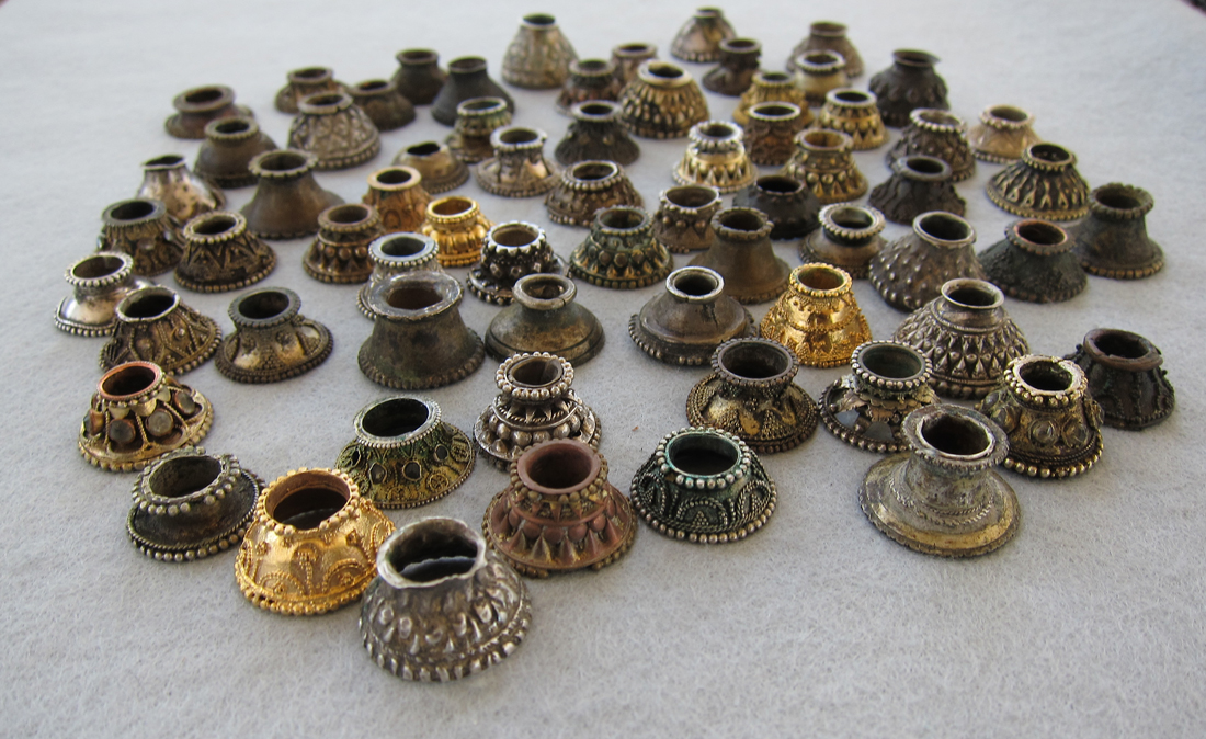

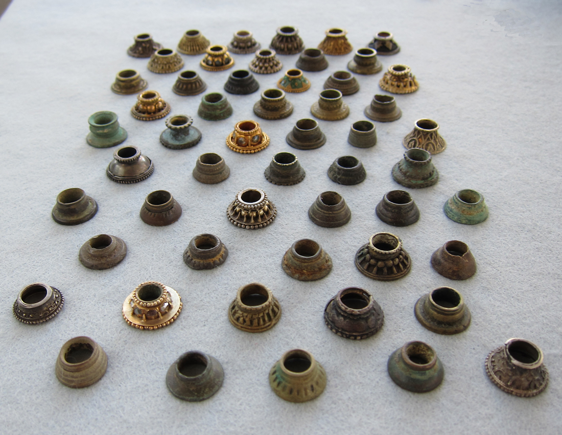

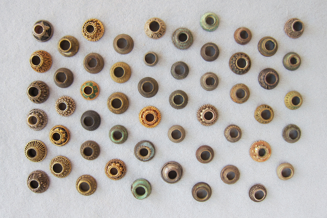

Mendak.
They are little things that can either make or break the presentation of a keris.
They should be of the correct type and correct quality to match the quality of the rest of the dress.
Good ones are difficult to get and good ones are not cheap.
Good old ones are sometimes prohibitively expensive, and for some years now it has been very, very difficult to find any decent old mendak at all.
Really old mendak are even more scarce.
Here are a few of mine.

Beautiful pictures Alan! And agree with you that it is really difficult to get good old mendaks and also new ones of good quality. I see on your pictures some very old ones, which materials are they from? Very nice are the ones from gold, are they from pure gold or gold plated?
Old 31st July 2014, 01:24 PM   #3
Posts: 7,232
Yes, there are some very old mendak there. Bronze ones.
There are two gold ones I think, and they are set with diamonds --- usual low quality.
