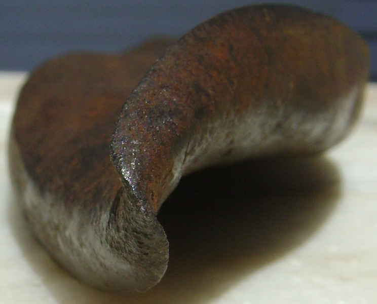

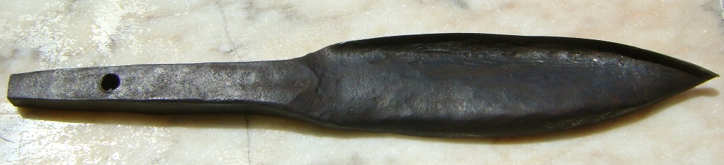

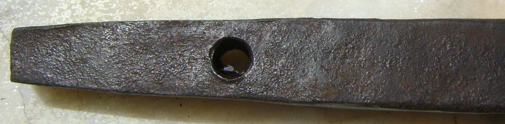

This ethno device is not a weapon, but it surely has a martial look, with its 1,650 Kgs. and 46 cms. length ... and capable to drill a 7 cms. hole.
But for drilling what ? I was told this is a tool associated with well sweep making; like for drilling a hole in the pole, i don't know
In any case the blacksmith has to be a rather skilled artisan, to make such an object to be effective.
Any ideas ?

What i didn't know was the term auger which, in return, i tell you how we call them in portuguese: trados. I dare say that those augers are not only used in boat building but also on a multipurpose basis, civil carpentry, cooperage, etc. ... still in use nowadays, although produced by specialized machinery.

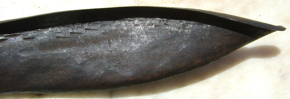

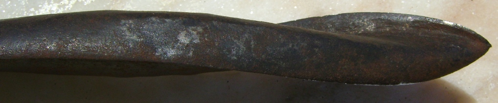

What i find atypical in my example is that, instead of having that spiral screw continuity, only has one single hélix blade, so wide as 70 milimeters, as if the material it has to drill is rather soft and so easy to penetrate.
I would venture this is definitely a tool for a very specific job.
Surely a primitive tool, i would say from the 19th century.

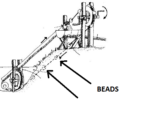

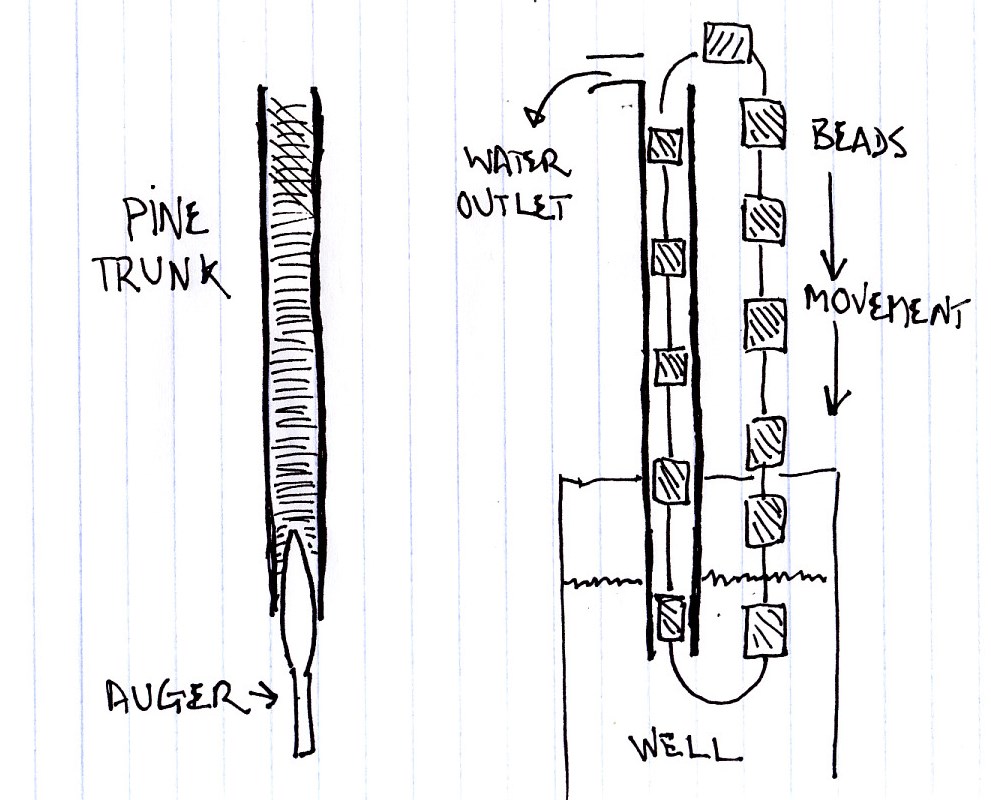

Someone came around and finally the mistery is solved.
Let me try and explain ...
Imagine a sort of chain, praying rosary style, with its beads. Then consider breaking the rosary, introducing it in a tube, where the beads fit precisely its interior diameter. After that, you introduce the tube in a water container and start rotating the rosary in the sense that the beads go up the tube. The result will be that the water is transported to the top, in quantities retained inside the beads interval.
That is the principle of water pumping in which this auger is used; for drilling a hole through a pine trunk where the beads (cork plugs) elevate the water, tractioned by some crank & handle resource.
No wonder this pumping system is called rosario (rosary) or de contas (beads).
