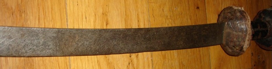

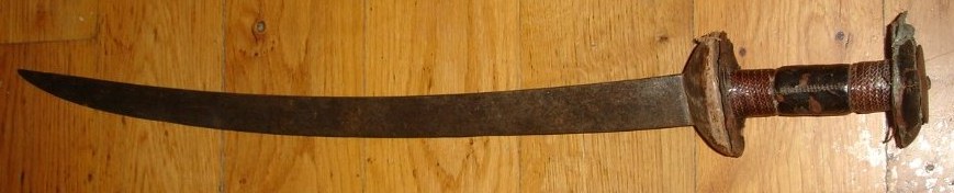

The seller thought it was Tuareg but that doesn't seem likely. After looking through some threads here the closest I could find was in this thread which was described as being Manding. It's not a perfect match to mine but it's somewhat similar.

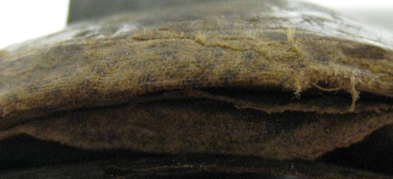

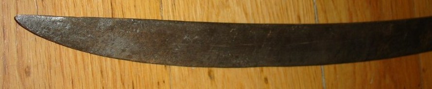

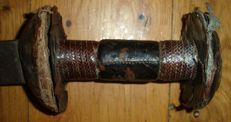

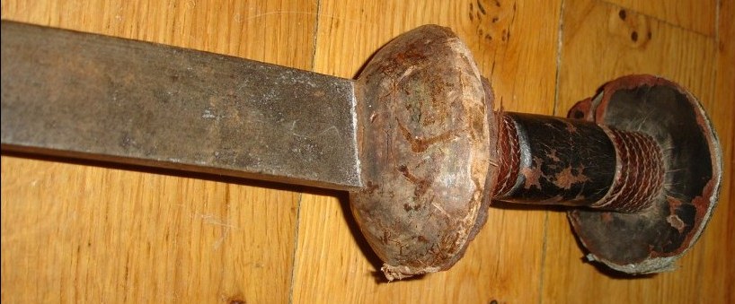

The pommel and guard look leather but they're actually made from some sort of waxy fabric, perhaps oilcloth or tincloth. I attached a closeup of the fabric, you can still see some sort of spotted pattern on the fabric. The blade is 56 cm long and 34mm wide at the base. It's 6mm thick at the base and tapers to a false edge towards the tip. There's no fullers, ricasso, or markings/stamps of any kind but it looks like a European blade to me. Maybe a briquet? The steel has swirl marks on it so somebody must have cleaned it harshly at some point.

I think the Sierra Leone and generally those West African regions are most likely. The blade indeed appears to be a European hanger blade, probably quite old, possibly late 18th c.

I agree the general region Jim. Not sure about the blade age. There seem to be somewhat endless variations on these swords within the larger Mandinka ethnic group, including the Mandingo of Sierra Leone.

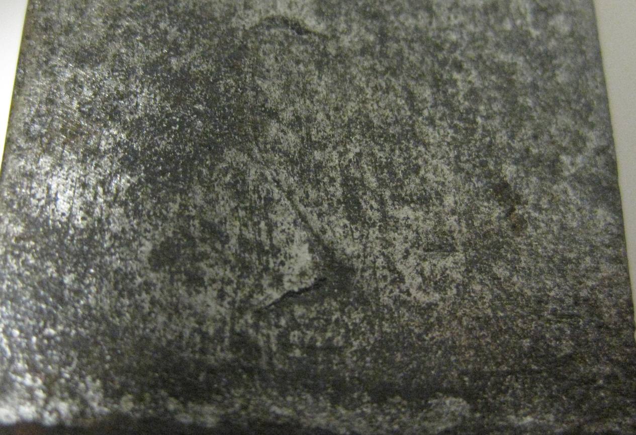

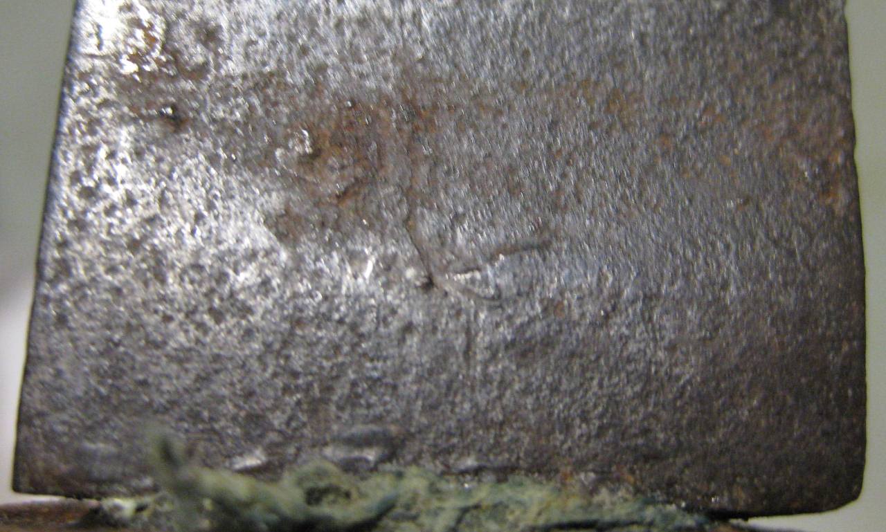

Thanks both. I've been looking at the blade closely to see if there are any faint markings that might provide a hint, but so far nothing. They may be hidden by the hilt. There is an "S" shaped thing but I think it's just a flaw in the steel rather than a mark.

I would agree that's not a mark but rather just a surface scratch or aberration in the steel.

I agree on that 'mark' Iain. On the blade, it seems like a simple and 'wedge' type, and as Blue Lander noted, perhaps it may indeed be a briquette. I have seen many with these kinds of blades, and that would probably bring the blade into 19th century....these were around pretty much through the century.

The briquette idea is pretty compelling I think. Some of the Belgian models as I recall have this profile with no ricasso.

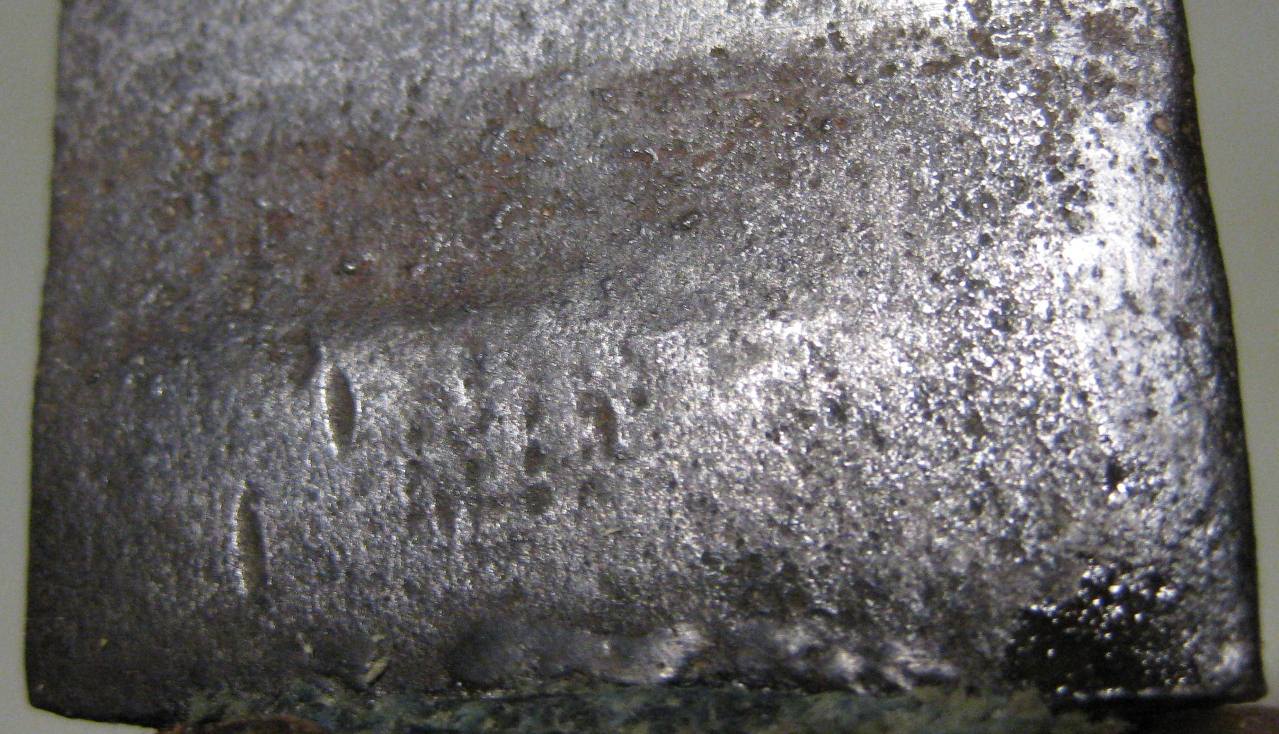

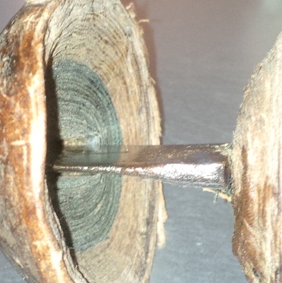

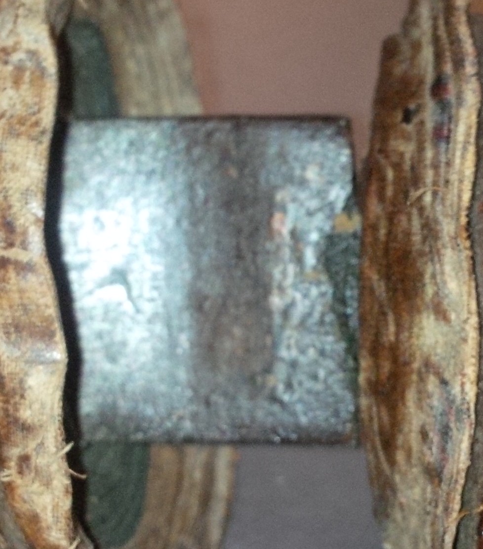

I was oiling the blade up when I noticed the guard felt quite loose. I applied the slightest amount of pressure and the guard separated in two, revealing the base of the blade. It does appear to have a very small ricasso, although I still don't see any identifying marks. I'm going to clean the exposed part of the blade with mineral oil to see if anything pops out before I re attach the top of the guard.

I cleaned up the newly exposed ricasso as best I could, but I don't see any markings. You'd think if it was a mid 19th century or newer blade it would have some sort of inspection stamps on it. Also interesting is that the steel is just as pitted in the part of the blade covered by the guard as it is in the exposed part.

I'm not well enough versed in these briquette blades to say if any series were produced without proof marks.
However on the pitting, this isn't a massive surprise, given the relatively recently hilting compared to the likely age of the blade.
