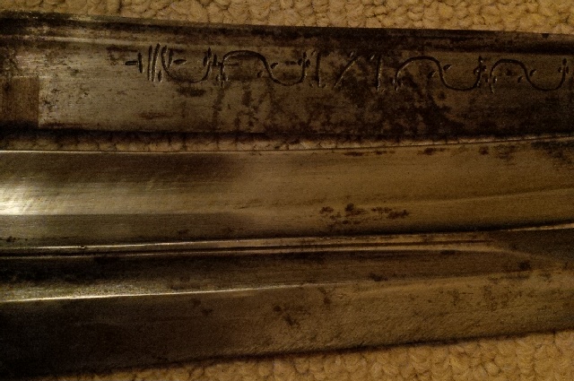

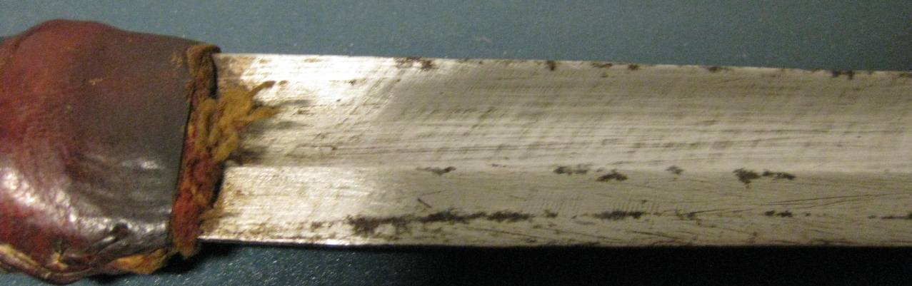

Default Blade origin of Manding sword?

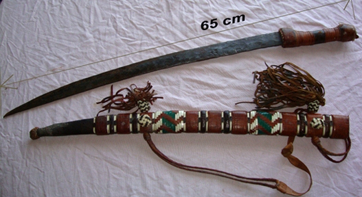

I recently picked up this Manding sword and I'm curious about the origin of the blade. From a distance it looks like an old European saber, but up close it's very roughly finished. The blade shape is odd too, it looks it was reworked to have a pointy tip and and a false edge. If you run your hands down the side of the blade, it feels wavy, as if the thickness of the blade keeps changing.
I wonder if it's a locally made approximation of a European saber blade, or if it's a saber that's been heavily worked over with a file and chisel? The blade's 25mm wide and 7mm thick at the hilt. The spine is square and also covered in file marks.

These short sabres are nearly always native blades in my experience. They are somewhat rough and ready in finish but are actually very good quality blades. It would be very nice to learn more about there manufacture. Are they nomad/semi nomad production? What is the quality of the tools use? Are the anvils stone? and so much more.

Interesting. I had read that they were usually French or British infantry sabers. But every time I see one go up for auction they seem to have locally made blades. I have another one that has a very crudely made blade that's still covered in scale and hammer marks.

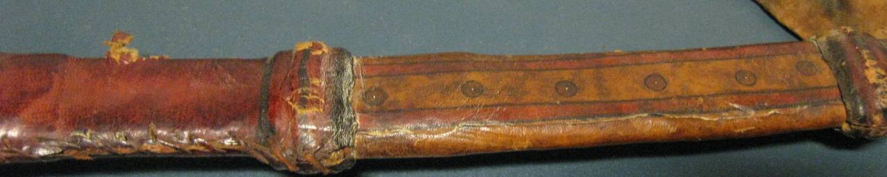

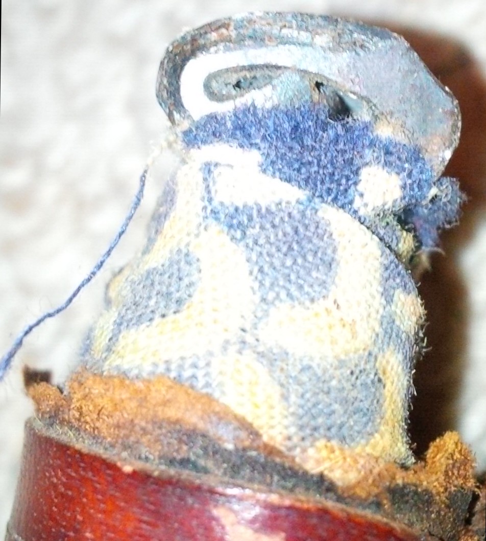

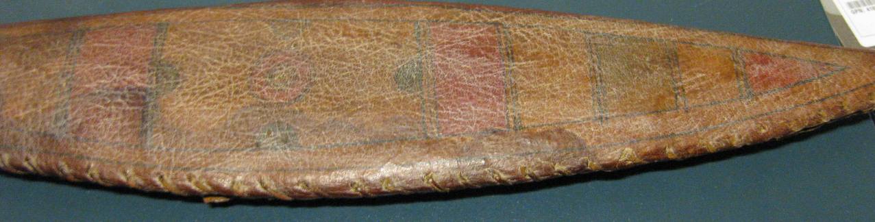

Interesting thing about the hilt and scabbard - the bottom of the scabbard is dried out and faded, while the upper scabbard and hilt are dark and shiny. I guess the body oil of the previous owner kept the leather in good condition.

Actually the blades on these Manding sabres that I have seen often have military sabre blades, typically from French cavalry sabres which of course were prevalent in these regions . These typically came of course from French occupied areas and were often Solingen made, the name Holler on many of them . These blades often became mounted in the Tuareg curved form of the takouba termed the 'aljuinar' (as per data from Lee Jones).
I have even seen English blades by MOLE in these.
The blade has a cross section with the fuller in a depression termed 'hollow ground', characteristic of these 19th century military swords and not as far as I have known, ever produced in the more basic blade production of native artisans. While this one is heavily ground down so markings etc are gone, this hollow ground fuller is still visible. While native armourers are known to have been remarkably skilled at forging and fashioning quality blades, they did not have the industrial equipment to produce these hollow ground blades.
It would of course be hard to say exactly how this guardless hilt sabre form developed but since the Manding were primary factors of the trade routes and entrepots in Timbouctou and others they would have had considerable exposure to incoming influences. Since much of this trade was networked from as far as Zanzibar which was of course the key entrepot of the Omani Sultanate.It has long been my personal opinion that the cylindrical hilt well known with Omani merchants and their 'kattaras' may have travelled on these routes through the African interior, trans-Sahara and into Mali.
While the distinct cylindrical type hilts developed in Muscat and in the case of available trade sabre blades became the curved version of these swords, perhaps the Manding version of these came from these, with the instance f using such trade or otherwise acquired European sabre blades.
Years ago the compelling connections between the curious baselard like weapon with 'H' shape hilt termed the 'Zanzibar' sword by Demmin (1877) via Burton (1884) and corrected by Buttin (1933) ...and the Moroccan sboula were shown. Clearly these weapons were one in the same and connected via these same trade routes and entrepots.
I have personally considered many African edged weapons to be 'reflective' of many outside influences, and becoming the now distinctive forms often regarded as indigenous to their respective regions.

Yes the larger versions are always made from European sword blade. This example is a shorter lighter version.

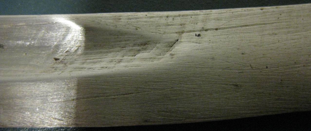

Ah, okay. The blade on this one is 62cm long.
I didn't want to insult the capabilities of the native blacksmiths, especially after owning a couple of very nice native made Kaskaras which I admire very much, but my gut instinct was that this was a little too refined to have been made by hand over there. I do still wonder what this started out as, since the blade is much more curved than the 19th century sabers I own. It reminded me more of a Polish szabla or a turkish blade.
Another data point: I flexed the blade by hand and the "false edge" tip of the blade permanently bent very easily (I won't be trying this again). The rest of the blade resisted fine, so maybe the tip had been weakened since material removed to make the false edge. I bent it back straight just as easily. The only two European swords I have are an 1867 Austrian infantry officer's saber and an 1889 Prussian cavarly degen. Both easily resisted the same amount of pressure without taking a permanent bend.

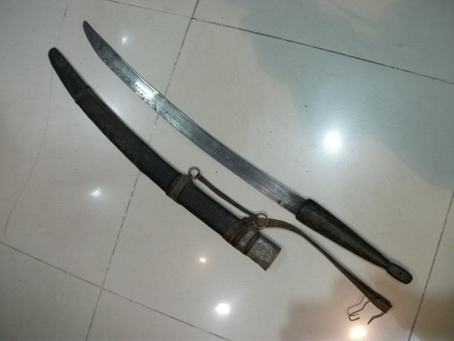

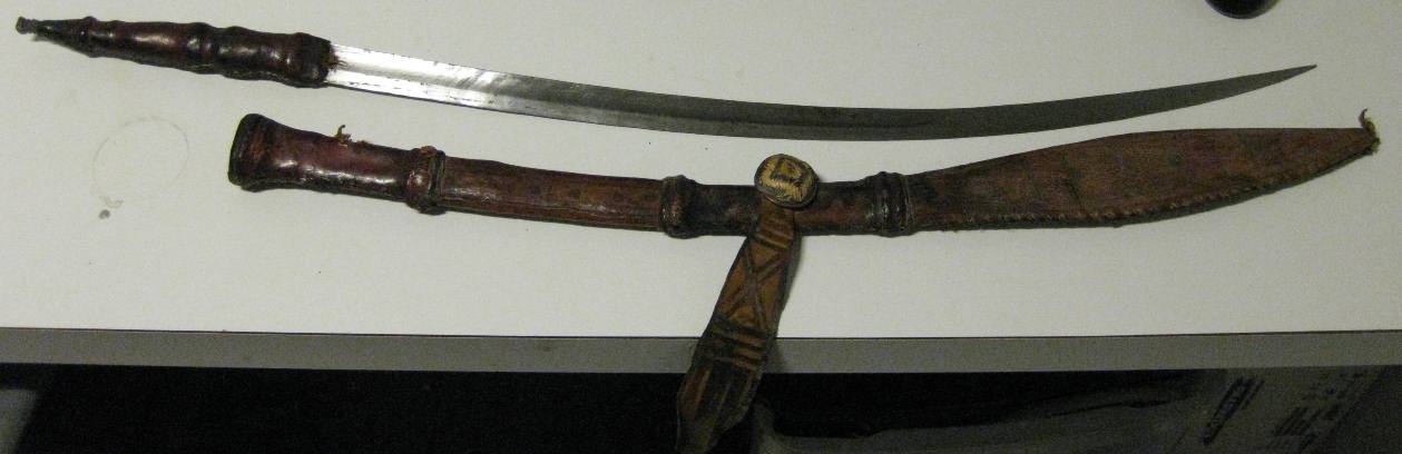

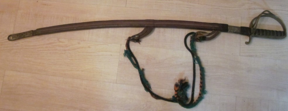

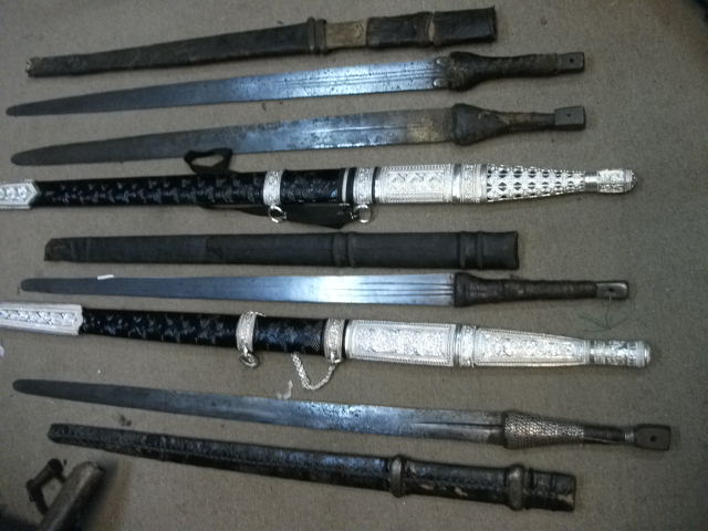

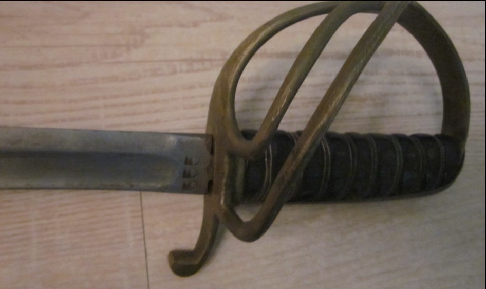

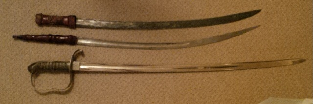

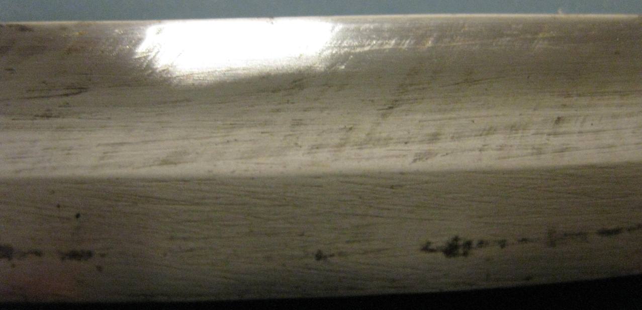

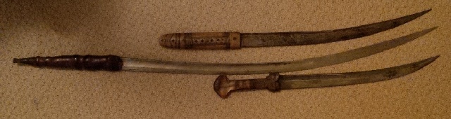

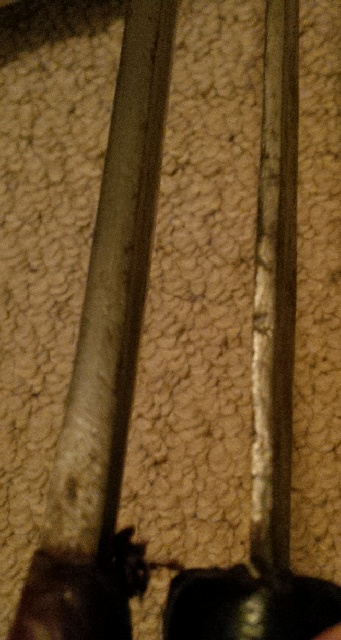

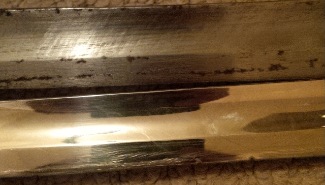

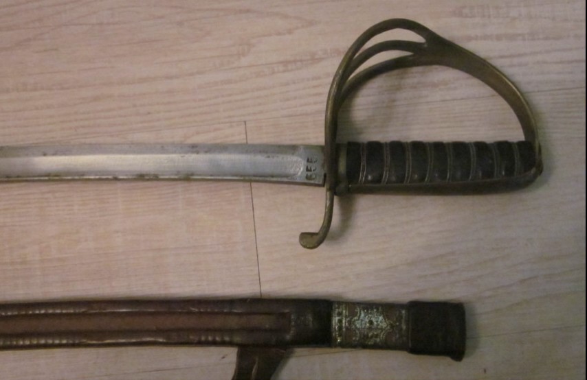

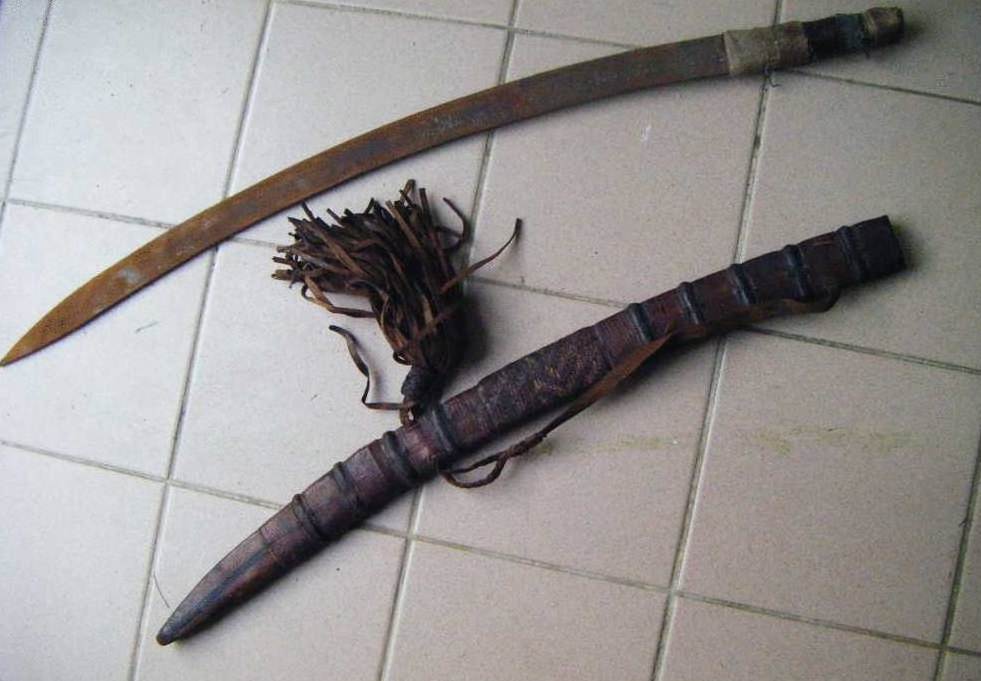

I took some side by side photos to give a little more context.
1 side by side with a "scrap metal" Manding sword and an Austrian saber.
2 closeup of the scrap metal Manding sword and the Manding sword in question
3 closeup of Manding sword and Austrian saber
4 spine thickness of the two Manding swords, the scrap metal one being the thinner
5 Manding sword next to two other "converted" African daggers with European saber blades. Big one is a Shula, small one is some sort of ersatz koumyya relative I guess
6 closeup of all three blades.
Edit: never mind, they all posted out of order. But you get the idea.
The Manding blade isn't quite as refined as the other Euro blades and it doesn't have any patina to it. But it definitely was retipped in a very similar fashion to the Shula and the other dagger. And as Jim said, why would the Manding make the tip in one shape and then grind it into another shape?

Salaams ! What you probably have here is a rather scratched up version of a European blade..somewhat less quality since it had a tip that permanently bent when pressed ...Nonetheless a reasonable example of late European French/German trade ..possibly a parade version not particularly required to be fought with..on a basic Manding hilt.
Tipu Tip the great Oman slave trader "owned" much of the interior centred obliquely on the Falls of the Congo River.
Please see http://www.vikingsword.com/vb/showth...highlight=tipu #10 for a reasonably full account and a general map is set out from that post below.
My view is that the influence occured from the Manding region to the falls Hub(Tipu Tip) thence to East Africa and the Zanj. Zanzibar being the generator/collecting point of slaves would have ensured recognition of the hilt form into Omani circles, moreover, it would have been in the right place at the right time to be accepted for the new pageantry only item...The Omani Dancing Sayf.
Nice to view the Manding in respect of influence on Omani Swords.

If it's a parade/dress saber that would explain the bending as well as how lightly built it is overall. And thank you as always for providing the historical context. I wonder why they altered the tip of the blade. It doesn't seem typical for Manding swords. Maybe the original tip snapped off and this is how they repaired it.
I once saw an auction for an "African saber" that was a completely unaltered European saber with its original European style guard and hilt, but in a Manding style leather scabbard. I wish I had saved a picture. If that saber could have been identified by the shape of the guard, maybe it would tell us more about when and where the Manding got their blades. Assuming it wasn't an anomaly of course.
Edit: never mind. I found the auction in my browser history and the scabbard looks like it's North African, not Manding. I must have misremembered. Here it is anyways. It looks quite a bit like a takouba scabbard, and the saber itself looks like a cheapo private purchase one rather than anything military issued.

Very nicely done Blue!!! Thank you for the excellent comparisons, most helpful. I think, as Ibrahiim has noted, this is indeed most likely a later 19th century European sabre blade, probably an officers, and as we have agreed, pretty savagely ground and reprofiled.
The intact European sabre is most interesting, and indeed does have a Tuareg style scabbard, something I have honestly not seen used on an original European sword. This type of anomaly certainly does reinforce the profound availability of these European swords and blades throughout these regions.

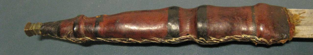

You know, when I first saw a Manding cylindrical hilt I assume it was shaped that way for practical reasons rather than stylistic ones. Like, if you took a stick tang sword and wrapped leather around it to make a hilt, that's the shape you'd end up with.
My other "scrap metal" Manding sword has a very different hilt construction. The tang is almost the full width of the blade. The end of the tang was folded back on top of itself to create a pommel. A leather cap covers it, but it's easily removed. I've seen quite a few similar swords go up for auction and they all appear to have a similar construction. The scabbards terminate in a tip like a European scabbard rather than the usual Manding style. The scabbards always feature woven multicolor leather. The blades are always blackened and extremely crude. The hilt is sometimes circular or sometimes dog bone shape, but there's never any metal furniture to it. Are these modern Manding swords made in a simpler style by less skilled artisans, or tourist pieces, or what?

That hilt strongly reminds me of the Sierra Leone swords I mentioned, which of course would not have been confined to that region but as always collectors have to put some kind of label on it. It is known that European type sabres have been in use throughout West Africa into modern times, so seeing these type of chape sleeves is not surprising .
What you are saying is systematically correct, fashioning a grip or hilt that is serviceable is a simple affair, so a rounded handle would serve well. It is of course understandable that a weapon being at least somewhat a status item one would not want just a crude lump of wood, so design and decoration would be employed accordingly .
I tend to dislike the cavalier description of 'tourist' item for ethnographic weapons at large as in many, possibly even most cases, these weapons are used in at least some degree as traditional accoutrements among tribal peoples. I think these somewhat crudely fashioned items fall into that traditional category, while the touristy items are obviously too fragile and focused on bling for combat or actual use. In many of these regions, edged weapons (often collectively termed machetes by journalists) are indeed still used.

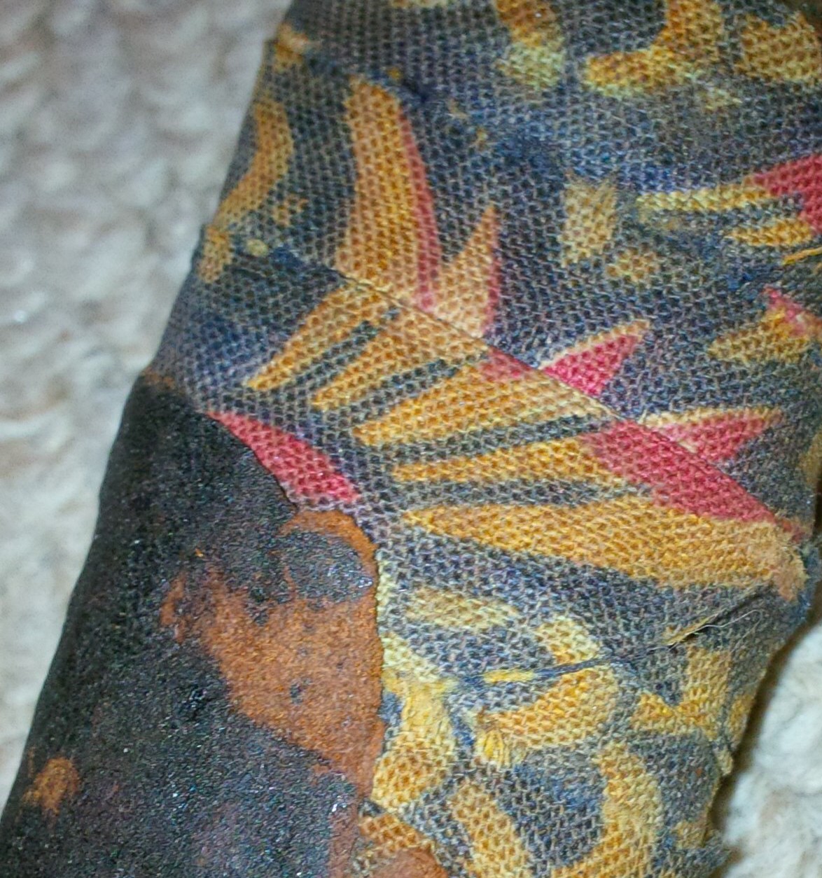

I'll have to read up more on Sierra Leone and its swords. I've attached a picture of the rolled up end of the tang, which I thought was pretty clever. I've always wondered what the pattern on the fabric is from. It looks like it used to be covered in black leather so it wasn't mean to be seen.

According to this site , there's a tradition of printed fabrics in Africa.
African print fabrics come from a batik tradition and were imported from Indonesia starting in the colonial period. On some piece there are still tags that reference "wax-resist" and/or "Java." Depending upon where you are on the continent this cloth can be referred to as lappa (Liberia, Sierra Leone), wrappa, pagne (Francophone West Africa), kanga (East Africa)
This site has several African prints that look somewhat similar to what's on this hilt.
