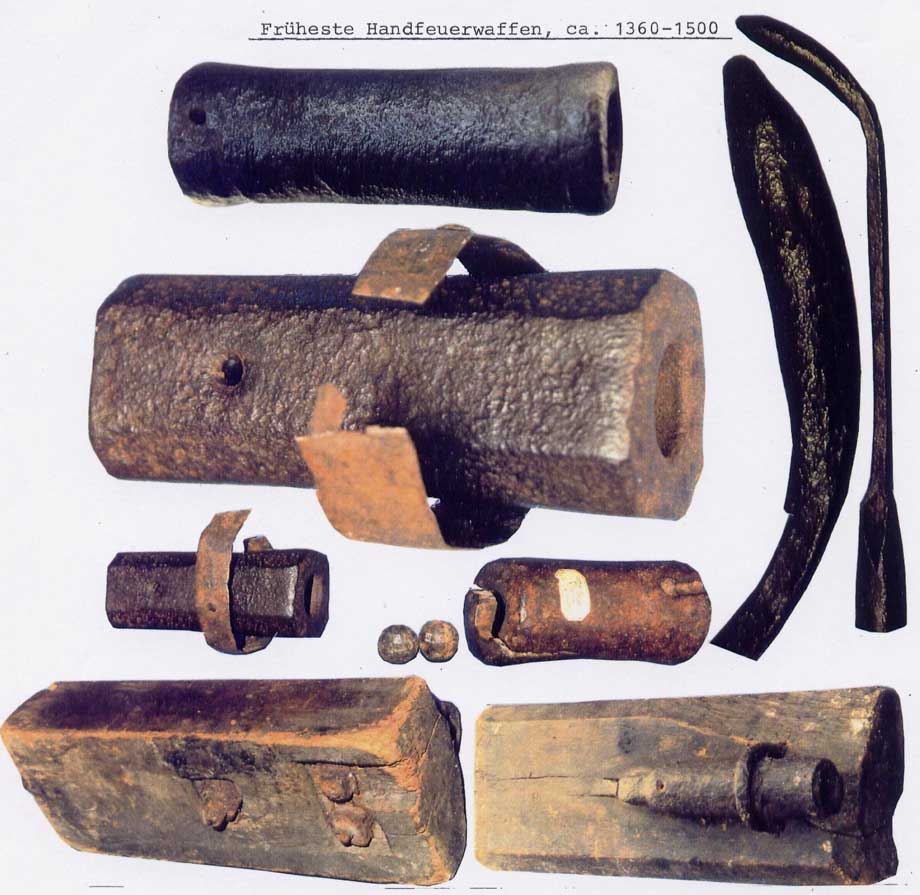

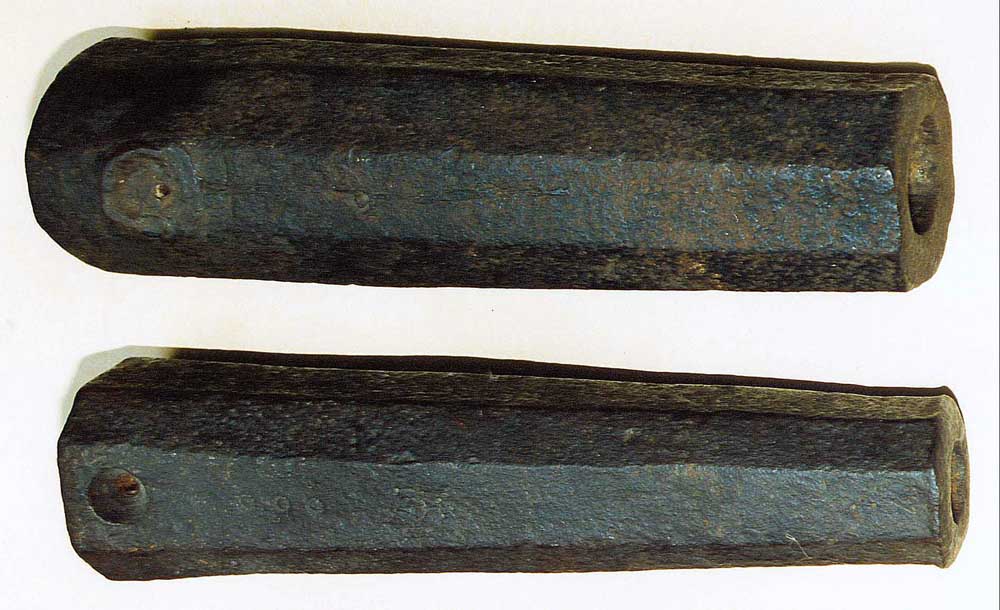

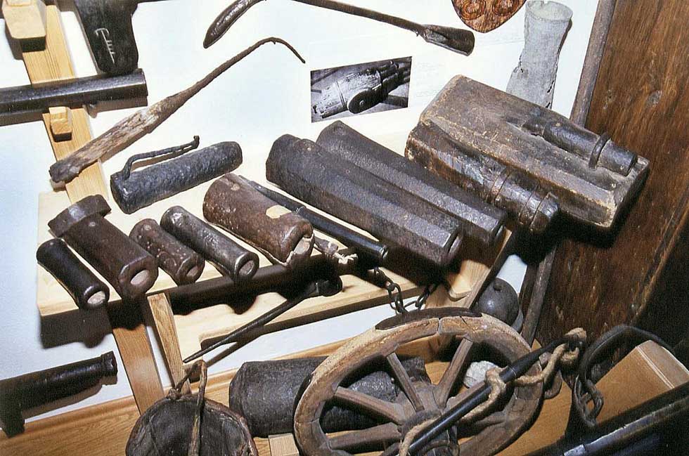

Historical illustrative sources prove that not all of these short wrought iron barrels were necessarily stocked invidually 500-600 years ago. Most of them probably formed parts of Gothic multibarrel guns - or should we refer to them rather as refined constructions?
Many of them were certainly just used as noisemakers (Böller) in later centuries.

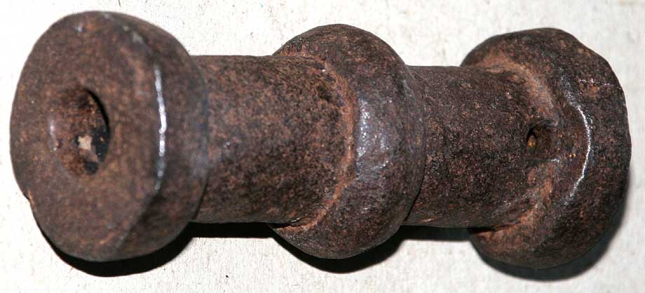

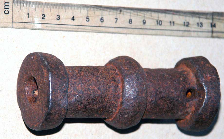

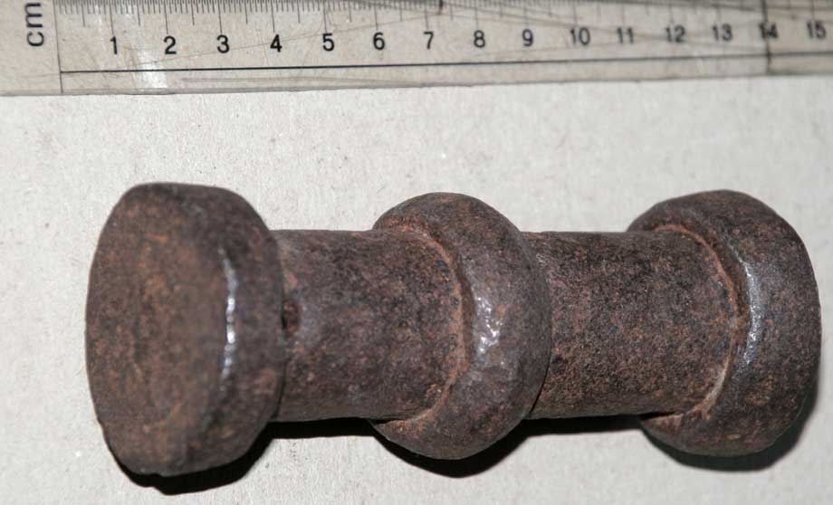

Another interesting little wrought iron barrel, of early 15th century form, contrasted to a source of illustration of a baptismal font of similiar three ring reinforced shape, an illumination from a Prague manuscript of ca. 1420.
Old 4th May 2009, 05:17 PM   #14
Hi Michael,
Is that what you call baptism of fire ?
Now seriously ... great piece.
Fernando
Old 4th May 2009, 07:25 PM   #15
Matchlock
Matchlock's Avatar
Join Date: Sep 2008
Posts: 4,310
Hi Fernando,
I can tell by your eloquence and love of puns (the latter shared between us) that you really appreciate the notion of a baptismal shower of flames as well as the smell of hellfire and sulphur!

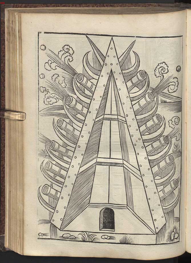

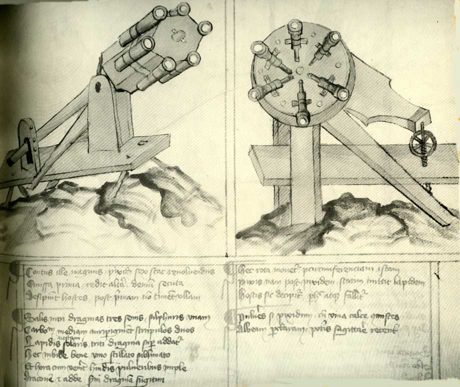

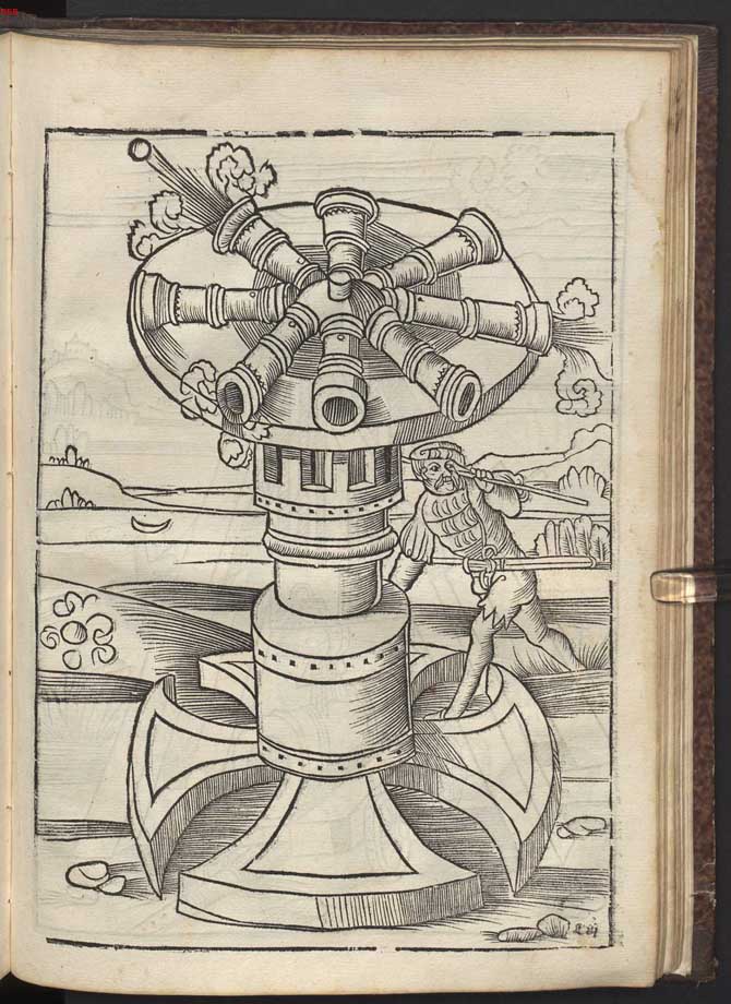

Default Multi Barreled 15th Century Guns

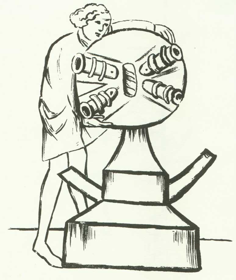

From:

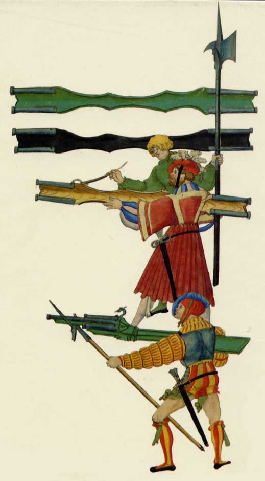

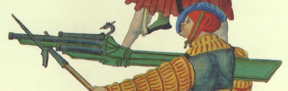

Flavius Vegetius Renatus: Vier Bücher der Rytterschafft (Four books on knighthood), Erfurt, Germany, 1511.
That's what I meant when I wrote that not all of those little guys that are still around in such amazing numbers need to have been stocked individually as parts of portable handguns.

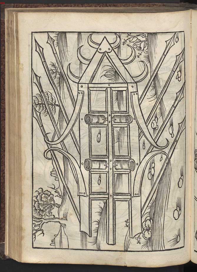

Old 14th May 2009, 05:39 PM   #17
Matchlock
Matchlock's Avatar
Join Date: Sep 2008
Posts: 4,310

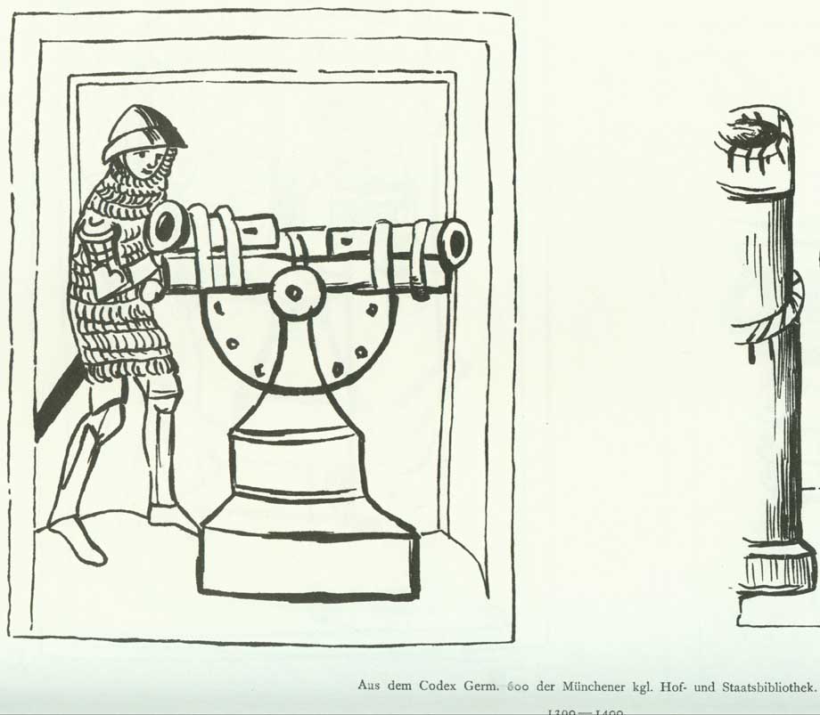

One more.

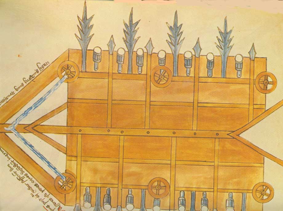

A multi barrel cannon cart, 1436.
Watercolor from Johann Hartlieb's book on warfare of 1436 (Austrian State Library, Vienna, cod. 3062).

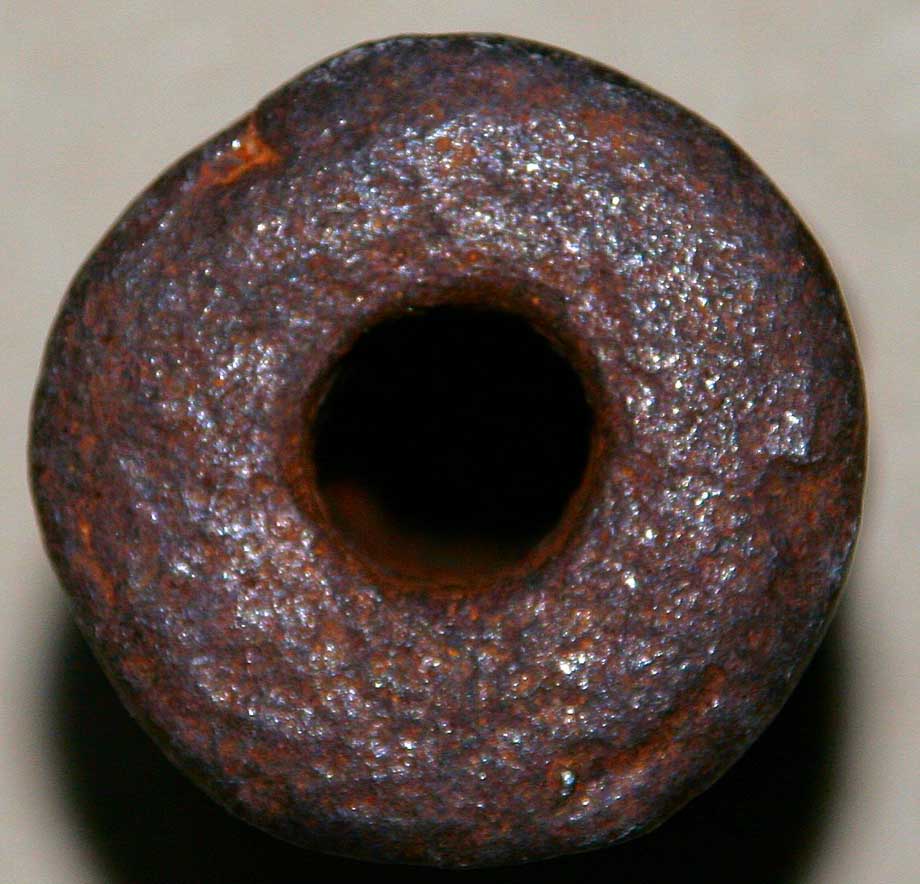

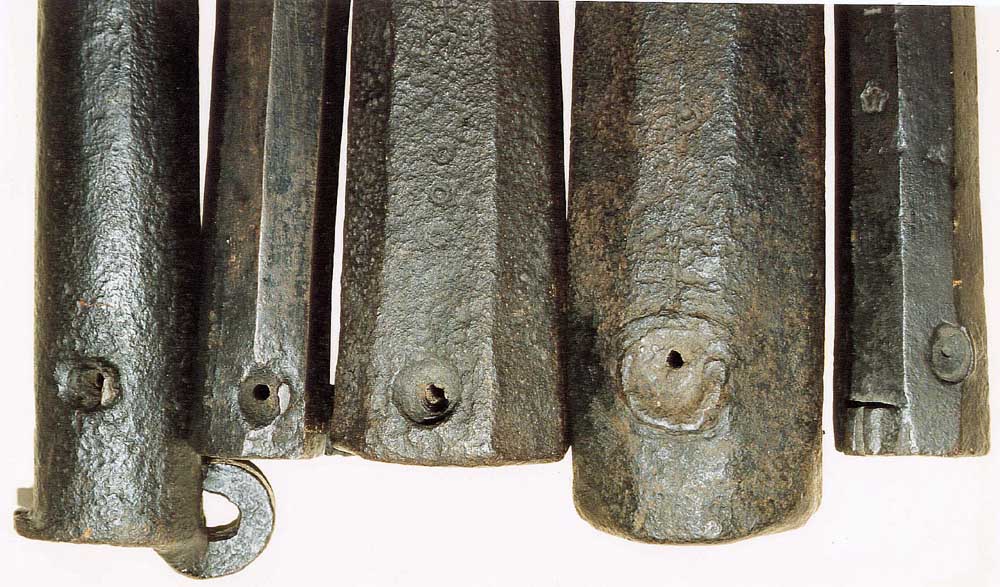

Michael, I have a friend from Ryazan who practice in target shooting with replicas of 15 century handgonne. He'd really liked this handgonne and wants to make replica of this for target shooting. He often read our forum But he doesn't have an registration on vikingsword. So, he asked me to know the length, outside diameter and caliber of this handgonne. May You help me with this question?
Spiridonov is offline   Reply With Quote
Old 8th April 2012, 05:57 PM   #22
Matchlock
Matchlock's Avatar
Join Date: Sep 2008
Posts: 4,310
Hi Alexender,
of course I can!
The overall length is 11.4 cm, the (quite irregular) maximum outer diameter is 4.4 cm, and the bore is 14.86 mm. The diameter of the touch hole, again irregular as it was not bored but struck thru the white-hot iron with a hardened prick, is ca. 6 mm.
I'd like to see images of the replica!

Please tell him to remember that the iron rings have to be forged separately, put on the barrel when white-warm and fire-forged!
m

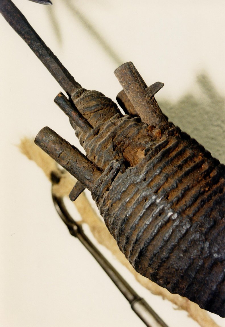

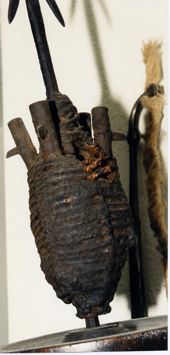

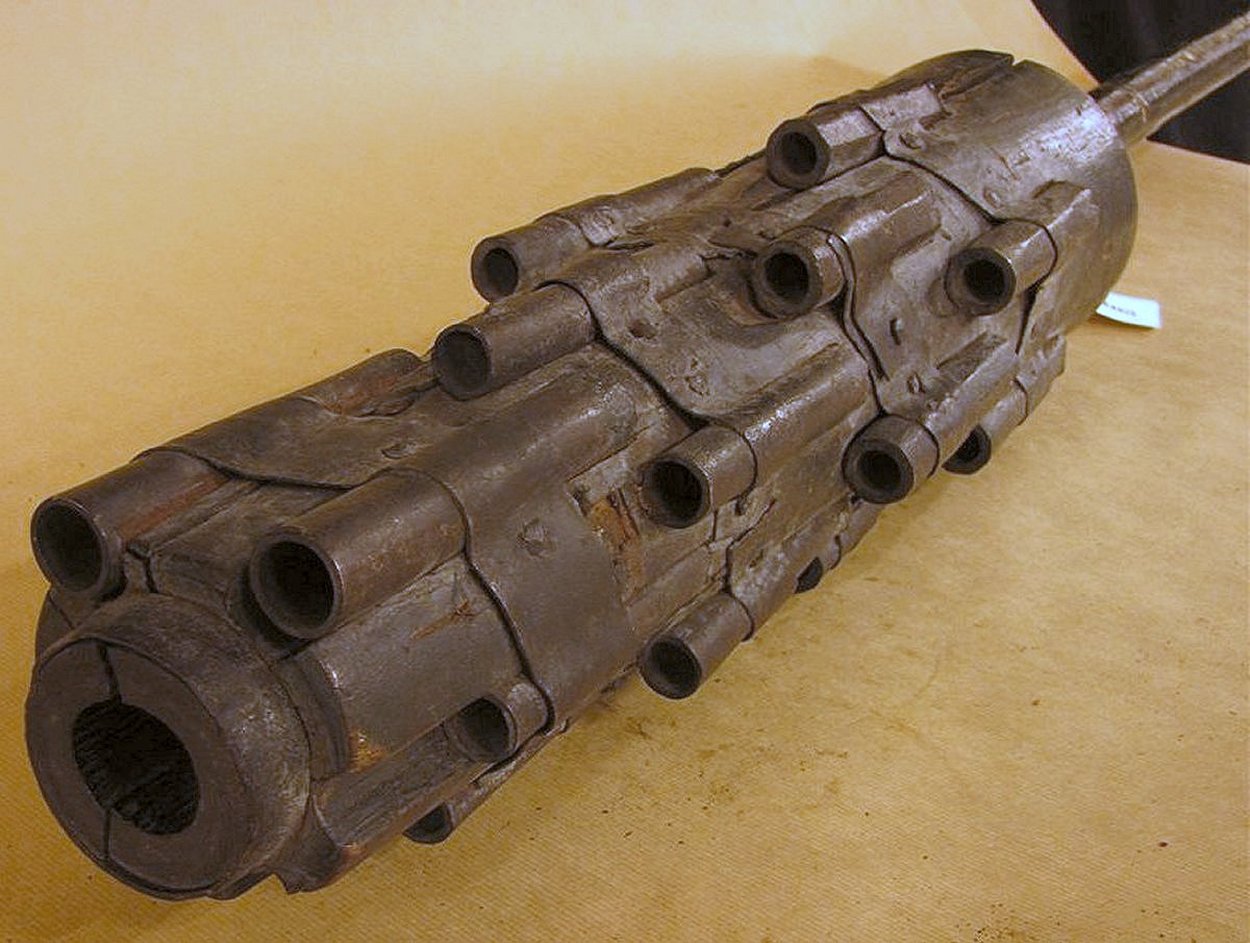

This most remarkable device, probably made in the Thirty Years War and re-using short, older barrels, is called Sturmkolben or Igel in German, and I would be glad to know the English equivalent.
Such multi-barreled devices account for the wide presence of short 15th-16th c. barrels which were 'on the loose' again when the device was destroyed or given up.
Preserved in the Army Museum, Stockholm.

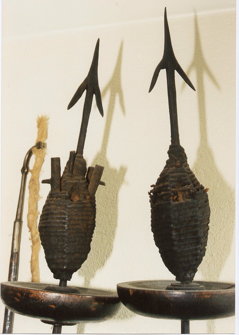

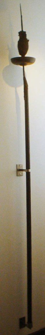

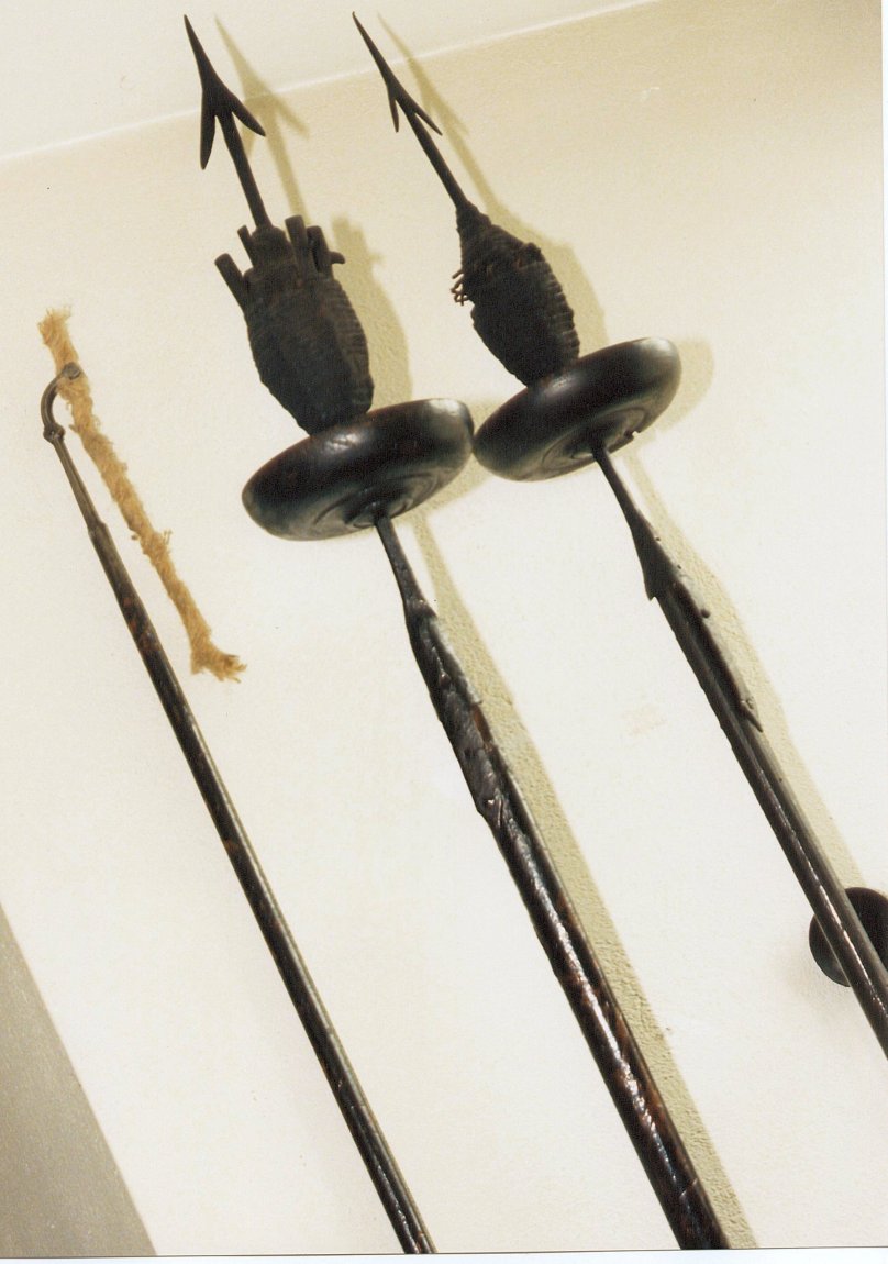

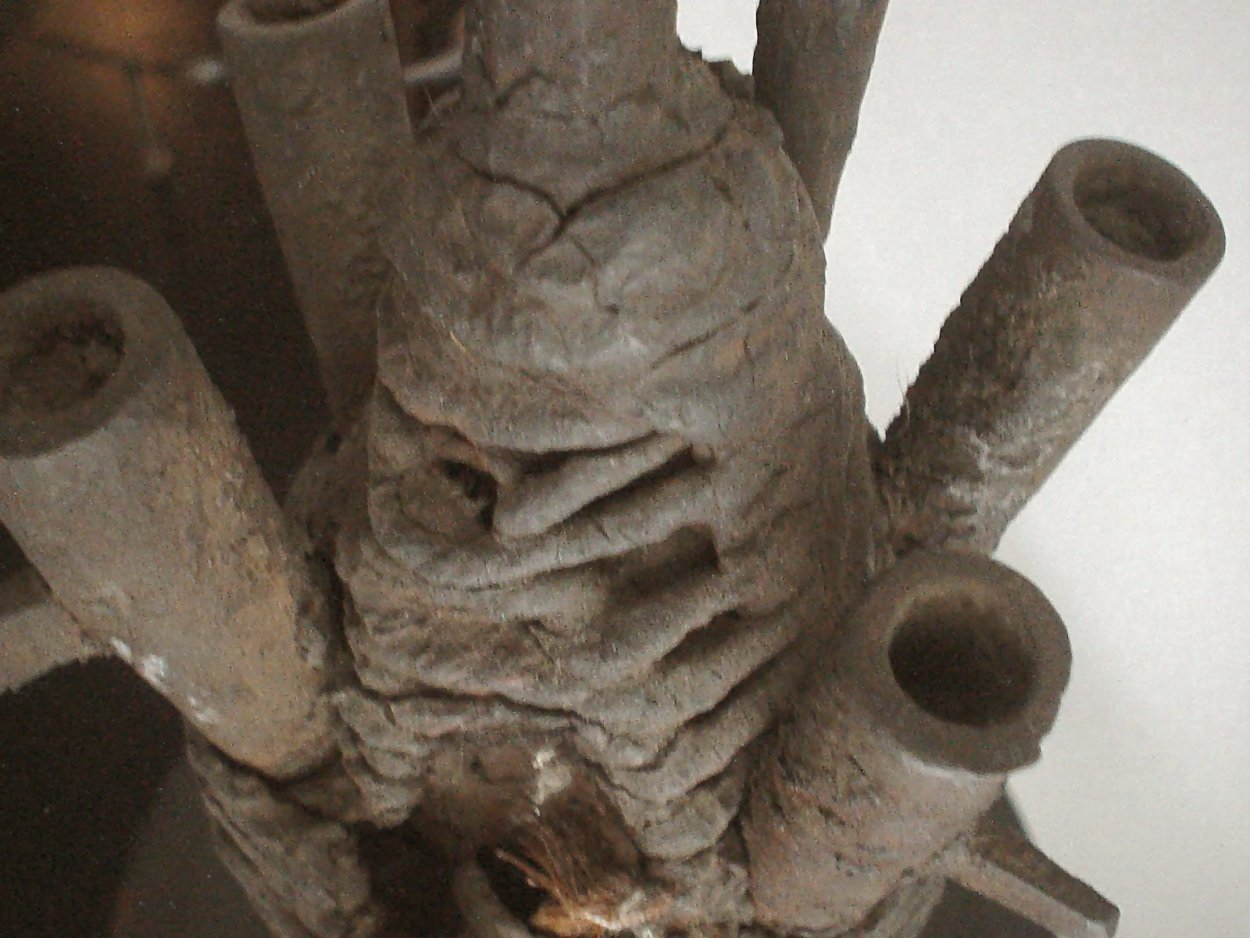

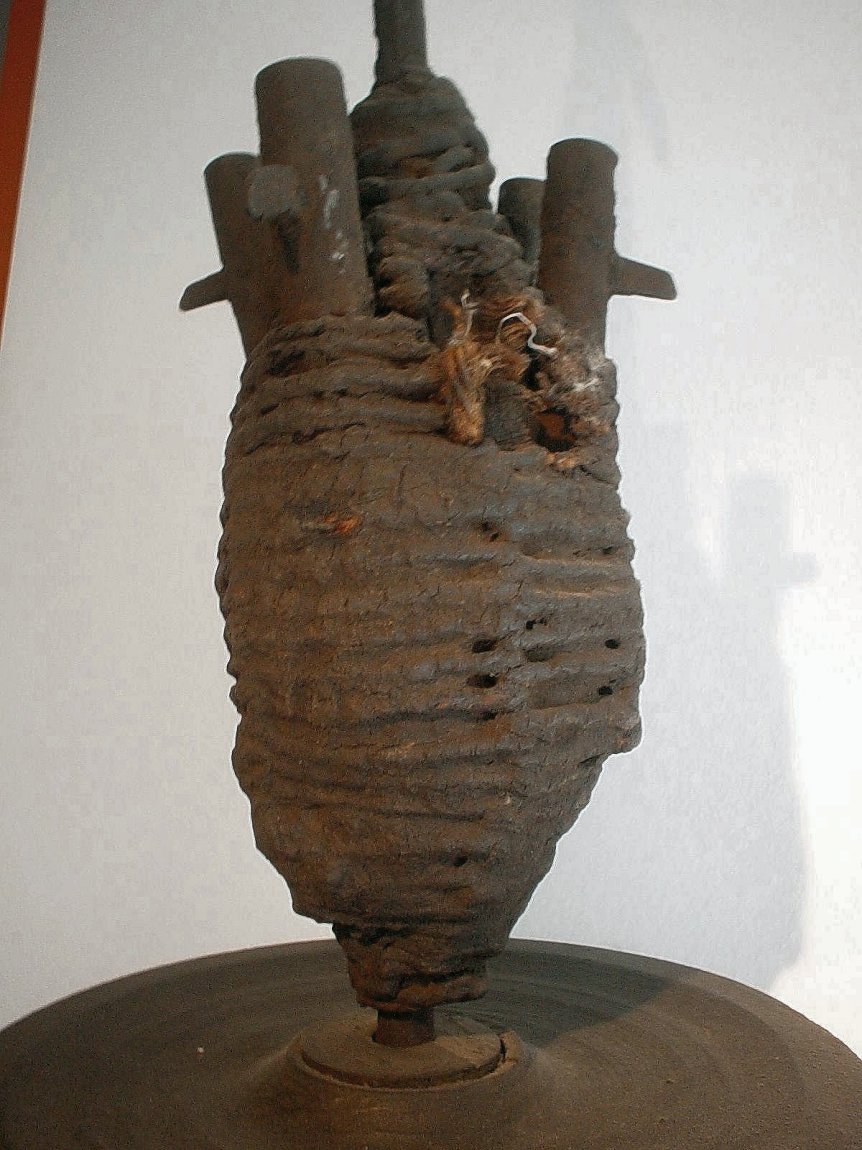

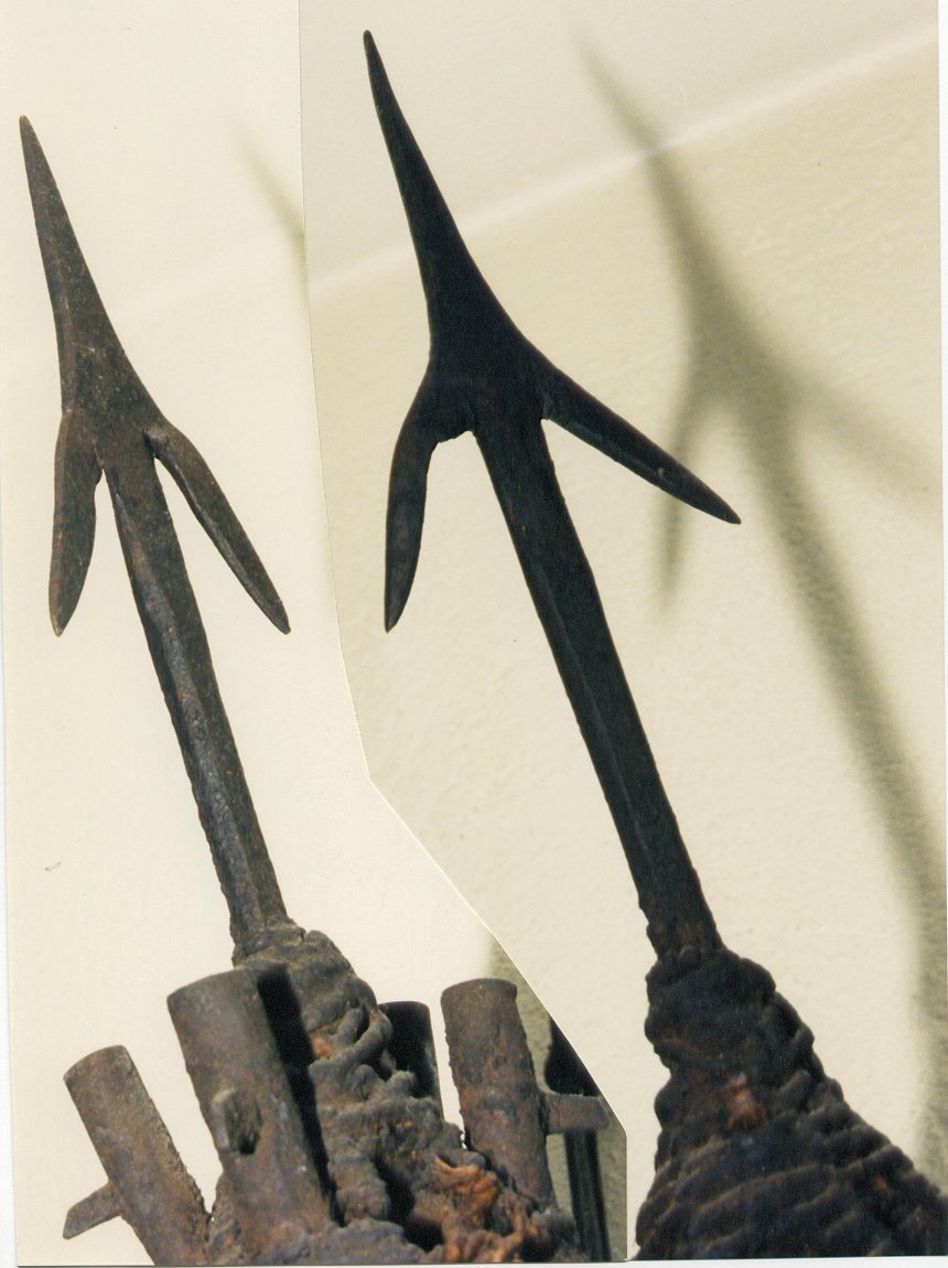

Similar samples in which older barrels are united are two 16th-17th c. Pechlanzen (pitch lances) in the Emden Armory.
The pitch incendiary mass was set afire and the lance was hurled by some sort of a catapult onto the shingled roofs of a besieged town where the delicate iron arrowheads got stuck, and the blazing tar/pitch would splatter around. Additionally, the short barrels are barbed for better contact with the roof shingles.
The saucer-like wooden plate at the bottom was meant to direct the splashing fire right onto the roof.
The measurements are:
overall length 2.25 m
width of the tar saucer 21 cm
weight 3.2 kg
I took these photos in 1987.
m
