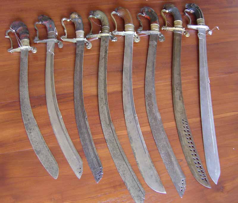

There is a nice thread on parang nabur with pictures here: http://www.vikingsword.com/vb/showthread.php?t=692
Dajak attached a picture of several of these swords, with the fourth example having an all brass hilt. You can see that picture here: http://www.vikingsword.com/vb/attach...tid=3618&stc=1
The blade on the one that sold recently on eBayis unusual, but I think it still falls into the general style of the parang nabur. The scabbard is also unusual, as Michael noted, but may be a regional variant or a later marriage.
Looking through v. Zonneveld, I don't see anything else resembling this sword.
Ian.

Dajak's Jimpul picture illustrates very well what the (single) hook usually looks like (if there is any).
All brass hilts on Naburs is not that uncommon.
What's most unusual with this sword is the scabbard, as I wrote earlier.
