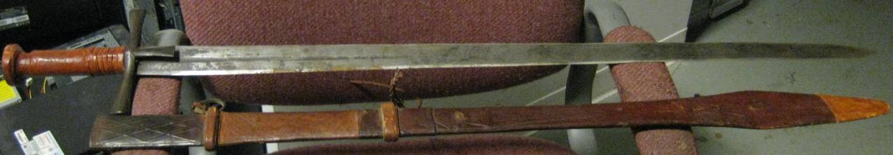

I picked up Kaskara off e-bay recently. I assume it isn't particularly old and the blade has no markings on it. Other than being a little rusty it's still decent good condition and dangerously sharp. The blade wobbles a bit, though it doesn't feel at risk of sliding out of the hilt. Is there any recommended way to tighten it back up? It looks like hilt is stuffed with fabric/cloth on both sides of the blade to act as shunts.

Thank you for pointing me in the right direction. It looks like it's stuffed with yarn of some sort, I could try picking it out and repacking it.
Also, you mention the hilt and blade look older than the leather wrapping. Do you have any sense of how old the hilt and blade might be? The seller didn't have much information, they described it as "WW 2 sword", so I assumed it wasn't much older than the 40's. On the other hand they listed it in the Japanese sword category, so I don't exactly trust the seller's expertise.
The blade has some bend to it, but it's much stiffer than my Takouba. It's a little stiffer than a good machete.

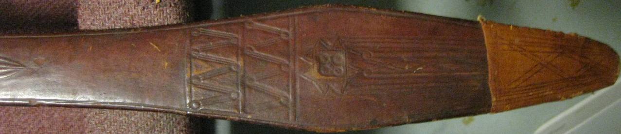

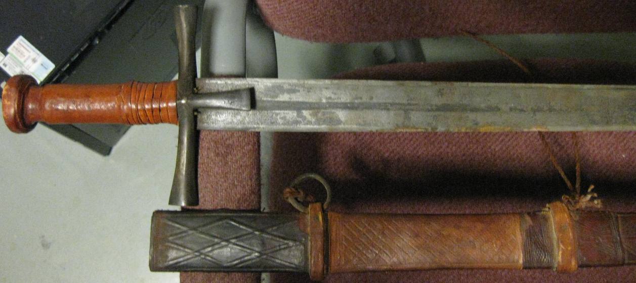

I don't think the blade has any markings. I attached a picture of what looked like markings on the blade at first, but I think they're just failed laminations or flaws in the steel. They're only on one side of the blade. The hilt does taper, but the ends aren't very well shaped.
I don't know if you can tell anything from the kind of rings used on the scabbard, but I included a picture anyways. They have a channel running down the middle of them.

I have a feeling that the blade is "locally" made from ferrous metal other than spring steel. How does it sound when you tap the tip on a hard surface; a kind of a ring or a dull thud-like sound?
Scabbards are made by a separate craft guild from sword and knife makers. The rings are likely made from scrap metal even nails bent in a crude circle. Your rings are interesting, but probably not diagnostic. Likely made from what useful metal on hand.
