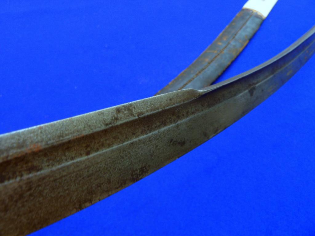

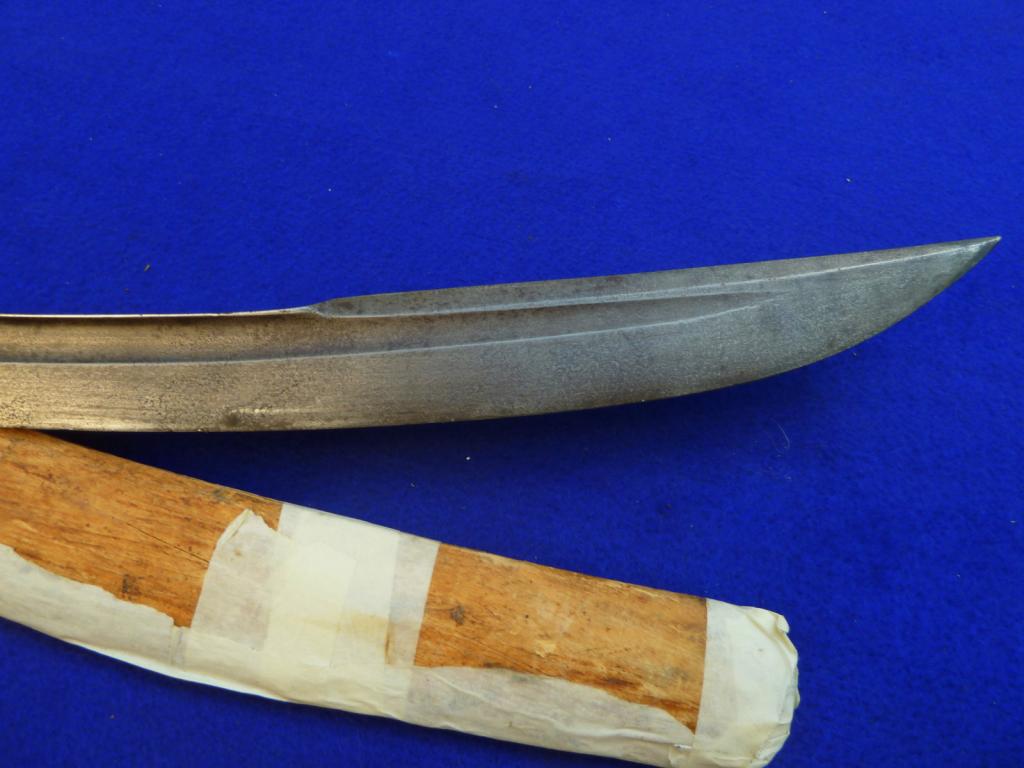

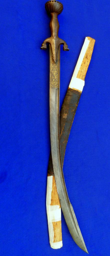

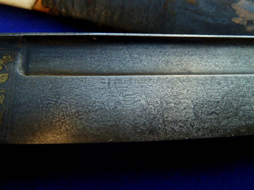

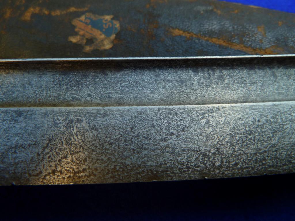

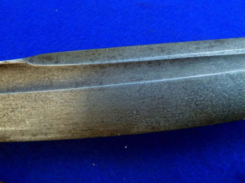

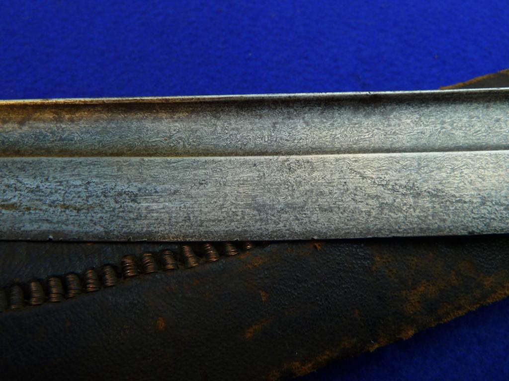

Colleagues,
This beautiful indo-persian saber was recently sol.
There sems to be a marked difference of opinion on the technique: is it a true mechanical damascus or just a superficial damascening ( etching?)
I am putting a bunch of close-up pics for you to express your opinion. The input from professional bladesmiths is especially welcoe.
Thanks.
Old 15th November 2013, 04:55 PM   #2
ALEX
ALEX's Avatar
Posts: 936
Clearly acid etch - imitation pattern applied on the surface.
Old 15th November 2013, 05:07 PM   #3
mross
Join Date: Jan 2005
Posts: 478
Looks etched to me as well.
Old 16th November 2013, 04:33 AM   #4
Posts: 7,280
Yep. I agree. However "damascening" means basically something like koftgari, but a little thicker, and usually in script.
