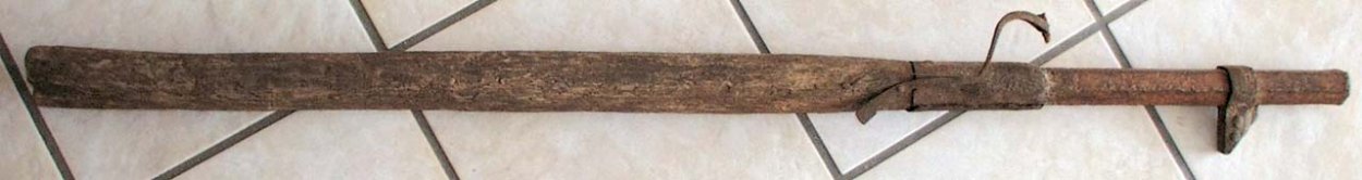

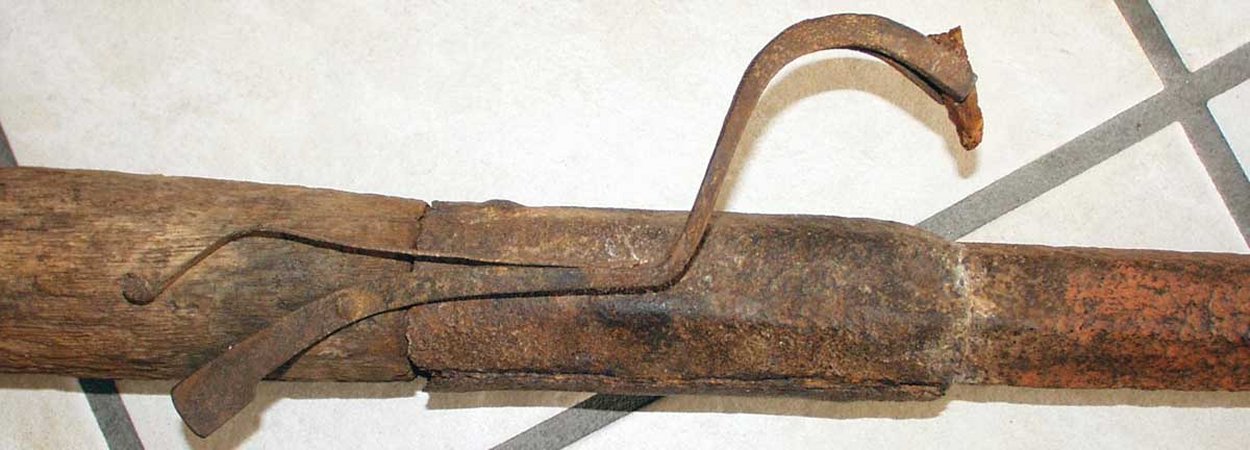

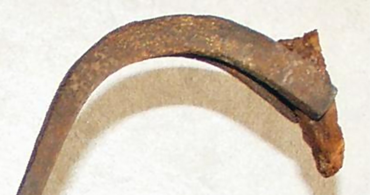

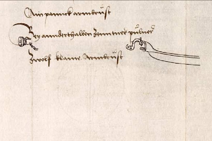

And a detail with a piece of old tinder in the serpentine, of the oldest known complete long gun in existence, ca. 1400-10 (!!!), in my collection.
The watercolor is dated 1411, from the famous Cod.Vind.3069 (Vienna Library).
