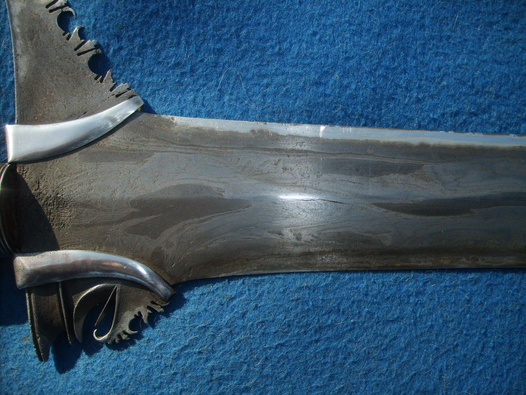

Moro kris with two patterns

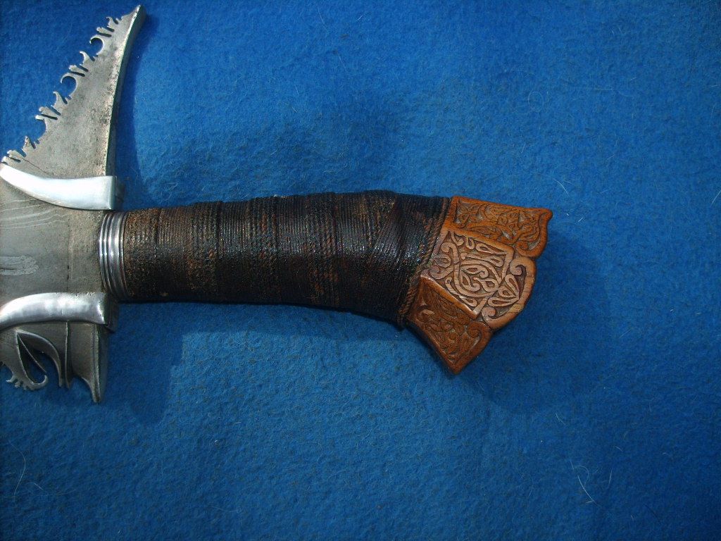

What a great and fascinating piece!
I love the pommel carving and the styles of the laminations. Rare but not unheard of. On my more recent Moro kris example, the lamination up top is similar but changes into another type down the blade.
Thanks for posting this.

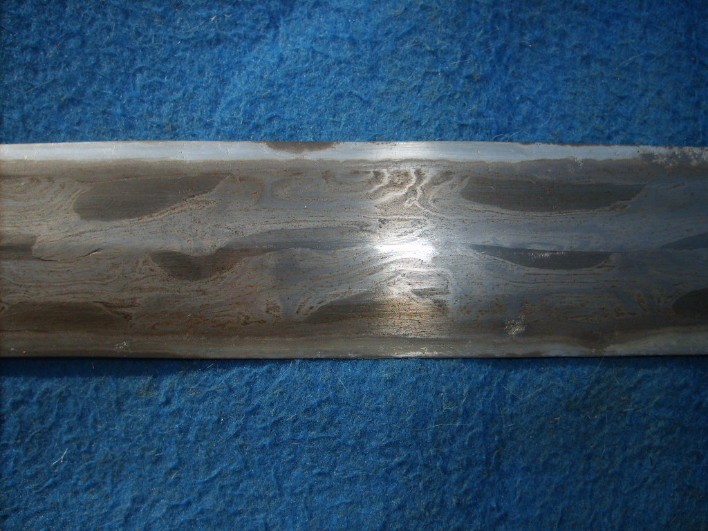

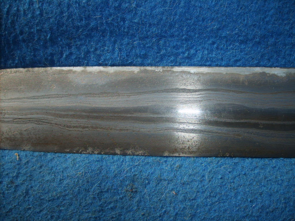

Jose: It is a twist-core on one side, and a linnear pattern on the other side.
Blade is 23 inches long, 29 inches overall. I also have a barong with a
random pattern and a linnear pattern. You can see where both plates
were welded together. I wonder if there are more variations out there.
Dave.

didn't hit me as twistcore til you mentioned it Dave! Wow, that's different!! i believe the barung with different sides has been posted here before. i can't find it, tho. this kris, i'm assuming they run out of material so they use a different pattern???
nice twistcore btw... need to post more of these twisties

Indeed an unusual sight.
I've seen different patterns on Indian sabres and I have a special one on a Keris but it is the first Moro example I have seen, thanks for posting.
Gavin

Very interesting example. The blade is superb, and like Battara I really like the hilt carving.
I am assuming this is two panels of steel forged together. Very unique and says a lot about the smith not to make a mess of it.
Two twisted bars on one side and one with horizontal layers on the other of the core.
Besides a very rare pattern also beautifully carved details at the base of blade. Would it be possible to see the whole blade from both sides?

Charles: While i'm not a bladesmith i think this has to be two different
plates welded together so when the edge is sharpened the weld-
line disappears, wereas on the top edge of the barong you can
clearly see a weld-line. I keep thinking i have another kris with
two patterns somewhere in our collection. if i can hunt it up i'll
try and post some pictures.........Dave
