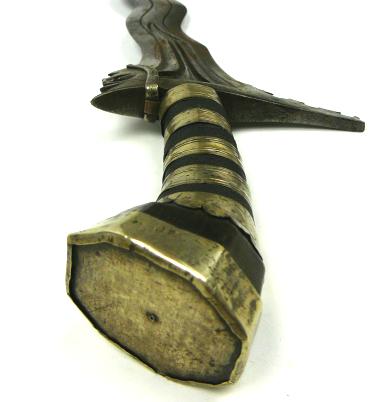

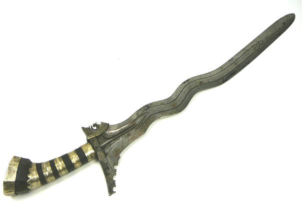

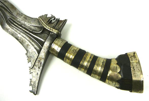

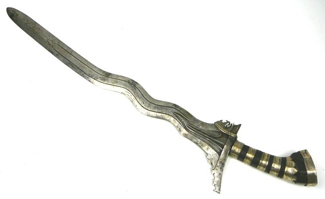

Dear All,
I would be very glad to hear your oppinion on this one. Original asang-asang (and probably the whole hilt) was another one, and there are some interesting markings at least on one side of the blade, something like a twistcore, ornament or letters. Could it really be from beginning of 19. cent., or is here something strange going on?
http://cgi.ebay.com/RARE-KRIS-KERIS-...item336501c85a
Length: 19.5 inches (about 49.5 cm).

I really doubt the handle and asang2x are original. The blade is old, most likely from early 1800's, but handle and asang2x is much, much later. As far as twistcore, it's impossible to tell with pics provided. I did see the smudge on one of the pics, but it could just be some type of forging flaw.

I agree with Ron, may be even slightly earlier as far as the blade is concerned. The hilt - later of horn and silver (?) as well as the asang-asang.
However I did notice the evidence of a twist core center down the blade. Please post better pictures when you get it. Also I would place this as possibly Sulu.

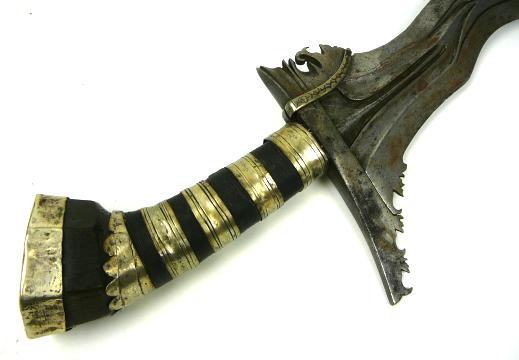

I KNEW this thread existed, it took me forever to find it again. I am now fortunate to find myself in ownership of the kris in question
Quite possibly one of the best quality kris I own in terms of craftsmanship of the blade. It turns out that it is a twistcore and I can echo everyone's sentiments when they say that the hilt and baca-baca are not original to the blade (Although it seems as though its current dress is a very old, very well done replacement).
What strikes me most about this piece is how differently it "feels" when held/handled. It seems to have the thickness and heftiness of a Moro Kris made later, however it is balanced closer to the hilt much like typical older Kris. I can also agree with Gustav in saying that it does seem very well-preserved and the base of the blade is very well executed. The lines and fullers are sharp, crisp, and smooth (Upon inspection it seems no one took a belt sander to smooth it out like you see with a lot of these twistcore bringback pieces. The laminations can be seen in person and the fullers outlining the twistcore seem to be deep and not worn down).
