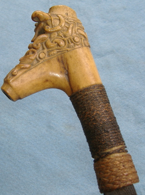

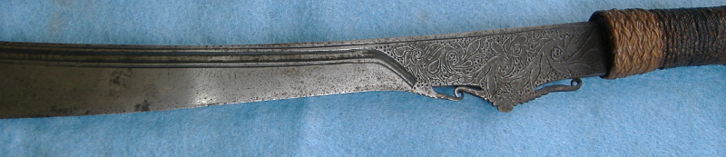

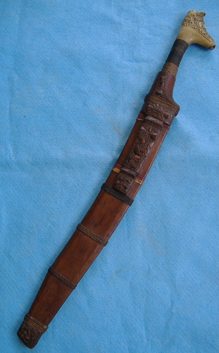

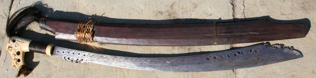

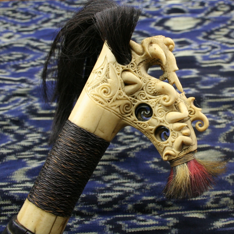

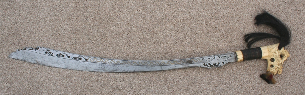

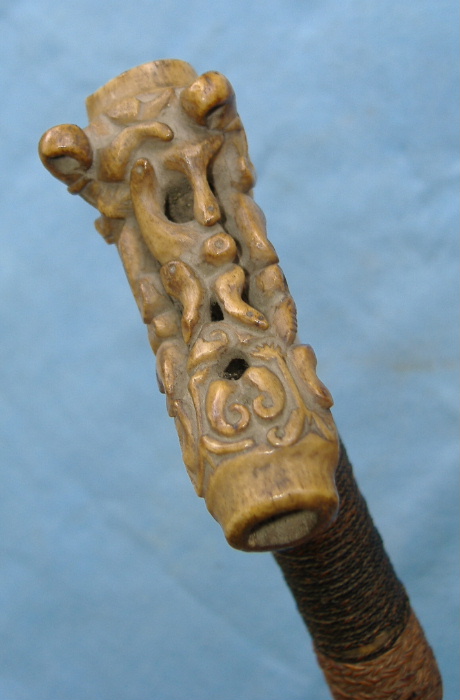

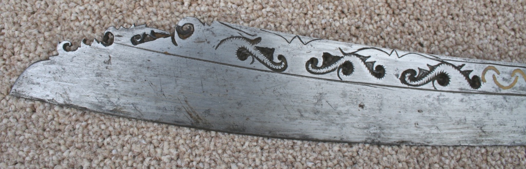

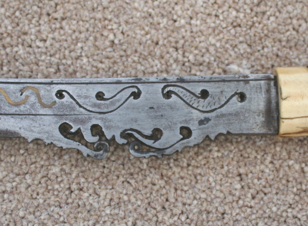

Were it 15 years ago I would simply have identified the sword pictured below as a Dyak mandau...on the assumption it's Dyak, so it must be a mandau.
Probably about 7 years ago I would have changed that assumption to rename it a jimpul...it is Dyak and curved, so it must be a jimpul.
I would have been wrong on both counts....
Over the last several years our Borneo specialists, most notably VVV, Maurice, MandauKudi, and Asomotif have proven to us that we can explore much more deeply the correct classification of Dyak weapons based on specific details and nuances.
Now I am trying to correctly identify the latest addition to my Dyak collection and I can best ascertain from Shelford/Banks that this is a tilang kamarau, and according the Shelford is a later addition to the Dyak arsenal(post 1902).
I am hoping the "Borneo gang" will chime in and tell me if I am correct or not and feel free to correct me if I am wrong and add anything, hopefully the likely location of its specific origin.

Yes Charles, you got it (a tilang kamarau, as described in Baltimore)
I would place it as from South Sarawak and the hilt might be later than the blade.
Maybe you should be a bit careful on using Shelford's date of 1902 as anything else than an indication on when he first saw a TK...

Thanks Michael! What features of the pierced hilt suggest that it is later than the blade?? It has a very nice patina.
Regarding the date, are you suggesting the type/style could be earlier, just unknown to him until then??
I just have the impression, based on the motifs and how deep they are carved, that this style of hilt is later.
It is always hard to judge age from pictures so I go more on the choice of motifs and the workmanship.
But if it has more patina than what it looks like on your pictures I might be wrong in this case.
On the date, I am a bit skeptic on Shelford stating a certain year without mentioning what he bases his statement on.
So if 1902 was the first year that Shelford saw them they might be a bit older.
But not as old as the parang niabur and even the langgai tinggang, of course.

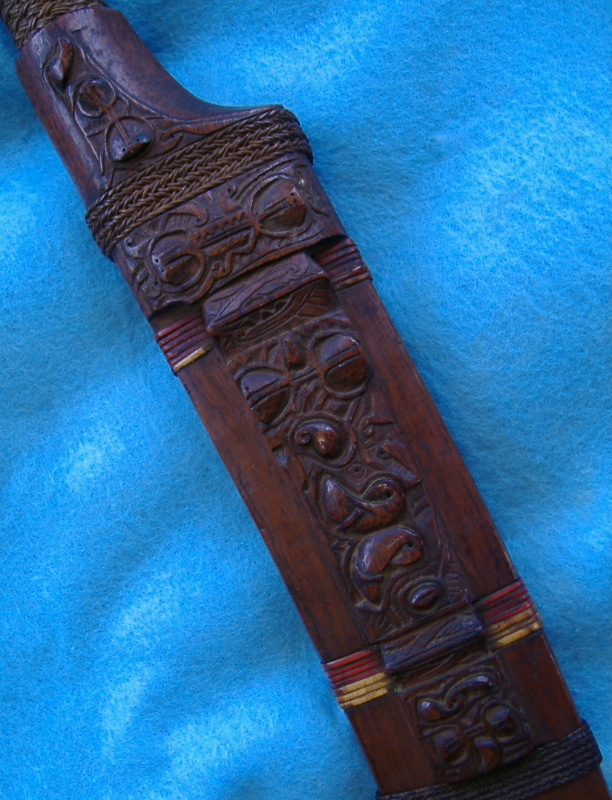

A Very Nice TK Charles!
I would classify this as a Tilang Kemarau also, based on Banks.
But if I was really an expert, I could tell you exactly the differences on all aspects between a "Tilang Kemarau" and a "Suai".
As I do have some ideas about it, I'm not sure about them!
But maybe nobody can tell the exact differences between those two, so we're only driven students of the few in the "top level"?

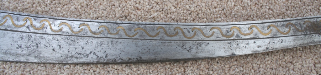

The blade looks very nice! I myself have the feeling that the blade is the oldest on the TK. It looks to me that the handle and the scabbard could be later and might be from the same date.
Michael described the hypothetis on the handle allready, which I agree upon.
I think the scabbard looks too perfect, and this in combination with the patina made me have this assumption of being also later.
Could we have a close-up of the carvings on the scabbard?
Maurice

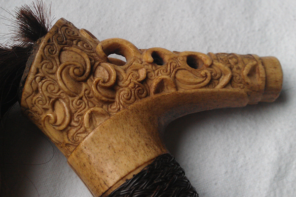

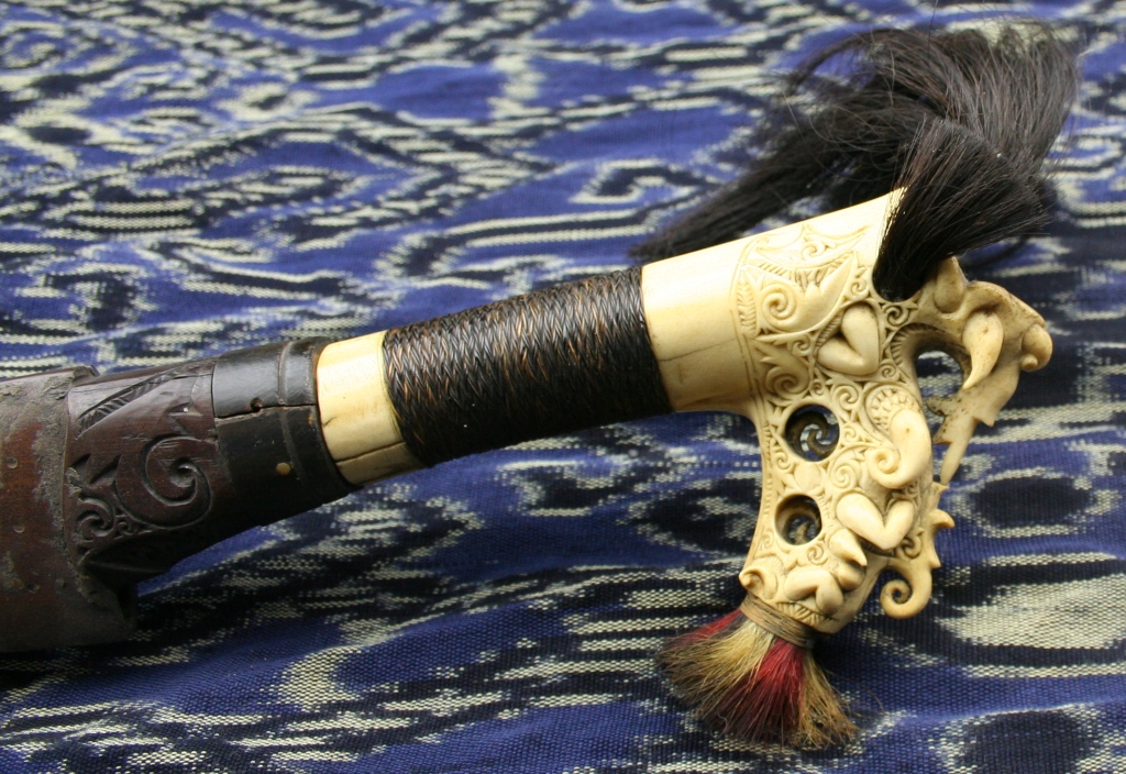

And also very old pieces can be in a too perfect state and with no or little patina when it's collected very early and since than stored at some attic or closet.
I have one with somewhat similar features considering the state and patina. Though the carvings are not very deep (besides of the big curls and the carving on top of the handle which comes out of the handle 3dimensional), the patina isn't that great one should suspect, but it is an old style handle.
PS. It's ex-Paul Vermeire and later ex-Coppens (though not depicted in the Coppens book).
I would love to see the carvings on your scabbard closely Charles!
Maurice

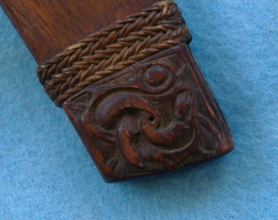

Old 21st April 2013, 03:15 PM   #9
CharlesS
CharlesS's Avatar
Location: Greenville, NC
Posts: 1,854

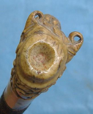

Maurice,

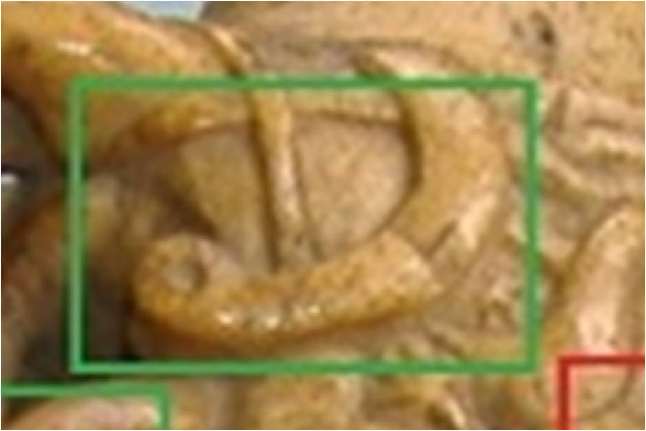

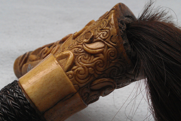

Here are some additional pics of the carving. Let us know what you learn from them.

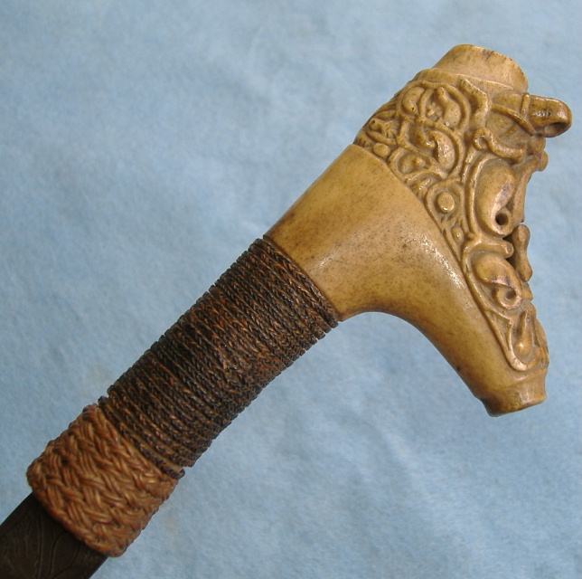

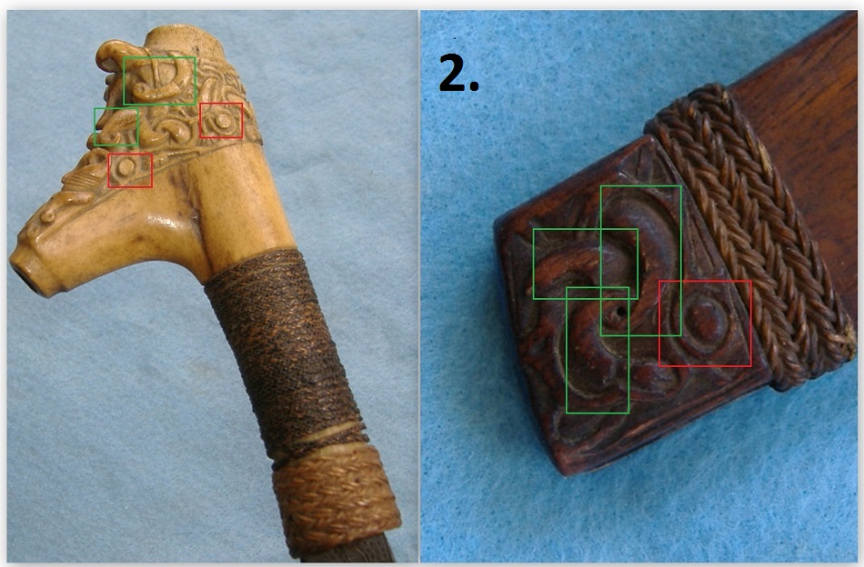

Thank you Charles for the close ups.
I have the feeling the handle and scabbard are from the same age.
There are a lot of similarities to be found, and they look like they belong together.

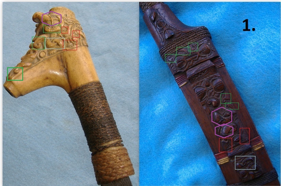

As the leeches and other motifs (circles etc.) are not uncommon on handles and scabbards of that area, the combination of some of them on the handle and on the scabbard are a good match.
For instance the little "impellers" (marked with a red square in image 1) on the handle we can also see in the scabbard.
And there are other marks which I also marked with different colours.
I hope you're not color-blind
Maurice

Smile Korambi?
Interesting: this leech(?) looks very much like a korambi!!
Actually, I think it is a korambi.
I don't recall, I have ever seen it before on a Borneo swordhilt.
Albert is offline   Reply With Quote

Albert you have great eyes....that surely does look like a korambi!

Quite unusual, indeed.
However, if it is a korambi then it is an additional indicator of a later date of the hilt.

Yes Albert,
looks like a korambi indeed.
However I think it's a coincedence that it's looking like a korambi, as there are more like these leeches (kind of curls with this little hole) made as decoration for the handle.
And which you're pointing out is the only one that happens to look like a korambi...
Maurice

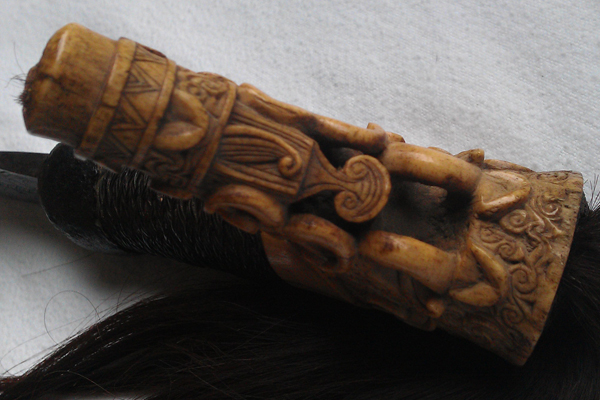

Hi guys,

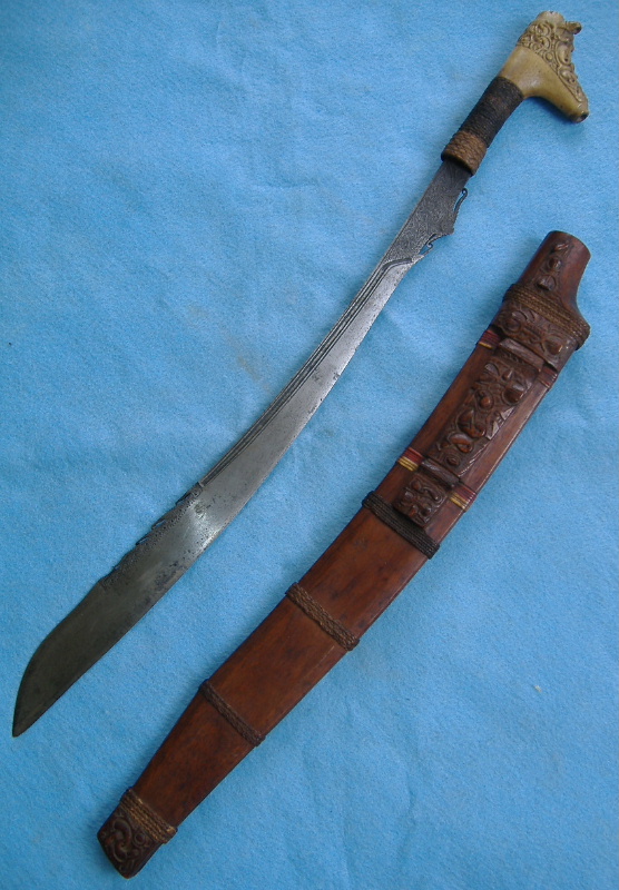

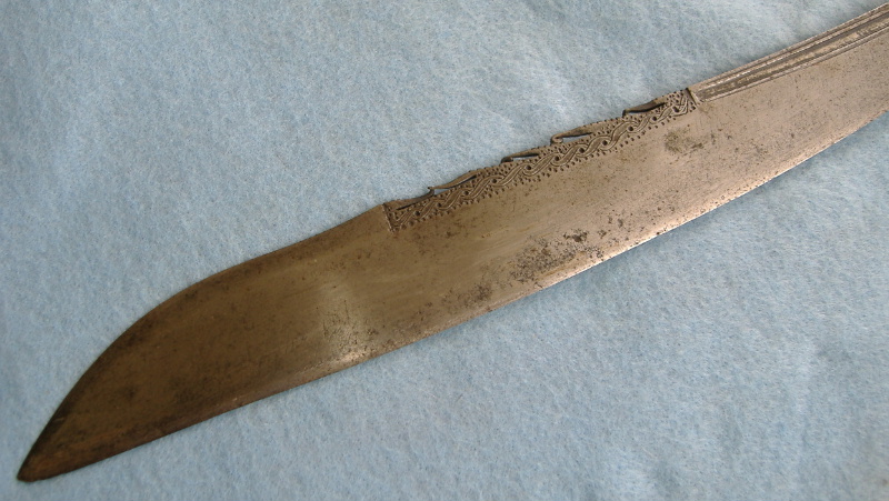

I'm doing a bump here, because I've recently stumbled across swords of this type and this thread is the first place that i hear the term tilang kamaru. Could any of you please post the 'Banks' and 'Baltimore' references in their full? I'd love to read them!
- thanks in advance!
All the best, - Thor

Hi Thor,
If you bought lot 7180 at your local auction house today the blade is a TK.
(Its hilt, however, seems to be an odd combo?).
The article is E Bank. 1935. Hoplology in Sarawak, The Sarawak Museum Journal, IV (14): 229-241.
Good luck and please post the pictures later.

*Michael* For the first time ever, I have a mom in law, who actually likes me, so I think it's just the mum in law-karma finally swinging my way.
*Roy* That one is clearly a common Parang Sellertomelang! Seriously though, that is a gorgeous hilt (not that the blade is boring). Very crisp and confident carving and delightful to see it still in such great condition. Thanks for sharing!
Cheers, - Thor

Roy,
Your T.K. is an interesting and unusual hybride of elements from Sarawak as well as Central Kalimantan.
Even if it is probably 20th it seems to be a one of a kind...
I have read the latest article, too, and it is mostly a discussion of Shelford's and Banks' articles.

Thanks Gentlemen
Thor, I prefer the name "Parang Staysonmywall"
Cheers
Roy
