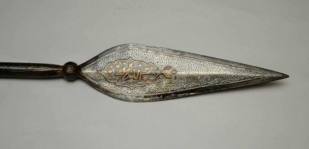

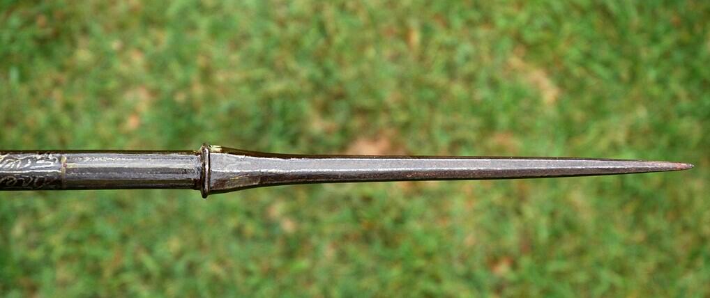

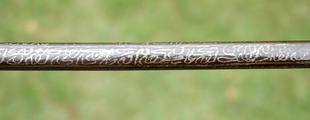

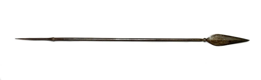

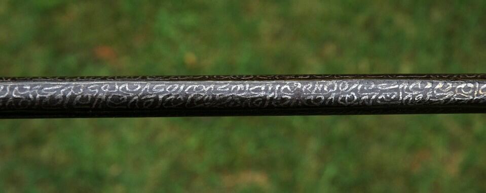

Hello all,
I recently bought this short Indo-Persian spear. It was a foolish impulse purchase (I was cruising on a wave of recent successes). I really don’t know what I have here, I hope I haven’t blown my money. It came from the estate of a noted collector, but “in the hand” it doesn’t feel quite right. Can anyone shed light on its origin and perhaps a translation.
Cheers,
Russel

Interesting item - what's the length? Perhaps my sense of scale is off, but it looks more like a throwing dart/javelin to me? But the head shape would be peculiar for that.
looking forward to reading others' comments, insights into this one!

Sorry, I should have mentioned length. 128cm. I'll weight it when I get a chance.

Hi Russel
Another interesting piece. I think this belongs to that genre of Sudanese weapons and other artefacts, supposedly from the Mahdist period. The stylised acid etched "thuluth" Arabic is typical, as is brass wire inlay. Sheet iron is also often used. I've seen the following types of objects falling into this category - swords, various daggers, axes, throwing knives, maces and processional standards "alams", but never a spear such as this... I have seen the coffee pot motif on some items before.
A nice piece, congratulations. There are other examples of this genre to be found on this forum. Some ascribe these objects to the Mahdist period, however I feel that a portion of them at least, were produced post-Battle of Omdurman for sale to Europeans. Often they appear non-functional with a more decorative quality.
Regards, Colin
PS. It also has the appearance of an African spear - so possibly it could have been for use of leaders of those elements of the Mahdist army that were of black African origin. This is a theory that has been put forward in respect of throwing knives of a similar style...

I was thinking about the Sudanese possibility as well Colin. Perhaps a member can make out something of the script? The crescent and star symbol seen on the blade was of course common in the Madiyah and Khalifa - see attached image of the Mahdi's tomb taken in 1936.
