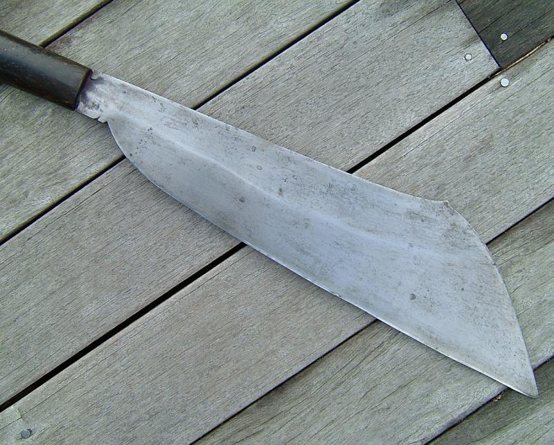

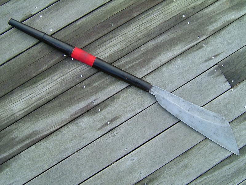

Whereas the pisau raut is intended as a tool but could be used as a weapon (most anything with an edge can) , I'm really not sure if the toa is a combination axe / weapon .
Given the weight and size of the blade and the two handed grip the toa would be a most efficient weapon and a good jungle axe too ; very much like the panabas .
My example is 34.5 inches overall with 20 inches of haft and 14.5 inches of heavy blade .
Okay , I've been through Van Zonneveld's Traditional Weapons and after reading his description of the toa I get the impression that it is a fighting sword from his text .
He also notes that most toas have a horn ferrule with metal being the rare exception ; IMO horn would not stand up very well to use on hard materials such as wood but it would be acceptable if used on softer materials like one's fellow man .

While I agree that horn might be a bit soft, Looking at your toa and the original one on oriental arms, I'm a bit confused. It looks like the handle is segments of horn, strung together on....what? The tang of the sword? If so, the whole thing might be sturdy enough to go hacking, wood as well as heads.
Admittedly, I know nothing about the island of Solor, except that it's small and apparently had a Portuguese whaling port on it (if one believes wikipedia). Just at a guess, the "jungle" that these toas would hack through could easily be second growth scrub, rather than great big trees.
Interesting blade.
F

It's hard to figure out the actual haft construction . The area covered with red cloth on my example is wood .
If I were to guess I would say that the tang of the blade is probably not more than half of the blade's length and that the entire core of the haft is wood with tubular horn sections covering the core (I can find no seams on any of the horn sections) the butt end is an ovoid metal (brass?) plate secured by two nails or rivets of the same material .
Again , Mr. Van Z. makes no reference to this being a multi use implement but simply says that : " both hands are used when striking " and " The heavy broad blade has the effect of an axe and can be lethal ."
I would like to know more about this interesting sword .
