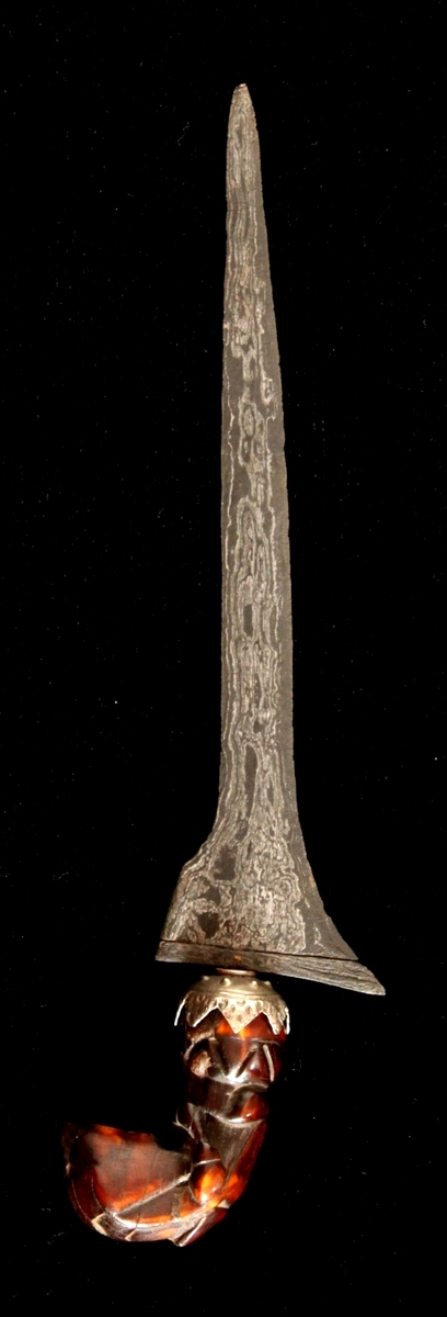

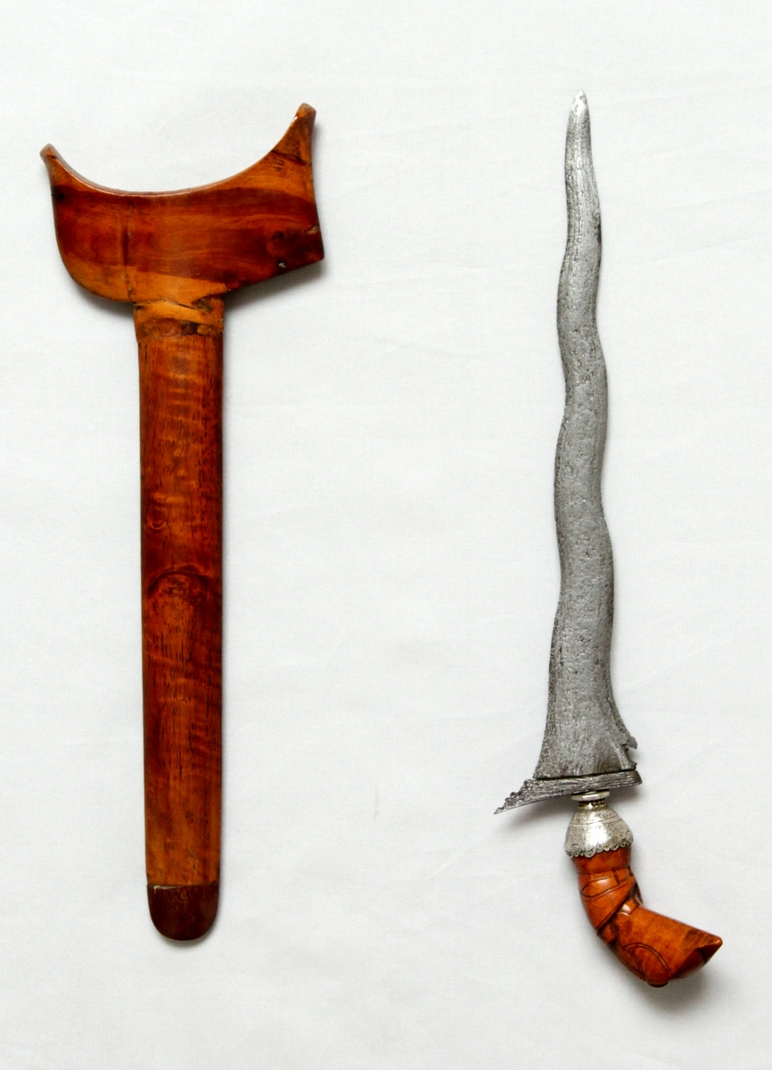

Dear forumites,
I own a number of small krisses from Sumatra (blade lenght less than about 10 inches or 25 cm excluding the peksi). All of them look original with one possible exception, and I would like to know for whom these pieces were made (women or children?). Your input will be welcome.
Their descripion is as follows from top to bottom of the pictures:
. Kris from Centre Sumatra?, blade lenght 19.5 cm
. Kris Minangkabau, blade lenght 21 cm
. Kris bahari, blade lenght 25 cm (possibly shortened)
. Kris Bugis East Sumatra, blade lenght 23 cm
. Kris from South Sumatra, blade lenght 22 cm
. Kris from South Sumatra?, blade lenght 24.5 cm
. Kris from East Sumatra?, blade lenght 24 cm
Thanks in advance and regards

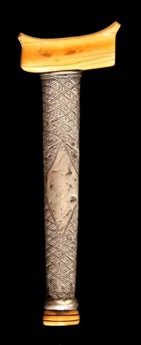

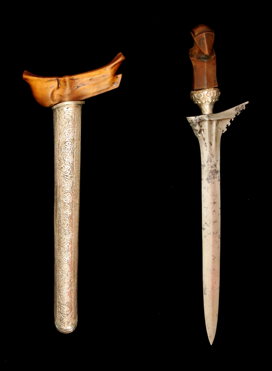

Additional pics

A nice collection of patrems. I especially like the first two. For some reason i really like this type of keris.
Forgive my ignorance here, but i have found so little written on these little blades. Is there a tradition in place of actually giving small keris to young children. Given one of it's traits as being a symbol of manhood that would seem odd to me. I would think it more likely that a boy would not receive a keris until he becomes a man, at which point it would seem an insult to present him with a purposefully smaller blade. Of course that goes right out the window with the idea of a keris for a woman, but at least these are adult women. It has been suggested to me in the past the the patrem is reserved for woman of a certain higher status (perhaps why we don't see a ton of them). Since i am interested in them and own more than a few myself i would be really interested in what anyone might have to add about the cultural application of the patrem.
