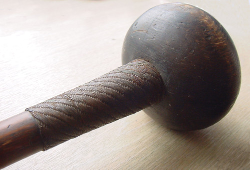

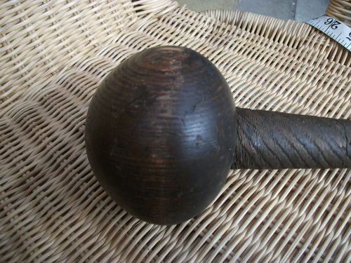

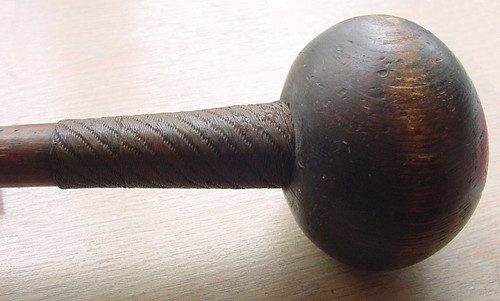

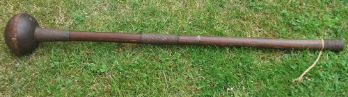

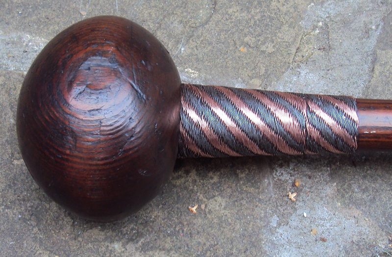

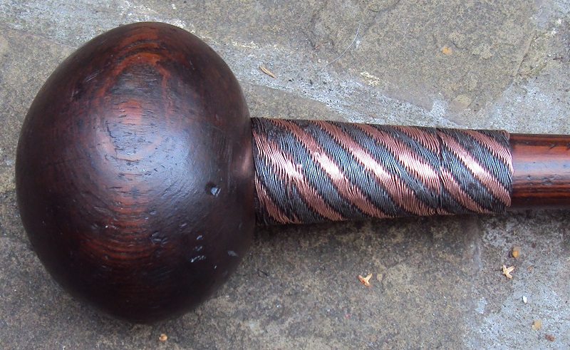

Nothing unusual here standard form and wire decoration. I just want to show the world how I spent this Sunday morning, as it is now possible. Got this for very for little cost. Another decade or so of neglect and it would not be retrievable without wire loss. Interesting that the wood has an open grain not dense like so many dark kerries. It looks very much like some kind of palm wood. Fingertip rather than elbow grease plus a little oil. Looks nice now.

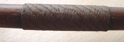

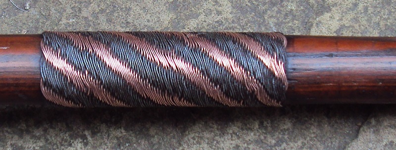

It looks great Tim.
What method did you use to get such a fine finish on the wire work?

Thanks Gavin. Copper will clean with an oil cloth but the steel wire is more of a problem. I use "hammerrite" rust remover dip. It does not etch metal like other rust removers. If you are working on an engine part you are meant to dilute it with water and leave for 24 hrs. On a weapon I use it neat. A wire brush will only do more damage. So fingertip work cutting tiny pieces of light emery paper, folded to form a stiff edge and just gently rub until your finger hurts. Then rub down with a cloth. Looking into South African palms and I think the club is old. The kosi palm has, had, a limited distribution. A small area of KwaZulu Natal. Although I cannot be sure of the wood it is none the less interesting and I may be able to say that this is a Zulu knobkerry.
