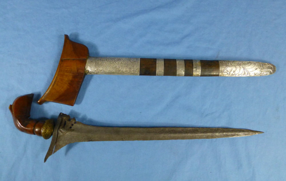

This was identified as a Bugis Keris dagger. Comments?

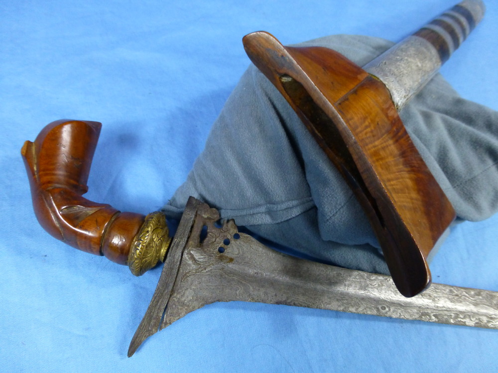

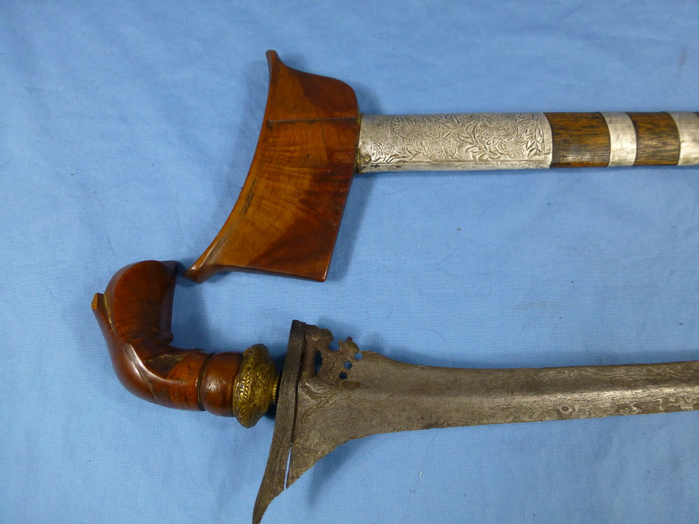

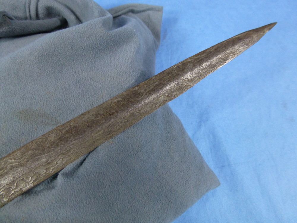

Default More photos
Comments welcome.

Yes, interesting kris from East Sumatra or Malaysia?
Old 12th August 2013, 09:24 AM   #4
My best guess would be that it is a Riau keris or maybe a Terengganu keris, would like to read the comments from our Malay members and Gustav.

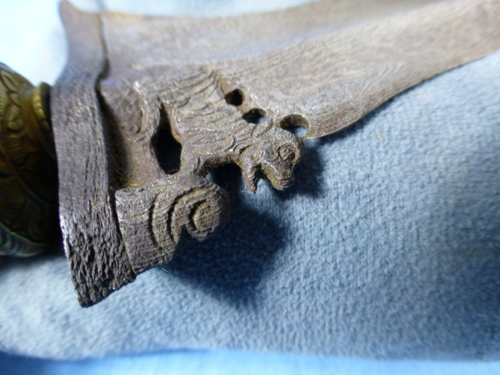

The other question is if the singha (?) carving at the gandik is original or a later addition. I also would like to see the hilt from the front.

I agree with Sajen. The blade is not Bugis, does it fit well into the sheath slot? (original matching or not?).

Hello Marcus,
Judging from the fittings, this is a northern Malay keris - possibly Terengganu, might be from further up North as well. How well does the blade fit the scabbard??
I'm convinced that this is a later alteration, indeed. Tip of the blade is also redone. IMHO an old, genuine blade got ruined - sorry for the bad news.
I'd second Detlef's request. The hilt seems to have some age but I can't place it yet. (IMHO probably N Malay, too...)
BTW, try carefully to remove that glue between hilt and selut.

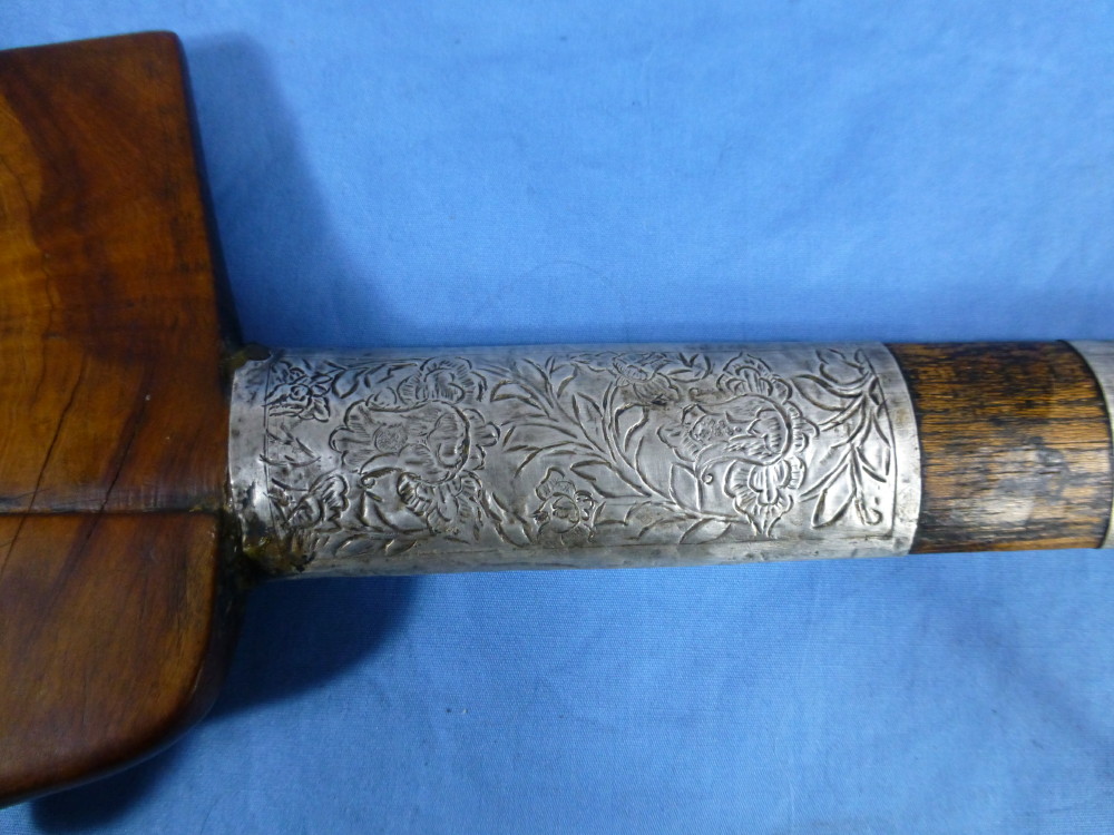

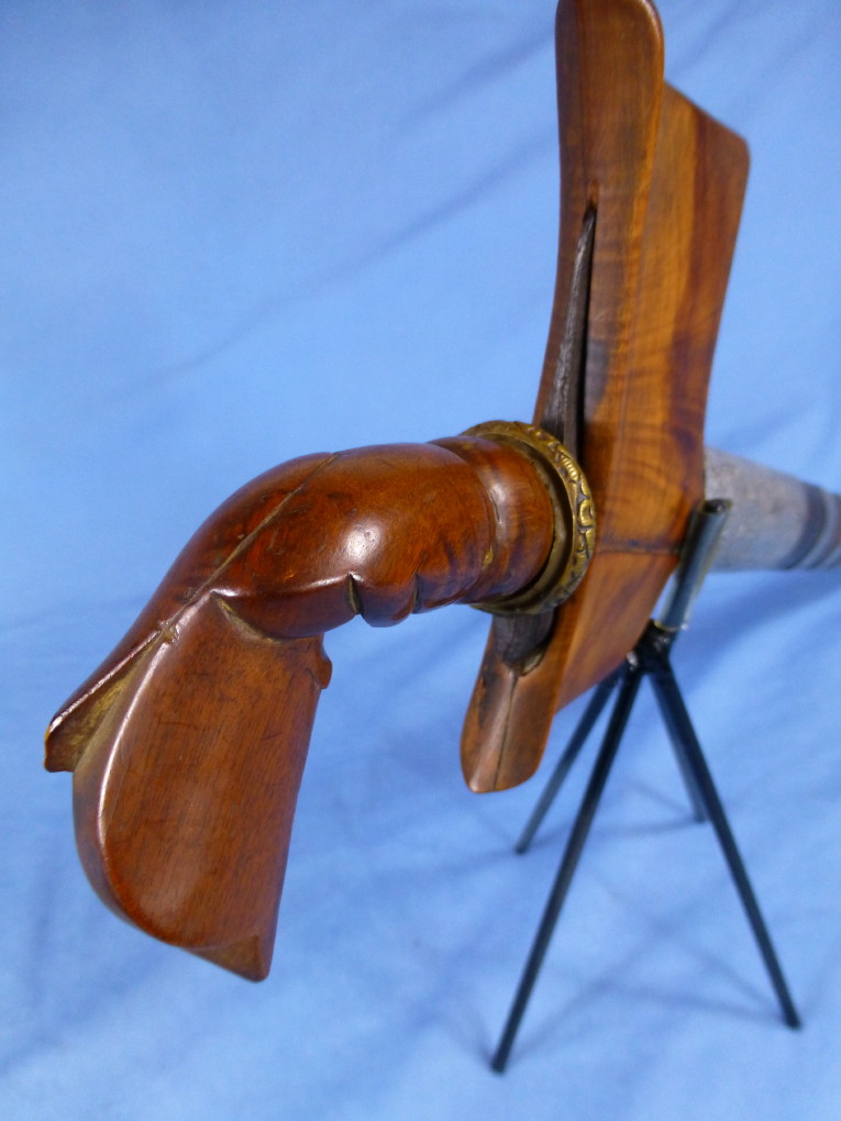

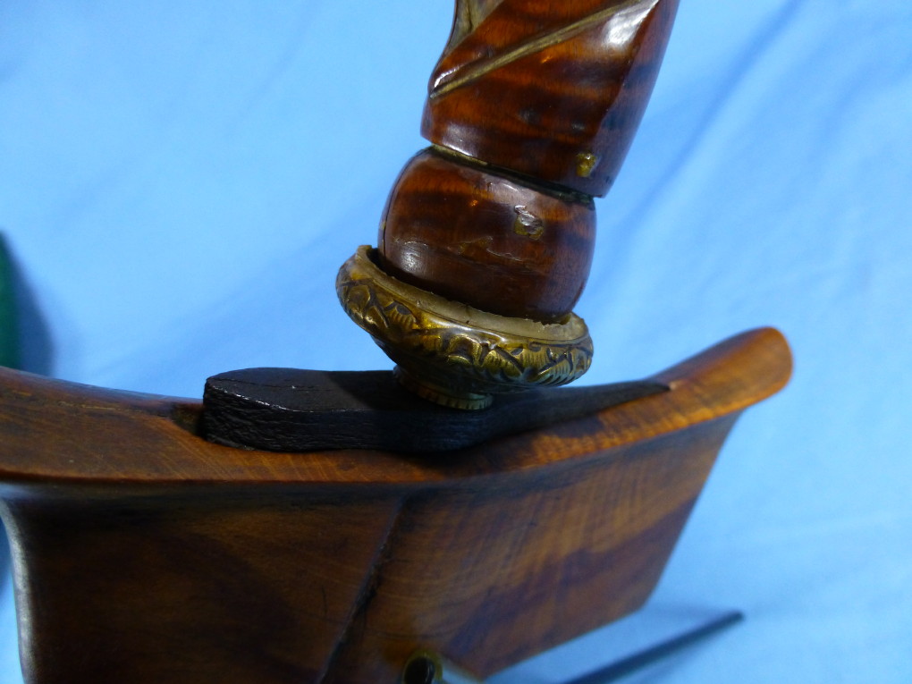

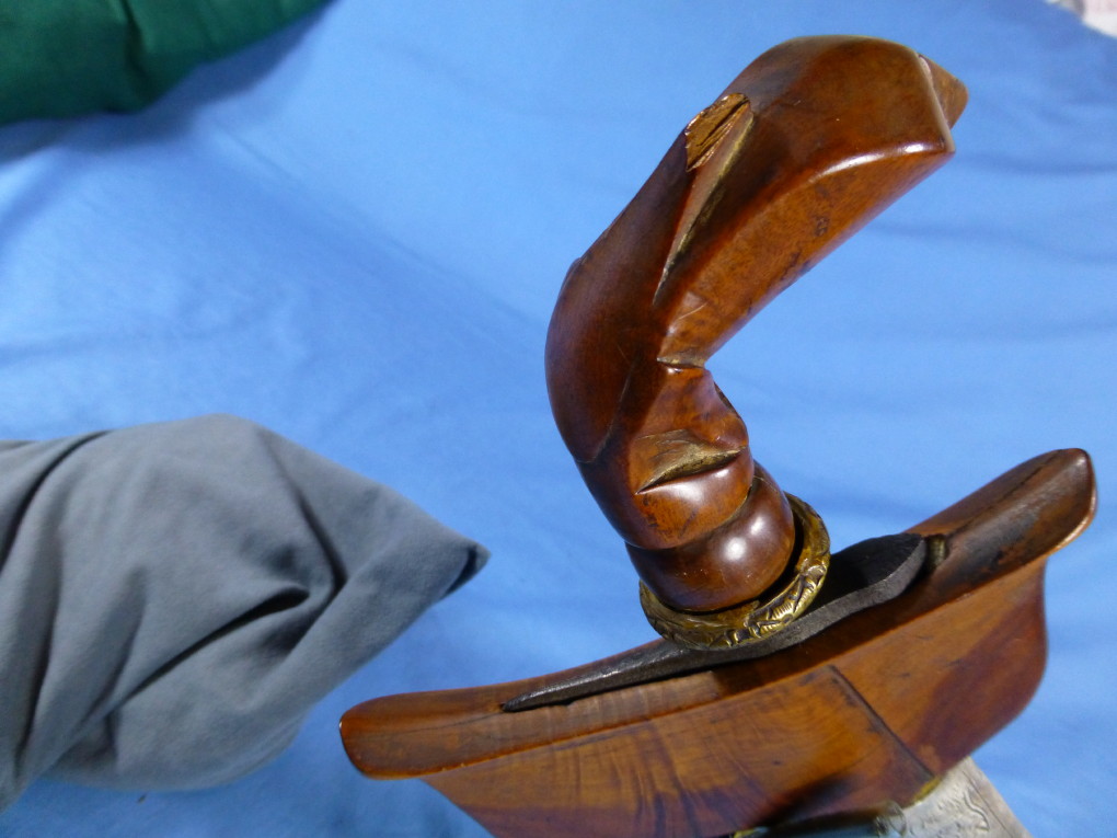

Old 12th August 2013, 10:45 PM   #7
Marcus
Marcus's Avatar
Join Date: Oct 2005
Posts: 420

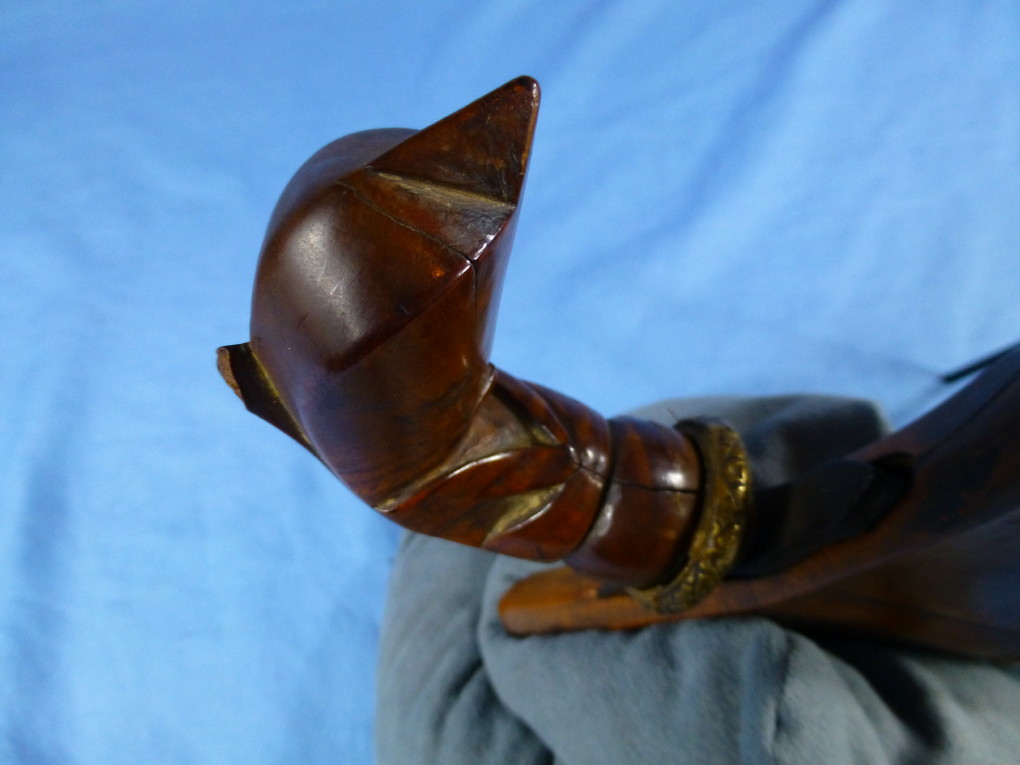

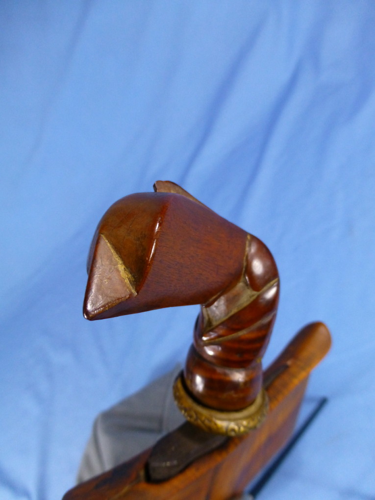

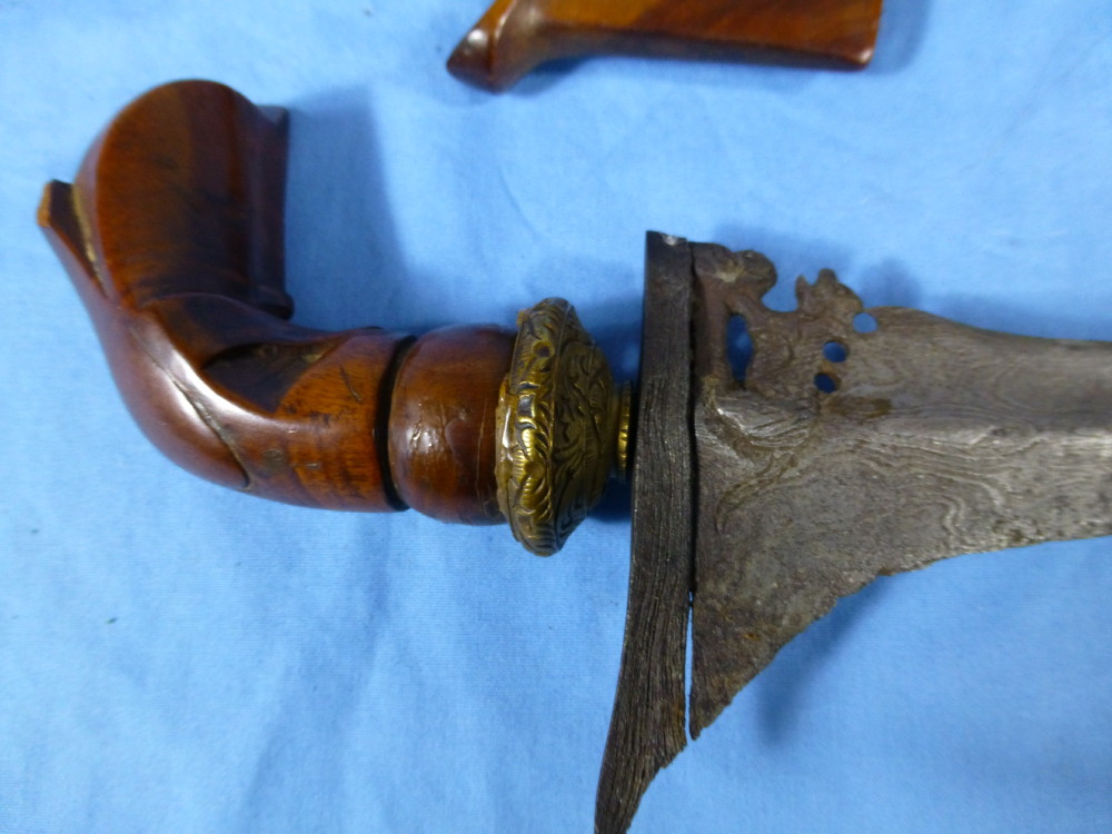

Default more pictures
Hopefully the angles requested.
Old 12th August 2013, 11:00 PM   #8
Blade could be originally to the scabbard, difficult to say without handling. But now I think to see that the pendokok is to big for the hilt. Hilt byself seems to be Terengganu.
