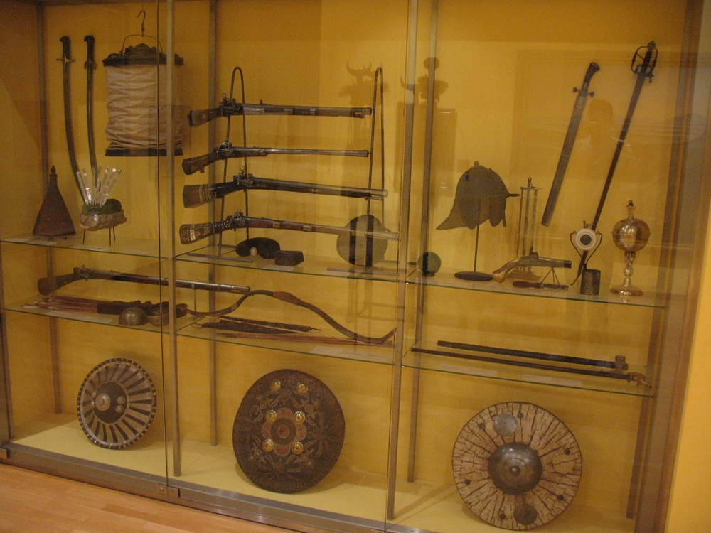

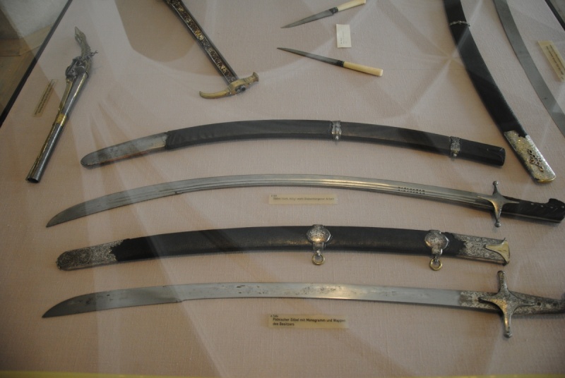

Just for fun's sake, here are pictures of karabelas from Vienna: the first one is from the Military History Museum, and the other two from a display in the Vienna City History Museum. I took a close up a few years ago when I was there, but it is too blurry, so I am posting picture of the entire display. Both displays are dedicated to trophies, taken during the second siege of Vienna (except for the Ethipian presentation shield, which the curators must have misidentified and misplaced, of course ).
I am also adding a picture from the Army Museum in Ingolstadt: it may have been posted here before, I do not remember where I got it from.

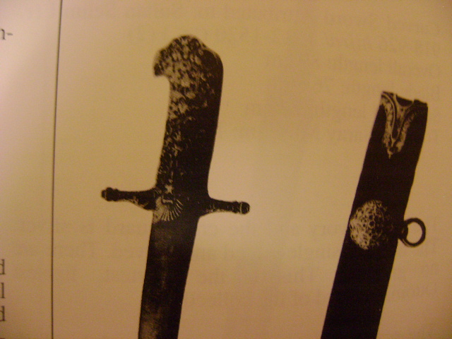

Here is a pic from Yucel's book about Topkapi collection. Usually, the authors are very fastidious about potential alterations to the swords and their furniture, not sparing even the examples attributed to Muhammed, his companions and the first Caliphs.
This sword has no corrections and equivocations. In the authors' opinion, therefore, it is as original and pristine as can be.
It is dated to early 10th century Hijra/16th century CE. Signed by Ahmad al-Tuqati, embellished with Seljuk motives.
Thus, Turkish "karabela" handles were in existence at least 100 years before Shah Abbas I, the purported "inventor" of that style traipsed to Karbala.

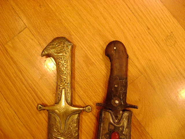

And here are 2 Yemeni Nimchas, 19th century, with rudimentary "karabela" handles. Ottoman Turks " were there, done that":-)
Salaams ! Ariel whilst Ive now sorted out my camera in support of your Turkish style hilt with a picture of a sketch of Selim the Grims son Suleyman the Magnificent and Janissaries with swords ~ The date of the engraving is 1559 A.D.
I might add that the cross guard of the style you show at your last post (left above) is normally Saudia in form.(According to Buttin).
I agree generally that the Yemeni style is as you show though it can have a variety of guards. It is, however, of the group Zanzibari style...One could pontificate all day about which pot it was boiled in but there it is; according to Buttin.
My only caution here is that you have almost entirely written off the influence of Syrian and Iranian form in its entirity whereas I can't do that since there was a lot of cross polination in style...
