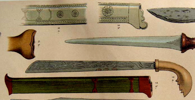

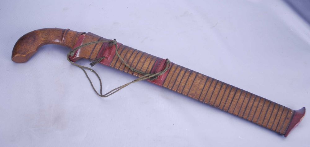

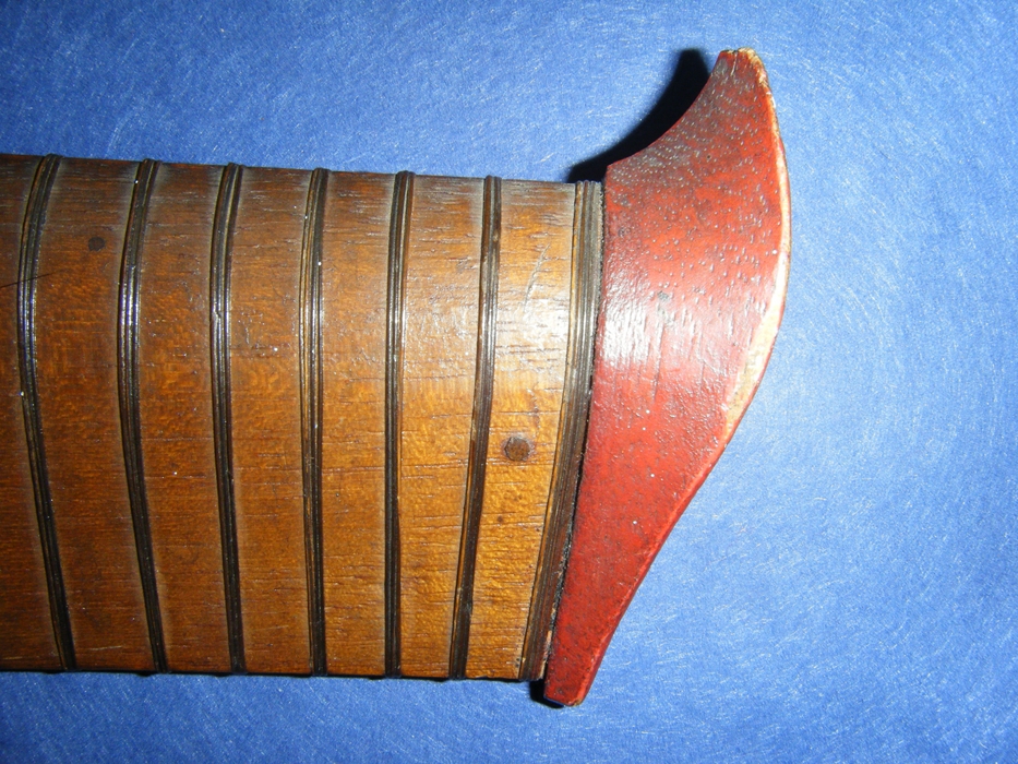

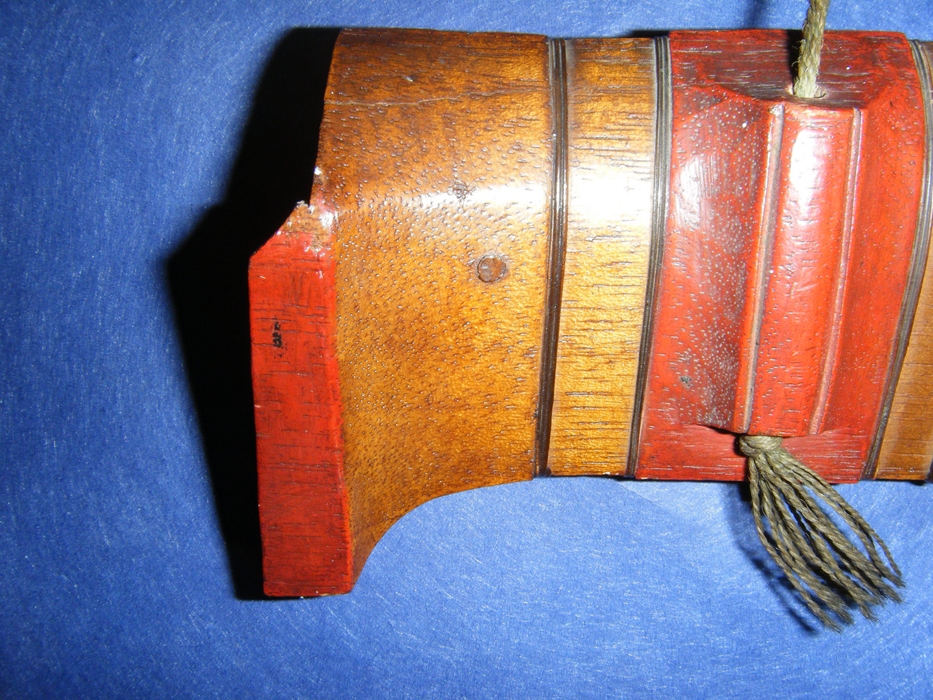

Have given a bid to this parang which was offered in a small german auction house and it seems that I have won it, the list of the results isn't shown until now. There was shown only one picture so my bid was small. I think that it is a parang kerekoepang from Banjarmasin. The first picture shows the parang, the second a picture from a Schmeltz plate. What do you think?

Yes, it seems to be a rare Banjar parang - congratulations!
I look forward to see the blade etc. when you have received it.

Yes I agree!
Very nice complete one! Congrats with this nice find!
Nice to see the scabbard tip is still there..

Detlef,
Nice banjar parang. right out of the books.
Any news yet if you actualy won the auction ?
Looking forward to pictures of the blade.
Hopefully it will be in the same condition as the scabbard.
Willem

Congrats, Detlef!
Looks like an average man's parang with a plain hilt style. Great to obtain a complete example with even all but one decorative rings still present!
Some of these Banjar blades have really nice pamor - am keeping my thumbs pressed for you. Please update once you receive it.

Thank you Maurice for the explanation.
Someone know from which substance the red paint is done?

Usually the red color on Banjar weapons is from Dragon's blood (it is a local plant resin, not from "real" dragons).

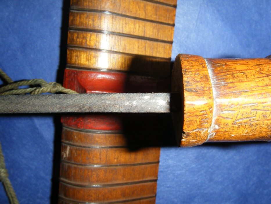

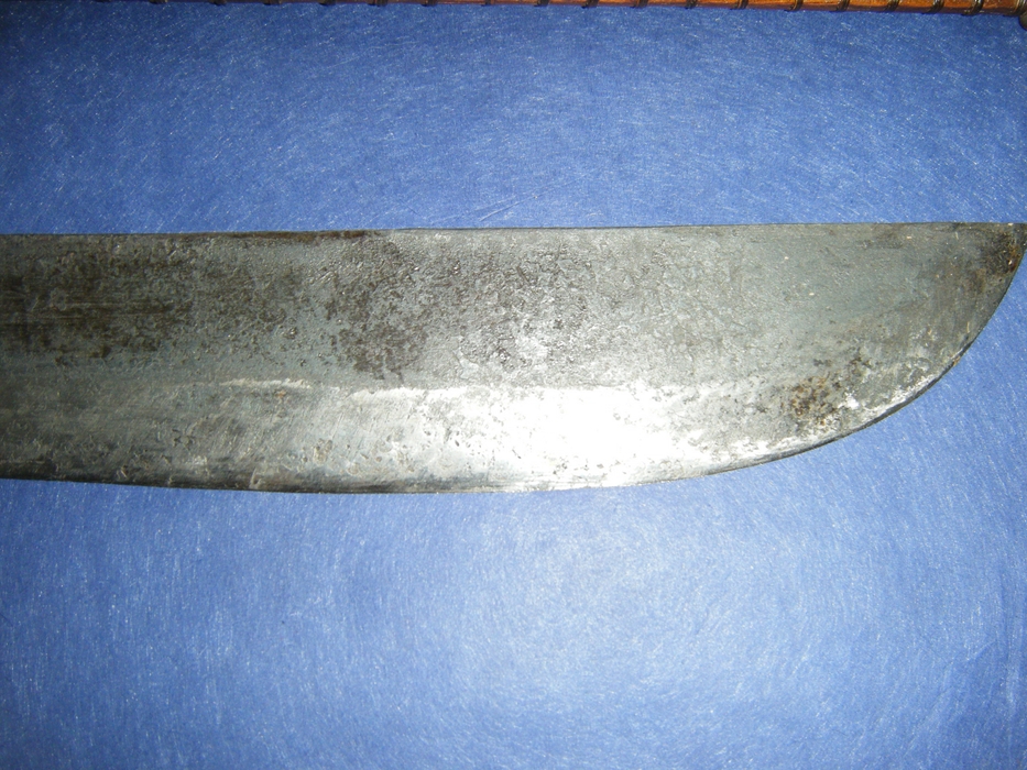

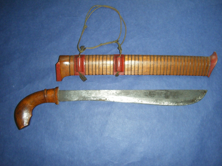

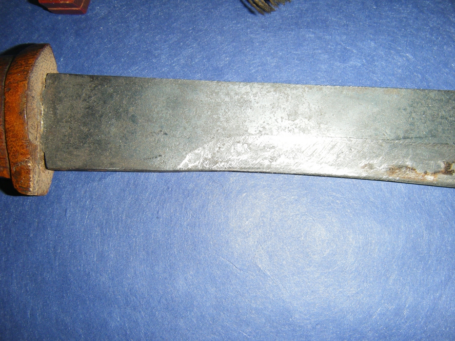

Yesterday I received the parang and it was disappointing, the blade is forged from monosteel. While the parang seems to have age it seems to be unused. Will look if the auction house can give me informations about the provenance.
Someone know how long this parangs are "produced" in Banjarmasin?
Old 29th June 2013, 10:57 PM   #19
Posts: 7,263
Detlef, I'm guessing that your disappointment is rooted in the fact that this tool was not made from material that has been folded and forge welded?
Personally, this would not disappoint me.
Working tools are normally made from the best material available. In Central Jawa working tools were being made from railway line and other material sourced from outside the country from at least the second half of the 19th century.
Where a tool or a weapon --- and a weapon is simply a tool with a specific purpose --- is produced for some cultural purpose, such as is the keris at the present time, we can expect to see traditional forge techniques of forge welding, pattern welding and so on put into practice, but where a tool or a weapon is produced for actual use as a tool or weapon, the smith will use, and his client will choose, the best material available. In the areas of SE Asia that I am familiar with this means spring steel or some other modern type of steel that can be properly heat treated to hold a working edge.
I believe you have purchased a tool that is correct for the time and place where it was made. I do not see this as a reason for disappointment, particularly in view of what you have said about the price you paid.
Old 30th June 2013, 12:08 PM   #20
Thank you very much for your thoughts and explanation Alan. And I am sure that you are correct. My disappointment was for the first moment since I have thought that all this Banjar klewang have a pamor blade but i am sure in the meanwhile that this klewang in question is an early collected item and wasn't long in use. A other member told me nearly the same by email like you have written.
