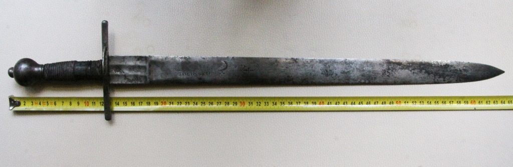

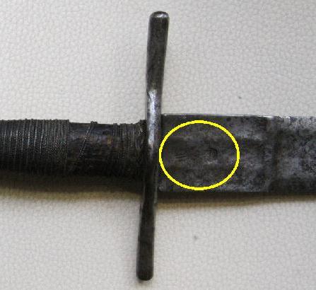

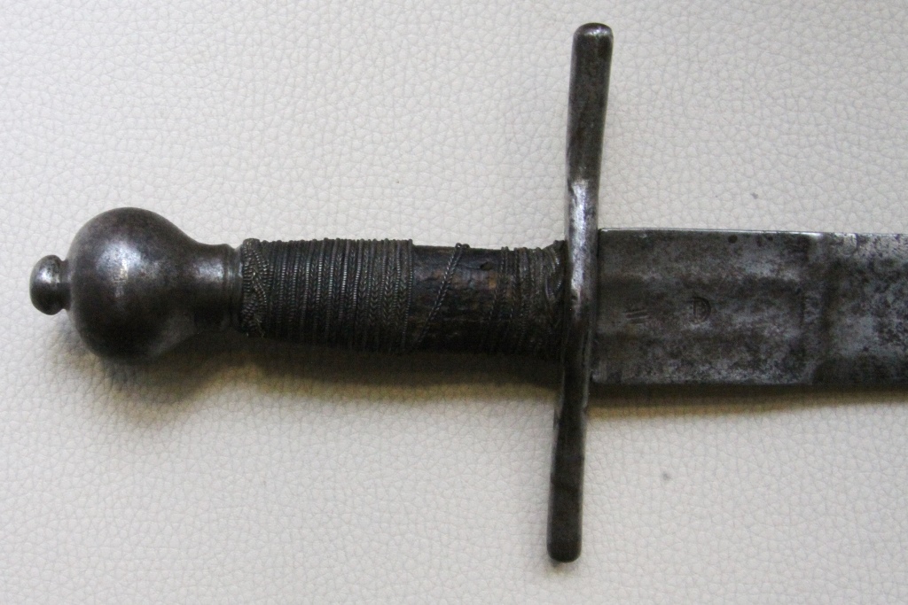

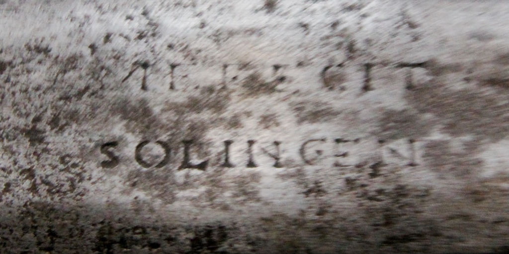

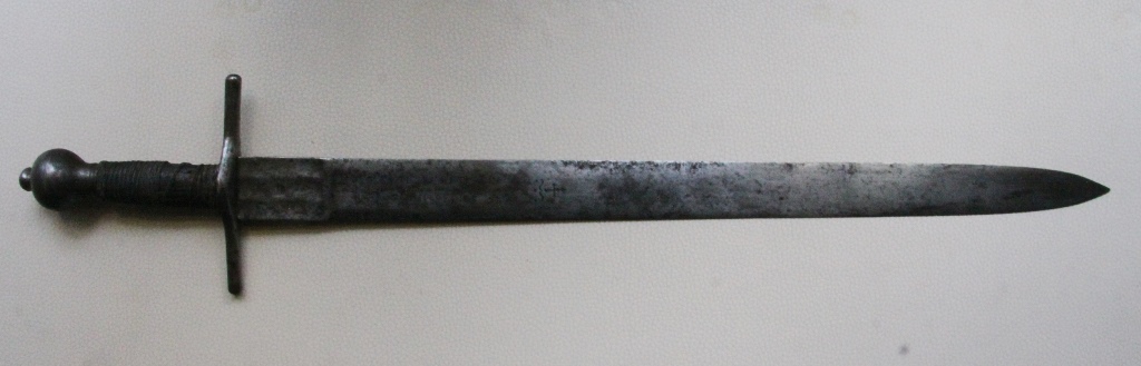

Hi everybody ,
I would like to have opinion's of members about this small sword.
I wondering if it could be early 17 TH century or 16 TH.
Any comment on it will be welcome.
Cerjak

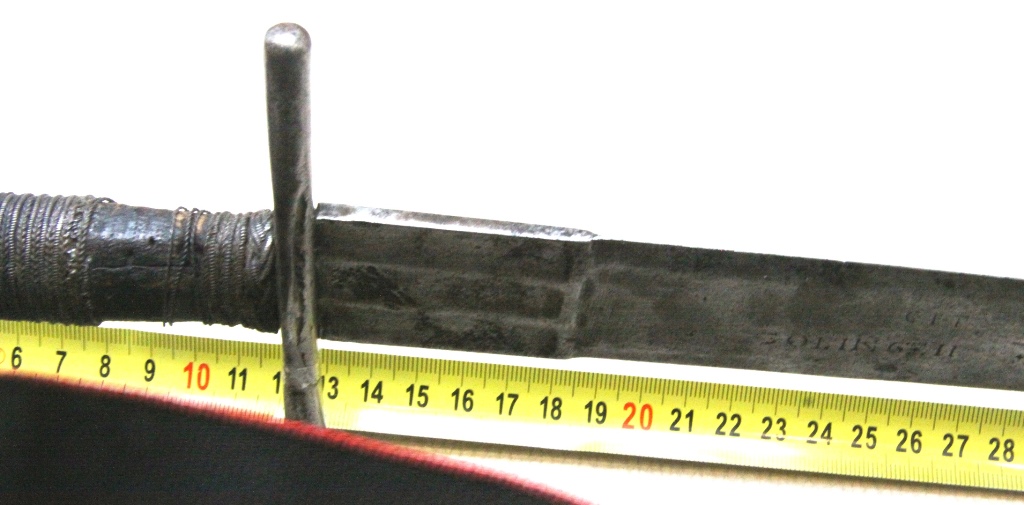

Hello:
Obviously, the inscription reads: MEFECIT - SOLINGEN and cross punch by imitating the mark is seen in the guns (barrel) Spanish
Affectionately. Fernando K
Old 9th June 2013, 03:58 PM   #3

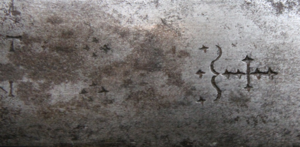

I wouldn't call that cross/anchor mark an imitation.
Certainly this is a composition. Shortened blade ... from a katsbalger ?
The grip wiring looks fine, with those turks heads. Maybe the pommel and crossguard are not the real thing .
Could you improve the picture of that mark in the forte ?

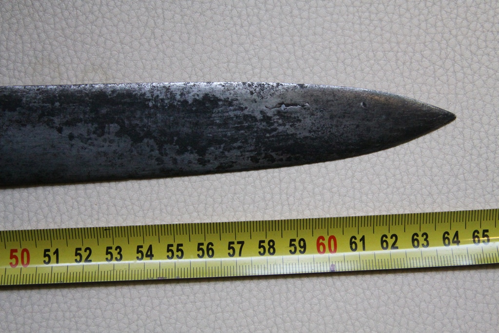

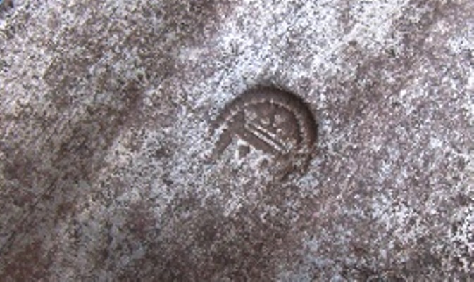

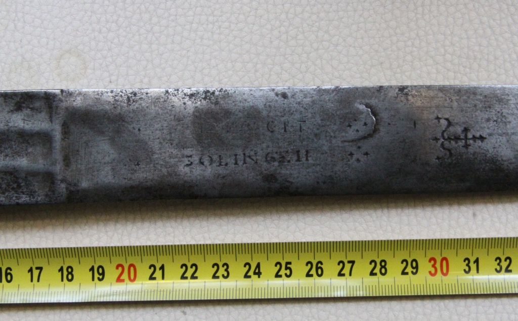

Hi Fernando
This is a close picture from the mark
Old 10th June 2013, 12:15 PM   #5
Maybe through that image some member could ID this blade ...
Old 10th June 2013, 07:46 PM   #6
Posts: 10,870
I have not yet found a match for the stamped mark at the forte, but in Wagner ("Cut and Thrust Weapons", plates 2,3, pp.182,83) there are interesting sword examples which offer certain similarities I think pertinant to assessment of this example.
In #1, plate 2, the hilt with alternating curve (s shape) quillons is shown as a mid 16th century form with Swiss attribution suggested. The deeply channeled forte is remarkably like those on this example, and the 'makers' stamp in the same location in the center channel at the forte.
The blade in Wagner is however channeled in the same manner, and the lettered SOLINGEN stamped in two of the four blade channels, above and below in the same manner as the ME FECIT SOLINGEN on this example.
The serifed font seems similar and it is noted that the ME FECIT combination is contemporary to the period suggested. The quadrant placed crosses which appear to encapsulate the words ME FECIT and Solingen, are also consistant with the style of the period with names, phrases and mottos. The 'anchor' typically is considered to have key nuances with crosses and Christian imbuement in amuletic properties on blades.
The crosses and 'anchor' style device is also consistant with German blades of the period using Spanish names, marks and other features, as seen in the ENRIQUE COEL sword in plate 3 (1590-1610). On that sword the rather plain quillons without notable terminals are apparant, and the pommel type, turks heads and wire wrap seem consistant with Continental swords of the 17th century through.
The stamped mark en cartouche seems to be a crowned M(?) similar to and similar to those on Spanish and Italian blades. There was significant crossover and spurious use of these marks between both and further complicated by the use of these by German smiths.
Similar swords to this with the simple crossguard configuration are seen in Wallace collection and in cases with earlier blade, identified as German around 1600. This is not to say these are matching, but that these kinds of simpler hilt arming swords were present with less developed hilt forms, and suggesting likely 'recycling' armaments to servicability as required.
I would say this blade is plausibly mid to later 16th, and as suggested likely from an arming sword from Landsknecht context. It seems also likely that the blade may have been shortened as the sword was refurbished, probably in the 17th century.
While I would defer of course to Jasper for elaboration of Fernandos well placed suggestion, these are my own observations on this very outstanding example.
This mark seems to be a crowned tower may be it will help you for ID

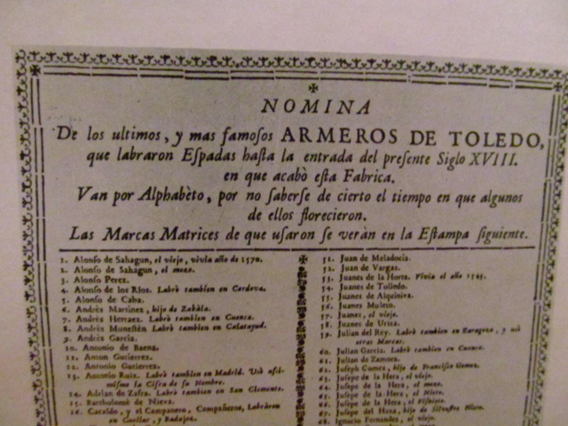

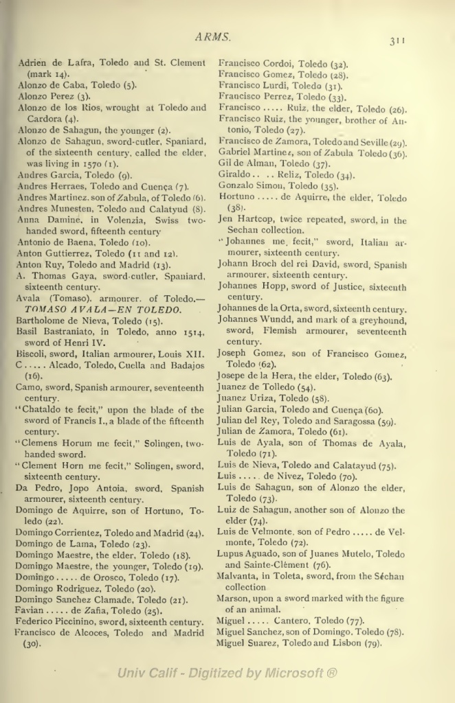

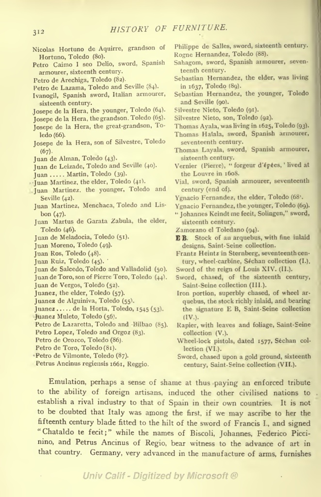

In the catalog of the Royal Armoury, 1849 Gunsmiths is a Payroll of Toledo who forged swords, with drawings of his punches. At number 47, Juan Martinez Menchaca, there is a punch with a crowned M

Juan Martinez Menchaca. Styled also in Lisbon, Seville and Madrid. He lived in the early sixteenth century. This swordsmith had a son whom they named Menchaca the Younger, who was also swordsmither Toledo, and worked in Seville, Lisbon and Madrid. (same source)

The blade was probably period-shortened. I have seen several near identical Solingen blades with multi-fullered ricassos, dating to the end of 16th c. They reused many sword parts back then. Doesn't mean it's a recent composite, just a munitions-grade trooper's sword from the mid-17th c. with an earlier blade.

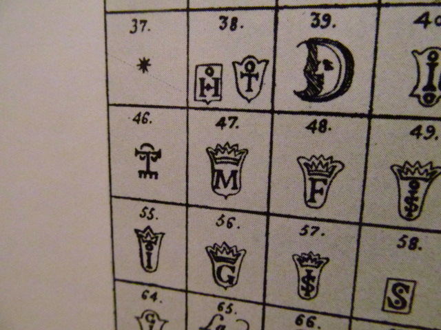

You're very welcome Jean-Luc, Im glad I could offer some useful info, and thank you for the great image of the stamp at forte. I will work at getting scans of the Wagner pages and enter them here.
Fernando K nicely done on identifying the mark!!!! I guess it was an M after all I dont have that catalog, only the Palomares plate from Calvert.
Jean-luc looks like you were already pretty much spot on when you posted this, and the blade is indeed about mid 16th century. As I mentioned earlier this seems to have been refurbished in the 17th century and quite likely was shortened at that time, as was often the case as arms were often reworked to supply troops.
Outstanding historical piece reflecting a sturdy working life! and interesting to see this makers stamp on a Solingen blade, though of course numerous Spanish makers stamps were copied in these times.

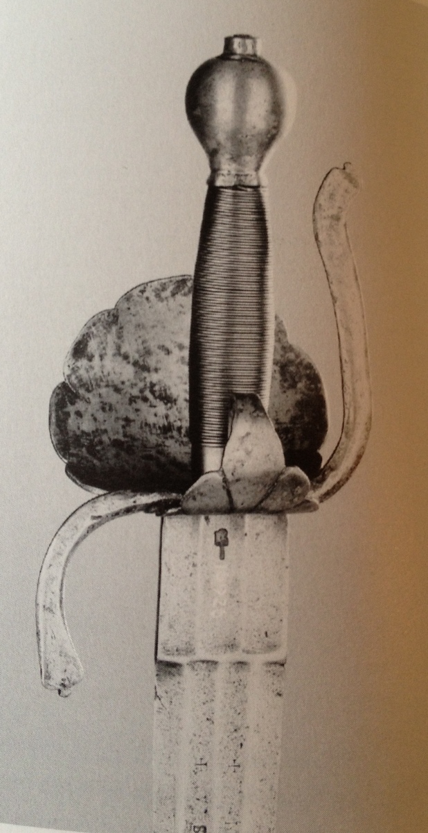

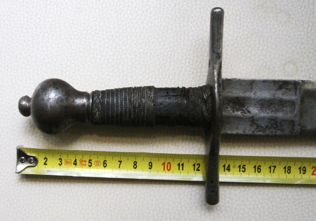

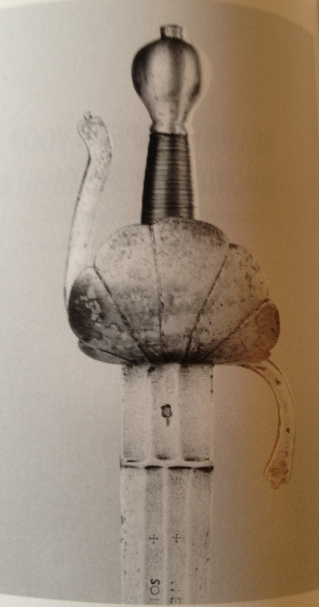

the pommel and blade come from a well known cavalry type of broadsword from around 1600 used in Germany and the low lands.
see pictures with a similar type of blade an with the inscription mefecit solingen.
the blade is a bit worn, there are three channels on the ricasso and two underneath.
the original blade length of this type was around 75 cm, but there are also examples known to me with a shorter length fe a crabhilted sword in a privat collection made ​​by clemens horn (1580-1630) made around 1600.
the guard of the sword under discussion is unusual for the 17th century, the sword seems to me to be a composite one, however,done in the first half of the 17th century.
the mark probably comes from solingen designed to the examples from toledo, this was often done by the swordsmiths from solingen in the early 17th century.
(fe the marks of wilhelm Tesche, johannes Mumm, wilm small, Peter Hoppe eso)

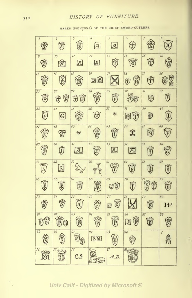

Thank you Fernando ,I have found also this name in this book "THE INDUSTRIAL ARTS"
IN SPAIN BY JUAN F. RIAÑO.
But I was unable to find any draw for the stamped mark ,Do you have the possibility to post a scan from this mark.
Best regards
Jean-Luc
Names of the Sword Makers of Toledo.
The numbers given correspond to the plates of their marks, given in "Catalogo de la Real Armeria."

Old 19th June 2013, 01:07 PM   #19
Fernando K
Join Date: Apr 2010
Posts: 672
Hi, Cerjak
Fernando K

Thank you Fernando k and in the same time I have found this doc too..
Old 19th June 2013, 04:35 PM   #21
Fernando K
Join Date: Apr 2010
Posts: 672
Hello, Cerjak:
The source is the same, the catalog of the Royal Armoury, printed in 1762
Sincerely, Fernando K
