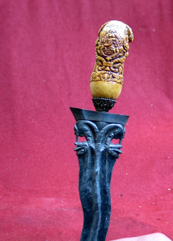

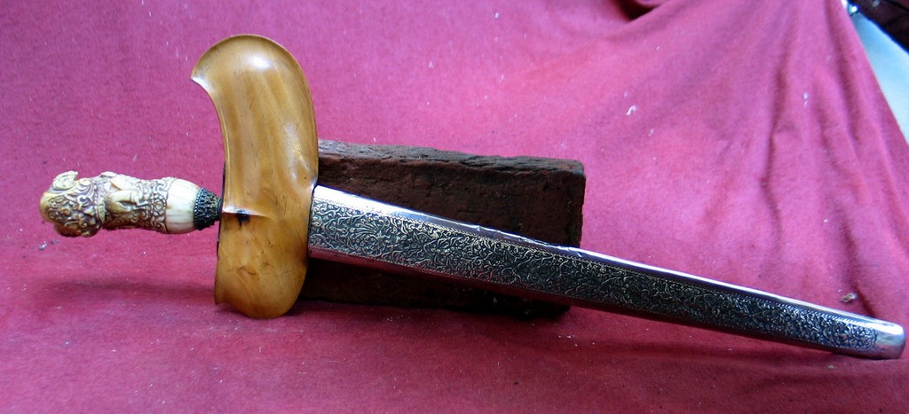

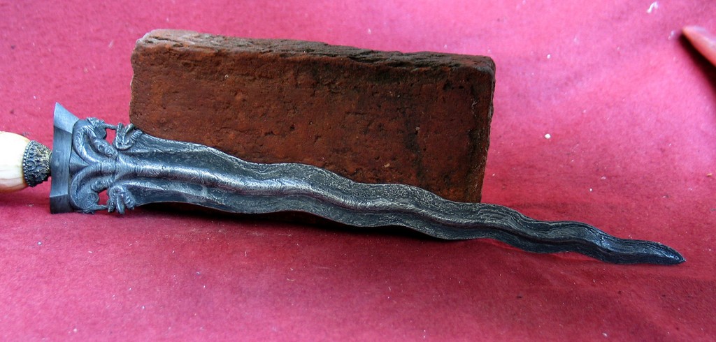

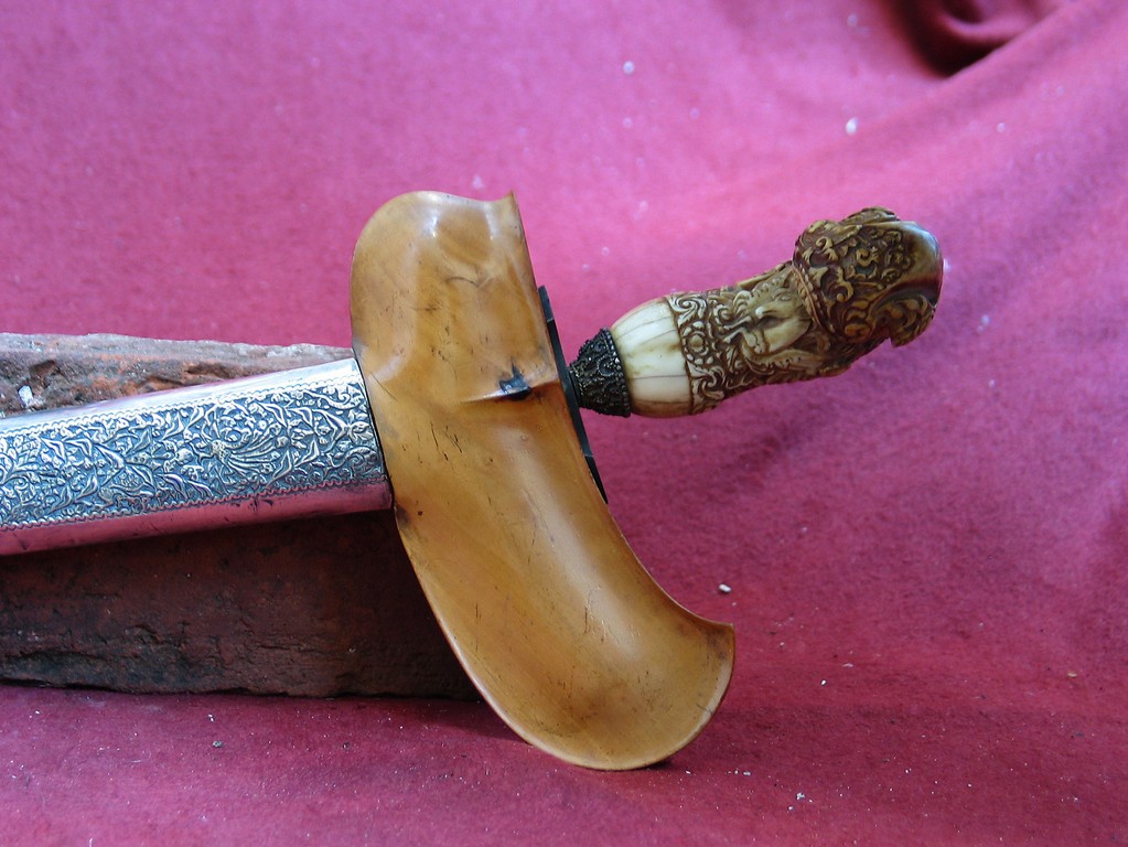

Today ended this keris by ebay: http://www.ebay.com/itm/SuperB-and-v...vip=true&rt=nc
I have attached some of the auction pictures and I am very curious what other members have to say about this keris. BTW, I am not the winner.

Uh......the blade looks recent to me I'm afraid....

hmmm...the seller claims the hilt is fish bone, which from my experience generally refers to whale bone in SEA. This, however, looks nothing like whale bone. He also mentions suasa as a material, but i don't see where that would be. I do notice he offers a "lifetime" guarantee...whose lifetime may still be in question...

Yes, from the pictures the hilt appears to be made from elephant ivory and it looks quite nice, but it does not justify such high bids
The seller may have mentioned fish bone just for avoiding any problems with ivory regulations?

Anyway, a great dress with Ivory ukiran. No i don't think he is avoiding regulations. Rather a lack of knowledge. The keris itself? Could be an older blade. But if so recently reworked and destroyed for the western market.
Very high price for a great Maduran dress.

The blade is not old and the keris itself is a montage, the value is in the individual components.

Thank you all for comment. I also think that the blade is rather recent and don't know from where the seller take the description. But agree with Alan that good old/antique ivory handles can become very expensive and I have seen similar handles which were sold by a higher price as this keris complete.
