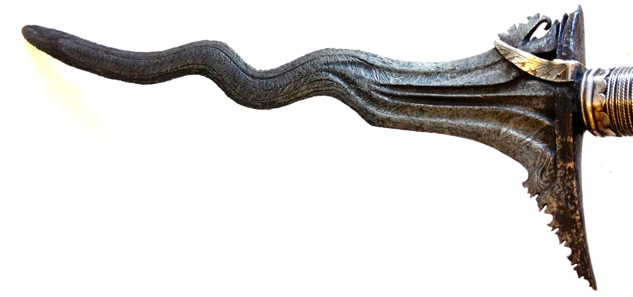

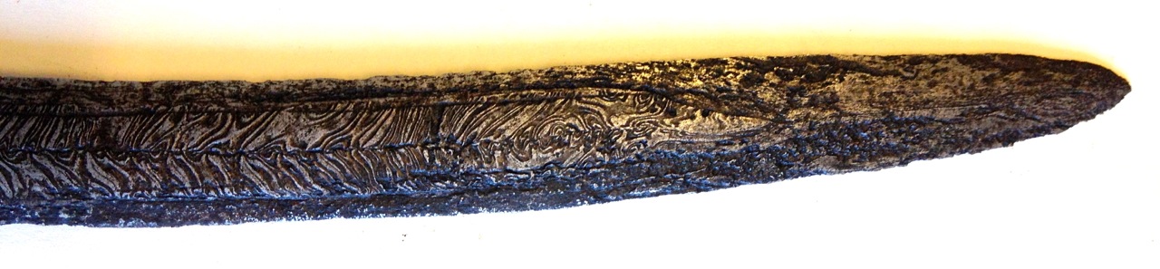

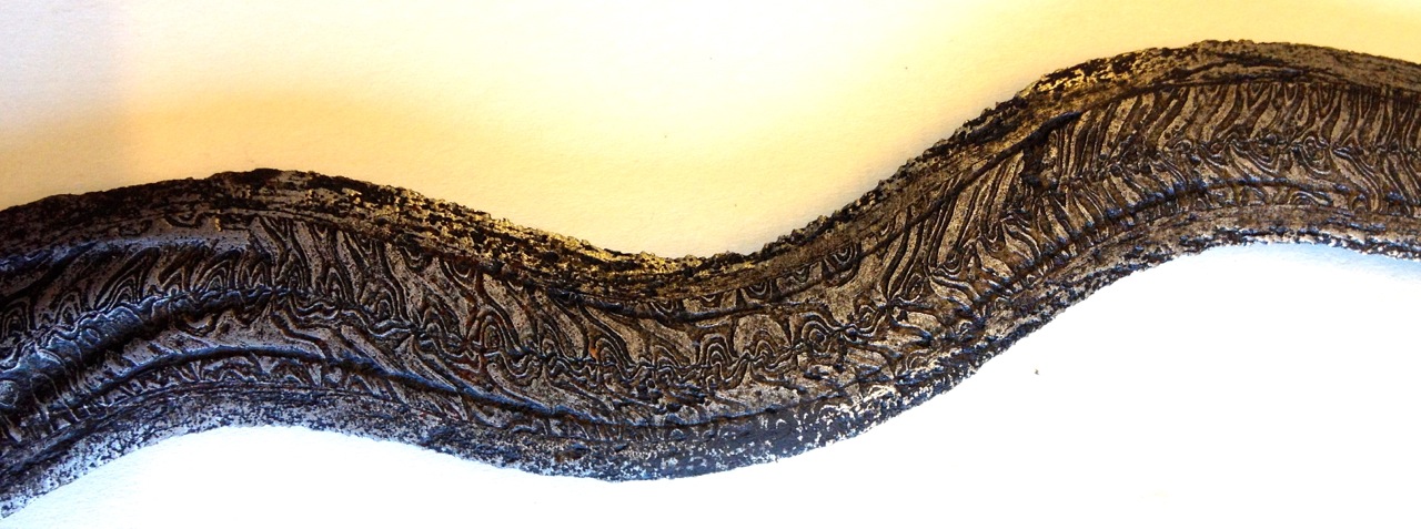

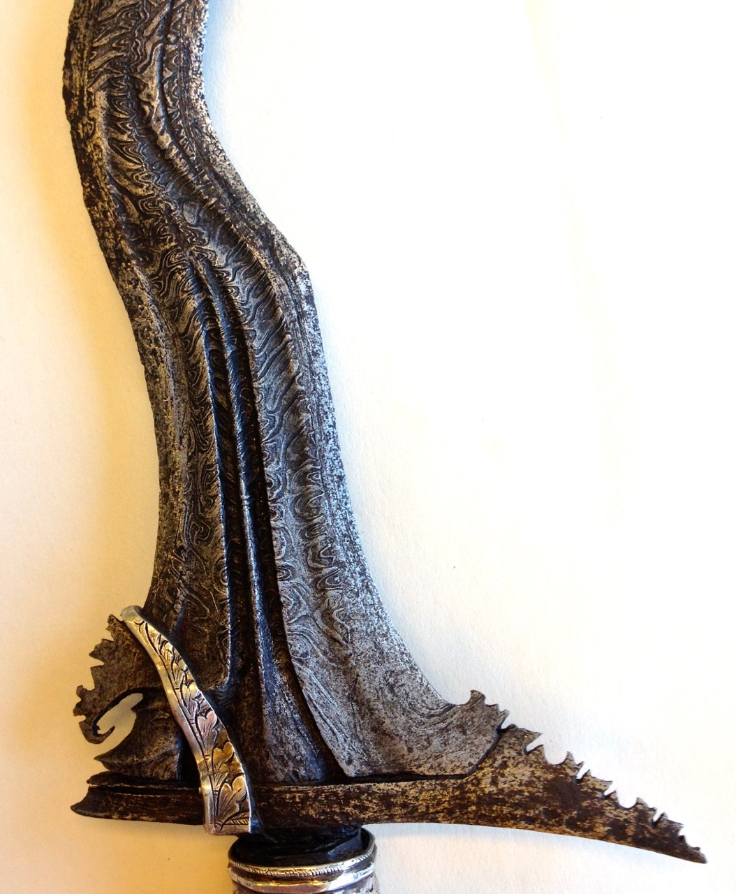

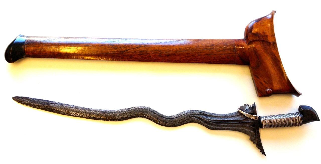

Like CharlesS, I also have a weak spot for the Malay versions of the large keris.
Here is my latest find with a nice twist core and a scabbard usually not seen matched with a Malay keris of this size.

What a nice example! I love the twistcore. Heavily etched. You can tell the unique okir work of the this piece versus that found on Moro pieces.

CharlesS
CharlesS's Avatar
Location: Greenville, NC
Posts: 1,854
Super piece Michael. What dramatic twistcore.
The scabbard looks like a Sumatran keris scabbard.
What a beaut!

Actually it's called Sampir Kusiwo and comes from northern Malay states. I thought, it would be more typical for Kelantan and Kedah, yet I could be wrong.
Yet the curved Loto, typical for this Sampir, surely is influenced by Palembang.
Very interesting and nice ensemble, Michael!

Thanks,
Gustav, I did not know what the scabbard is called but I would also place it in North Malaysia.

VVV, that is very nice addition to your collection. Amazing blade. I like the deep waves. If this was Moro, I believe some would classify it as being archaic.
