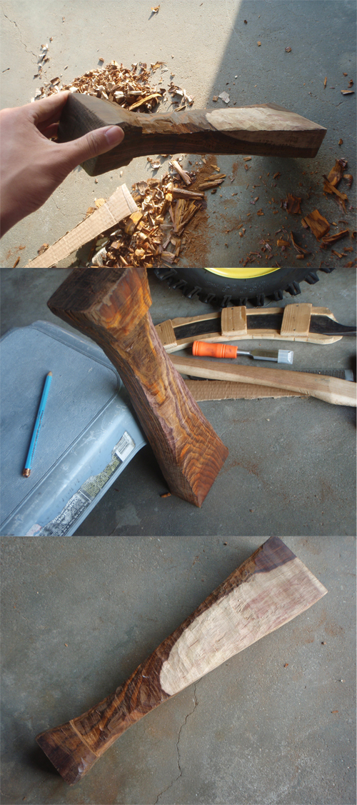

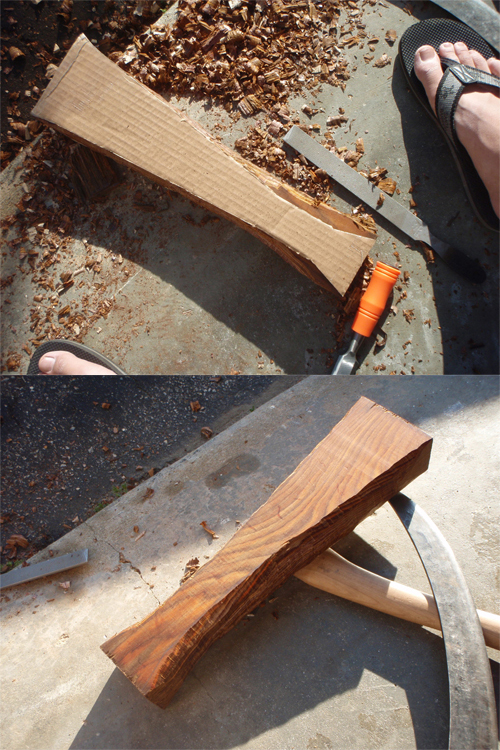

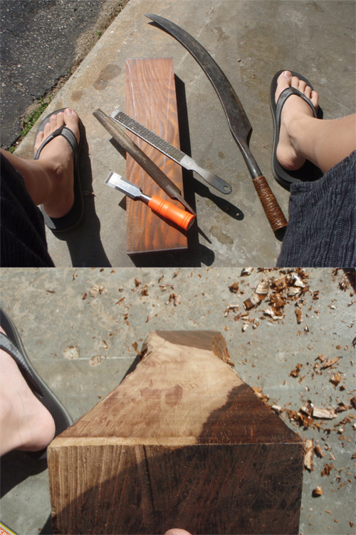

So I got myself a piece of cocobolo. I started by making a guide and tracing the aputu shape on the block of wood. Now, step two is carefully hacking material off of the front and back faces of the bludgeon... though my hand is tired, that was the easy part. I'll have to smooth that out more, then for the side-faces, carefully cut, chisel, and file/rasp away the material... that will take some time. After that I'll work the waist a little to make the handle feel right, and then I I'll wrap some cotton around it, and see how it feels.
Hopefully, will have updates tomorrow or the day after

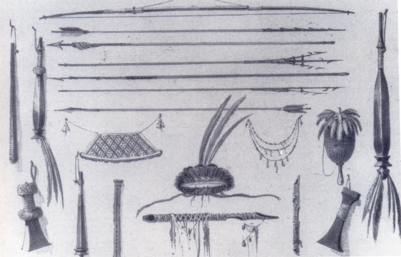

Here's a photo of Kali'na weapons... they are a Carib group.
notice the bow with the long arrows, the aputus, the sword-like clubs, and the bat on the left

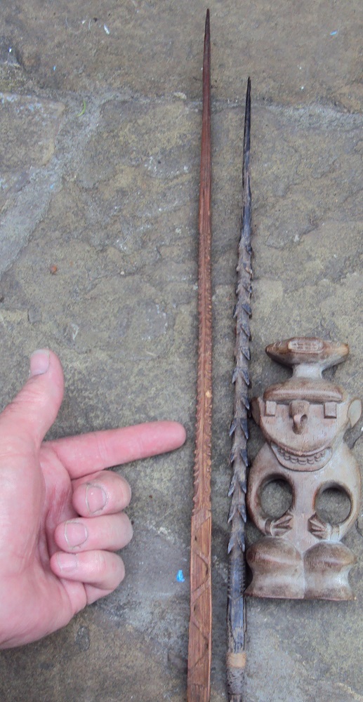

Posts: 5,958
Great project. I will be interested to see it decorated and polished. Thank you for posting the excellent picture plate.

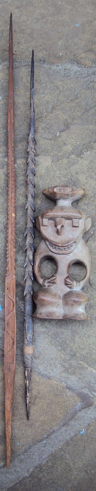

Not wanting to hijack your topic but it has been most helpful in identifying a club I have. It seems that Colin was correct in suggesting a South American origin. Although the pointed distal end on this club is plain, the general form and handle end or unmistakable. The top and bottom bindings are my attempts with raffia at halting further unraveling of what was a decorative plant material weave. If anybody can find other pictures of Carib ect weapons please post them.
http://www.vikingsword.com/vb/showth...el+island+club

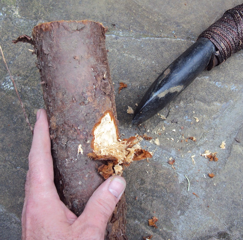

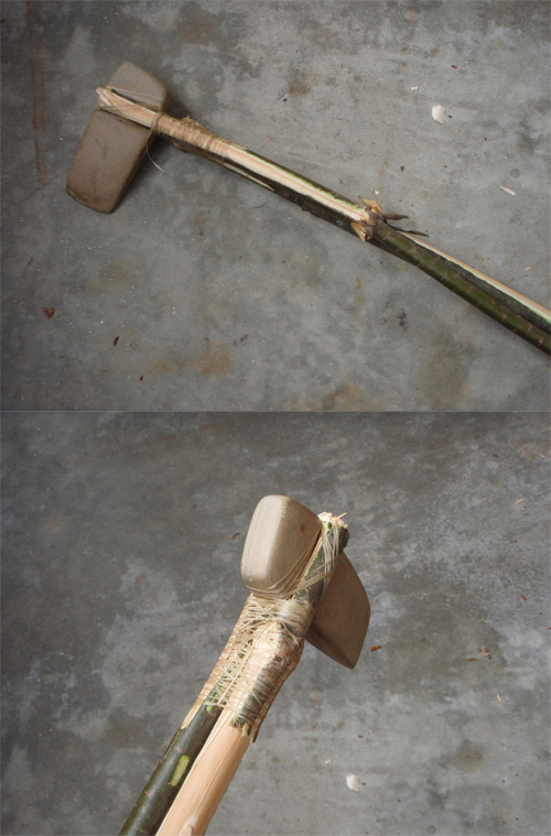

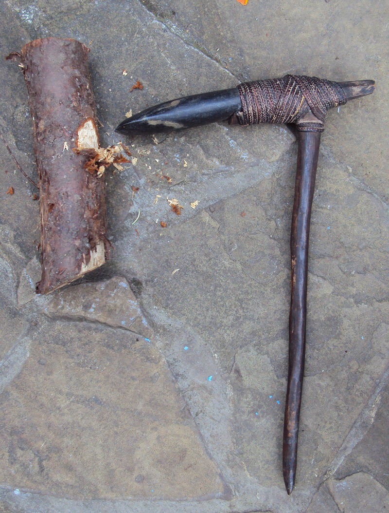

Speaking of making... Remember, the Guiana and Amazonian tribes/towns had very limited lithic tech... they have primitive stone axes that seem to be far inferior to the fine axes of the Incas, Mayans, and celt axes of the North American Eastern woodlands... better for mashing the wood rather than chopping out chunks like the beautiful celts of the aforementioned cultures. Sure, they had palmwood machetes and saws, but these were only good for lighter vegetation and softwoods... for carving they used a peccary/javelina or agouti tooth style of chisel/knife tool (which is still used by many interior tribesmen)... I don't think they had files, though they had graters made of wooden board embedded with teeth so the idea of a rasp wasn't non-existent... just hard to make with the technology and materials at hand.
Today I tried using a grooved ax. The grooved axe can be expediently re-handled and is secure enough while it lasts. This is probably why it was used in the American west by the natives who did not have regular access to forests (and thus make the stronger celt style axes). I'm not sure if the Caribs used celts or grooved axes... but it's what I have. While it works... and it can chop softer wood with ease, and harder wood with some patience... it's inferior to steel in performance. And I am not even going to bother using an agouti tooth to plane the faces of the club.
...let's just say I'll be sticking with steel.
But for what it's worth, here's a grooved axe I assembled.
Filing down the front/back faces of the club now. Time consuming, and trying not to accidentally inhale wood-dust... cocobolo especially is known to give lethal lung infections.

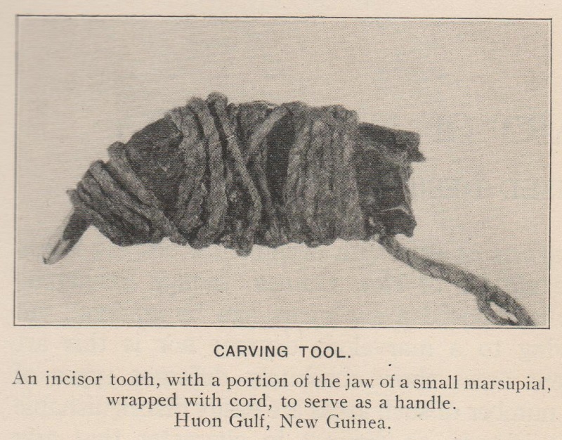

OTHER FINISHING TOOLS THAT MAY HAVE BEEN AVAILABLE DEPENDING ON THE TRIBES LOCATION. 1.(SALT WATER OR RIVER MOUTHS) SHARK SKIN FOR SANDING AND SHARK TEETH FOR CUTTING AND CARVING. A BILLFISH BILL ALSO MAKES A GOOD FILE.
2. (FRESH WATER)PARAHINA TEETH AND OTHER FISH TEETH COULD ALSO BE USED. THE SCALES OF THE GIANT ARAPAIMA FISH MAKE GOOD FILES AND ARE STILL USED TO FILE FINGERNAILS AS WELL AS OTHER THINGS TODAY. HERE IS A PICTURE OF A 15 FOOT 4 INCH ARAPAIMA NOTE THE LARGE THICK SCALES, ONE FISH YEALDS A LARGE SUPPLY OF SCALES AND MEAT.

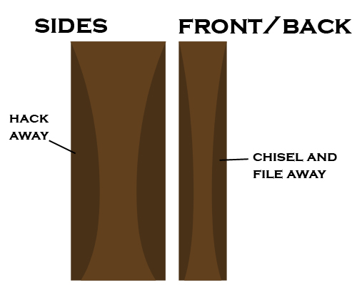

Started to cut/chisel out the sides today. Haven't finished the flare at the pommel and the handle needs to be narrower and not so rough. Then I need to smooth it all out and make the surfaces concave. Still unsure if I am going to carve it with designs, and if so, what kind. There's a few examples of carved aputu, some with very complex designs. I'm thinking I might just let it be... my carving skills aren't great and most aputu I've seen pictures of are plain.

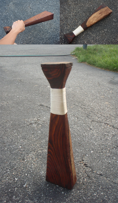

Completed... I think? Used rasp, plane, sandpaper... and then 3 coats of tung oil...
Not as fine as the aputu made by the natives themselves, but I'll get there.
Anyone who owns one... how do they handle? I find my reproduction feels "OK". Not great, the handle certainly would NOT roll in the hand because of the rectangular shape, and it'd be hard to lose because of the flaring butt... however it's not particularly comfortable.
Anyways, I think this came out decent... I look forward to making better examples, with more concavity on the faces like some of the old clubs. Maybe I'll even add in a metal or stone spike/ax to the club someday....
Comments? Suggestions?

Well done, it looks a good job.....

That is a good basic block club. You could take it further? Many old block clubs have beautifully incised decoration and appear lovingly polished.
Your thread is a great opportunity to explore carving without metal tools. Metal tools have the advantage of being more easily formed into practical working shapes to start with. The edge of a metal tool in many cases may be no sharper than a flint tool but the edge can take more abuse and be so quickly resharpened. Metal tools of the right type cut deeper and allow much faster work. I think the main difference between metal v stone, shell and other "primitive" tools is that metal tools enable anybody to use them with good affect in quick time. The economics to tool manufacture v the availability of trade industrial metal tools must of had huge appeal. But to my mind an artist/skilled crafts worker will achieve the same results what ever there tools are made of. Another factor to why we see such wonderful work done without metal tools is that the makers where used to using then and knew no other way. They would have had a tool kit with portable sharpening stone like any good worker today. Even small objects must have taken much time to finish and nothing came from a store respect . All these pictures are PNG but illustrate primitive carving tools. From "Decorative Art Of New Guinea, Incised Designs, Field Museum Of Natural History, Chicago 1925". My pictures show just 1 minutes work with a stone adze on some firewood and a few fine objects carved without metal.

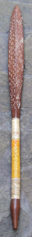

I may polish this one down better. I would love to try my hand at carving the more elaborate designs but the pictures featuring those aren't big enough for me to really capture the detail. Maybe I carve something like this? http://anthro.amnh.org/anthropology/...40.0%2F%206339

http://www.vikingsword.com/vb/showth...ighlight=aputu
HERE IS A LINK TO A OLD POST ON THESE THAT WOULD ADD INFORMATION TO THIS POST AND GIVE YOU SOME IDEAS ON SIMPLE DESIGNS. I HOPE THE LINK WORKS
