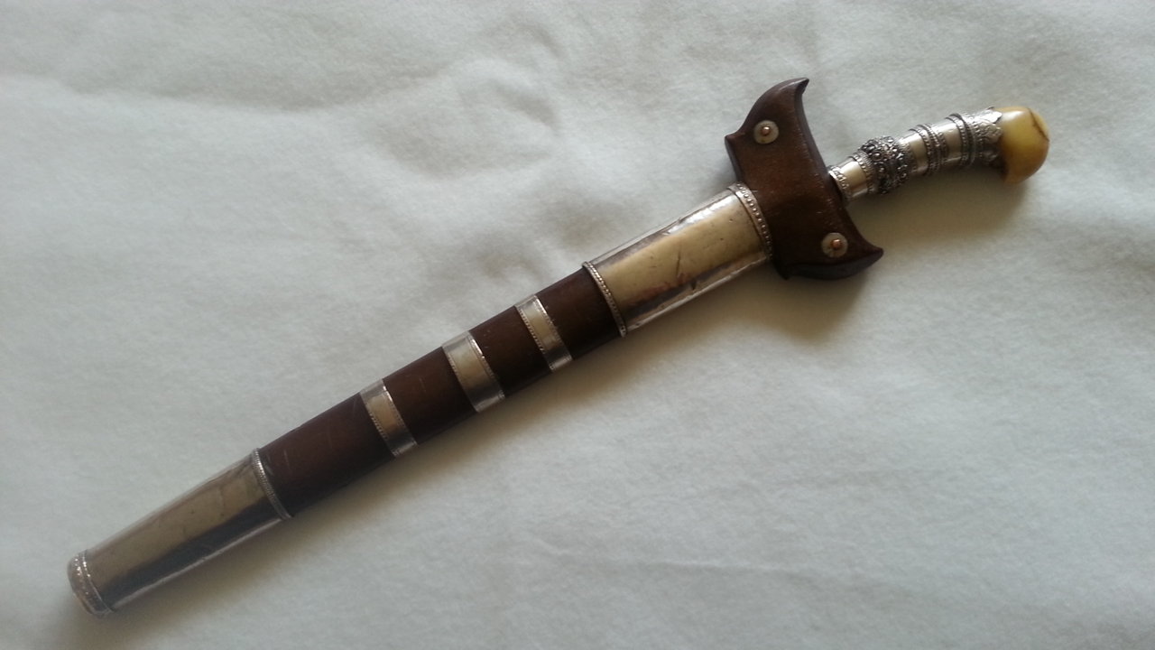

here's a kris i would like to share for viewing pleasure and comments. at first glance, it appears to be a normal type except for the asang-asang that's missing. other than that, everything seems to be intact.
the pommel is made out of ivory in a miniature fashion. handle is silver that is exquisitely decorated. scabbard is complete, with silver bands; and the blade is in a straight fashion and has a separate gangya. it appears to be laminated. i haven't had the chance to etch it.

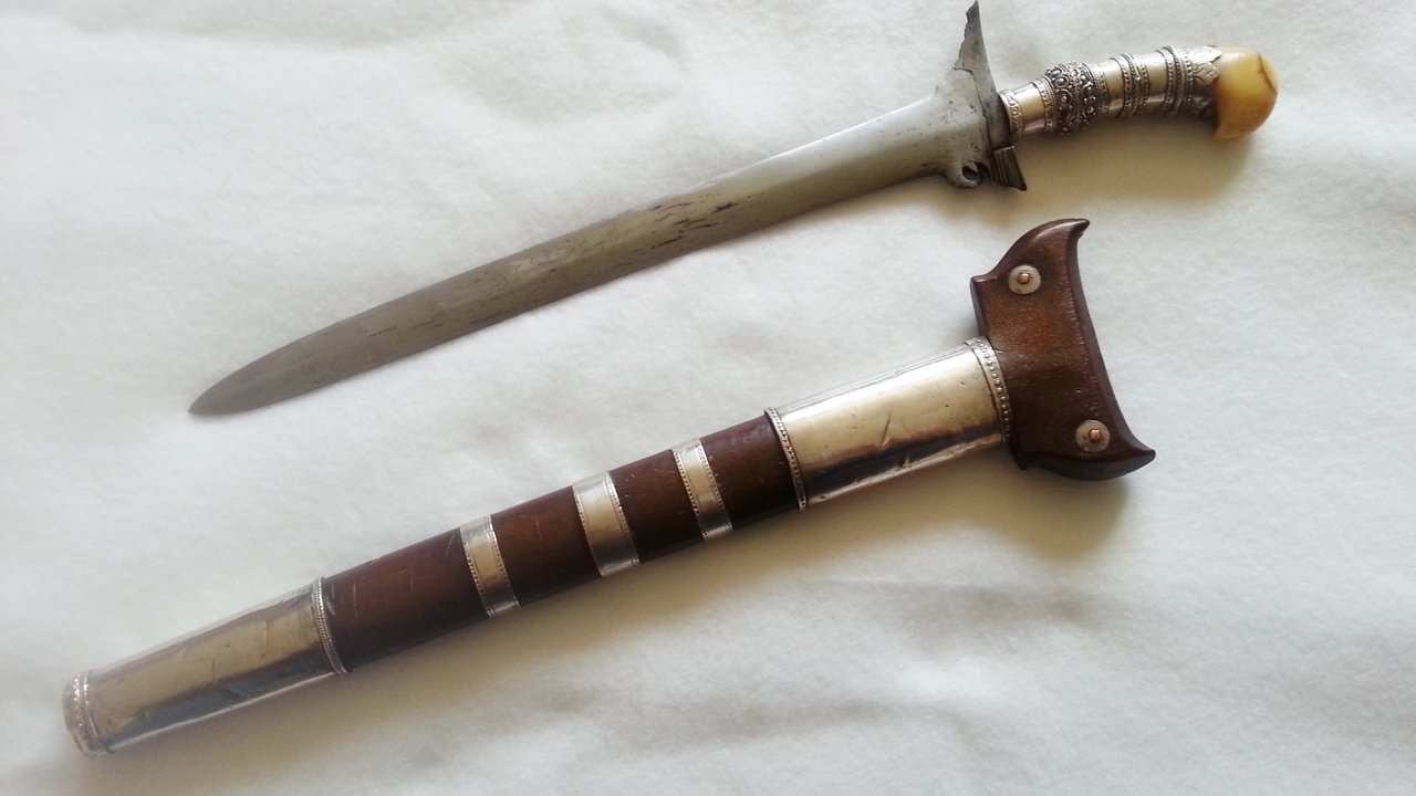

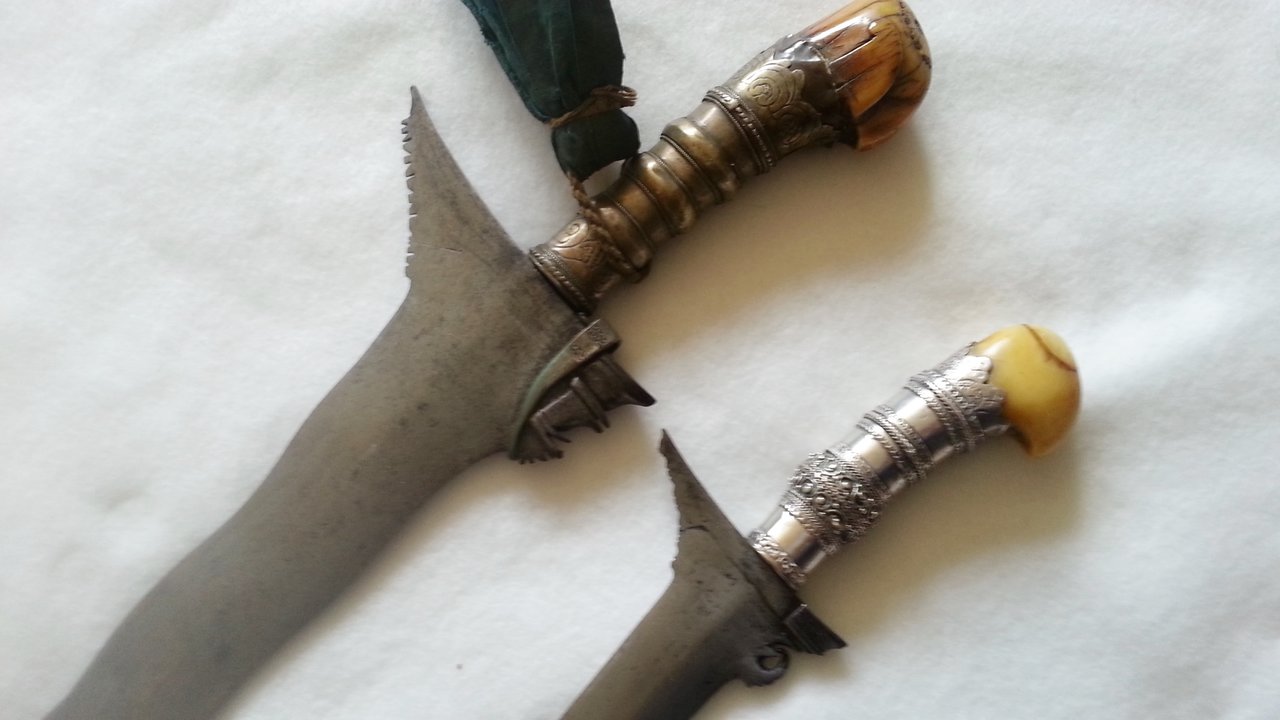

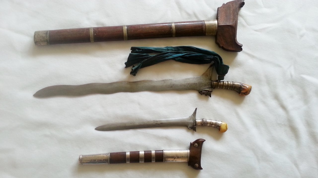

smallest kris i've ever seen. blade length is 11.5", and the width is 5/8". the handle is slightly smaller than an average kris's, with a total length of 4". possible that it was a child's kris, although i've seen some that are labeled as child's kris which is bigger than this. it could pass for a stiletto type dagger without a doubt, as it has the heft and balance. what gets me are the details that went in making this kris. that and the materials that was used.
yes sir, my latest acquisition. found in an antique shop a couple towns over.

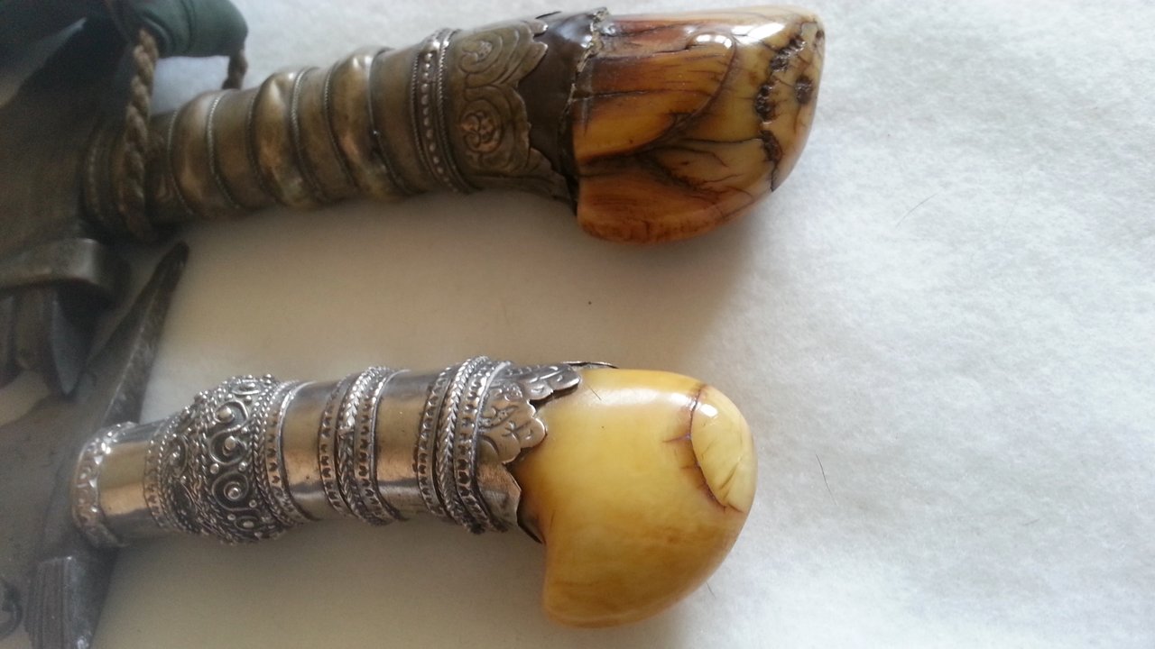

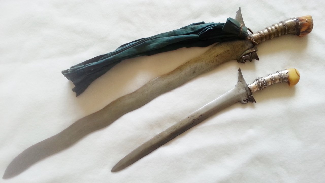

here are some pics taken next to an average size kris, just for comparison. notice how the gripping part of the handle is almost the same size. comments?

I'm with David on the Kris being small. Blade is shorter than the scabbard.

That average sized one is very nice as well, is that a abbreviated elephant trunk or is it broken.

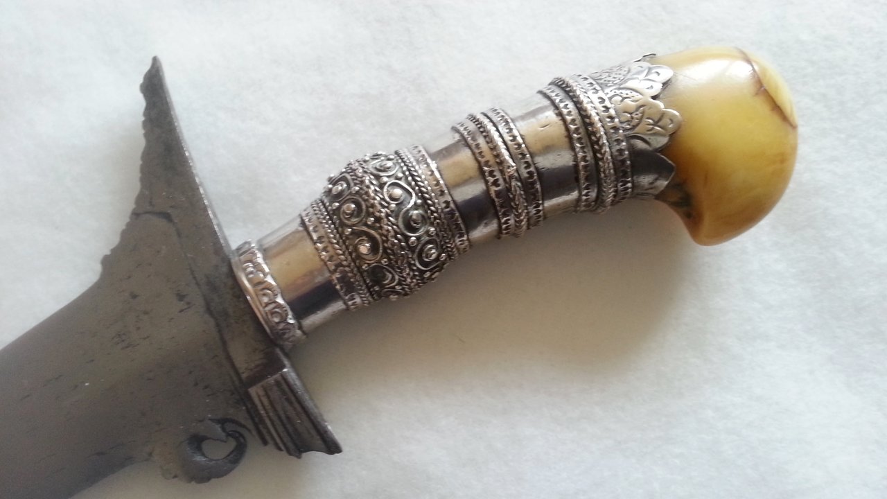

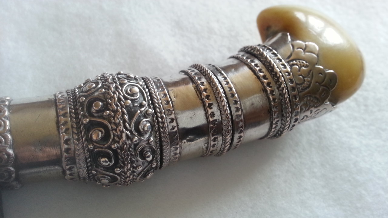

One may wonder wether this may be a very early attempt at circumventing sword bans (which would mean a relatively late date) considering the similarity of the bulbous grip ornament with those seen in gunong/punal. OTOH, some early kris also have this bulbous grip ornament although stylistically this dwarf kris appears to be closer to early gunong. Okir is very limited on this hilt (Ron could you please post a close-up taken from the top of the grip?); it doesn't look Sulu to me and also the scabbard points to Mindanao. I'd guess this is a relatively early type of additional sidearm and believe the history of gunong/punal also goes back for quite a bit longer than usually acknowleged.

Spunjer, I think I see a bit of a difference in the hilt size between the two you have displayed. If so that could suggest that the first one may be a "princely" kriss specifically made for a child. Only handling it would likely answer that question, so what is your take on it?

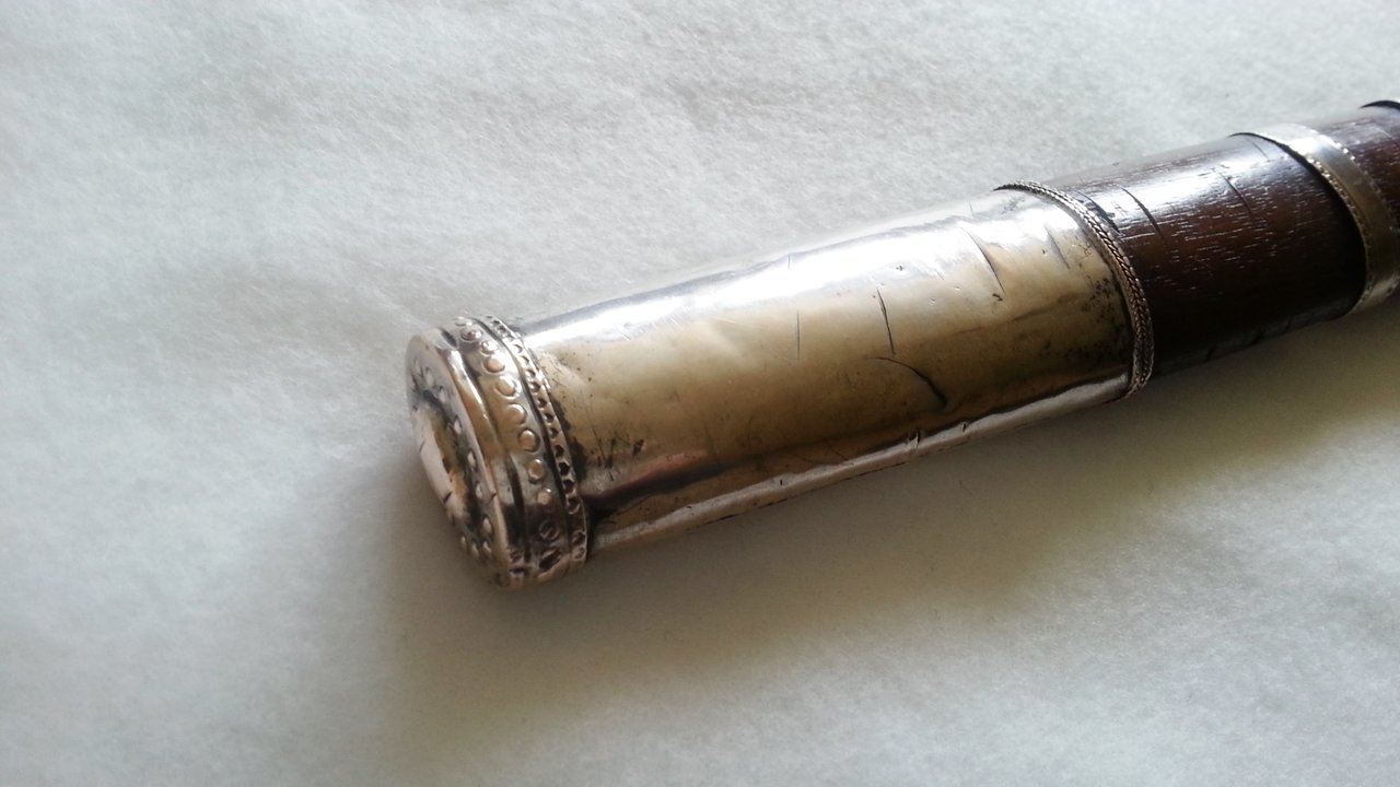

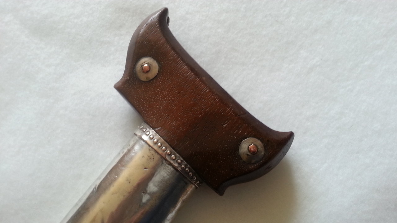

Al, regarding your question about the other kris's elephant trunk: no, it's not broken, rather it's abbreviated. kai, per your request, i've added a close-up of the handle. i've also added a close-up of the crosspiece. those pins btw are swaasa

To me it seems more probable to be a dagger meant to be worn in addition to a regular-sized Moro kris. Ron, could you please check whether you can see wear suggesting on which side this piece was actually carried?

For the fun of it: Could you please take a pic of the kris under discussion with a average-size gunong and possibly a children's kris from Mindanao (or a Sulu kris of similar size) next to it, Ron? Thanks a lot!
I assume the side you're showing is the front of the scabbard. I'd especially check the wood for signs of stronger wear from the tip on top being more exposed and (with a lot of luck) on the lower side from wearing in the sash. The silver fittings may also preserve some cues.

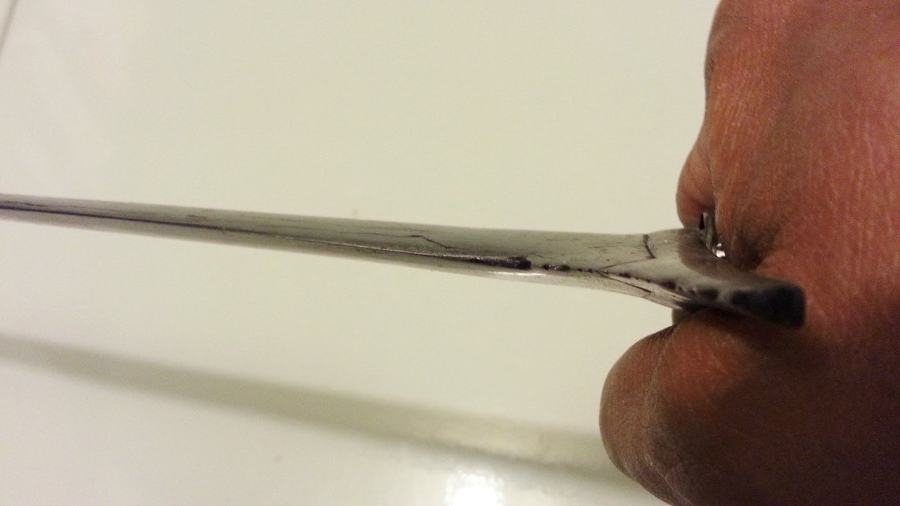

Hello Spunjer, Seeing that I know little to nothing about kris swords I have a couple of question for those who do. If this is actually a dagger (usually meant mostly for stabbing) and not a true sword (meant for stabbing and heavy slashing motions) would it have originally necessarily even had to have had asing asing ? Is there any real evidence, shadow or worn area on the blade, gangya or remnants of broken mounts that would suggest that this piece ever did have asing asing? Either way, my congratulation to you on this most interesting and beautiful piece.
