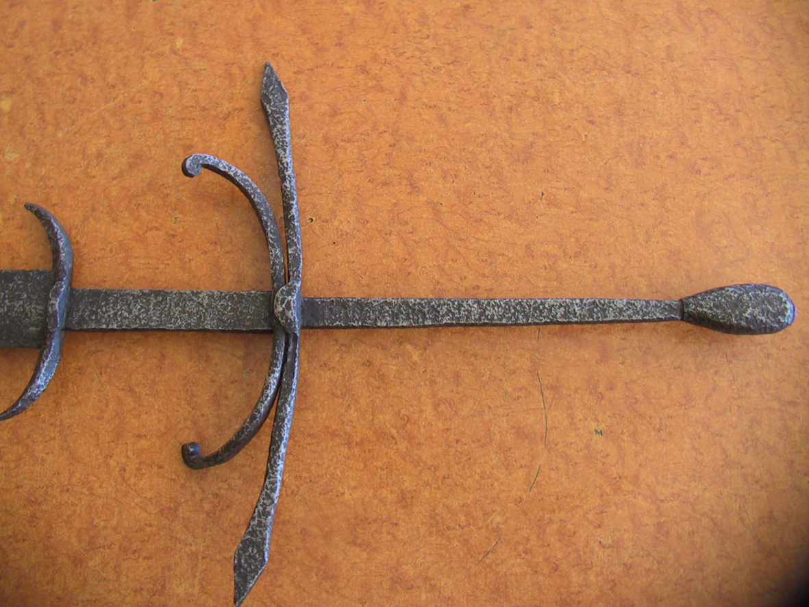

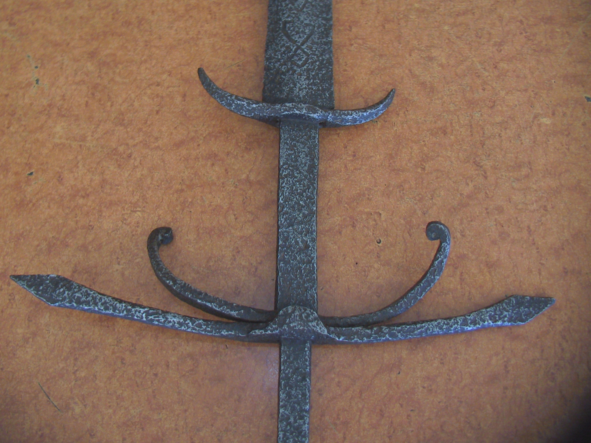

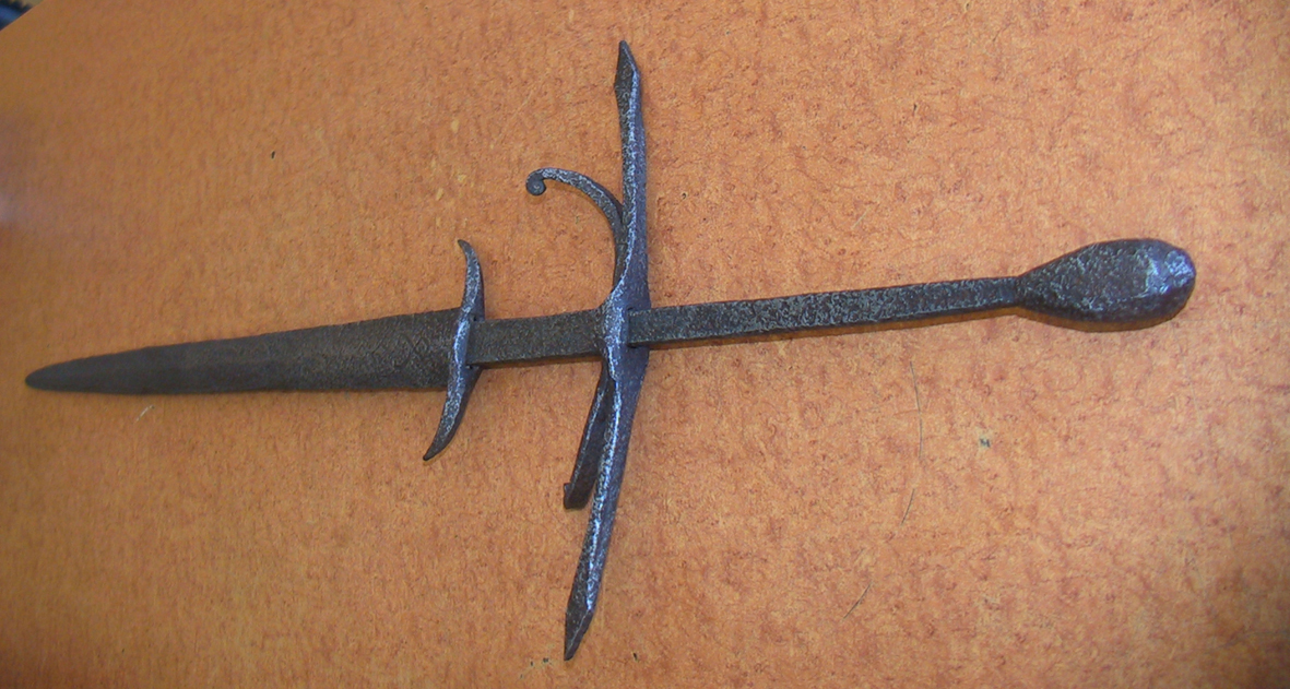

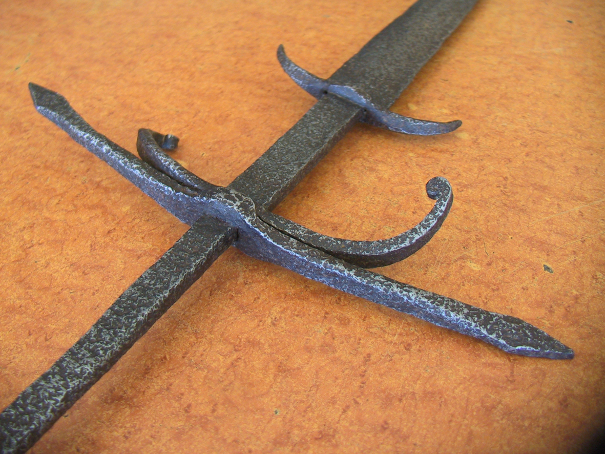

bought this last night in a drunken bravado. tis morning cheak it out and i think i bought a zweihander! my only concerns its that at 3 ft 10 inches its kind of short for a zweihander? plus there seem to be a mark of fo some sort that needs some identifying. can anybody commet or help?

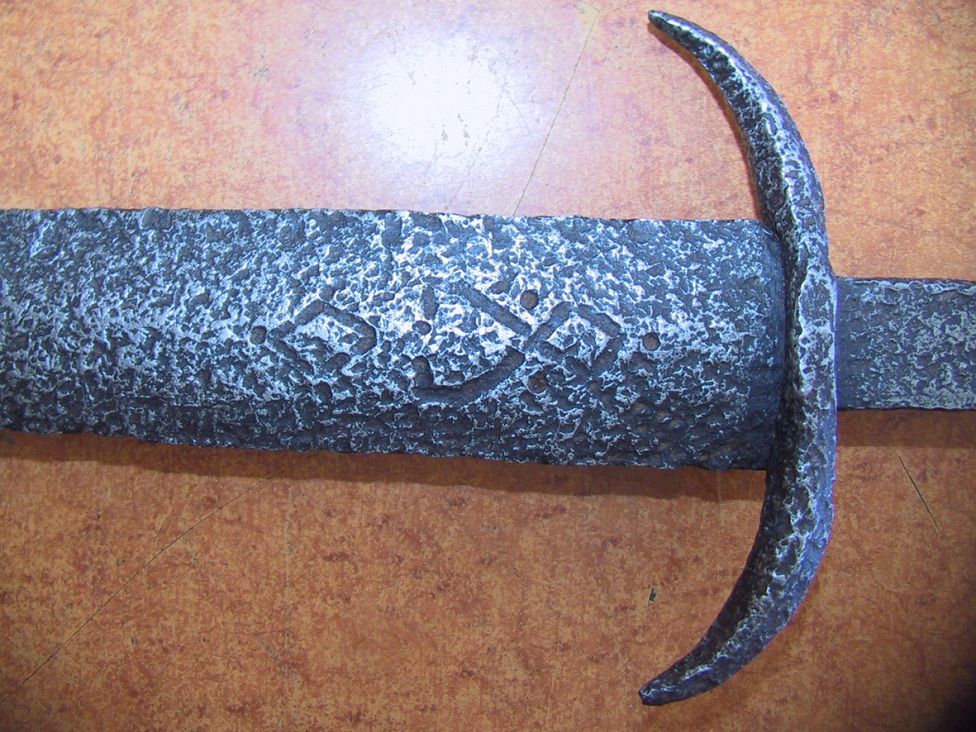

heres the pic of the mark

I'm sorry to have to give this criticism.
I hope you have not purchased the sword as an original from the 16th or 17th century.
because it seems to me a newly/recently created fantasy sword, what has been treated to make it look old.
both the construction of the Hilt, pommel, Parier thorns and guards, as well the modern tool engraved "mark" do look extremely unusual.
(original marks are struck in the blade or hammered in, in another metal in thin lines.)
