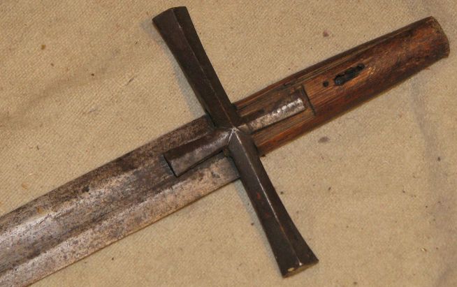

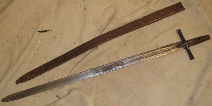

This is something of a first: a kaskara with a Arabic "seal" stamped on both sides of the blade.
It's quite an old piece - a heavy, stiff, trade blade that has seen a lot of use - it has a lot of old, deep scratches in the fuller. It has a forged fuller from the hilt to about a third down the blade and has a well-made iron crossguard with an X. All the leather has gone and the scabbard is not original. The missing grip binding allows an insight into the hit-and-miss nature of lining up the holes in the grip and the tang. The blade is very tight in the hilt - cloth padding is visible.

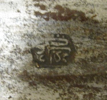

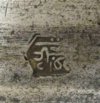

The hexagonal stamped marking is the same on both sides: unfortunately it has not been done evenly but fortunately the whole may be read from the two parts. I have no idea what its says or even if I have shown it the right way up. Perhaps there is a date.
As always your comments are most welcome.

Very nice. Iain, do you think this is a local blade or a european one stamped with maybe an armory stamp? the stamp reminds me of indian/afghani ones.
It says Dawud Ali, btw.

Honestly Stephen has a lot more experience with kaskara than I do, so if he says it's a European trade blade I believe him. The style of cross guard certainly matches with an old sword.
Wood is in surprisingly good shape.
About the stamp, I was half hoping the translation would give a place rather than a name. The name I assume has nothing to give a regional clue? As I understand it Dawud is the Arabic version of David, so probably quite common, Ali of course is a very common name as well in the Sudan.
So, I don't think it's an armoury stamp. I'm wondering if some enterprising merchant stamped a batch of blades he imported or bought up? Would be a decent marketing trick perhaps, as in "I have a Dawud Ali blade and it works great! You should go get one as well!".
That's about the only thing I can think of. As Norman points out, I really doubt this was a one off.

Salaams, Is there any Arabic stamped on the blade... I see something about one foot down the fuller? The stamp is upside down but no problem it is perfectly translated by A.alnakkas. I see no date. Ibrahiim.

While it is of course difficult to accurately assess a blade in kaskaras asto being European or native by photos rather than actual handling, it does seem this one reflects possibly being a European trade blade. The fuller profile compares to examples described and illustrated in line drawings in Reed (1987, plate LII, p.168) and Briggs (1965, T8, p.52). Apparantly these each have running wolf on one side and the cross and orb on the other. It is suggested these are German 17th century and a reference to Wallace A524 is cited by Briggs.
While these authors do not unequivocably claim these blades are European, they imply they probably are, and note that native makers did imitate these markings among many others.
The stamp is most interesting and certainly unusual for a kaskara blade, the absence of European markings or copies in the fullers notwithstanding. It is known that stamps with Arabic characters en cartouche were used in Algeria on the blade of a nimcha (Briggs, p.78, plate XVII, b) in one example and of course likely others. The use of stamps by native armourers there and in many of the centers seems to have existed from earlier times and of course into modern times. As these stamps became worn the character of the devices being stamped of course less distinctive, and the depth decreased with quality of definition. In some cases of courses, simple chiseled marks are used, but this rather crude definition is sometimes on old European blades as well, especially with the running wolf.
I think Iains idea is well placed that in one location an industrious trader may have stamped this and blades received by him with a mark, which like most such devices would likely be perceived as talismanic and imbuing the blade with power. In the Reed article, (op.cit. plate LII) he notes that the individual he was interviewing (in 1987) indicated the blade was 'before Kasalla'....that is, a very old blade. Kasalla, as described in Ed Hunley's excellent article , became the heart of modern edged weapons production in the Sudan. These old blades, many indeed quite early European trade blades, were refurbished countless times as they changed hands or were handed down, much as this example clearly exhibits.

You have presented an interesting observation here which I missed entirely, the stamp is very much like those seen on Indian/Afghani blades though these cartouches are typically in the upper part of the blade. It does seem that is certain instances blades which were likely from Indian trade have been found in kaskaras (i.e. backsword blades).
It is an interesting consideration that this could be a stamp from Indian regions which may have found its way to an intermediary involved in Red Sea trade and perhaps was applied in that medium.
Iain, I think this presents well regarding your merchant suggestion. In the trade centers where blades were received from arriving ships and dispersed to caravans and other merchants this seems very plausible.

The more I think about it, the less likely I think this was a local Sudanese application.
If we look at why and how local marks were applied it was usually for talismanic reasons or to imply European levels of quality.
As the name on this stamp does not seem to be a known local ruler or religious figure, I think we can rule out any such properties. Additionally names and religious inscriptions tended to be etched or carved in, not stamped.
I agree with A. Alnakkas that there is a resemblance to armoury stamps from India. I lack the expertise to know if this example is in that style or not though? Perhaps one of the Indian experts can weigh in on the issue?
All in all an intriguing sword, I love these odd pieces that do not confirm to the textbook examples!

It seems like most of the Indian/Afghan stamps were either in square or circular cartouche, and the ones I have seen were in Urdu..but the configuration of the characters in this seem quite similar.

hmm, well the stamp has a common name through out the muslim world. Be it urdu, arabic or persian.. it will still be written all the same.

Thanks very much, that is good to know and thus the possibility of a stamp being used by an intermediary in the trade complex with a stamp which could be from many locations. With the Indian swords I have seen with these stamped cartouches (typically square) they were tulwars stamped nearest the blade edge at the ricasso...these blades typically also had a stamped 'trisula' at blade center. (see Rawson, "The Indian Sword", #44; V&A 3459).
With the other instance I have seen a circular stamp on Algerian 'nimcha' sabres, as described in "European Blades in Tuareg Swords and Daggers", Dr. Lloyd Cabot Briggs ( JAAS, Vol.V, #2, p.78-79). noted as follows,"...the ricasso is stamped on one side only with a circular stamp containing an illegible combination of Arabic characters in high relief". There are line drawings with this shown (pl.XVII, b) and it is noted there are two swords, both Algerian with nearly identical blades. The first with the cartouche has sickle mark as well; the second has no cartouche, but ANDREA FERARA.
I do not agree with the assessment of 16th-17th c. Italian or German for the two blades, they appear to be of 18th century Solingen production as the triple fuller configuration on sabre blade suggests, as does the Andrea Ferara stamped name.
The point is that the stamp occurring on one side only of the blade of one of two sabres imported from Germany in either beginning to perhaps mid 19th c.
suggests it may have been a worn stamp being used by a trader or merchant on one of these. The fact that the stamp on this blade is apparantly from the same stamp with varied quality is to the application by the user.
Briggs notes that the cartouche was likely added later in the region received of course than at production, and that various marks including the sickles are known to be added as such, apparantly in Sudan (kaskara H2, op.cit.)as well as other regions, in this case Algeria.
Naturally the nature of the blade itself must be considered, and this is of course a broadsword blade of the type used on kaskaras, and not used as far as I know on Indian swords, nor on Algerian nimchas. Also the stamped location does not correspond to the other instances noted, so this stands as an amomaly in kaskara blades until others are found.
