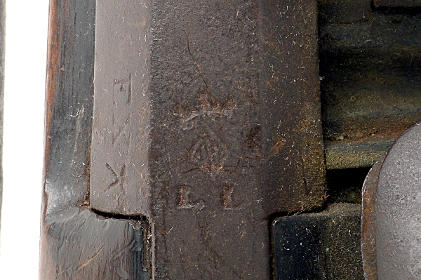

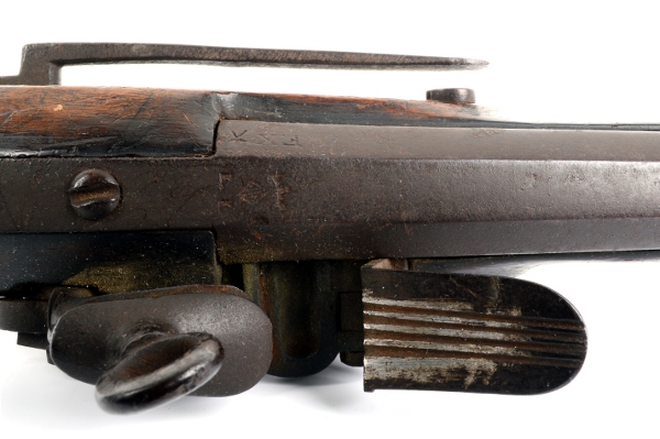

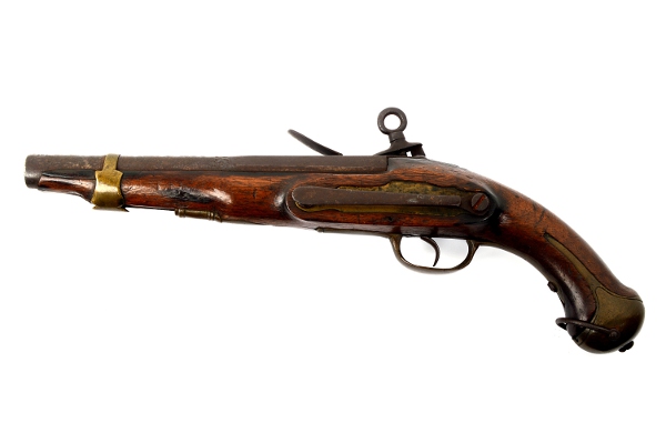

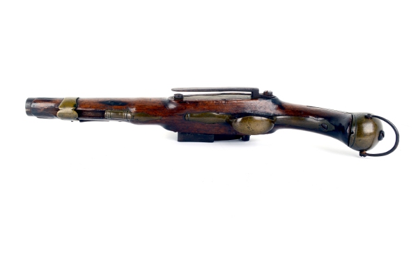

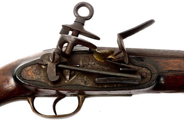

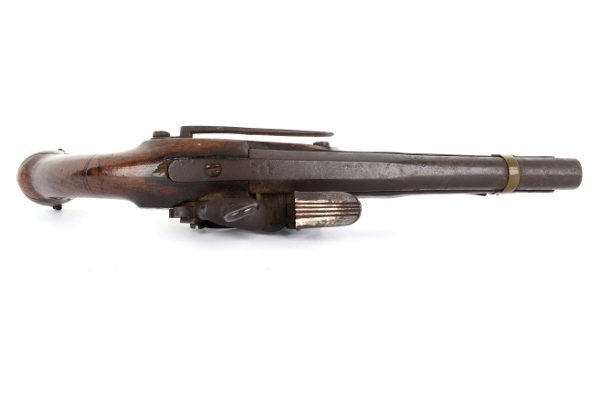

Here are some photos of a Spanish cavalry pistol with a patilla style miquelet lock. It was made in Valencia 1808-1812. The pistol is marked “Fa.Va.” (Fabrica de Valencia) and “L.L” (doblemente leal=LL=doubly loyal). The emblem of Valencia (a rhombus with vertical lines under crown) is also stamped on the barrel.
Juan L. Calvó depicts a similar pistol on page 68 of his book “Armamento Español en la Guerra de Independencia”.
The pistol has a belt hook. I am looking for any illustrations of Spanish cavalry carrying this style pistol in a baldric, saddle or horse holster.
This pistol may have been in use during the Spanish War of Independence 1808-1814 (Guerra de la Independencia Española).

Estimado Dana:
La llave (lock) es "a las 3 modas". Del miquelete, toma el resorte mayor actuando hacia arriba, el "gatillo" (cock) y el tornillo pedrero (flint screw) con aro, y el sistema de disparo. De la llave a francesa, toma la brida del rastrillo fija a la cazoleta (pan) y el rastrillo (steel) redondeado y curvo (si bien está estriado como en el miquelete). De la llave "a la romana", toma la disposición del resorte del rastrillo (encima del muelle real), si bien está fijado como en el miquelete, por oreja pasante y no por tornillo.
Afectuosamente. Fernando K

Sorry Fernando K, I am not sure what you are trying to tell me.
Maybe you wouldn't call this a patilla style lock. It is certainly a late example. The frizzen / battery spring is forward of the pan and has no bridle, but it still looks like a patilla to me.

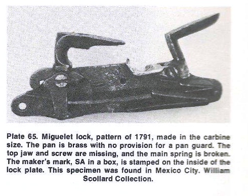

Regarding the key classified as model 1791, actually corresponds to the 1802 model for artillery carbine:
Fernando K, Please see the first post. Juan L. Calvó tells me this is a cavalry pistol made at the Valencia Factory (1808-1812). It may just be the lanyard ring that makes it a "cavalry pistol".
I don't have a copy of “Armamento Español en la Guerra de Independencia”, so I can't check Juan L. Calvó's photos. Do you have a copy? Does anyone have a copy? They only printed a limited edition of 1,000.
The lock looks a lot like the one labeled Model 1791 in Benninghoff's Spanish Weapons in the American Revolution and the one shown in plate 65 from the Scollard Collection.
