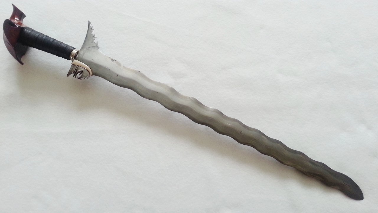

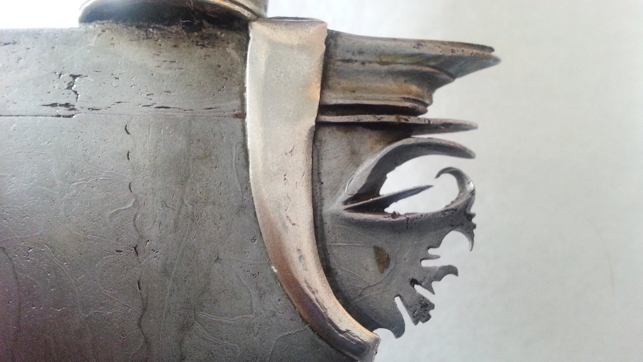

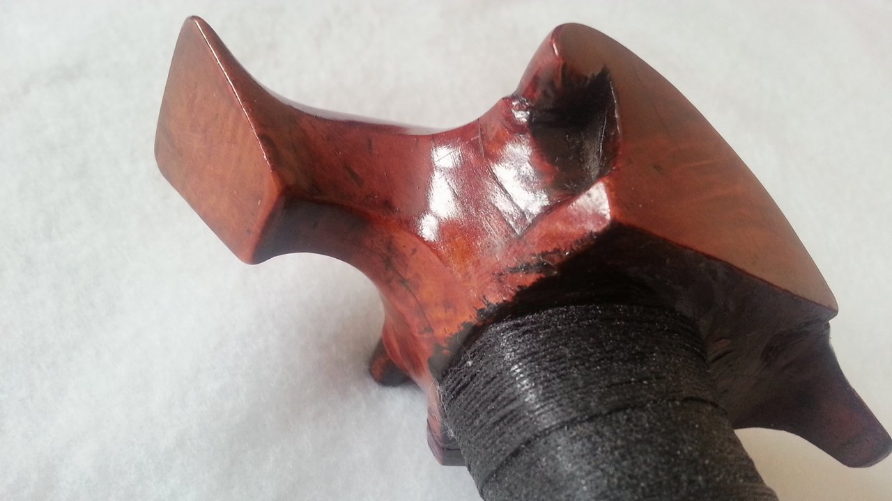

i'd like to call this the "Almost Kalis". the pommel is "almost" like one of those superlative junggayan. the wing appendages are about as wide as those junggayan krises but the beak and tail were simplified into the more normal types.

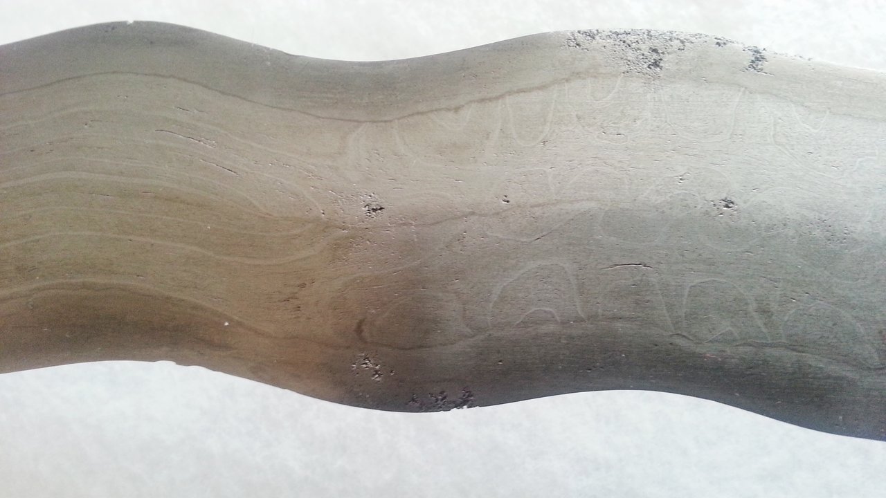

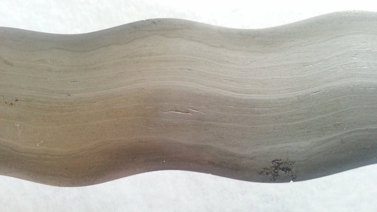

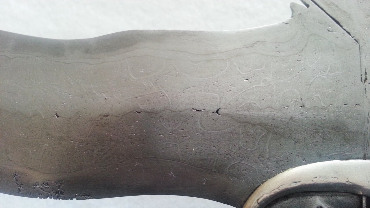

then i decided to etch the blade, to see if it is laminated. i was ecstatic to see twistcore then about a third down, i was like, "what the...?" from twistcore, it went to the skunk stripe lamination pattern. seems like it just petered out on me. both sides were like these. an "almost" twistcore blade...
the twistcore covered the upper third. notice how it's all the way to the trunk. the katik is laminated as well, but it's the more average type.
comments on this unusual kalis?

Very interesting....never seen a Moro kriss with that short of twist core/lamination mix. Looks like something more likely to be seen on an Indonesian keris. Obviously a very talented smith.

Congrats, Ron, that's a special one for sure!
The chunky pommel is not my cup of tea - how does it influence handling the sword?
The blade is obviously pattern welded and intentionally so - I like it! Also, it makes kinda sense to restrict the twistcore to the broader part of the blade and go for the linear pattern towards the tip (if you decide to go for more than a single pamor).
I do wonder why we haven't seen more of these in Moro/Malay kris? On a side note: While adeg pattern welding is rare in Moro kris to begin with, I believe that one could argue that the linear pattern seems to be even rarer than the famed twistcore pattern!
BTW, is that the best etch/stain you can obtain? (I'd believe this kind of quality work would suit a stronger contrast if possible...)

Actually Kai, the balance is excellent on this one, given that the pommel is quite chunky. Perhaps the reason why the beak and tail were abbreviated. Had the carver went all out, it might have been a tad top heavy. The blade is a bit narrower than the average blade of a big junggayan kris.
As far as etching, i try not to make the blade black, especially the edges. This was starting to turn real dark; i have to rescrub it with 0000 steel wool. Actually, it's quite obvious in real life. I was having a hard time taking pictures of it...
It seems that real prominent linear pattern were relatively more common on older blades. To see it on a later blade was a surprise to me.
