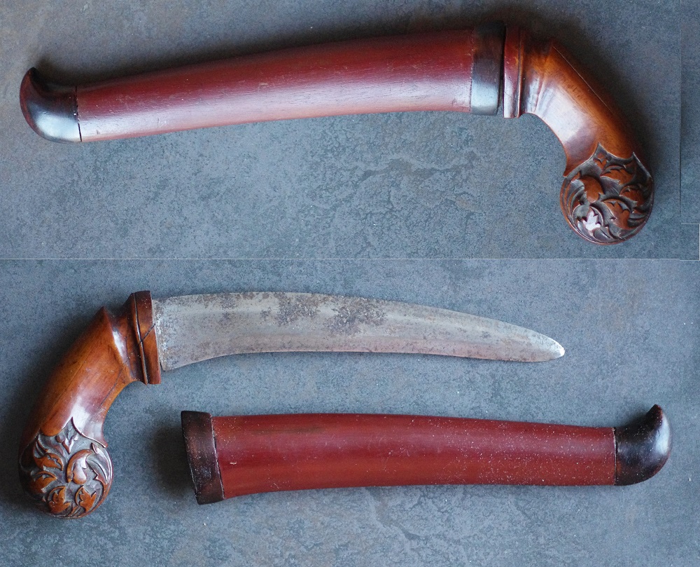

Another Sumatran?/Malay? strange dagger.
The blade look like beladau blade but the hilt is very different.
The blade also looks like the Lawi Ayam but I do not really know this family of weapons and I think that the blade may not be curved enough to be classified as Lawi Ayam.
The sheath is in Suamtran/Malay style (The true color of red wood is a little browner and darker), but the adjustment with the handle is not good, I feel that it may not be the original sheath.
Length blade : 18,3cm
Thickness at the base : 5mm
Do you know the name and origin of this dagger?

Hello Séverin,
Nice grab!
Certainly not a lawi ayam or korambi.
The hilt clearly is a variant of a badik. The red color might point to a coastal Malay community if the scabbard is original.
Does the blade fit only very loosely?
If the blade feels suitable, it may just be a bit misaligned: It looks like it may have been shifted slightly upwards.

I think that it is a badik from Sumatra and a very nice one on top!
I am nearly sure that the scabbard is a recent replacement, compare the patina from the handle and scabbard and note the unpurified workmanship of the scabbard. So I am unsure if the scabbard style could be a hint for the exact origin.
Old 23rd December 2018, 10:07 PM   #4
And by second look I think the red colour from the scabbard body could be stained.

I agree with Sajen. Lovely piece with a later, but not inappropriate, scabbard. Congrats on a nice find.

So it's Malay/Sumatran Badik.

I believe we are looking at the blade of a jambiyo, most likely made in the Bugis tradition, that has been remounted as a badik, probably in Sumatera.
