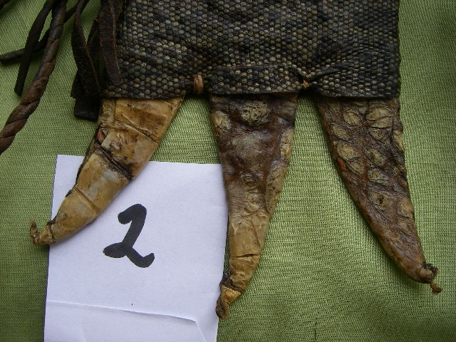

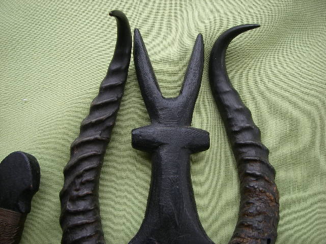

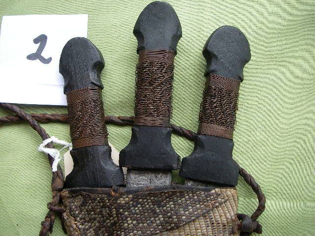

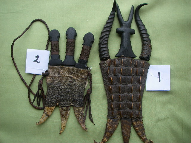

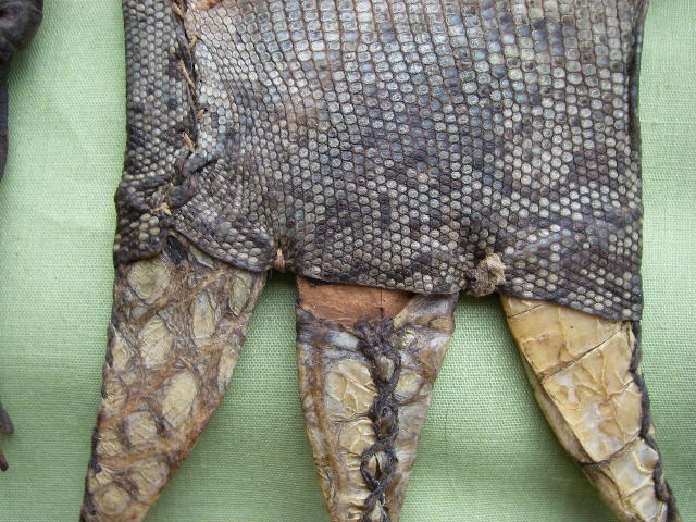

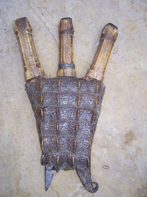

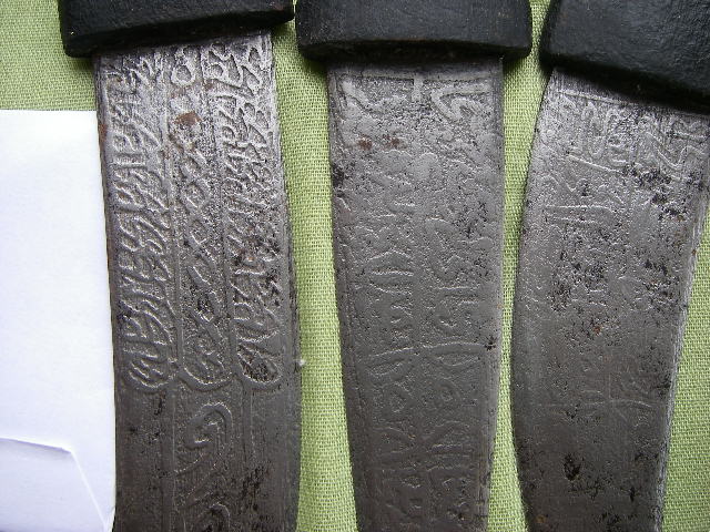

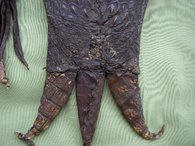

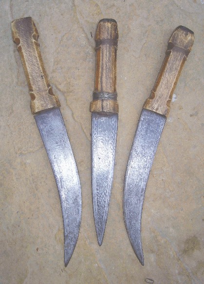

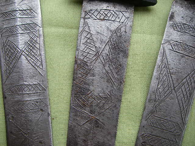

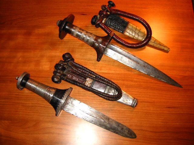

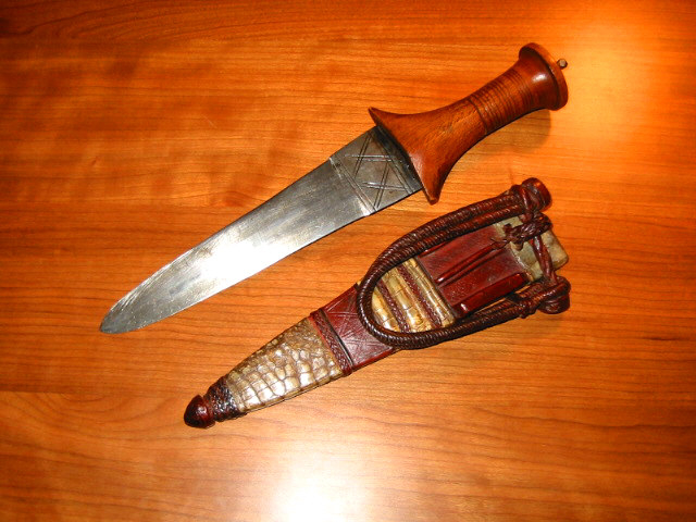

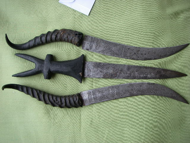

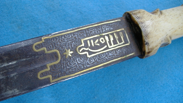

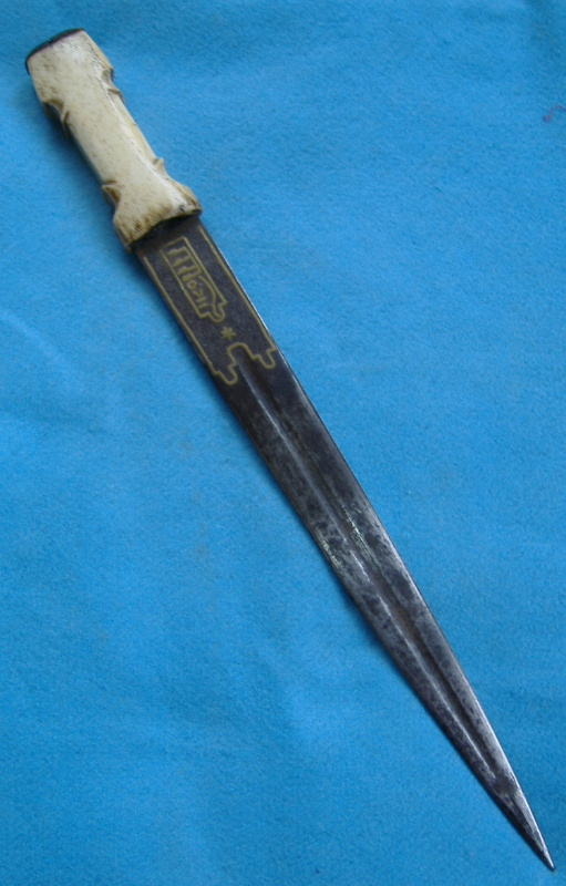

Hi all,
Here are two more of the 15 items I bought 2 days ago. The seller's father, now deceased, visited northern Africa in 1920 and obtained this and other edged weapons. They have remained in the family for 92 years.
The seller thought, but was not sure, that these dagger sets were part of a chief's regalia and were worn on the chest. Can anyone provide more information about them?
Brian

Iliad
Join Date: Feb 2008
Posts: 187

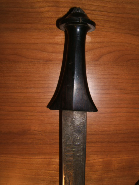

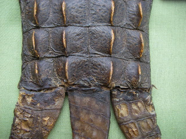

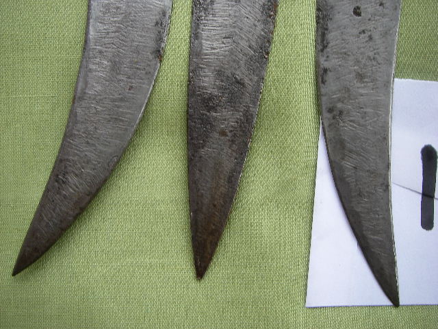

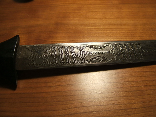

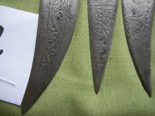

More photos
Iliad is offline   Reply With Quote

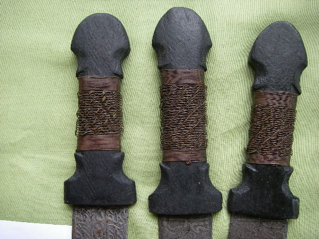

Old 6th December 2012, 07:10 AM   #3
Iliad
Join Date: Feb 2008
Posts: 187
A few more

Hi Brian
These daggers IMO do not look 92 yrs old to me? The hilts are poorly carved with no patina. The blade incisions are crude I would place these around 1950 or so not 1920. Anyway these sets of three daggers were geared towards the tourist trade back in the day. I never saw a photo with a warrior wearing this set of daggers

Hi Brian,
have to agree with Lou, not as old as suggested by the seller.
I have a set of these which I believe are early 20th C ...maybe late 19th ?

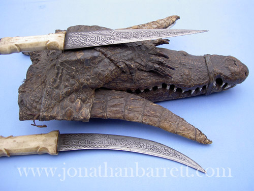

(picture below) These three knives with sheath probably date to the time of Mohammed Ahmed (1848-85) and the (Mahdi) revolutionary insurrection against colonial rule in Sudan. The double-edged blades are engraved on both sides with Arabic calligraphy. The use of crocodile hide on the sheath may have offered powerful warrior energy to the owner.
Source:
http://searchcollections.brighton-ho...+skin&record=0

I am inclined to find dismal assessments of ethnographic weapons tossed into the 'tourist' category both discouraging and disappointing. Discouraging for the collector and disappointing in that these proclamations tend to be judgemental and poorly qualified.
It seems that these weapons are from a grouping which seems to include other Sudanese items, and it is clearly stated these are from an estate which notes these were collected in about 1920 from there. With this as a terminus post quem, it seems reasonable to consider these from between the Mahdist period and until then.
It was interesting reviewing those old threads, especially from 2005, when I had thought this thuluth acid etching, not engraving, was done at Omdurman presumably by armourers for the Mahdist forces. I have since realigned my thoughts in discovering that this type of decorative motif was associated profoundly with the Mamluks, who remained in somewhat nominal power among the Ottoman rule in Egypt. Many of them due to the strained relations there had relocated in regions in Dongola and Sennar in trade activity, particularly slaving. Here many weapons came in through Suakin and other avenues, and I believe the Mamluk style thuluth was applied to them for dispersion via trade routes. The Mamluks were routed in 1821, however thier influences remained influential it would seem.
In my opinion these weapons in circulation were undoubtedly used during the Mahdist campaigns, and heavily collected in the subsequent occupation and events through WWI , probably in degree as seen here until the 1920s.
Tribal interaction and warfare continued in rural and remote regions much as always well through the 1920s and later. There was dramatic cessation of arms production, especially swords, after the Caliphate, but daggers were still made. I believe the thuluth covered examples are among the earlier,probably late 19th c. items.
The lack of patination, as was recently pointed out to me in discussion, with these kinds of situations with items out of early collections, is to be somewhat expected in pieces that have remained static in reasonably unthreatened conditions for many years.
The early photo of Sudanese warriors with one wearing this dagger pouch around the neck is telling, and I think the idea that these are tribally significant as badges of rank or authority (as noted by David) is well placed. The use of various weapons and implements etc. seems to explain the variations such as ivory grips on haladies and the alem heavily covered in thuluth as a standard.
The other pouch with less significant, but traditional designs on the blades seems in context but not as highly placed. It is interesting to see the horned pommel which is remarkably similar to those seen on the Black Sea yataghans, which likely led to the suggestion these originated in North Africa. Plausibly, examples of the BSY entered the Ottoman and Red Sea trade from Turkish ports and perhaps influenced hilts in Sudan via Egypt.
Again, very nice examples Brian!

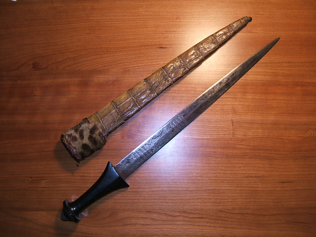

Old 7th December 2012, 03:15 AM   #12
Lew
Lew's Avatar
Location: East Coast USA
Posts: 3,191
Default For Comparison

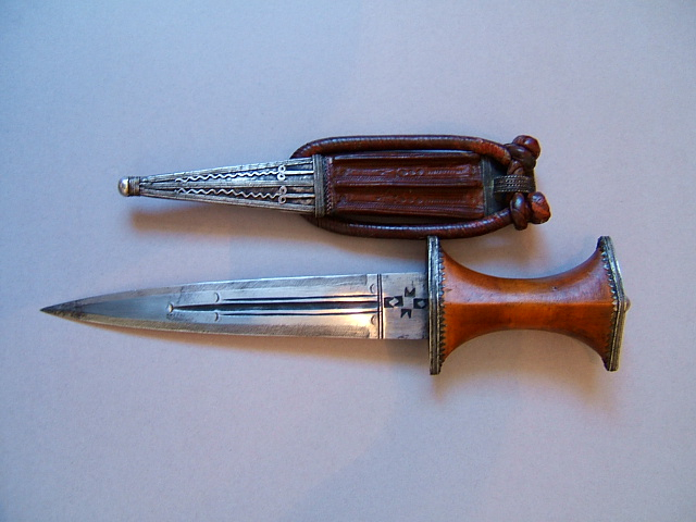

Just to compare what I meant about patina. Below a several examples dating from the 1890s-1940s Top photo lower dagger is circa 1890-1898 from Dafur the other one is circa 1920-30s. The next one down has an Arabic inscription on the reverse side Omdurman 1898. The one with the medium brown hilt and X's on the blade is circa 1940-45. The long bladed with the finely detailed engraved blade is circa 1900-20. All were tribally used and developed a smooth rich patina.

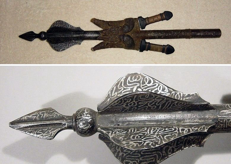

Old 7th December 2012, 05:35 AM   #13

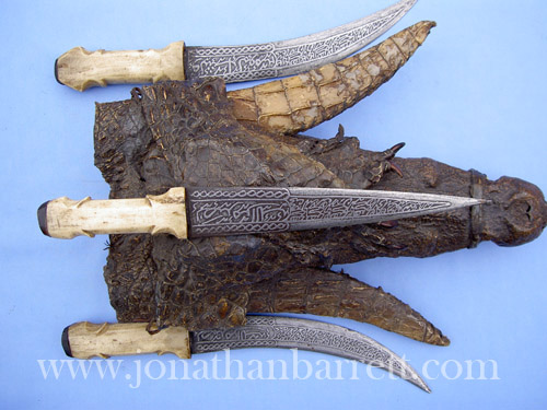

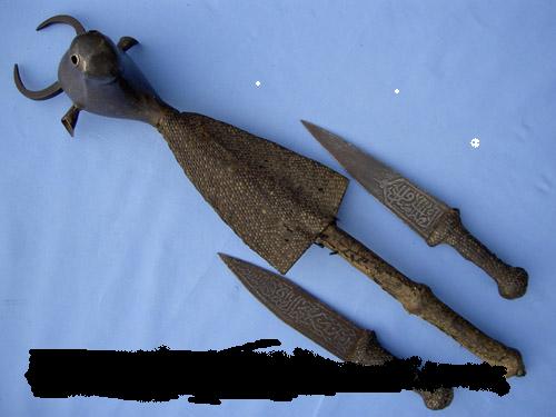

HERE ARE A FEW PICTURES OF EXAMPLES OF AFRICAN 3 WEAPON SETS. THE MOST COMMON ARE THE ONES WITH 3 DAGGERS. THOSE WITH SWORD AND 2 DAGGERS OR MACE AND TWO DAGGERS ARE MORE RARE. OVER THE YEARS I HAVE SEEN MORE EXAMPLES OF THESE DAGGER SETS IN POOR SHAPE THAN IN GOOD SHAPE BUT AS MENTIONED IF COLLECTED IN GOOD SHAPE EARLY AND KEPT AND MAINTAINED WELL IN A COLLECTION THEY CAN LOOK AS GOOD AS NEW. LOOK FOR DRYED OUT OR BLEACHED OUT SKIN AS WELL AS NOTE THE SMELL IF THE SKIN OR WOOD SMELLS FRESH OR STINKY BEWARE. BUT OF COURSE IT COULD BE OIL OR WAX PRESERVITIVE AND SOME ETHINOGRAPHIC ITEMS CAN BE STINKY EVEN MANY YEARS LATER.
ONE MACE HAS A HEAD THAT LOOKS LIKE A POTTERY GERNADE AND IS SAID TO BE MAMALUKE AND IS 21 IN LONG.
THE 3 DAGGERS SAID TO BE 19 CENTURY SUDANESE,18.5IN. LONG, NILE CROC.
ALL ARE SUPOSSED TO BE FROM MAHADIST PERIOD.
THE HORNS ON YOUR EXAMPLE ARE LIKELY FROM THE TOMPSONS GAZELLE WHICH IS ABOUT THE RIGHT SIZE AND QUITE COMMON. THE SKIN ON THAT SCABBARD IS CROCODILE AND YOUR OTHER SET IS COVERED IN MONITIOR LIZZARD SKIN.

Old 7th December 2012, 12:28 PM   #15
Lew
Lew's Avatar
Posts: 3,191
Vandoo the set with the cows head mace that mace is Indo Persian even though it is old. I just find these sets to be ceremonial rather than for combat the blades are very thin with no discernible edge. You often see Kaskara with this type on thuluth writing on the blade and they have dull edges also. There were a lot of British soldiers in the Sudan at the turn of the 19th-20th century. I just think some savvy locals found ways of supplying them with battle field keepsakes. It's amazing how many of these sets I have seen over the years.

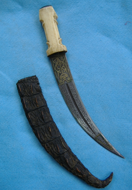

Old 13th December 2012, 11:00 PM   #27
Lew
Lew's Avatar
Posts: 3,191

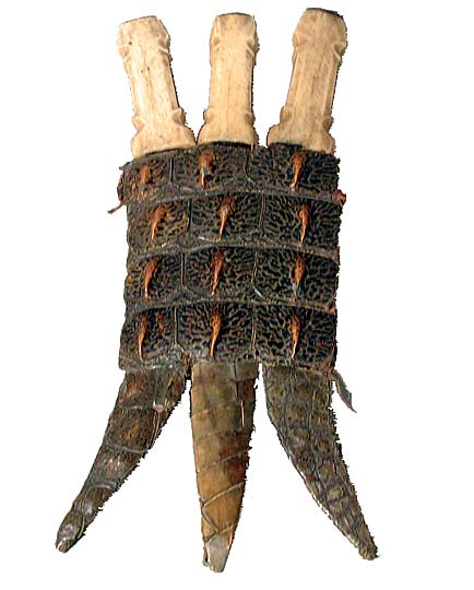

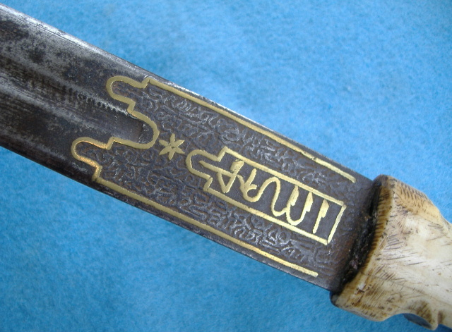

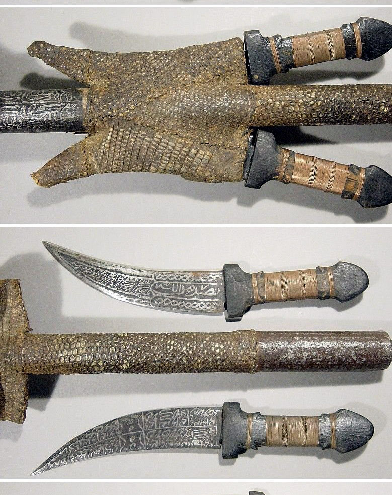

As promised here are two higher quality examples courtesy of Charles.
