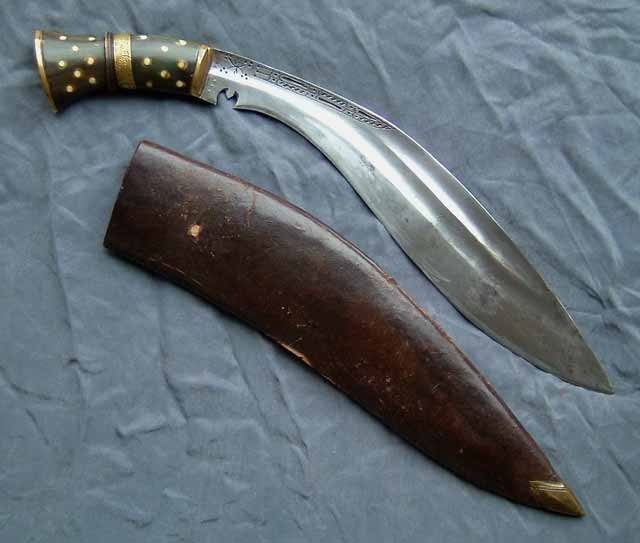

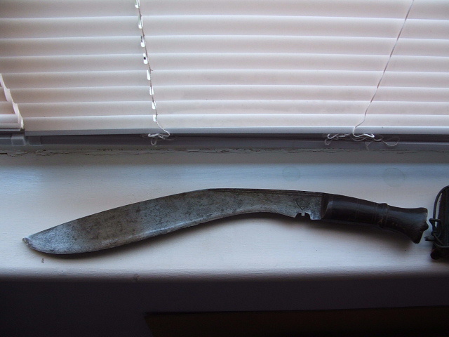

Hello all
This little gem fell into my hands over the weekend. Can someone tell me its age and place of origin. I have looked on other web sites but as yet have not found an exact match. The blade is 13inch long, the handle is 4inches in length and is finnished with a dome cap. The mark on the blade looks like a stylelised deer head or similar. The scabbard is interesting in having a large tinder pouch. The brass scabbard tip is marked with what looks like I&M (samemark is stamped on the tinder pouch ). Both small knifes are missing. Thanks in advance.

From what I understand, the steel bolster points to a pre-1900 piece, along with the easy slope of the blade.

HI Andy,
The scabbard is fairly rare & probably early ww1 & may be marked & dated at the top of the pouch under the flap.
It was made for thr mk.1 issue kukri.
It is official British Gurkha issue.{& Garhwallis, Kuamon, Assam, & Burma units etc. of course.}
The kukri is not any regular military pattern. So it wont truly be identifiable.
Steel bolsters are still made & have been throughout the 20th century.
Brass bolsters are probably post 1910.
But steel is still currant, & a sign that more time was taken making the kukri than brass ones.
That particular shape doesnt date the kukri. But as a pure speculation it could be ww1 or 1920s era.
It may have been taken into ww1 but it was not an issued pattern kukri.
If you ever want to sell the scabbard or trade it, give me a shout.
Spiral
P.S.
I can normaly be found at IKRHS Forum or on Tora Forum.

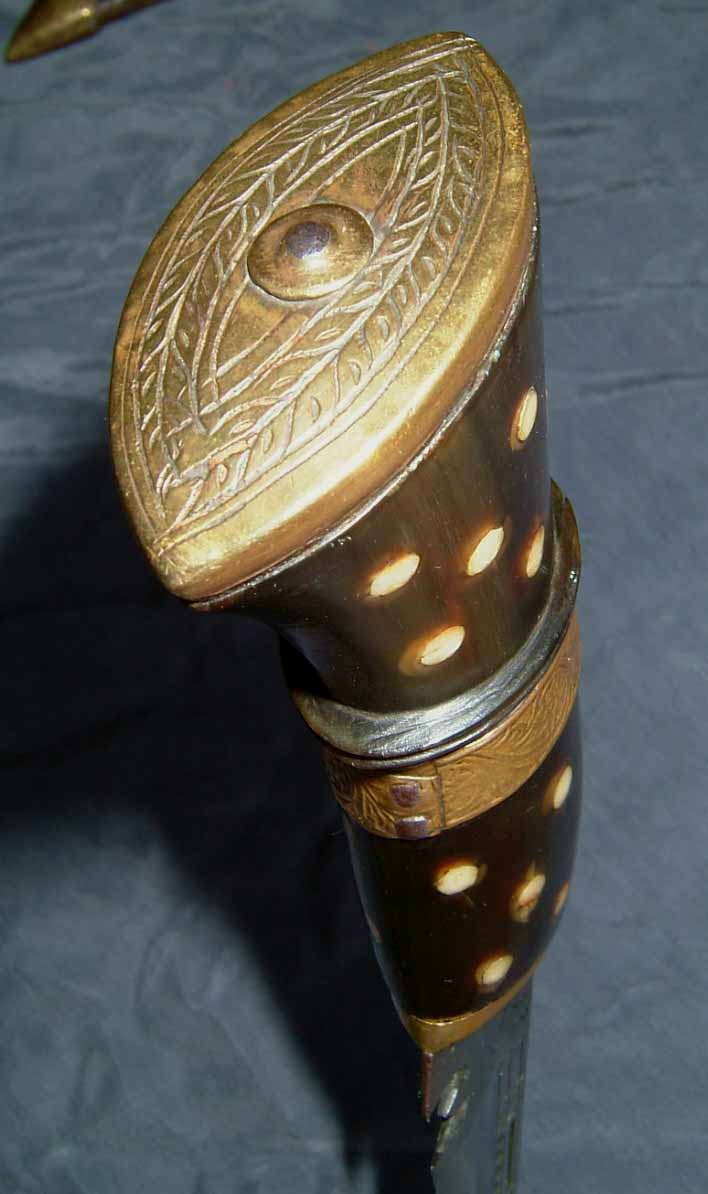

Hmmm , I thought I'd already posted a picture but a search fails to reveal it , so here :
I'd love to get a pair of knives and pouch for it and to have the scabbard re-covered (cut along the edge) .

These ones with inlay are rather attractive I think, is it possible to tell what the inlay is, or are the fragments to small for positive id?
It reminds me of one I saw about 4 years ago, that had been bought out of Singapore in the 1930s. It could even be the same one? Last time I saw it was on ebay heading to a well known American collector.
Most serious kukri collectors try & pick up one of these models. I was lucky to find this pair together & both obviosly made by the same hand.
You do get various qualitys of them, ranging from good to exceptional, I would say. As with most hand made kukri. Some dont like the brass so much,because of the dating but the other versians of them were still bieng made into the 1920s as well. So it makes no odds I think. Silver is always nice of course!
But A good kukri is a good kukri, afterall.
Although I Must admit I dont bother with many post 1950 ones.
Do you collect kukri? or is it just a "stray" you came across?
Spiral

The inserts could be either bone or ivory ; just not sure .

What did you make out the inserts to be ; bone or ivory ; I lean toward bone .

I cant realy recal Rick, I have a slight thought that some seemed bone some ivory? But couldnt swear that was this piece.
Glad you like it, as I recal it had a great feel to it.
