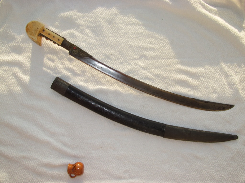

The length is 76. 6 cms, without sheath 73. 5 cms, blade 59 cms. Width of the blade is 3 cms (yelman 3. 5 cms), max thickness is 7 mms. I do not know too much about yathagans and I would be interested in any info (provenance, if such combination was common, etc.). The sheath (if not original) is old.Thanks

Unusual combination and I would speculate that perhaps the blade is older and may have belonged initially to a Kilic type weapon. I do like it especially the blade, one intended for use and not for merely 'stepping out'. Hope we can get more info from some of the more knowledgeable Forumites.
Norman.
Old 26th November 2012, 04:12 AM   #3
Posts: 7,407
I agree. As I mentioned in the other thread looks like a Balkan hilt with a kilij blade.
Never seen that before.

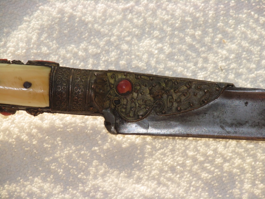

Thank you Noman and Battara. As far as the handle is concerned - for me (maybe wrongly) "Balkan" is relatively big region which includes territory from the northern Rumania (and maybe even Besarabia) and Alps foothils down to the Medditerranian Greek isles. Was this hilt used throughout all this territories or was more specific for some of them ? Is the material bone ?

Big walrus ivory eared hilts are attributed to Bosna and the Western Balkans. I am not sure the blade was taken from a kildj/pala. To me it looks much more like a nimcha blade, as in nimcha meaning a half sword. My guess would be that someone wanted a yataghan hilted cutlass, possibly for naval use.
