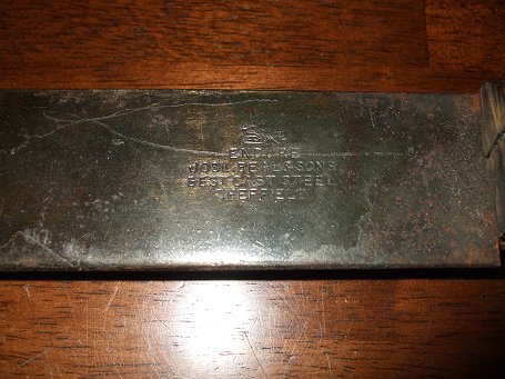

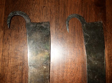

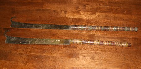

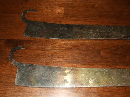

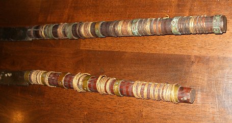

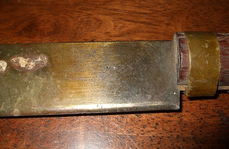

Here are some pics of a pair that I purchased a while back. These were collected by a Mormon Missionary that was in Samoa during 1929 and 1930. The blades are British steel. One is marked with a Boar's head over the words "Endure / Josh Beal & Sons / Best Cast Steel / Sheffield", and the other appears to be Birmingham / England, but I can't make out what's stamped above it.
The longer of the two is just under 39" overall in length, with 19 5/8" of the total being the blade. The second is 37 1/2" overall in length, with 20 1/4" of the total being the blade. The steel blades are 1/8" in thickness. The coconut fiber cord is pretty unraveled, but hanging on.

wow!!!, nice.. seems those were british made blades,,so i guess there was enougth demand for them to produce them i a quantity,, has anyone got any of the clubs these weapons were based on?

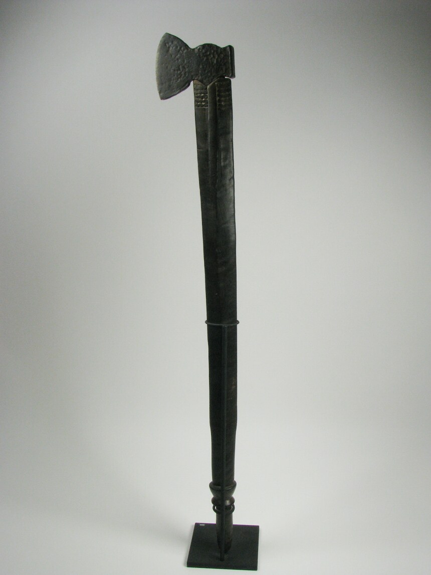

MOST OF WHAT WE CONSIDER OCEANIC SOCIETYS WERE STONE AGE IN THE PRECONTACT DAYS. THE HIGH ISLANDS HAD STONE ( VARIOUS FORMS OF LAVA, BASALT BEING THE ONE HEAVY ENOUGH AND STRONG ENOUGH TO FORM A HAMMER OR ADZ, THE OTHER FORMS WERE SUITABLE FOR GRINDING SOFT FOODS, ECT OR AS ABRASIVES FOR SHAPEING OR FINISHING WOOD, SHELL OR BONE. THE LOW ISLANDS HAD NO ROCK AND LIMITED TYPES OF PLANT MATERIALS. HERE BONE, CORAL AND SHELL WAS USED IN PLACE OF ROCK SOME ROCK MAY HAVE BEEN OBTAINED FROM HIGH ISLANDS DURING VOYAGES OR TRADE.
THIS WOULD HAVE MADE IRON WORKING VERY DIFFICULT EVEN IF IRON ORE WAS AVAILABLE. A PIECE OF FOUND IRON COULD HAVE BEEN POUNDED WITH ROCKS AND WORN DOWN BY HAND GRINDING ON A ROCK TO MAKE SOMETHING. MOST OF THE IRON TOOLS CAME TO THE ISLANDS THRU TRADERS ONE OF THE MOST FAVORED BEING A HATCHET OR SMALL AX HEAD. THE AX HEADS DID NOT TAKE UP MUCH ROOM AND WERE IN BIG DEMAND AS THEY COULD BE USED AS A TOOL MAKEING TREE CHOPPING A LOT EASIER AND ALSO MADE A DANDY WEAPON. THEY WERE MOSTLY OUTFITTED WITH HANDLES BY THE TRIBESMAN AND WERE USED ON MOST ISLANDS AS WELL AS IN THE AMERICAS WHERE THEY WERE CALLED TOMMAHAWKS. OFTEN LATER EXAMPLES BECAME MORE ORNATE AS THEY WERE DESIRABLE AS A PRESTIEGE ITEM NOT JUST A TOOL.
THE SAMOAN KNIFE WAS PATTERENED AFTER A WOODEN CLUB DISTINTIVE TO SAMOA IT MAY HAVE BEEN SPECIFICALLY MADE FOR TRADE TO THOSE ISLANDS AND SHAPED ACCORDINGLY BECAUSE THAT FORM HAD CEREMONIAL OR PRESTIGE MEANING. I CAN'T THINK OF ANY OTHER WOODEN CLUB THAT WAS REPLICATED IN STEEL FOR TRADE PURPOSES SO PERHAPS THE SAMOAN CLUB/KNIFE IS UNIQUE IN THAT REGARD.
SEE EXAMPLE OF A COMMON OCEANIC TRADE AX FORM

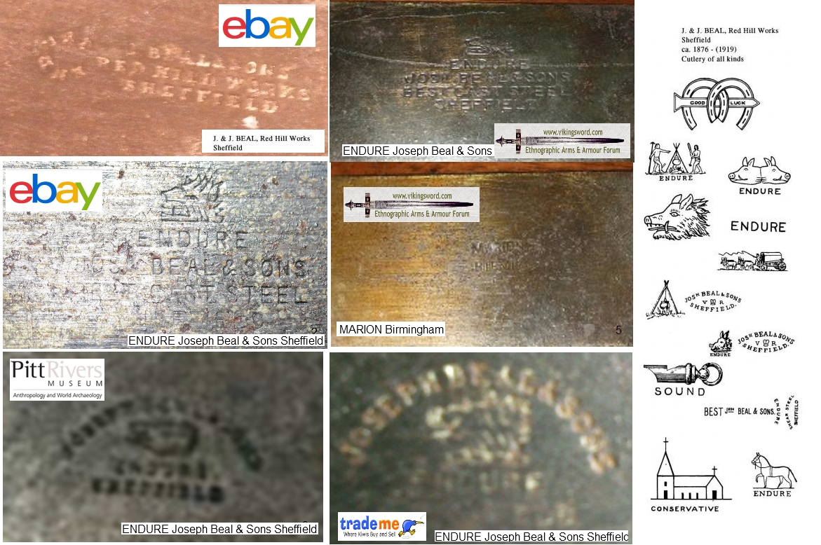

I've done a bit of a study on photos that have been publicly available of Nifo'Oti (I've sighted eight early Nifo'Oti) and most of the early examples were manufactured by Joseph Beal & Sons in Sheffield. Some had no markings so they gave no clue to their origin. It is unclear exactly when they were exported to Samoa. Several of the Joseph Beal & Sons blades have different markings - indicating different shipments.
Below is a compilation I've made of the markings. I've included the logo of the websites where they were found. It would be interesting to hear from collectors that have a Nifo'Oti that I don't have a photo of yet.
While there is no doubt these Nifo'Oti (translated Tooth cutter and modelled on pre-european contact wooden Nifo'Oti) were used for warfare - they were primarily used as an agricultural and multi-purpose tool. Being a prized possession of the chiefs and higher class. This is also indicated by the regular display of Nifo'Oti rather than other weapons in early photographs.
