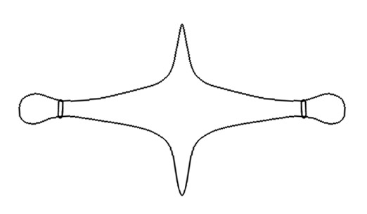

hi,
i am currently looking into the origins and dating system for this specific type of quillion block.
all books tend to assume the earliest form goes to the 17thC (and of course into the 19thC), but i wonder if this assumption is becauce few (if any) earlier examples exist. i personally feel it could go a few hundred years earlier.
please note the proportions, the rounded quillion ends and the ridge before the elongated ball-ends.

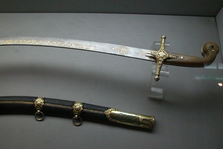

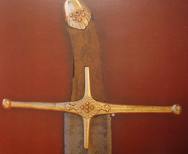

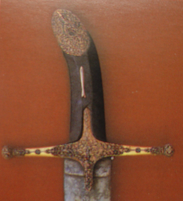

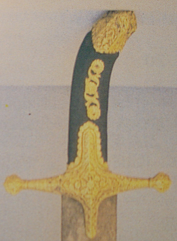

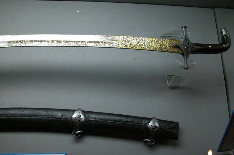

Ok, so, just to set the ball rolling, here I put some swords from the Military Museum in Istanbul that are labelled as 16th c. and that allegedly belonged to some of the Ottoman rulers of that time. Sadly, I know nothing about the reasons that may support such attributions (I suppose the inscriptions in the blade may have something to do with it) nor how reliable may they be.
In fact, I'm afraid I must confess I don't know enough about "eastern" swords of this period to really feel comfortable discussing the finer points of the origin of a crossguard typology, but I happened to have these pictures and thought they could contribute to this subject...

jens, i dont think the answer will appear in merv, but will happily ask ann. i am hoping that wolviex will join in (hint) or aqtai/kirill as i feel the answer will be in ottoman/mamluk/eastern europe.
marc, thank you for the images. the blades you show are wonderful, but unfortunately it is these swords that are leading the arguements against me. all the hilts are later. whilst i would hope the quillion blocks could have been original, the grips are definately a latr addition. the grip would have been slightly slanted off to one side with a pommel cap. btw, can you read french (an obscure and unrelated question)
kirill, this is interesting but can you expand as my 'great' library always seems ridiculously inadequate when you quote sources
Thought so, but I felt it was at least worth a try. I'll keep my eyes open, anyway.

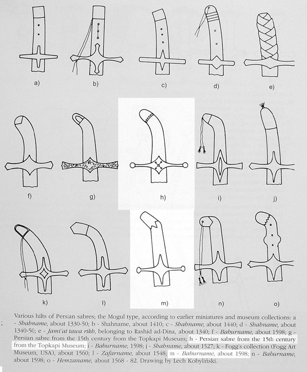

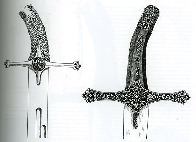

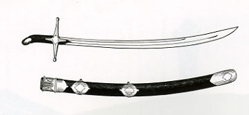

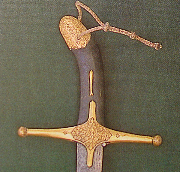

Sorry about that. Attached are:
late "mamluk" (??) , and two "turkish" sabres, XVI century.

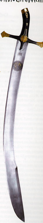

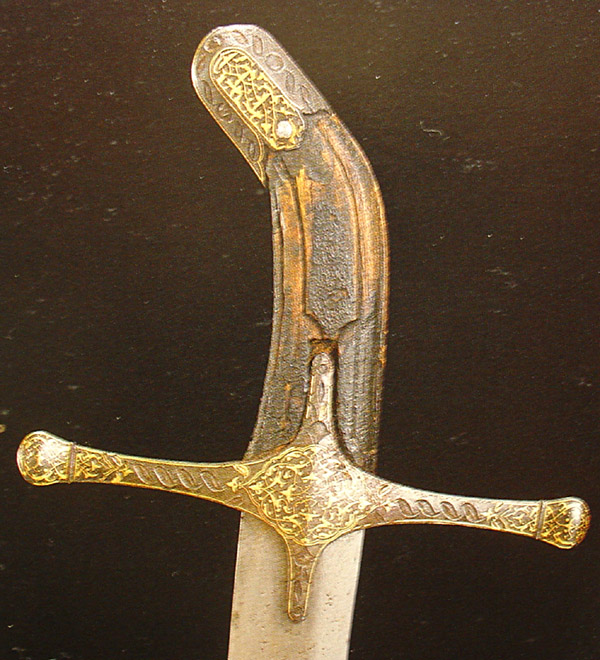

This sword is attributed to the Mamluk Sultan El-Adel Tumanbay and is dated 1501 AD. The sword is of "kilij" type and is in the Museum of Islamic Art in Cairo, although I have never actually seen it. the picture comes from Esin Atil's "Renaissance of Islam: Art of the Mamluks".
Atil describes the crosspiece as being made of gilt silver. Judging by the appearence of the hilt I have a suspicion that it may be an Ottoman replacement, although Atil makes no mention of this.
The reason for my suspicion being that this hilt is quite different to the 15th century Mamluk hilts depicted in Yucel's book.

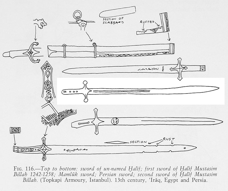

The sabre was brought to europe by a few nations (or tribes) - the Avars, Magyars, Pechenegs and the Kipchaks. Today we can find a lot of early medival (VIII - XI century) sabres in Ukraine, Hungry, Slovakia and Poland (well only two, but i had to mention ).
Below - Kirpichnikov's sabre crossguard typology XI-XIII century
A Xth century sabre from Chernihiv (ukraine)
A Magyar sabre found in Poland (near Przemyśl)

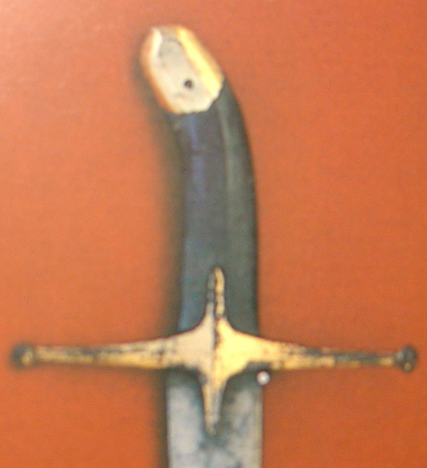

i have attached some early pieces from the topkapi (sorry for the poor quality). where many of the swords were thought to have later hilts, these are clearly early and more like the one i am after (although the quillions are somewhat longer).
an early mamluk/hungarian miniature would be a wonderful find!!

Astvatsaturjan is very specific in attributing the attached kilij to 16th century. I do not know if it is what you are looking for.

yes, this is exactly what i mean, and the sword you show is of the same ilk as the last pics i posted. i think what i am looking for is the same, but maybe a little shorter in width, and definate dating.
