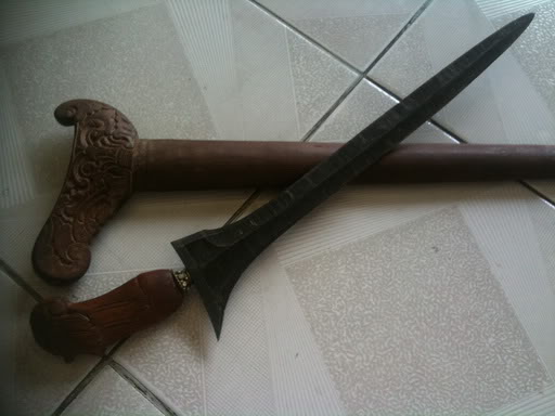

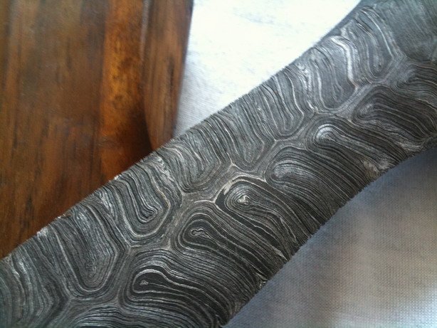

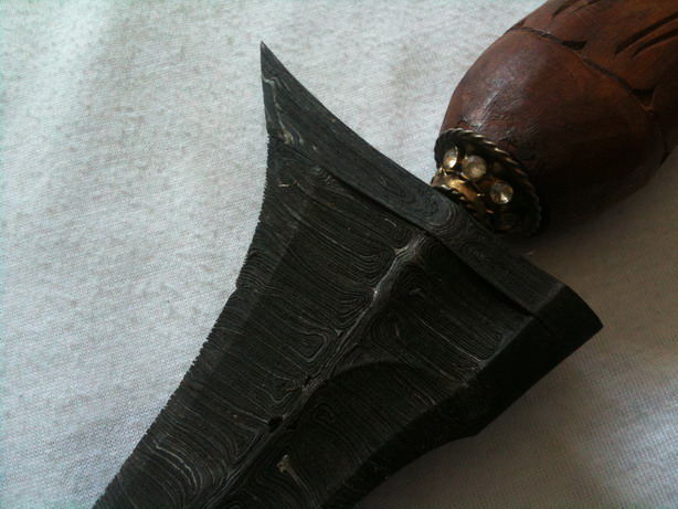

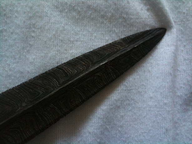

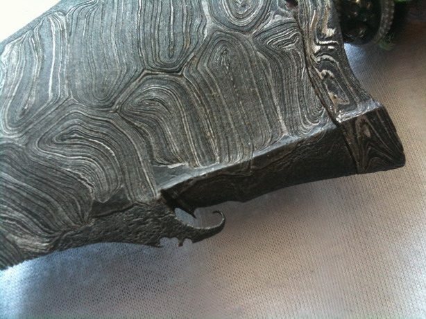

Hi all

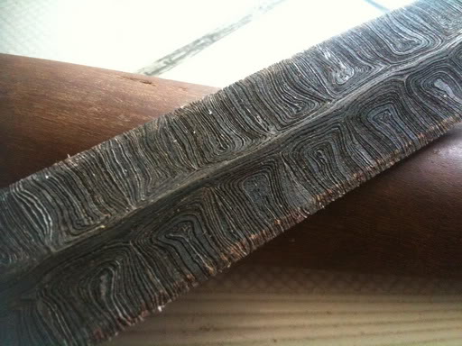

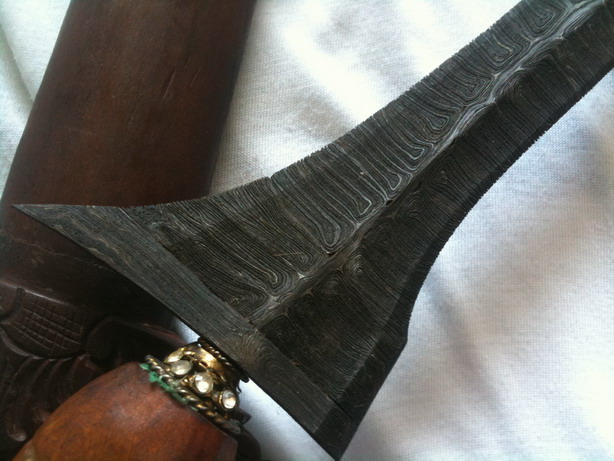

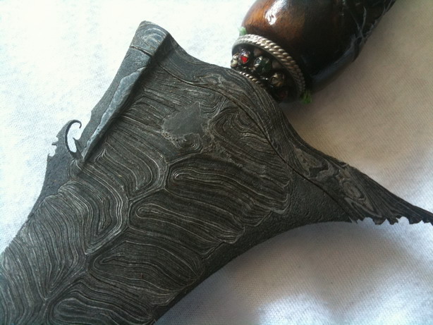

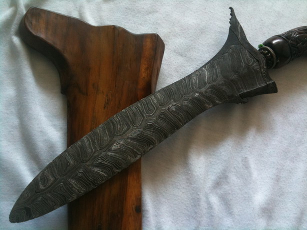

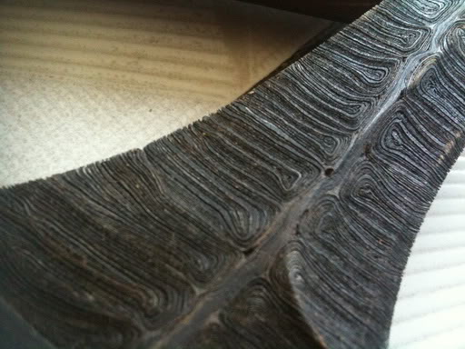

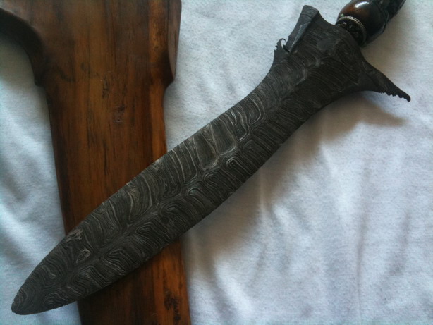

in spirit of sharing knowledge, here it is another keris of mine.
This keris is simple. What makes it nice is the pamor
I believe this dhapur is known as Jalak Ngore (CMIIW), and this one is not stained properly due to poor storage before
this one has "Unthuk Banyu / Unthuk Segara" pamor
Unthuk banyu means = froth / foam of water / sea water
it is believed this pamor will help in terms of relationship with others
this pamor is unique, apart from it is rarely seen, this kind of pamor along with time and maintenance, the different metal will corrode differently, and producing saw-like edges (can be seen in the pictures)
the "wood" powder you see in the pictures is sandalwood powder
about the age ... say this one has been someone's family heirloom for 30 years, so at least it is 30 years old

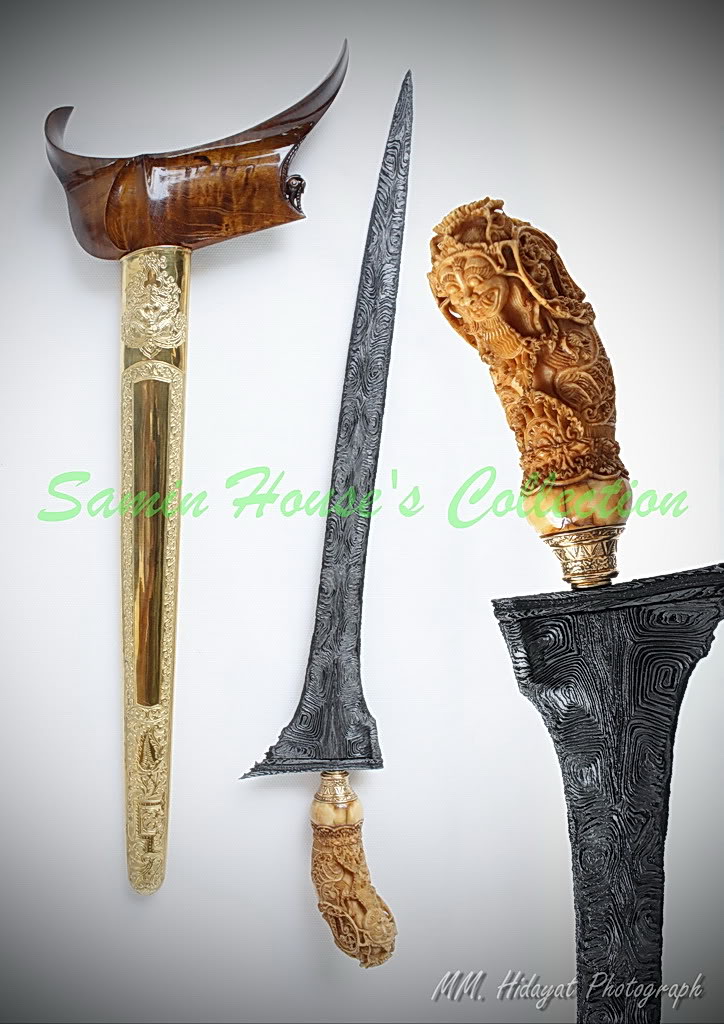

first, I have to borrow one pictures of friend of mine in Indonesian forum about similar keris, but thought to be made in 18th century, courtesy of Mr. Hidayat - so comparison can be made
pardon my pics as I took it using iphone
enjoy!!
regards
Donny

Fascinating pamor. Is the this recently made stuff?
Old 18th September 2012, 01:16 AM   #3
Posts: 6,426
Looks like two different pamors to me, first one looks like balls of string ; yes, the second example's style has been done in recent times .
Both are not unknown in newer keris .
Old 18th September 2012, 01:52 AM   #4
Posts: 7,290

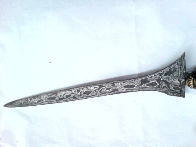

Not sure just how much comparison can be made. I agree with Rick, these are not the same pamor patterns. Also agree that Donny's is current era.
Hard to say solely from photos of Mr. Hidayat's example. Lovely current era dress, but i am afraid i don't know how to spot a well made and expertly aged modern piece from the real thing strictly from a couple of photos. While complex pamors of this sort are known to have existed in older blades, well preserved examples such as this are few and far between. It (Mr. Hidayat's) is a beautiful keris regardless.
I believe so
newly made (kamardikan) in terms of keris could mean somewhere between 0 - 67 years

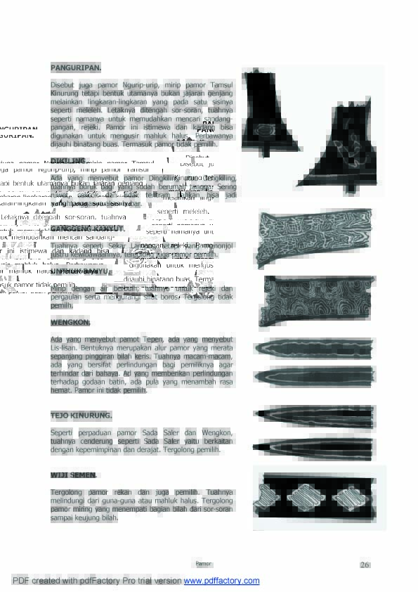

I agree with you, as with books I attached below, the unthuk banyu pamor is confined within the blade, and in mine, it is becoming parts of the cutting edge.
you mean that the pamor, which like )))((( is the 1st pamor
and the spine consists of another ??
if so, what pamor do you think this keris is ??

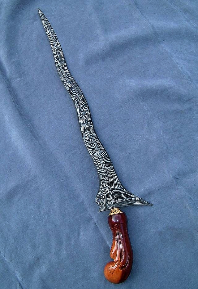

if you see this example, http://agenbiteofinwit.com/keris2.html
and according to couple friend of mine, my keris above still categorised as unthuk banyu pamor
but I am agree that there are differences between both blades. Therefore, what pamor do you think it is ??

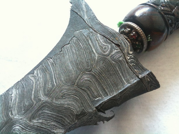

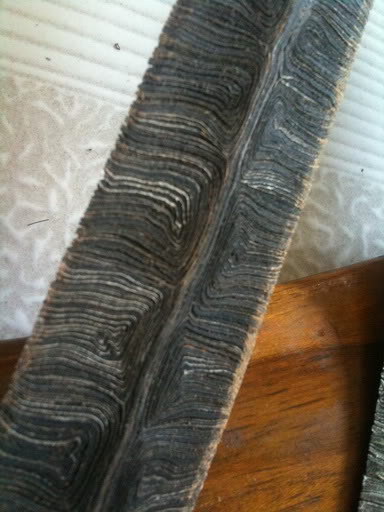

here's more pics and also a page from my book explaining about pamor unthuk banyu

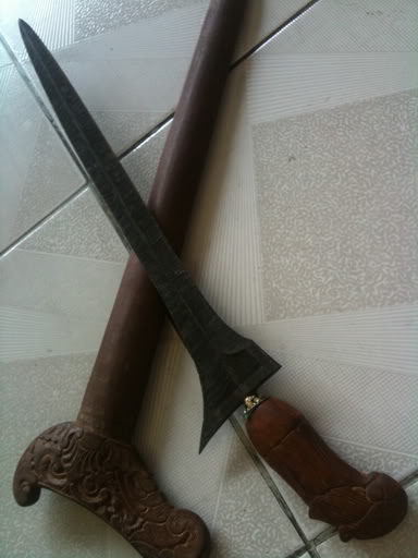

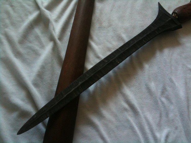

continuing the story ...
this particular keris comes in pair ... there's another one in different dhapur but with the same types of pamor when I bought it
perhaps the previous owner needs popularity so bad as this type of pamor is believed to boost in relationships and popularity
pictures will be posted, soon

Posts: 7,290
Your pamor does seem to be closer to the one in the above link.
As to what pamor to call Mr. Hidayat's keris, i couldn't really say. Personally i don't spend too much time trying to figure out pamor names since they tend to sometimes change from era to era, region to region and even village to village.
yeah, I know that
but in light of education, I personally tend to use familiar terms in books rather than following local dialects

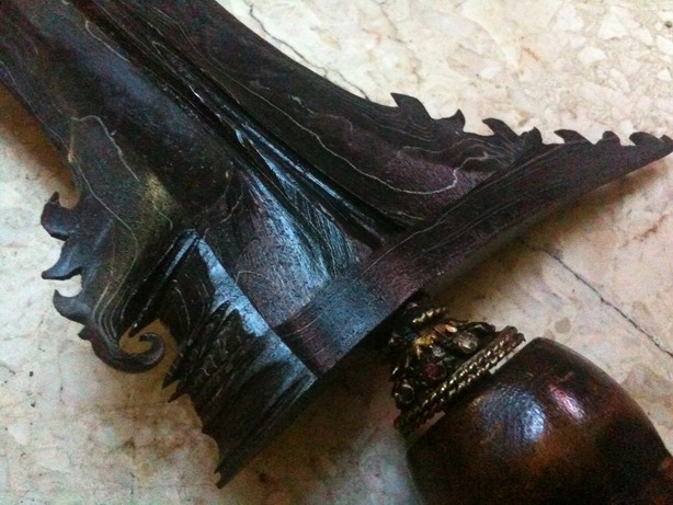

now this is another keris, which comes with the jalak keris and definitely kamardikan (according to me)
any comment is welcome

From a bladesmith's point of view those two different pamor are quite wonderful. The first one is more difficult to forge than the second.
Well worth stealing those for my own work.
Thank you for posting them.
Ric
Ric
You're welcome, Ric
I have seen and held hundreds of keris, and still considered myself a newbie, and this type of pamor is rarely seen, perhaps due to the difficulty in making it
and your comment is similar with my first thought on this keris - how can they made something so intricate, yet so beautiful ... with limited resources compared to modern smiths
that's what driven me to preserve this blade
satsujinken is offline   Reply With Quote

I don't think Hidayat's keris is recent David, I've only ever seen old examples of this pamor, also the style of the blade is an old style. I've got an example of this myself.

CMIIW, as I am a newbie in this field, but as far as I know, balinese tend to stain their blade blacker than javanese keris ? my friend here named the style of staining of balinese keris as dongsalibing
the final result is the balinese keris is much darker and smoother than its javanese counterparts
I may be wrong, as I never encounter this information on any books, but from several friend of mine, who are in this field for couple of decades
look at the comparison below, keris bali first, keris jawa second
