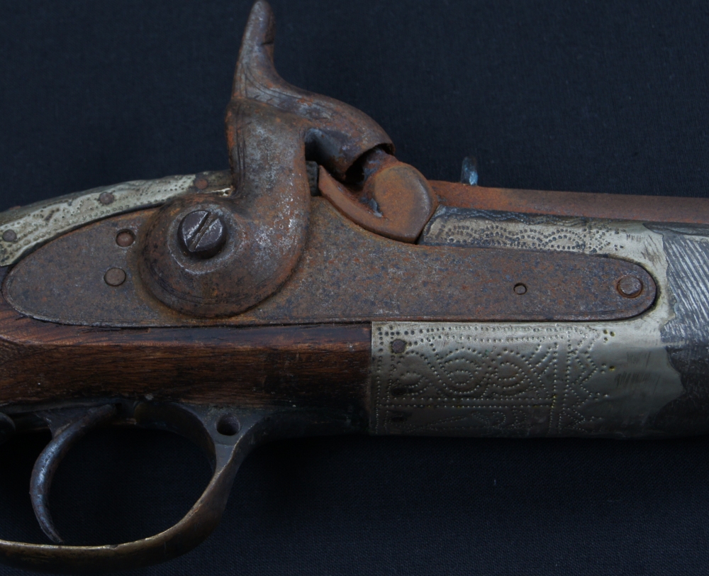

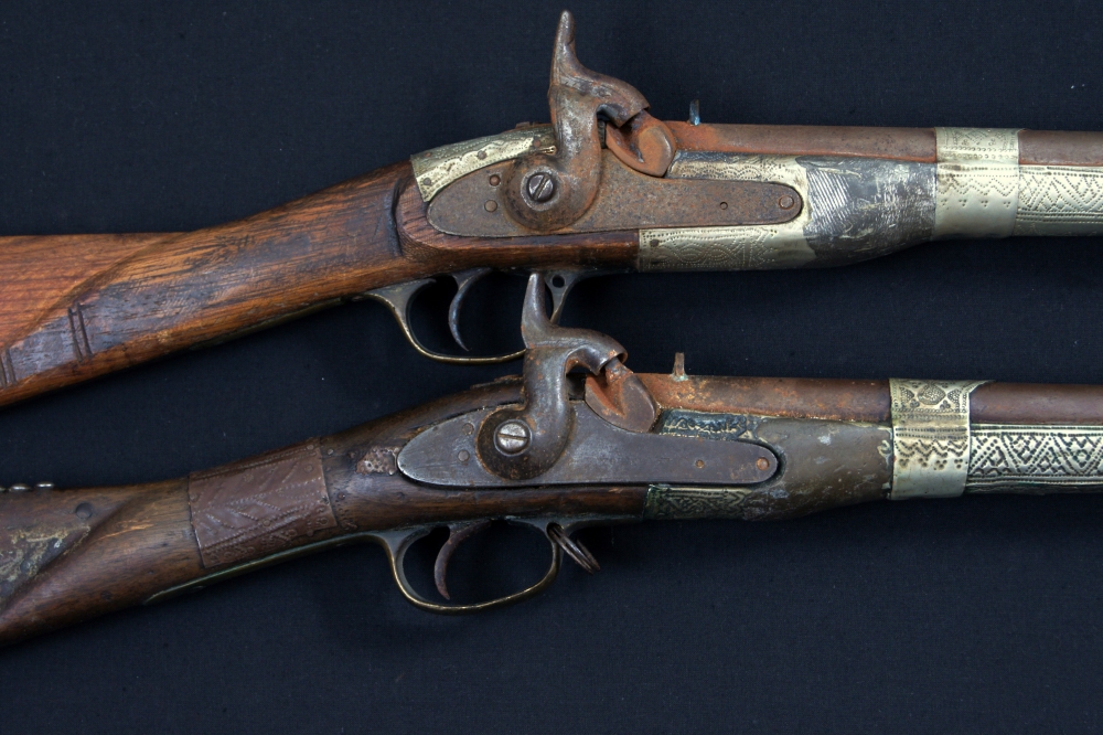

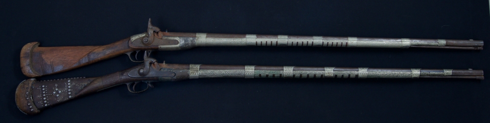

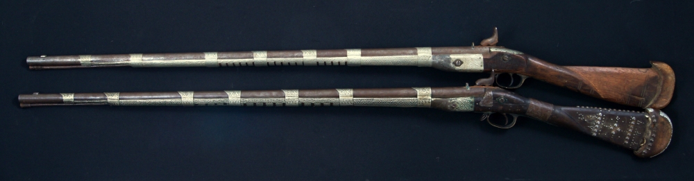

Following on from a previous thread where we discussed the amount of guns that were made by recycling British army gun parts, here are a couple that basically recycled the whole gun. Hope you like them.
These are as they arrived to me, totally untouched, hence the rust which I, and the other new co-owner will no doubt remove as soon as we can. The guns started out life as Enfield P53 rifles but ended up in a Swedish diplomat's house in Saudi Arabia before coming to me. The stocks have been condiderably modified, especially the more decorated gun and the barrels have been bored out smooth. I do think the the barrels are original though because they are the regulation 39 inches, correct calibre and have all the proof marks and army stamps still visible. Ramrods are the originals as are trigger guards and locks. One lock is a Tower lock, Crown VR and dated 1855, the other needs cleaning before we can see if there is legible date, but it looks as though its got the crown at least, and I believe is the original lock.
The original guns should have had a ladder sight but these have been removed and a more traditional pinhole sight has been added.
Looks to me like the silver work is done by the same person, but not at the same time - or someone tried to copy the pattern on to the second gun, but stopped decorating once they got to the wood work. The gun certainly has been used though, so it was not that they just never finished and packed the gun away. Interesting that on this one the enlarged butt end is actually part of the old stock where they have cut the rest of the wood away. On the more decorated gun the enlargement is separate, and decorated with studs, a back plate, and what looks like animal teeth.
Chris

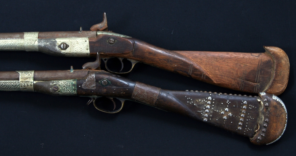

Not teeth but likely claws---either animal or bird. I once owned a Khyber Jezail which also had these.
Nice guns by the way and I particularly like the more decorated one. In respect of "recycled" British guns and gun parts, it has to be remembered that the British held sway over a very large part of the Middle East and the Indian continent, and the quantity of guns around must have been huge.

Absolutely fascinating examples, and I think these now tribally associated guns are exciting as they were in use over such a long time, even into recent times. As always I am ever interested in the motifs and potential symbolism imbued in the decoration of these. I wonder if the 'claw' representation might be related to the talons of the falcon, I think a well established predator bird in the Arab world.
I am interested in the tacks used in motif as well, and while definitely not suggesting any connection, cannot help noticing the similarity to the decoration found on American Indian guns of the 19th century. I would presume these may be 'furniture' type tacks which were present in trade and 'settler' type situations. It seems that the cross was convergently present in many circumstances and often represents the four cardinal directions, a tribal representation of universal power.

Salaams Jim, Tacks were used as ballast in Victorian times on ships bound for India and adorn many artefacts such as chests of furniture ... and in this case guns. Amazing claws in the butt !

Salaams Jim ~ I think you are correct on all counts however it is a fact that the old and tested systems ruled longest as put by the late Anthony North in his Islamic Arms treatise .. For that reason we still see a lot of abu futtila (the one with the match) matchlock gun barrels though there are a lot of Martini Henrys and Enfields some in very good order... favoured by Palace guards and the various official Muscat gendarmeries often under British control in the late 19th C. The Bedouin preferred Martini Henrys; barrels cut back about a foot removing nicely the bulky bayonet fitting whilst retaining the accuracy(amazingly) and lessening the weight! Ajman and Muscat star highly as import points; therefor in addition to weapons entering the market as palace guards weapons became obsolete(ie their old weapons were sold by the authorities to the souk) Muscat also attracted Martini Henrys, Enfields similar to the ones at thread and the later 303 black powder versions and other marks from all points of the compass.

Salaams Jim ~ Interesting guns. The pin patterns may have some meaning to the originator and certainly on furniture chests there are set patterns so why not on guns?.. I feel that the pins may represent the round ball ammunition. I noticed that on the black weapon forward of the trigger there is a plate resembling a coat of arms and except from this that the two weapons have almost identical markings from the trigger forward. I note a strengthener of different material on the same weapon behind the trigger wrapped round the narrow part of the Butt as it has split previously.

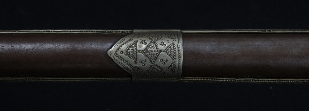

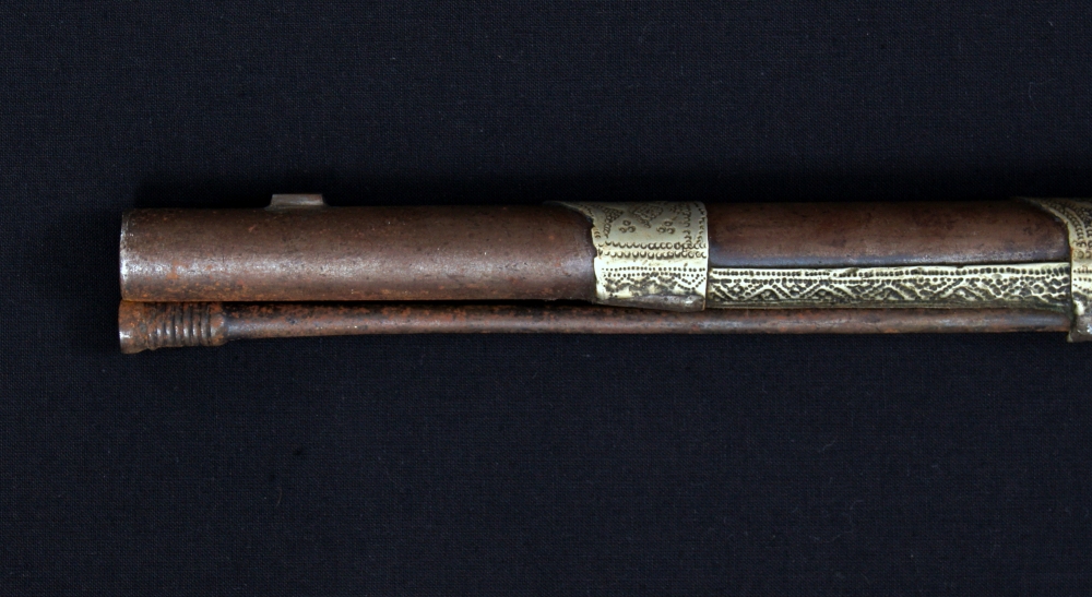

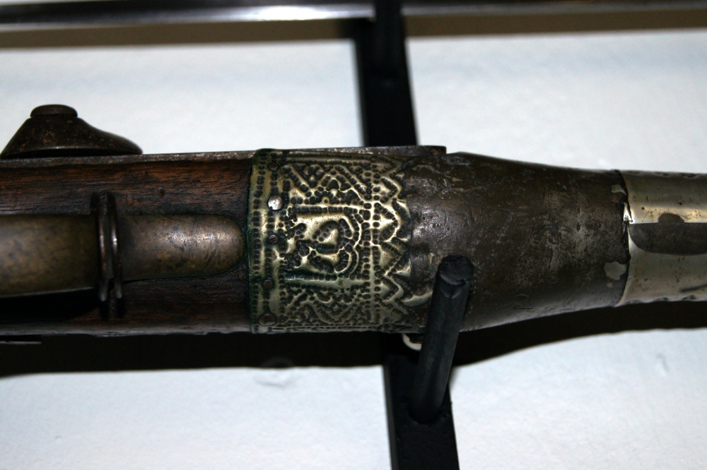

Not sure if it helps your discussion of the patterns and their significance, but here are a couple of pictures of the patterns you could not see before. One which is duplicated on all barrel bands on both guns, the other is forward of the trigger guard. The third picture is the non-studded gun same location - the best angle I have. If we need more pictures we will have to ask the new owner.
Chris
