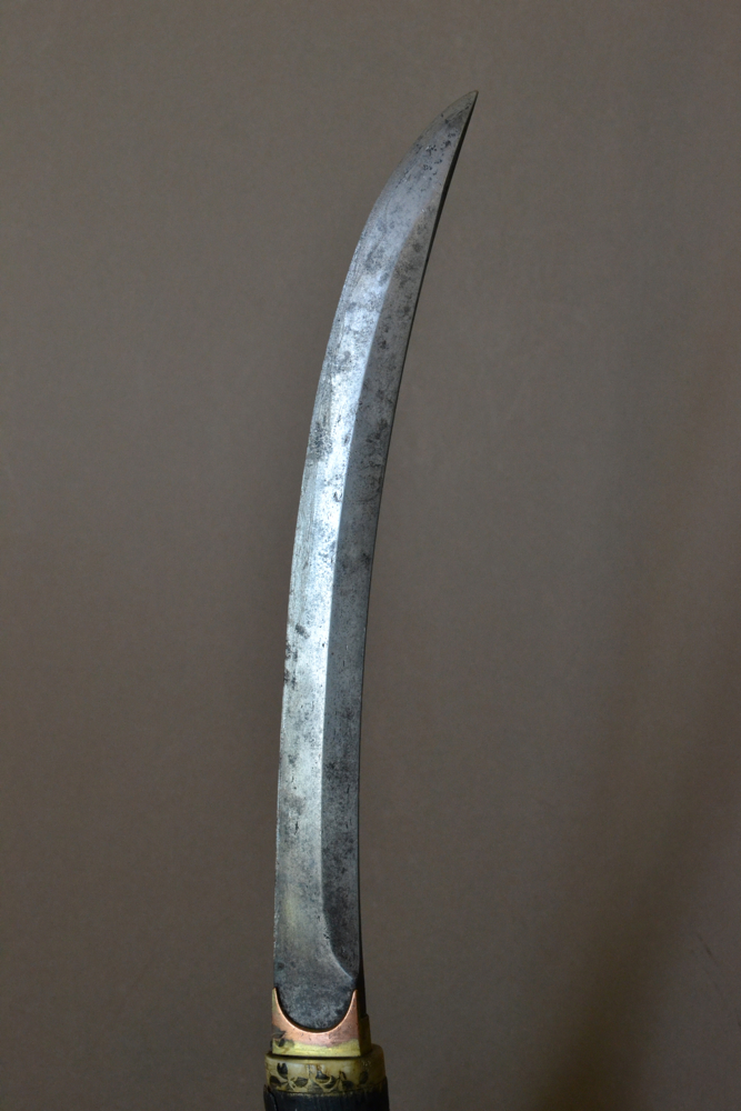

I had posted this blade in another forum dedicated to the discussion of nihonto:
It is a tanto-mounted naginata. For those not already familiar with the term, naginata were the Japanese polearms mounted with single-edged Japanese tanto- and wakizashi-length blades, used by both Samurai and Japanese foot soldiers.
However, the mounting of this example is atypical of Japanese mountings, leading a couple members to suggest an attribution to the Ainu, the indigenous people of northern Hokaido, the Kuril Islands, and southern Sakhalin (Russia). Another poster suggested a possible attribution to one of the cultures or civilizations with whom the Japanese conducted trade.
This latter comment sent me on a quest for information regarding Japanese trade during the Tokugawa Shogunate (1603-1868). Wiki has a nice entry on the Japanese Red Seal trade, from which I read briefly about the export of Japanese blades and the existence of a mercenary community of Samurai and traders based in what is now present-day Nakkom Si Thammarat in southern Thailand.
This colony was led by Yamada Nagamasa and he had 300 Samurai at his disposal (there was also an expat population of Japanese in Ayutthaya that was estimated to number between 1,500 and 7,000). They even fought alongside the armies of Ayuthatya in military campaigns of Songtham, who ruled Ayutthaya from 1611-1628. Apparently, the Japanese also engaged in acts of piracy against the Dutch in the waters between their settlement and Jakarta in and around 1620.

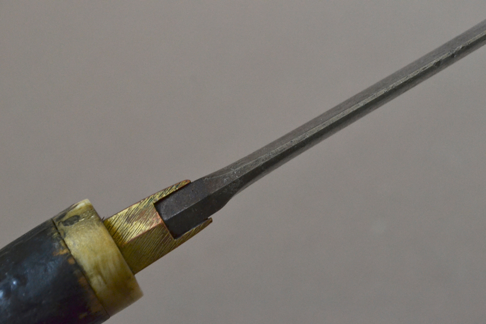

Which brings me back full circle to this example… In addition to the habaki (the sleeve over the bottom of the blade), the tanto also had two menuki (small hilt ornaments) attached, both traditional Japanese mountings.
However, the ferrule, grip, grip cap/pommel are all non-traditional, as is the method by which the hilt is fastened to the nakago (tang). Of note are the stylistic elements that repeat on the ferrule and the top of the grip, a foliate vine pattern executed in black lacquer. There is also remnants of gold paint or gilt on both the ferrule and the pommel cap.
The rattan binding matches similar binding found on the lone Ainu tanto I have found. However, I have not seen nearly enough Ainu-mounted Japanese blades to form an opinion.
And while the aesthetics IMO are distinctly East Asian, could the use of similar organic (though not same IMO) material on the ferrule and cap, while recalling fuchi and kashira, also indicate a possible influence of native tastes, i.e., influence from peninsular cultures surrounding colonial outposts like the one in Nakkom Si Thammarat?

Very interesting information. I once saw a katana on fleabay, with very obvious African decorated fittings, and scabbard. On the weapon in question... Is the cutting edge on the inside, or outside of the curve?
The cutting edge is on the convex edge; as I understand it, other than double-edged moroha zukuri, the only japanese tanto with a cutting edge on the 'inside' of the curve, kubikiri, are blunt-nosed, i.e., they have no kissaki (point). The example shown above is tori-sori unokubi-zukuri, either a naginata-naoshi or a naginata-naoshi styled wakizashi.

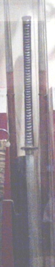

Default Trade blade in China.

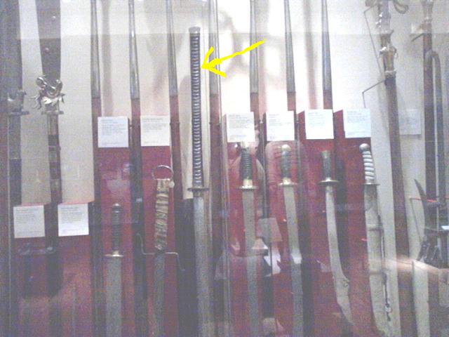

In the Royal Armouries Leeds there is a large Japanese Katana/Nodachi in a very long hilt that came from China. As part of the convertion the Chinese had forged the tang out to a long wittle tang and then peened it over the pommel to hold it, rather than using the flat tang and peg it had been made with.

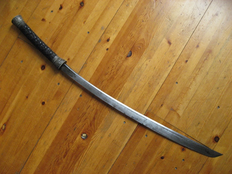

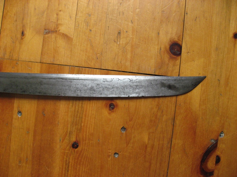

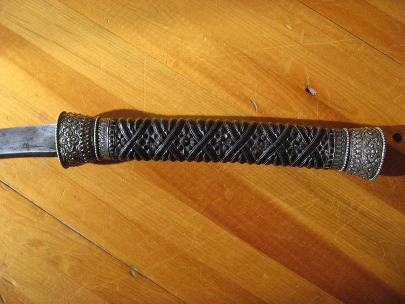

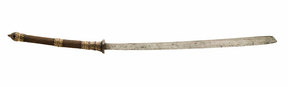

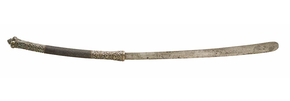

Sure!
At almost 40 inches it is a bit of monster. I've been lucky enough to handle a few of this style and this is the largest. Others have had different blade styles but similar handles, with the wrapped-style decoration, and oval profile. I find the different cultures represented fascinating.
DhaDha is offline   Reply With Quote

BTW I believe the blade to be locally made, in the spirit of a Katana.

Thank you for posting these images of this fascinating - and beautiful - dha variant. The hilt is most definitely made in the style of an ito-wrapped tsuka, and it is the first time I have ever seen this feature borrowed by and incorporated into another culture's indigenous weaponry.
I also agree the blade is not nihonto, but rather is a local interpretation of a katana blade. By your estimation, how old is this dha?
David: Interesting find, and thanks for posting it... You wouldn't happen to have a photo of that long hilt, would you? As it so happens, the curator emeritus of that collection is involved in the discussion of this piece over at NMB. He's about to leave on vacation but has said he is going to take a picture of another 'pseudo-naginata' in the Royal Armoury Museum when he returns... I'll ask him about the piece you're speaking of.

Yup, that's the one
D, I had forgotten the blade was local, just the general impression remained. I do recall it was a pleasure to handle.

Hey Emanuel, glad you were talking about this one You do remember correctly. Pretty nimble for such a large piece. Glad you liked it.
laEspadaAncha, these are often attributed to the Ayutthaya Period (1350-1767). But I've seen them come from right up to the 1800s as well. I'd say this this one is on the older side of what I've handled and seen. Around 1680-1700? Hard to say though. By the way, they also exist with Chinese-styled blades. But still sporting the Japanese styled hilts, and SEA fittings. Pretty cool.

Outstanding sword, DhaDha! Thanks for sharing it.

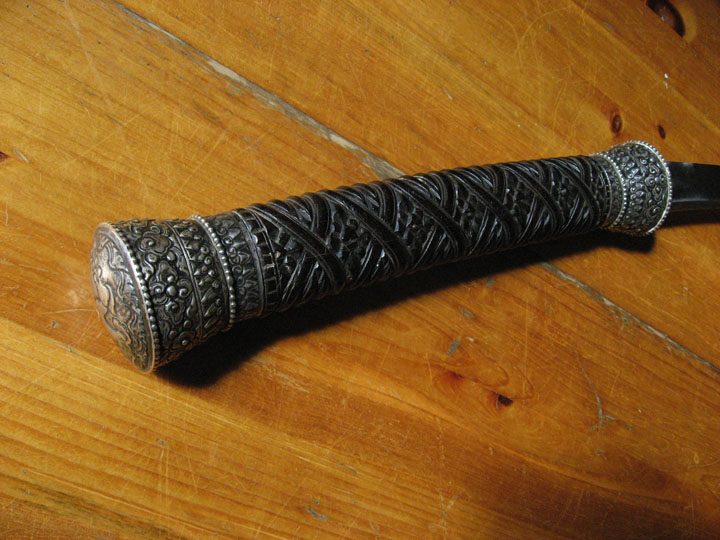

Based on the repousse work and blade markings, however, I would place the age of your sword a bit later than the Ayutthaya period and would lean more towards the late 18th/early 19th century (Rattanakosin period). Many pieces from this period evoke or are in a "revival" of Ayutthaya design.
Here is an example from my collection with similar silver work dating to the early 19th C.:

The few, true, surviving Ayutthaya period swords I have handled have iron fittings, often with gold and/or silver koftgari and more...delicate (?) and refined blades and workmanship. An Ayutthaya sword from my collection:

This is why i try not to go on record dating these things. My own opinion changes often. That said, I do feel this one be older than that estimation. But maybe a bit younger than mine. There is at least one example in the National Museum in Bangkok with a Japanese-styled silver handle attributed to the Ayutthaya period. With so many different styles of swords worn by so my different groups, I have a hard time with hard rules...

Can't really argue with you too strenuously--my opinions on these change as well, and truly old Thai swords with reliable, documented provenance are scarce.
I will observe, however, that rattan (and other similar organic materials) like that on the handle of the top sword, does not generally survive in such good condition on swords that are 300+ years old...
Sorry for the delay, here are pics of the remodeled katana/nodachi.

I'd love a good clear shot of the Gou (hook swords) to compare with the pair I have....
