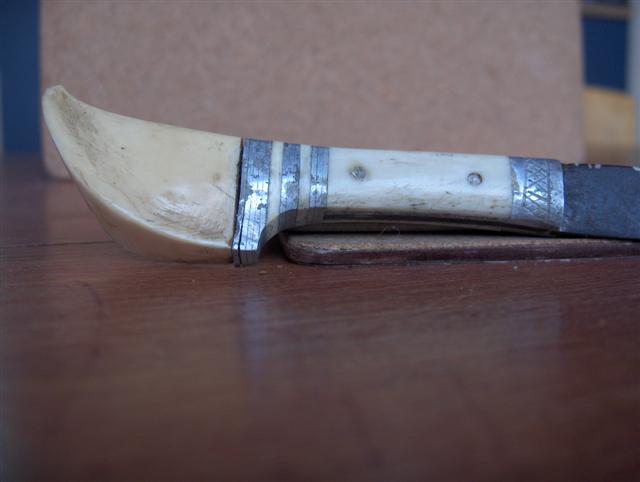

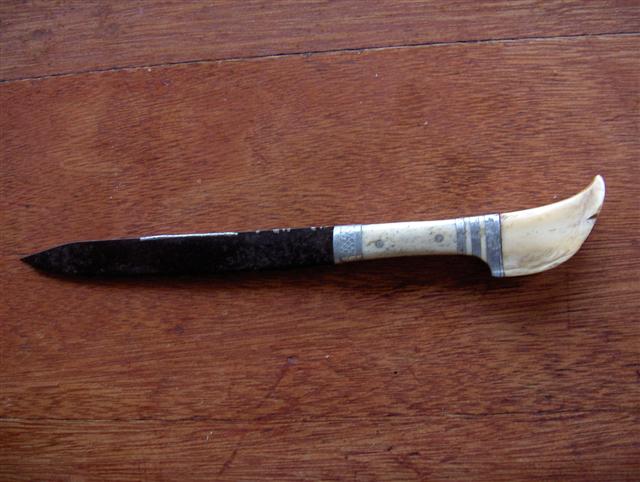

I bought this in the Maldives about 20 years ago. I was told at the time that it was used for (amongst other things) writing in traditional script on leaves and that was why the tip was curled. I am curious if anyone has anything to offer on the piece. I know it is not strictly a fighting weapon so am not sure if I am out of line posting here. It is about 24 cms (10") long.The inlays seem to be silver, the handle ivory or bone. The blade has old rust patina with a little pitting. Speaking of which, I come from bayonet collecting background. With them the ideal is minimal cleaning, leave the patina as is, but I noticed from reading a few dozen posts on this board that some cleaning/polishing seems ok with the mostly asian and african swords I see posted here, is that a correct or incorrect conclusion .

I HAD NOT HEARD ANY STORIES ABOUT WRITEING ON LEAVES WITH THEM BUT THEY ARE THE TRADITIONAL FORM OF DAGGER USED IN THE MALDIVES.
YOURS IS THE FIRST ONE I HAVE SEEN WITH THE TIP LIKE THAT I WOULD SAY IT IS DAMMAGED UNLESS SOMEONE DID IT INTENTIONALY SO THEY COULD USE IT FOR SOME PURPOSE. I TEND TO BOUBT ANYONE WOULD DAMMAGE A NICE DAGGER JUST TO WRITE ON LEAVES OR WHATEVER WHEN A SMALL TOOL COULD BE EASILY FASHIONED FROM SOMETHING ELSE EVEN WOOD.
ON THE GOOD ONES THE MATERIAL USED ON THE POMEL IS MADE FROM SPERM WHALE TOOTH, BONE WAS NOT USED AT ALL ON ANY OF THE EXAMPLES I HAVE SEEN. THEY MAKE SOME FOR SALE TO TOURISTS THAT ARE COVERED IN BLACK CORAL OR MOTHER OF PEARL CURRENTLY. THE GOOD OLD ONES ARE VERY EXPENSIVE TO BUY IN THE MALDIVES AND DIFFICULT TO FIND TODAY. MOST TOURISTS COME ON THE CRUISE SHIPS THAT STOP THERE SO IF ONE IS IN PORT OR EXPECTED SOON PRICES ARE UP. CONGRADULATIONS ON A SELDOM SEEN KNIFE!
I MOSTLY SAY TO CLEAN OFF ANY ACTIVE RUST IS OK BUT TO GLEAN AGRESIVELY ENOUGH TO REMOVE PATINA OR TO GO DOWN TO BARE METAL FOR A ETCH TO SEE IF THERE IS A GOOD PATTERN IS A MORE DIFFICULT CALL. PERSONALY I PREFER TO JUST USE OIL OR WAX TO STABILIZE A PATINATED BLADE OR ONE BLACK WITH OLD STABLE RUST OF COURSE THERE ARE EXCEPTIONS TO EVERY RULE .

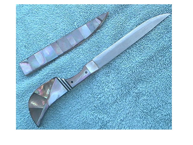

Heres a contemporary piece that I have with MOP pieces all over it,like Vandoo mentioned:

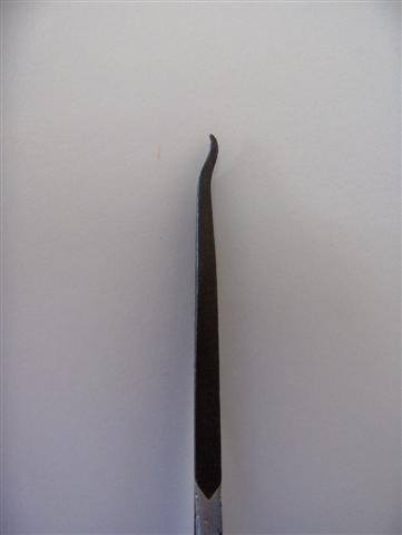

Drdavid,

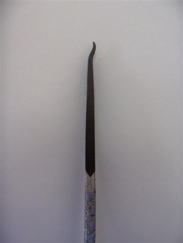

Is there any way you could post a better picture of the knife looking down on the spine and showing the tip? One with out a shadow would help alot. I, like Rick am not sure if it is damaged or made like this on purpose and a better picture might help in deciding.

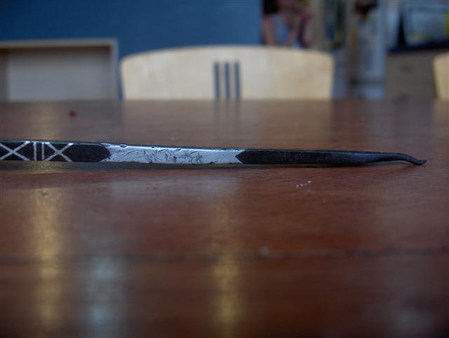

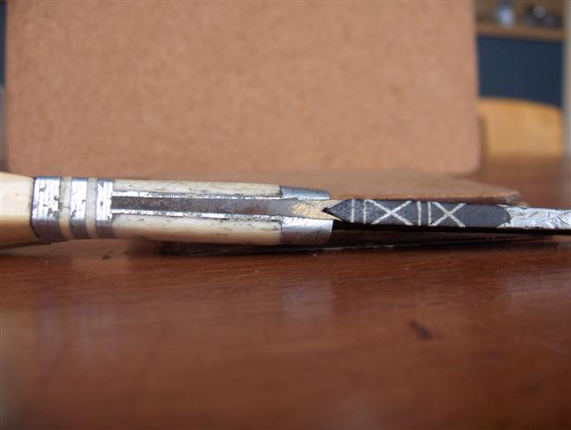

Here are a couple more photos, tricky getting rid of shadows and not using flash. Thanks for the interest in this topic

IMO to get a bend like that in a blade that thick you would need super strength and a 1/4" thick steel plate to ram the point into .
Also , if my eyes do not deceive me the left side of the blade is arrow straight right up to the first bend whereas the right side seems to taper in a little ; and what's up with the recurve ?
If a blade gets bent it's usually in one direction , not an S curve .
I still think it's intentional ; if not someone would have already tried to straighten it on an anvil .

You can get a bend like that by trying to pry something with the tip of the knife (like the lid of a paint can or a chocolate tin), especially if you try and bend it back the same way. How soft is the metal of the blade? If it is fairly hard, I would be wrong, as the tip would have snapped off rather than bent.
I have to say that it does look pretty deliberate, though. The very tip has been brought exactly into line again with the spine, for example.

And if you hold an edge of paper against each side of the blade the uneven taper becomes more apparent .
Pretty strange though I will admit .
