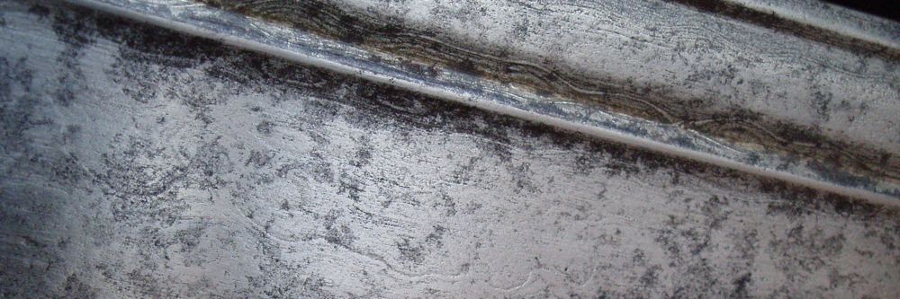

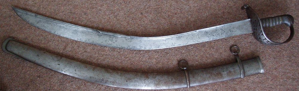

Hi All,
New aquisition, blade length 29 3/4 inches 35 1/2 inches overall. I think an Ottoman/Turkish blade mounted with a European hilt possibly Austrian or perhaps Swiss and with a purpose built metal European style scabbard with slot to upper part and suspension ring to accommodate the curve. Do you think this is a trophy remounted or a European style mount commissioned by an Ottoman officer? As you can see there is Arabic script on the blade, presumably Turkish but maybe not, a translation by our resident team is much looked forward to. The blade itself has a pattern and I would be grateful to the experts in this field as to how I should go about bringing out the best that the blade may have to offer. I look forward to all opinions and thoughts.

A very fine sword indeed Norman. Did you have to remortgage the farm for that one??
Looks pattern welded and not wootz to me.
Be careful with any etching as you of course also have western military type etched designs.
A very, VERY light etch with warm vinegar might show more, but be careful.

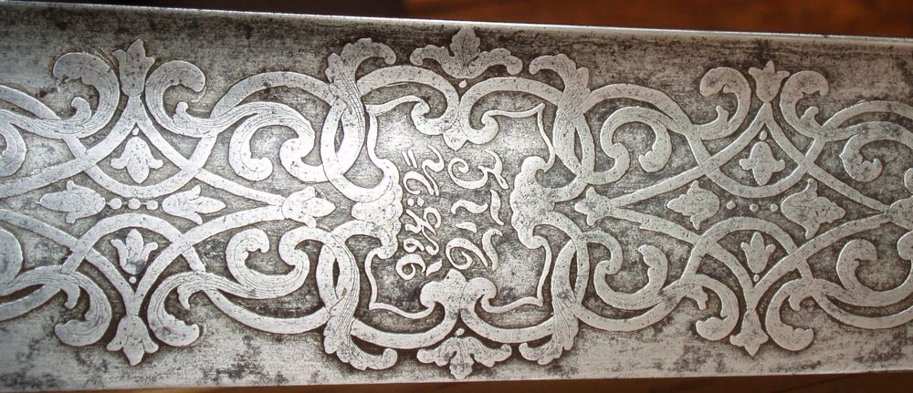

Third pic shows some pseudo-arabic gibberish. I am sure the blade is not eastern of whatever origin: european imitation. Very nice and unusual sword. Would be interesting to now whether it was a regulation pattern, place of manufacture etc.

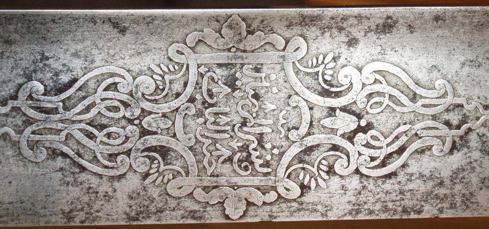

Nice one. I really like the blend! The inscription at the top says "bashir almumeneen" (bring glad tidings to the believers. Quranic verse) the bottom one says "hibir/hisir (?) albab" (I think its either a name or a sufi reference albab means door)
What about the latin inscription? I cant read it... Maybe some date is there?

Many thanks for your comments and help re the translation, I'm a bit lost as to the Latin inscription, which text do you mean?

Many thanks for your thoughts. I thought about it being a European blade but the patterned steel, the Arabic script and there is a hint of the etching having been gilded, small amount of gold where the hilt touches the blade, made me think it was Turkish. This is out of my comfort zone so I'm 'stabbing' in the dark. Thanks again.

I have seen genuine Oriental blades in British hilts, I have seen genuine Turkish barrels mounted as Austrian hunting rifles. Prior to the 1830s and even later, Eastern blades and barrels were often seen as superior to the Western product. I see this as a genuine Turkish blade , mounted at the time as an Austrian service sword, perhaps via another country like Greece or Montenegro.

Hmm, I would have fully agreed if the etching wasnt present. The fact that the Arabic inscription is etched in european style makes me think its a european production. Koftgari seems to be the way to go for turkish arms so doubt they'd use such etching.

I e-mailed the Heeresgeschichtliches Museum (Museum of Military History) in Vienna regarding the origins of this sword, the reply is below. I would certainly agree that the blade and hilt were not made originally for one another and the explanation that Mr Ilming gives is one that seems reasonable and obviously not unknown. If anyone else has a view, contradictory or otherwise, I would be pleased to hear from you.
Regards to All,
Norman.
Dear Sir!
I think the blade of this sword will have belonged to a different one, before it was mounted with the hilt it has now.
The blade was perhaps part of a booty in the wars between Austria and the Ottoman Empire in the 18th century, and handed down in the family of the person who captured it, until it was used by one of his descendants in the combination you have now purchased.
This happened quite often within the nobility, where almost every male member of those families in every generation served as an officer in the army. By this way such “hereditary blades” were preserved over the centuries.
I hope, this response is of some help for you. Please do not hesitate to contact me again, if you have some further questions.
