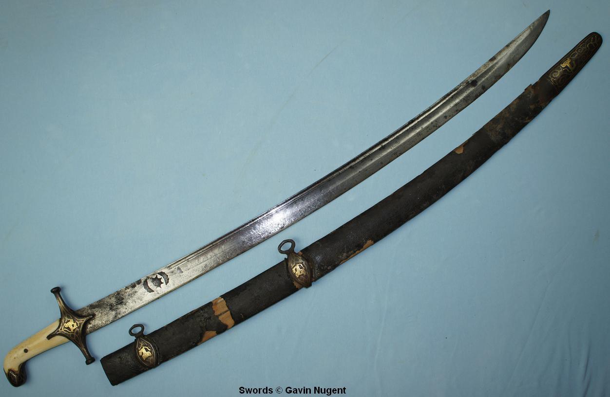

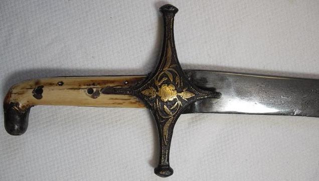

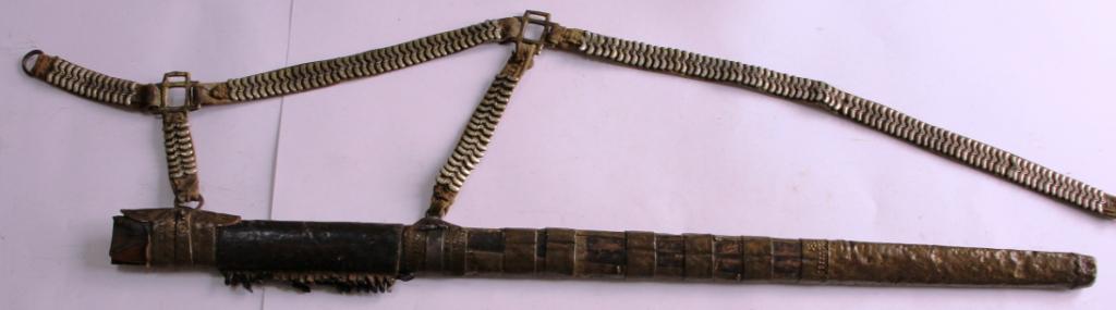

A long time on the want list this one;
I did a while back buy this sword for the collections and I know some of you have viewed it privately as I have not yet added it to my gallery page.
My reading points this to be a true Khevsurian sword in Persian style rather than one of the 'Cottage Industry' types often passed off as the real deal.
The armourers stamps are to both sides and are similar to those of mid 19th century Georgian smith marks but being aware of the intricacies behind these weapons, there could well be other cutlers who used and or copied these marks.
I'd like to share this image now that my new camera has finally arrived.
Comments and further directions to the intricacies behind these swords are welcome.
Gav

Very nice piece, but I disagree about its attribution. This is a typical Georgian Khmali, saber, in Persian style. Khevsurian sabers ( palashes) are cruder, their handles are different and brass bands are the must.
There is, indeed, a proliferation of Khevsurian swords on the market, many not fakes, but actually homages, and are honestly signed by the contemporary master, Mr. Kharanauli.
Ariel, thanks for coming in. If anyone would know, I knew you would, thank you for clearing that up.
So it is the dress the sword is in more than the sword itself that denoted this Khmali attribution Ariel?
I ask, as an example, a recent auction had both described within its catalogue. Swords labeled as Khmali that shared by large degree many similar attributes with the hilts of Khevsurian swords. In the same auction a Khevsurian Palashe shared the same but cruder motifs on the guard and suspension fittings as this example does...in simple terms, not clear cut to myself.
What should be considered when delving in to this world and seperation of the two labels, or more so identifying the Khmali attribution.
You note 'typical' too Ariel, I know it is in reference to styling but how typical are these sabres? I know I do not see swords like the one above very often at all and untouched as found examples even less.

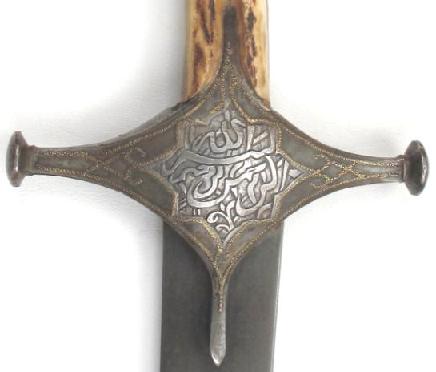

Agree with Ariel. This is Georgian saber. Here is another one in Persian shamshir type.

Thanks Alex, nice to see other varients of Georgian sabres, interesting to note the inclusion of the 'gazelle' on the drag, kinda highlights in a way, one plausible notation the history or the lion/leopard motifs on these swords.
Can you address the division of points asked above in relation to the shared factors on the swords of Khmali and Khevsur design elements in the hilts etc?
Do you consider the one you present a trophy or war or a sword of trade decorated in native Georgian fashion?

... Khevsurian sabers ( palashes) are cruder, their handles are different and brass bands are the must...
correct - the brass bands are characteristic for hilts (and scabbards!). There could also be brass inlays on crossguards, as on our examples. Below is another example of a crossguard with brass inlay elements. The brass inlay is more of a Georgian feature, but the cheaselled script is Persian.
Gav, it is hard to say whether it is "trophy or war or a sword of trade decorated in native Georgian fashion". My opinion is toward the later - the Persian blade is much more likely to be a "trade" object, furnished in local style, by commission/order or to make it more saleable - still a well practiced trade, whereas the "trophies of war" is not as much, thankfully.

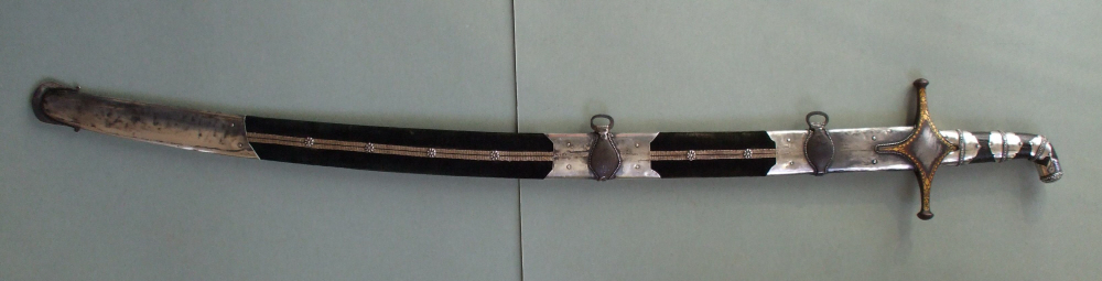

Here is one below listed at AI as
"A RARE KHEVSUR KHMALI SWORD"...why both denominations...covering all bases or am I missing something.

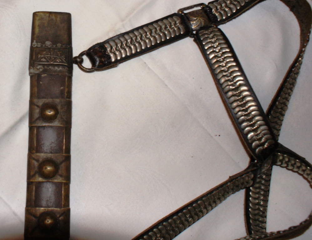

A couple of more images that also show other Khevsureti with curved sabres of Pesian styling and scabbards free from brass binding...
The upper image, the middle chap with an unbound scabbard, curved sabre with a hilt type often refered to as Khmali....
The lower image labeled Khevsurian as is the image in the post above, again, a curved sabre with unbound scabbard and Persian style hilt.
There seems to be no absolute about Khevsur swords just a majority of brass bound swords....what gives?

First of all allow me to make few corrections to provided information. The picture of seated warrior in chain mail, signed in Russian script “Xevsur” is well known picture from Russian collection of types of the Caucasus. However on the picture is not a khevsur highlander but a person that was hired by the studio to pose in khevsurian garment. The armament on the picture is assembled from various sources and there for is not entirely khevsurian. Saber is not of khevsurian style as well as head piece and clothing below the knee.
Next to above mentioned picture is another one of the saber , signed “khevsur khmali ….”
It is not however khevsurian , though I agree it shares some features. The saber is typical for Kartly and Kaheti regions of Eastern Georgia. The distinctive features are elements of scabbard. The blade itself is of curved “gorda” type or also known as “gurji gurda” its distinctive features are fullers and marks on the blade. So how to distinguish khevsurian saber or palash . One should keep in mind that scabbards of khevsurian swords are extensively or completely covered in metal. I will try to post few examples of such scabbards.

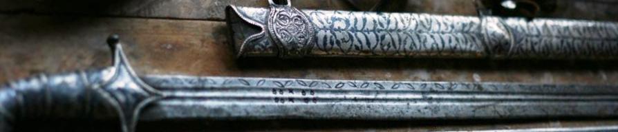

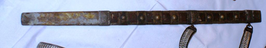

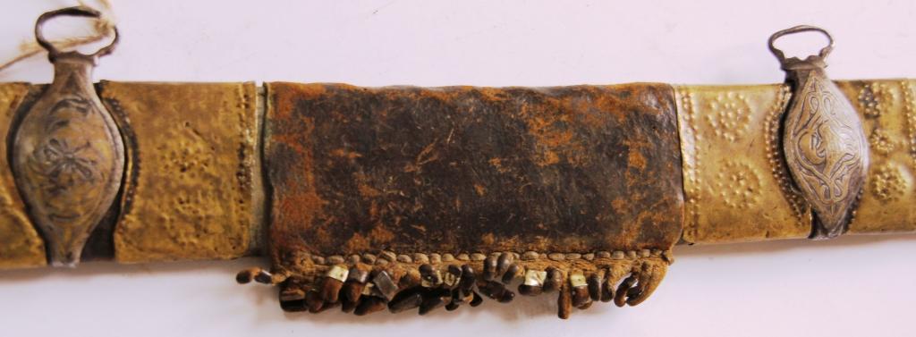

There are few general details and elements that are helpful in establishing khevsur origin of the sword. Most of khevsur sword harness should have along its length small silver or brass embalishment scales (also protecting the leather of harness).
Also take a look at the connecting section , it is another element.
Keep in mind that khevsur scabbards are extencively protected by metall elements or compleately covered in brass or silver.
Of course there are diferences in curved or chiseld paterns, shapes of scabbard plates that came from diferent Khevsurian glens or communities. But those diferences are unnesasary to know for general attribution to Khevsureti region.

Items displayed above are from the collection fond of GeorgianNational Museum, Kibishauri family and Likokeli family.

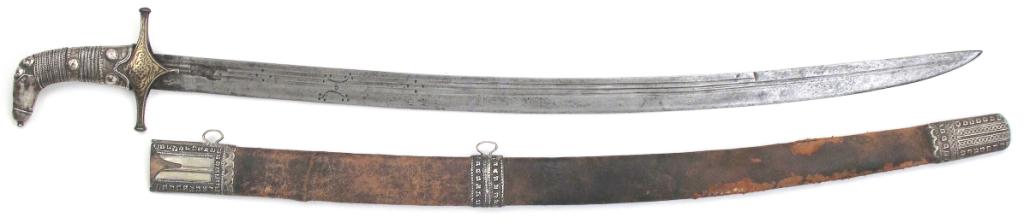

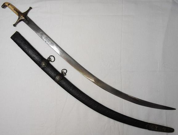

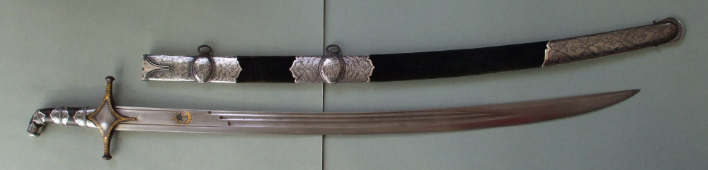

Have a question, this is a Khevsurian sword? Or does it have another name. Best, Kurt
Kurt is offline   Reply With Quote
Old 21st July 2012, 01:09 PM   #22
I know I am barging in, and I do not want to steal the thunder from Kiziria, but I am just happening to sit in front of the screen:-)
I think that Kurt's saber is not Khevsurian, but Kartli/Kakheti, ie strictly Georgian one. This is with full understanding that Khevsureti is a part of Georgian cultural domain, but has very local flavor due to their geographic isolation and just local peculiarities.
BTW, Kiziria may correct me,but I cannot recall any Khevsurian sword with abundance of silver: they were pretty poor, and brass was the usual material, with occasional silver decorations on the handle. Also, and again IMHO, Khevsurian scabbard fittings are never traditional 3-piece beauties, but rather multiple simple brass circular bands.

Hi, Kurt ! Thank you for wonderful pictures. Really nice item here.
Ariel pretty much answered to your question so I have nothing to add really.
If you make closer shot at stamp we might read it and know the name of the maker, maybe even the year of making. The stamp itself might be from Tbilisi craftsman, cant say for sure based on pictures only.
Thank you again!

“barging in” is only welcome dear Ariel ! And you are absolutely correct about saber that Kurt displayed, it is definitely not a Khevsurian type but of Kartli/Kaheti region which we can judge by the construction of the handle and niello pattern on the silver plates of scabbard and scabbard itself.
About your question. Nither me nor my colleagues have seen many of silver plated swords from Khevsurety.

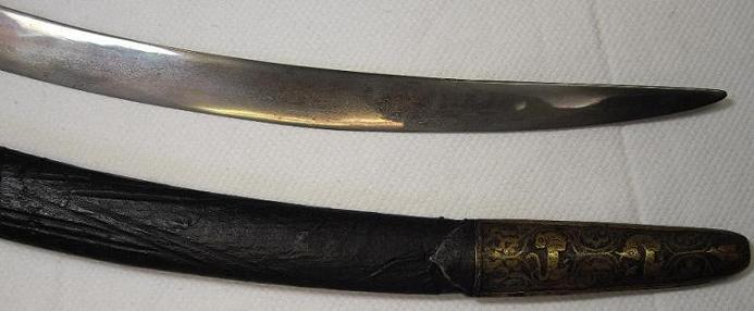

The silver scabbard and sword that I had displayed on top is one of 2 that belong to Likokeli family from Likokeli glen (Likokis temi in Georgian) and were made by Likokeli masters.( Present owner David Likokeli however does not continue family tradition). Likokelis swords are of special interest because these masters had kept distinct style for blade making as well as for pattern motives on silver. I will find and post later an axample of their signature blade, which might be helpful for attribution.
There are other fully clad in silver or brass scabbards that could be attributed to works of other old smith families that claimed its authorship namely Arabuli, Mindikauri or Chincharauli , but work of establishing it is not finished, because those items are not in Khevsurety but in provide collections. Hopefully in the end we will be able to say exactly which work is done by what master. So far there only 9 such swords are located. It is a really small number but we hope to locate more.
They probably were never produced in big numbers partly due to the fact that not every one could afford it. Also it had been suggested by a collegue that silver wears quikly against chainmail shirt so silver plated scabbards probably never could become a common choice. ( arguable in my opinion)

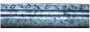

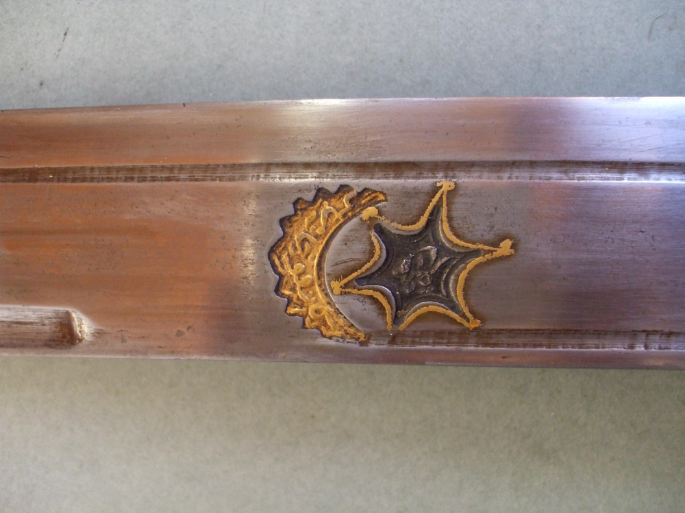

I doubt that any such work will turn up occasionaly since it is very rear , but just in case here are the following.
"likokeli blade"
Note the kind of oval made of two semicirkles facing each oter and joined in figure (dont remember the name of such figure in English). Note that curves of "oval" are smooth unlike "eyelashes" that are distinct for "gorda" blades. This "ovals" tilted and arranged in a row runs along the blade length and end up where "sashari" or double edged shurpened tongue of the blade began.
