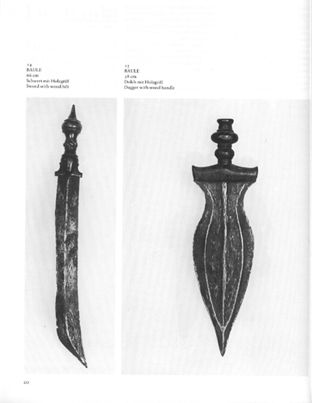

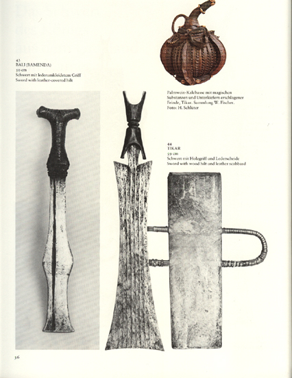

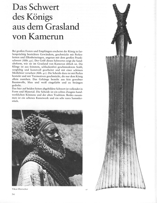

Hi Freddy, this knife/short sword it's particular but very beautiful.
I don't know with precision the provenience, but seems to me that remember some Tikar sword (Cameroon) in the "decoration" of the blade as you can see in some examples on Fischer/Zirngibl's Afrikanische Waffen.
To the contrary the general shape it's similar to the Baule sword (a part the tip of the blade).

In this thread Flavio showed some pics from Zirngibl and Fischer (by the way, a great book !).
Here's one of the pictured sword 'live' :
Notice the similarity in construction of the handle (not the shape, of course). Some kind of material, I think it's a piece of wood bound with cord, covered with leather. The second pic shows the front, the third the back of the handle.
This sword is attributed to the Bali-tribe living in Cameroon. The sheath consists of some wooden pieces held together with rattan binding. The loop is also covered in leather.
When I found this piece, I didn't know anything about it. I had never seen a similar sword, but I had to have it. I just couldn't resist. A friend pointed out to me that he found a similar one in the book of Zirngibl and Fisher.
